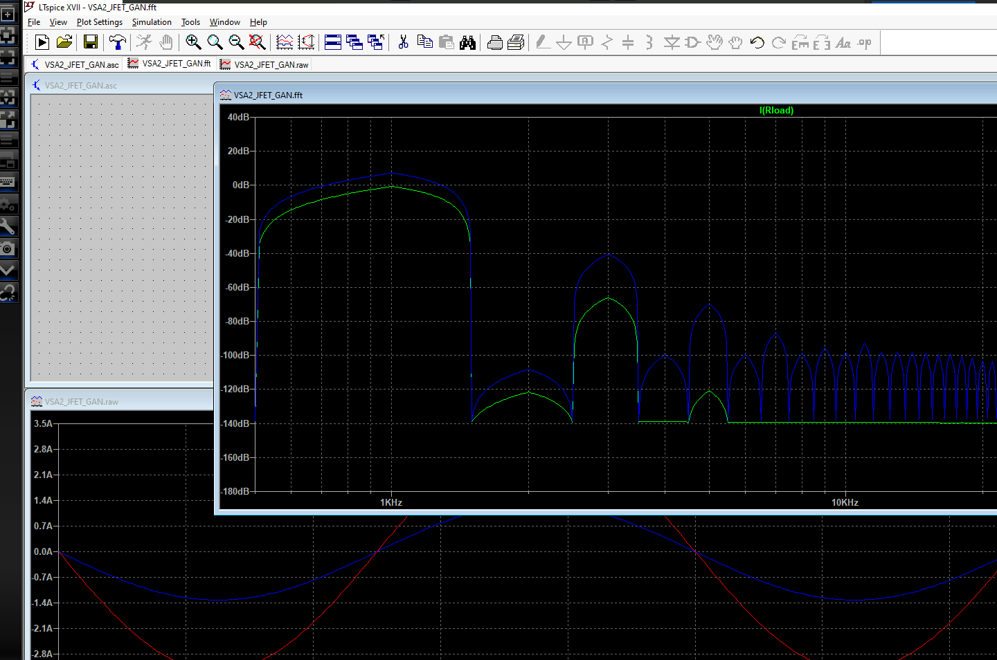

I did the simulation:
I attach photo of FFT.
bias needed is around +1.65V
Circuit is far from tuned because KP1 seems better fit for negative bias. So needs a lot of tuning and now I manage only 3.5 App. With SiCs I manage 7App
It needs more work and I have to stop again working due to other obligations.
On J111 (Idss-100 mA), the optimal offset is + 1 ... 2 V. For SiC, use J112 (Idss-50 mA). The maximum amplitude of the offset depends on the Idss Jfet, which are in the buffer. As the Idss increases, the offset shifts towards the positive side. When decreasing - in the negative direction. This must be taken into account in the simulator.
Correct. For this simulation I used J111 but the problem is not the bias, I manage to get it correctly, no issue there. The problem is the amplitude of the driving signal of the final stage FETs. Without much tuning I get 30 Vpp, which on 8 Ohm gives me 3.5 App.
With SiCs but with a lot of tuning I had doubled that.
BTW the input signal is 0.3Vpp which makes this design proper for FULL integrated amplifier, not final stage, with only two stages!!! Excellent design!!!
Still, haven't managed to create the prototype, even if I have soldered the PCBs and have all the parts in place... But I am close...
OK using 2N4091 i can get 4App. In general it needs work to go up. The final stage I use is GS66508. They seem to work excellent. I get for now to 0.05THD in 4W but mainly due to buffer stage not the final stage.

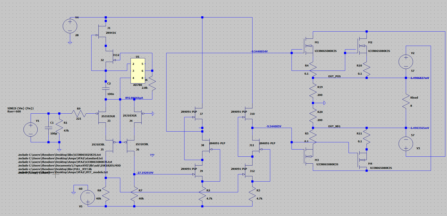

But you need to swap J1 and J2. J1: Idss - 10 .... 20 mA, J2: Idss - 3 .... 5 mA. 2N4416: Idss - 5-15 mA.
The stable current generator circuit has been modified and may be unstable.
Thanx. I had it that way and couldn't make the circuit stable... Any way let me try again
PS. Did it, same results but it takes longer to analyze circuit: J1: 37mW, J2: 3mW
OK, now I remember why I had reverted them. The correct way gives me a little worse distortion (a little bigger 3rd harmonic)

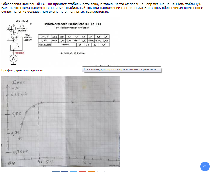

On a Russian forum, author Sergei (Svjatoslav) investigated a stable current generator(SCG):"I examined the cascode SCG for current stability, depending on the voltage drop across it (see table).
It can be seen that the circuit reliably generates a stable current at a voltage of 3.5 V and above, providing an internal resistance greater than that of a bipolar transistor circuit."
This circuit is very stable, provided that J1 is Idss = 10 ... 20 mA, J2 is 3 ... 5 mA.

I was able to source all the jfets exactly as shown in schematic. Can you confirm the circuit in post #27 is the correct schematic to use for the 2sJ103/246, the J112 and the UJ3 SiC Jfets?
I am not clear if there is a PCBWay PCB done for it and(or) an available power supply board for it.
I would also like to know what is the power output and the quiescent current as drawn in post #27 just to make sure I get the heat sinks sized adequately.
this is one of the most intriguing designs out there so I am going to embark in this.
Yes, the circuit from post # 27 will do. Instead of 2SJ103Y (VT3, VT4), you can use 2SJ103GR. On VT5, VT6, you can put J175 (Idss-25 mA). Quiescent current - 0.3 ... 0.4 A.

I saw the circuit with the thermosensor installed post #200.
What is that? It's in russian.
Yes, these are Russian germanium diodes. You can use silicon diodes, but you have to experiment.

UJ3N065080K3S will be closed provided that the gate is -12 V or more. When the amplifier is turned on, the SiC will be open until a negative voltage appears at the gate. To prevent the fuses from blowing, it is necessary to delay the power supply to the SiC for 2 seconds until -8.5 V appears on the gates. To do this, you can use a protection board to supply AC voltage to the primary winding of the power transformer.
maybe I am getting my terminology confused.
The datasheet says normally on 80 mohms at vgs=0.
So it's a short at sturtup.
yes ok so you need the neg vgs to bring the resistance up so as to flow the correct 400mA bias.
Yes. And for a quiescent current of 400 mA, the offset is approximately -8.8 V.
As the negative bias across the SiC gates increases, the quiescent current will decrease.
