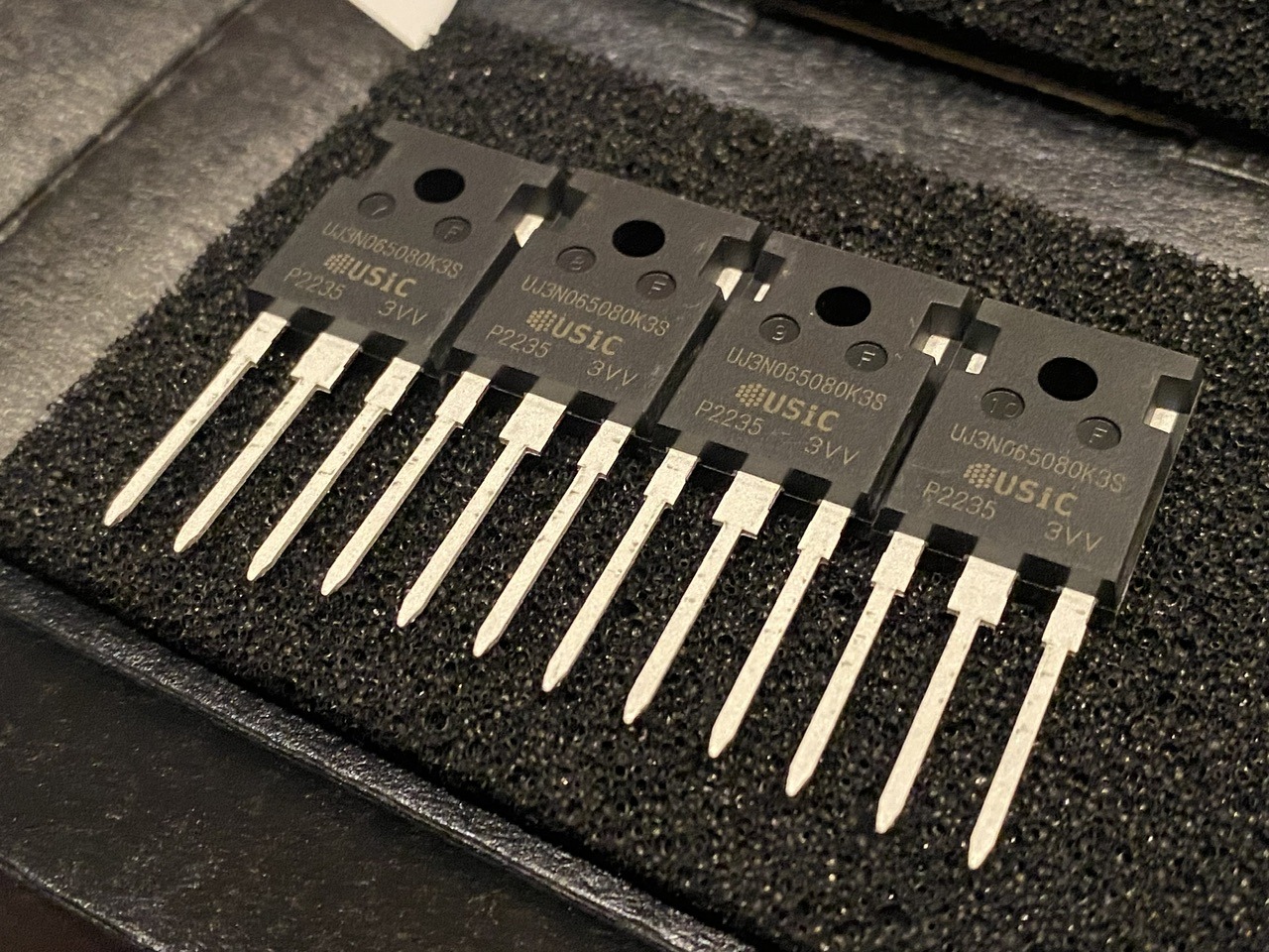

These puppies are trough hole: https://eu.mouser.com/c/semiconductors/discrete-semiconductors/transistors/mosfet/?mounting style=Through Hole&technology=GaN
I can’t get LTSpice to work on my Apple M1 (I’m too stupid for this) but if I get it working I’ll do some simulations as well.
Need to design something firth a tube frontend and a **** ton of parallel transistors in the output. Each with it’s own bias
The one that could fit is TP65H015G5WS. It is the one that has acceptable SOA. But will fit in project in more than 6 months from now 🙂

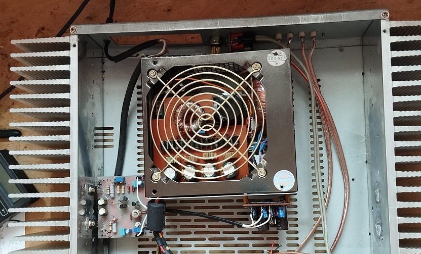

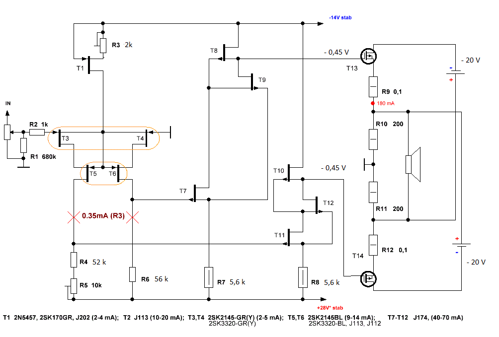

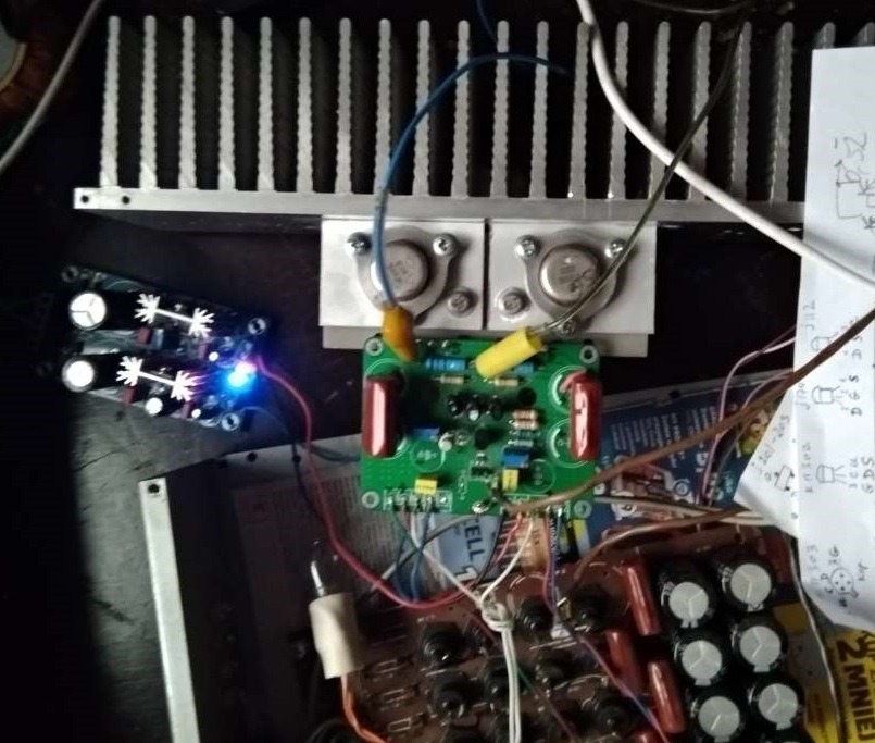

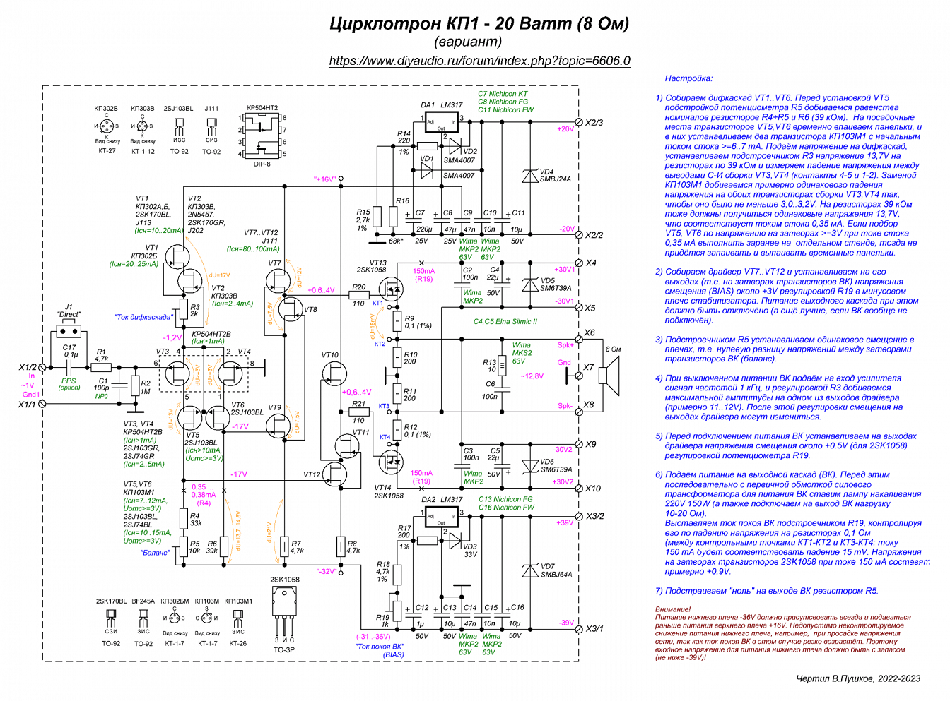

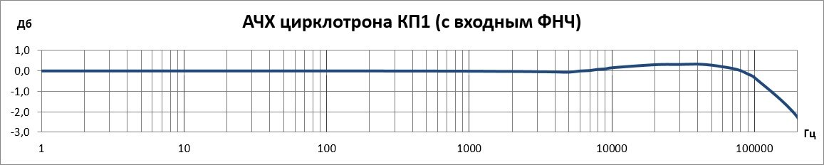

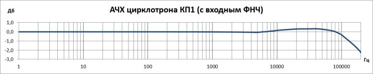

Removed transistor T2 (KP2). Nothing has changed, stability has remained the same. I attached darlingtons on germanium transistors instead of mosfet. I used germanium diodes D303 in the power supply. On massive radiators, the current is very stable. MOSFET laterals P- channel are also well suited for KP2 circuit. But the output impedance will increase to 2.5 ohms.
https://www.profusionplc.com/type/lateral-mosfet
Square wave - 60 kHz;

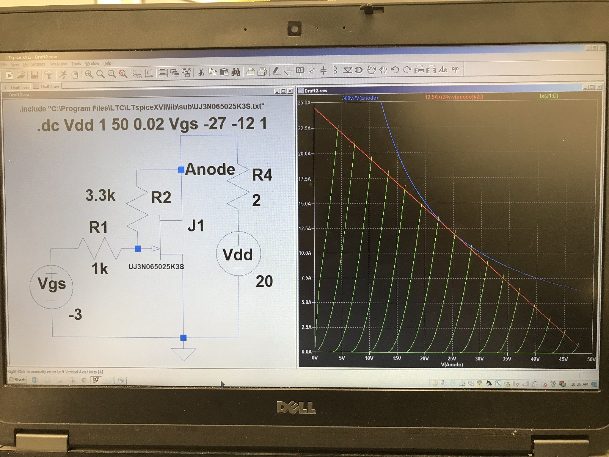

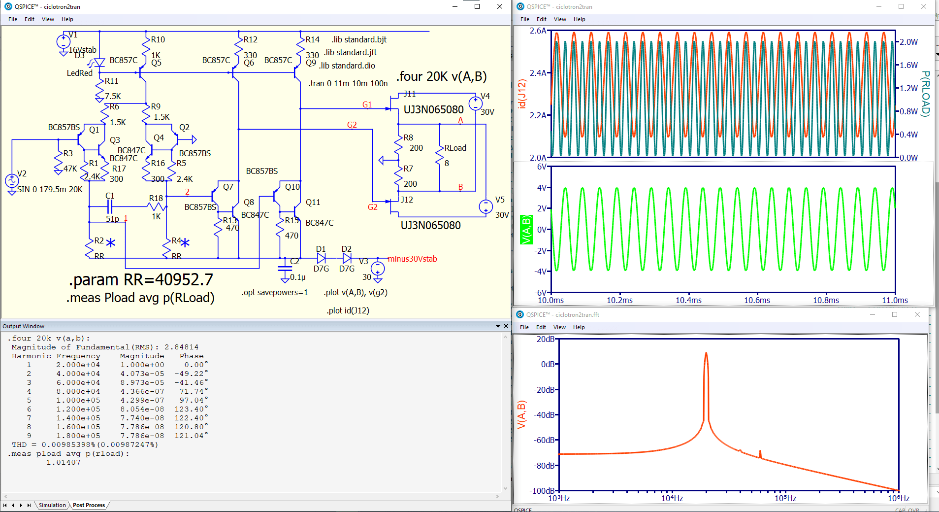

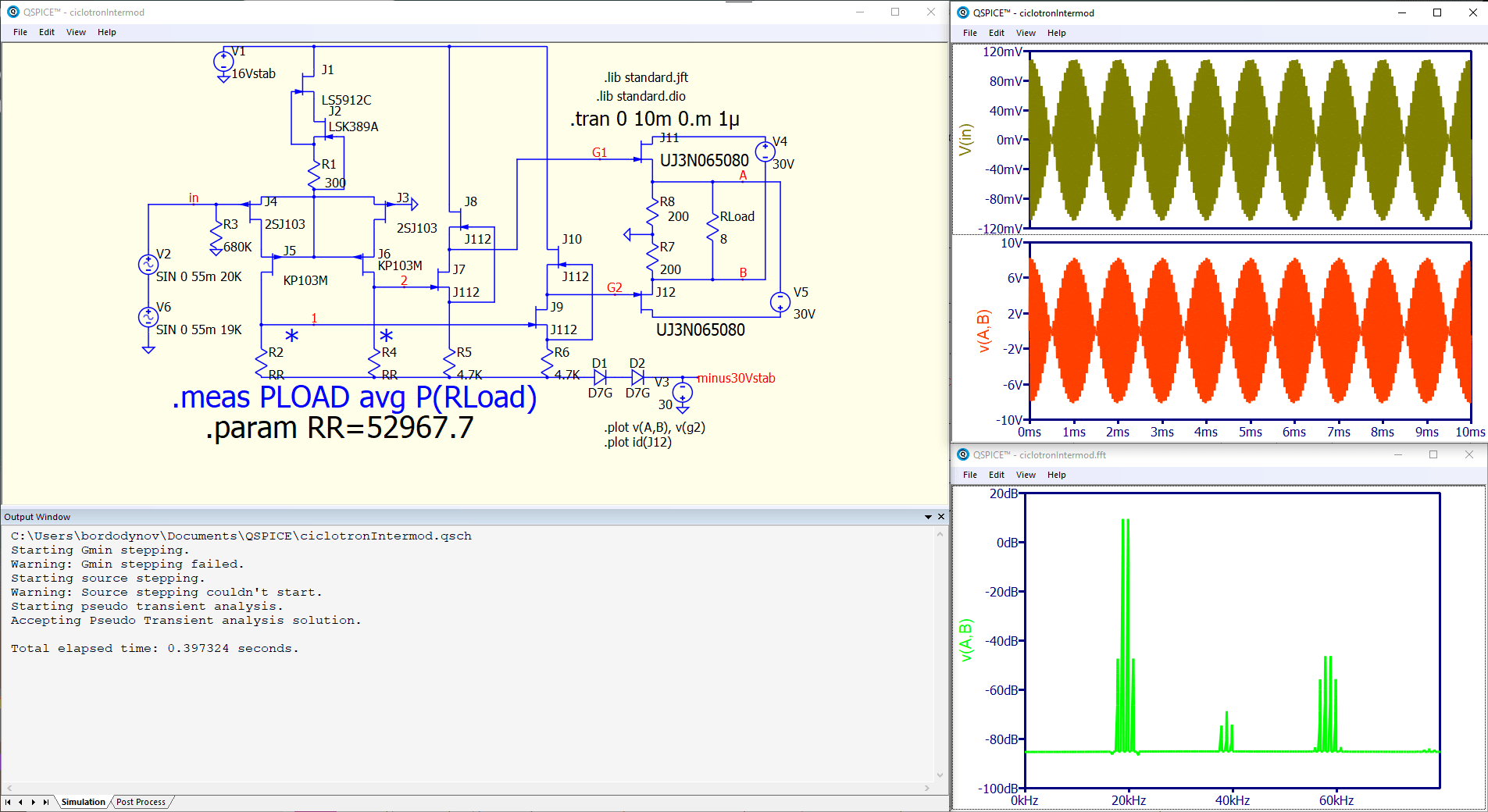

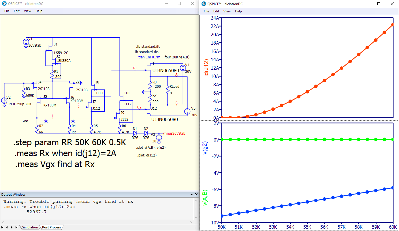

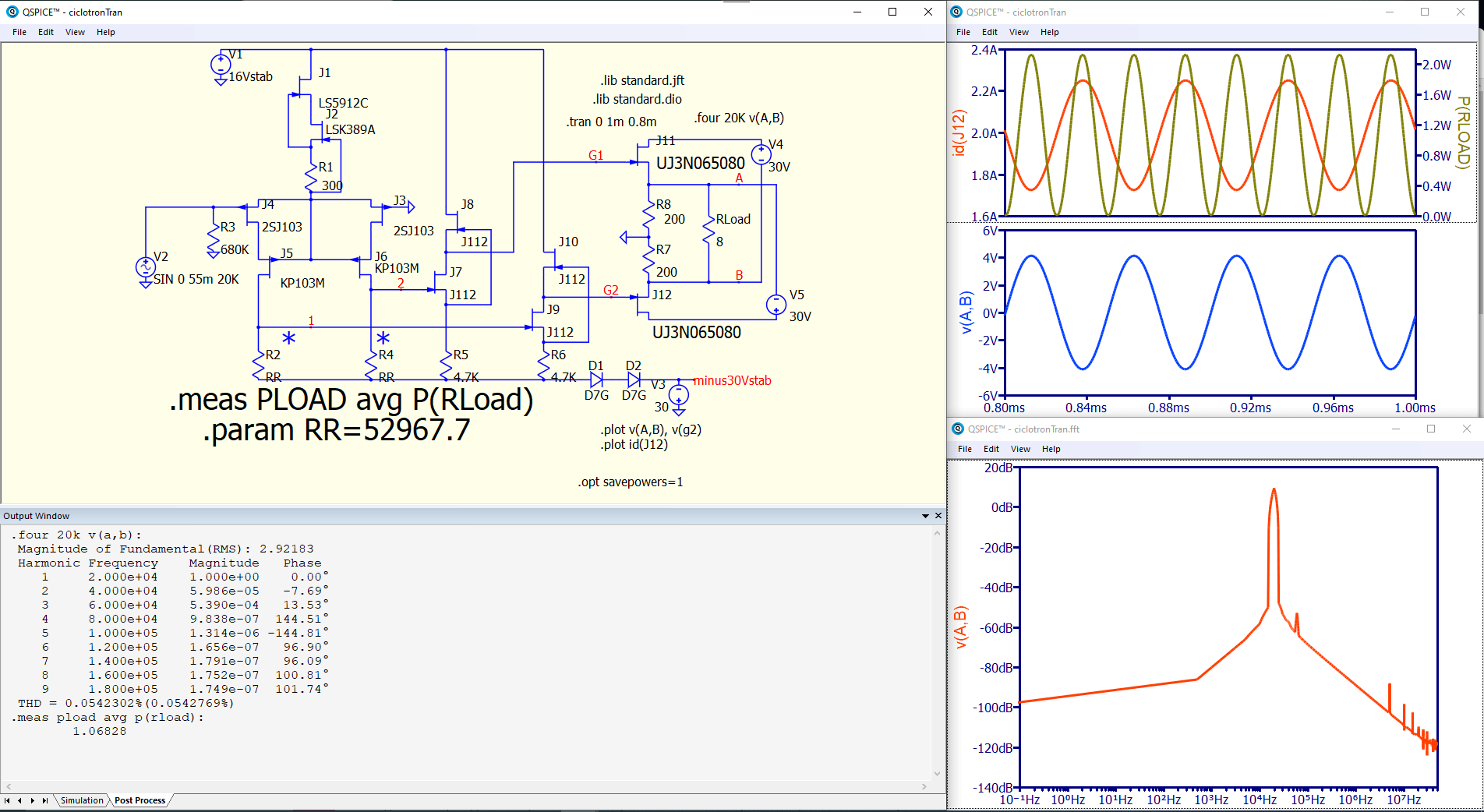

Calculation of the Circlotron on silicon carbide transistors. Operates in Class A without overall negative feedback. In the first calculation, resistors are determined to operate at a current of 2A. Distortions are determined at an output power of 1 W and a load of 8 ohms. Intermodulation distortion is calculated.

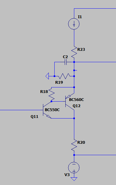

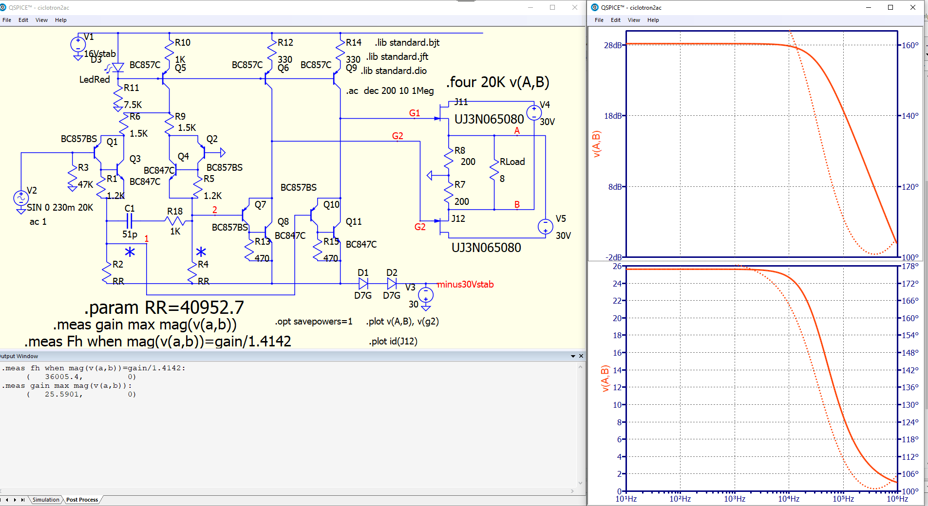

Here is an upgrade of the above scheme using a more accessible element base. The harmonic coefficient compared to the circuit on all-field-effect transistors is five times less.

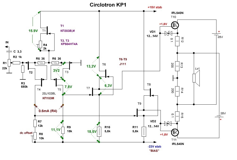

Probably, the decrease in THD depends on the introduction of local feedback in the differential cascade (R6, R9 - 1.5 k). The last circuit on jfet looks like this. Great sound! The IRL540N fit well into that circuit. There is also a local feedback R5, R6, but the values of the resistors (36 ohms) need to be selected at a minimum of THD.
P.S. The BJT circuit is just a simulation. It was not collected in hardware.

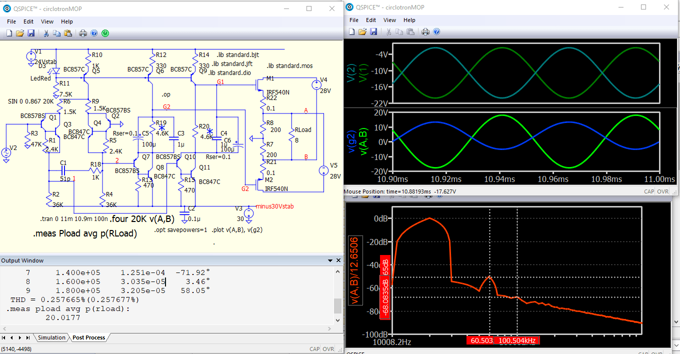

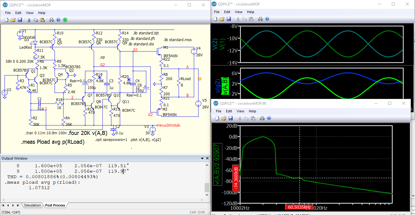

The problem of setting the offset on the gates of MOSFETs has been solved. Coarsely can be adjusted by changing the value of the resistors 4.6 kOhm. Fine-tuning by changing the negative voltage of the stabilizer.
Hi Sébastien! I took these works in the simulator here:
https://kazus.ru/forums/showthread.php?t=122489

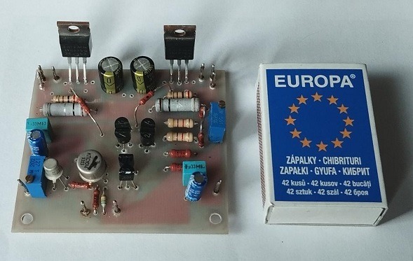

I assembled this circlotron on the BC547/BC557, but the frequency response of the differential cascade is linear only up to 12 kHz. And I don't know where the reason is. But the maximum amplitude is 16.5 V. Maybe you need to change the circuit ... You laid out an interesting circuit. Can you see in more detail?

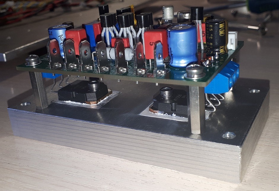

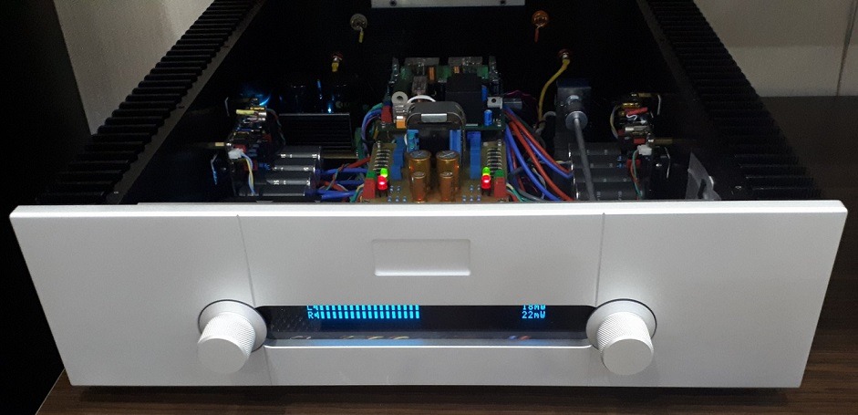

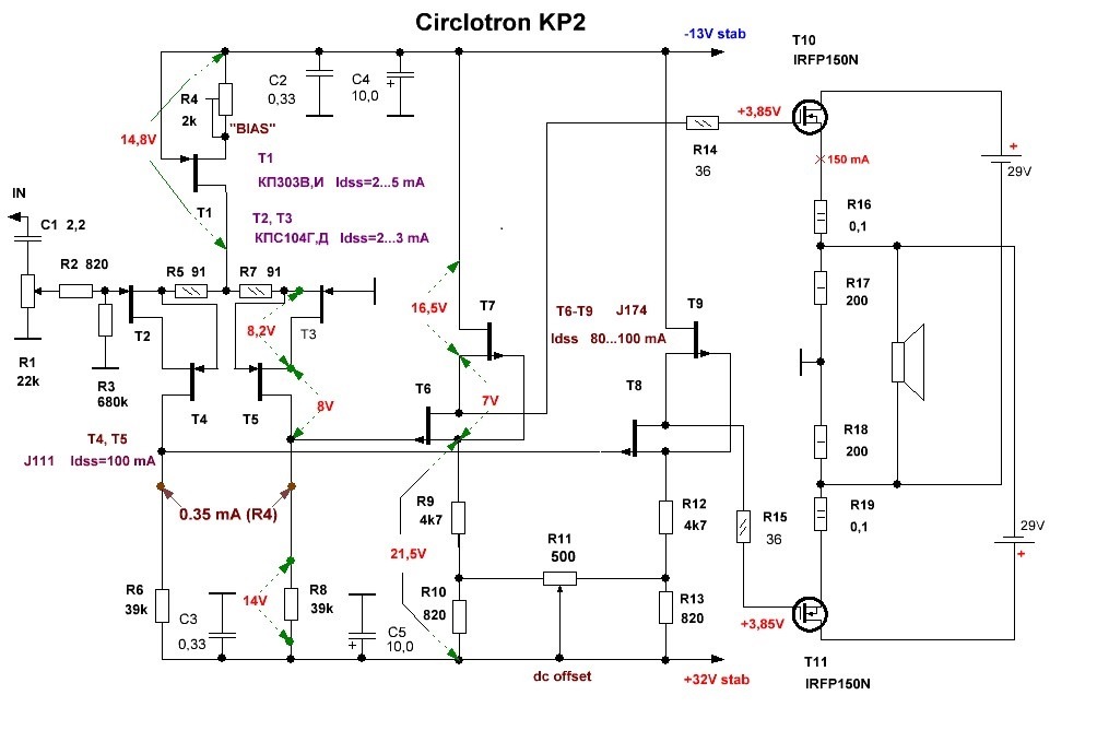

I have settled on this circuit of KP2. I've been listening to music for a few days now. The sound is excellent. On large radiators, the output stage current is stable. Due to the local feedback of R5, R7, there is less distortion. The output stage is powered by a switching power supply.
The current of the output stage is tuned to R4.

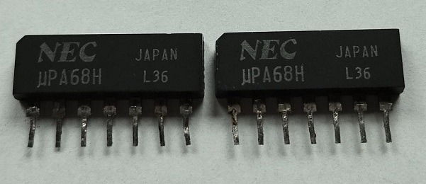

I took out the UPA68H from the non-working Sansui amplifier. The initial current is 2 mA. КПС104Г can be replaced with UPA68H. At first, I used mosfets IRFZ46N (Umax-55V). The sound was excellent, but the power supply to the output stage was 30V and in one channel the mosfets failed. I had to replace them with IRFP150N. Their capacity is twice that of IRFZ46N. And the sound got a little worse. I was too lazy to disassemble the pulse source and unwind the turns of the transformer.
