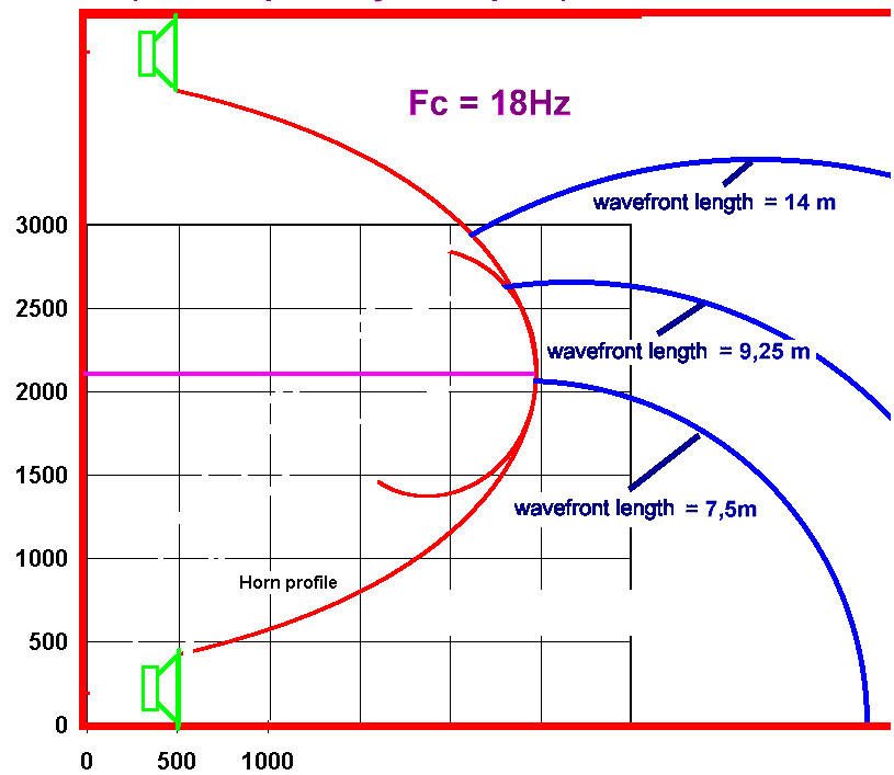

Bass horns are good examples to illustrate the "tuned pipe" effect of truncated horns. I am aware of that and that's why I recommand bass horns as in the attached file.
These are few examples:
http://img383.imageshack.us/my.php?image=dsc30511280x768ac0.jpg
http://www.diyaudio.com/forums/attachment.php?s=&postid=1770740&stamp=1236807427
(The best bass I could listen to was delivered by that "Le Cleac'h" bass horn built by my friend Frédéric Lebas)
Those 2 examples will still show some diffraction due to the upper edge of the mouth but that one
http://ndaviden.club.fr/pavillon/exemples/front.jpg
will have less due to its height quasi equal to the height of the room.
One advantage of using the total width of a room for building such horns is that the quasi cylindrical wavefronts can develop gently very far from the throat (see attached graph). The amount of reflected energy as I could see on pulse measurement of the second horn is low.

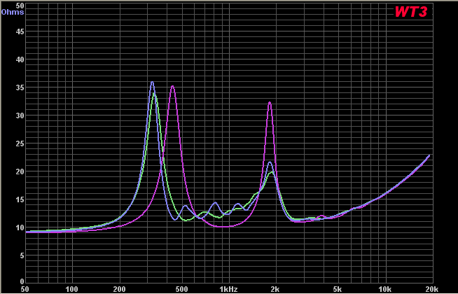

Speaking of impedance in horns, here is a graph just for fun. My measurement of the same 1" compression driver with 3 different loads.
Magenta line is the driver unloaded (no horn)
Green line is a homemade roound Tractrix horn. Mouth diameter ~10"
Blue line is the same driver on an Altec 811b horn. Note the midband ripple.
I couldn't seem to find it, but I did have a measurement of the 811 horn with a roll-over added to the mouth. It was smoother.

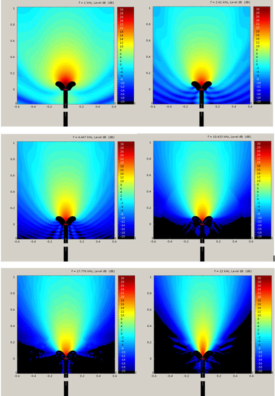

After many tries, this is about the best I can get. It does seem that a more conventional baffle edge diffraction control scemes would be more promissing though.soongsc said:
Jean-Michel, Thanks for pointing this out. Looking at the dimensions, I was wondering the same thing. I just need to figure out how to do it with this software. Right now it seems like extending the horn so that the baffle is far away from the lip is the only alternative, so I may just put the horn 1 meter in front of the baffle.
Here is a comparison among the various positions involving lip shape.
As expected, it seems that out in the open will widen up the beam. Also, it seems that the small radius lip really creates ripples in the response, which is quite expected in terms of edge diffraction. The actual wave guide built just brought the sides staight back tangent to the lip. So it would be interesting what measurements would look like.

Hello Jean-Michel,Jmmlc said:Hello Soogsc,
As long as you'll not solve the problem of the reflective boundary (lower horizontal edge in your graphs) it will be difficult to separate the artefacts due to reflection on that hard boundary from diffraction at the mouth.
About the baffling what I think is that it will be harmless only if it is infinite. Finite baffling of horns or waveguide is IMHO a twisted solution. (When I see waveguides with 1 or 2 inches baffling I smile...). How large is the baffle do you plan to use?
If you know that width, then you'll have to simulate the finite width baffled waveguide in the same conditions as the one with rolled back lips that means separate from 1 meter of the lower horizontal reflective boundary.
(Most probably the software you use may accept that you change the property of the limits of the area simulated. Please, check.)
Best regards from Paris, France
Jean-Michel Le Cléac'h
I think you are correct. However, the best this software can do is to position the baffle so that it's like a wall. Additionally, I think simulation will never be perfect. So what I intend to do is just move the baffle around and see how the artifacts change. The further back I move the baffle, the more time it takes to run the sim. Currently I try to compromise the setting so that it will finish in about 24hrs. I have not yet found a way to change the property of the boundary limits at the baffle.
Another thing that is limiting is that this software will only do axisymmetric sims. So if I want to do a non-axisymmetric design, then I will just have to make an educated guess.
Currently it's driven using a concaved dome tweeter. The study started in the Geddes thread, so if you are interested please go there; I think I started this on page 81. Part of the throat uses an OS type expansion, and part of the extension uses a LeCleach type expansion, if I remember correctly, T=1.85 and Fc is 800Hz. Then there is a section that combines the both into one smooth curve. There is no way to spec this design except adjusting the curves to obtain certain soothness in response with a controlling the beam to see what seems to be a good compromise between HOM and directivity. When something looks promising, the some test measurements and listening. The OS type throat is necessary for high frequency beam width, but the LeCleach type expansion is necessary to control beam pattern prior to cutoff.sqlkev said:
