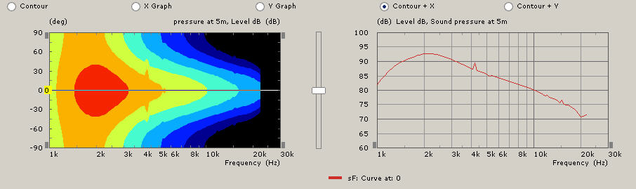

After numerous simulations, it seems the last post has the smoothness of dispersion. If I try to increase compression using a smaller thoat, a little more HF dispersion is accomplished, but at some frequency there will be a sudden unsmoothness in a very narrow frequency band. So it seems the right amount of compression for a particular horn guide if important. I'm not sure whether there is any mathematical way of estimating the right match without numerous simulations or not. The LeCleach expansion of T=1.9 seemed to provide a good control at the mid frequencies before limited by the mouth size.
Below is a dispersion contour. Some small gliches still show. The drop around 20K is really great because this is where the driver breakup is.

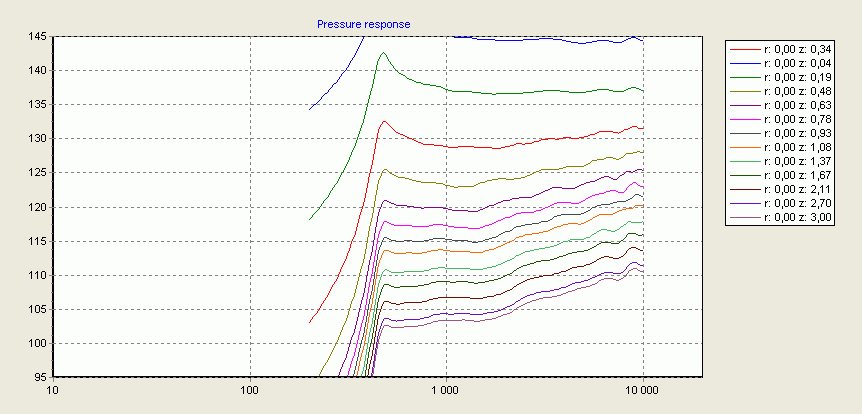

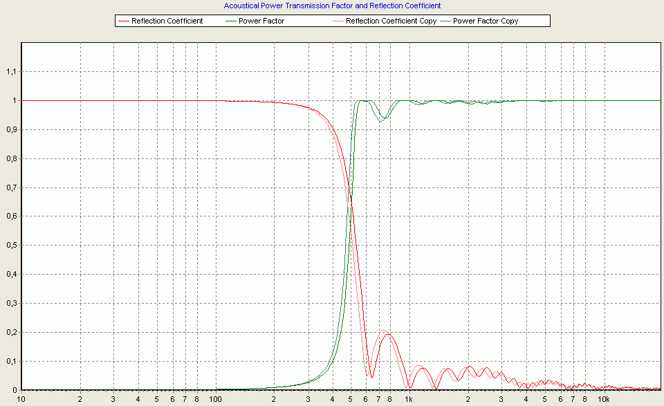

All of the BEM's and Power Factor data is from Bjorn Kolbrek, and was used extensively in the development of the AH425. Here's an example that was made in May of 2008, showing 440 and 420 Hz horns with a T ratio of 0.707 and the Altec 288B compression driver. As you can see, they are similar, but not identical.
I should mention I was never trying to get maximum bandwidth from the horn system, but low IM distortion, maximum headroom, and freedom from internal diffraction, reflection and multipath. This points away from commercial PA or theater horns with nonuniformities (kinks) in the expansion, and made me wary of sharp boundaries at either the driver/throat interface or between the mouth and free air. These boundaries are troublesome enough in direct-radiators, and seem to be far worse in horns.
Since I was confident of the performance of the direct-radiator woofer (which is in piston band at 800 Hz) and the supertweeter, the region of greatest interest was between the LF limit of the driver and diaphragm breakup/phase plug cancellations at the top of the range. My own experience with direct-radiator tweeters and horn systems is that trying to "stretch" the LF bandwidth is a bad idea - distortion skyrockets, and listening fatigue goes way up. That's why the Ariel uses a Scan-Speak 9000 tweeter crossed over at an extremely conservative 3.8 kHz, for example. I just don't care for the sound when it is crossed over any lower. Same with horns. They sound good when used conservatively, not so good when trying to "stretch" bandwidth.
A flat power factor means the power is going where it belongs - out the horn. True, it says nothing about reflections, diffraction, and HOM's, but it does show if the diaphragm is seeing a resistive and "stiff" air-load. This keeps distortion down, one of my primary goals in the critical 800 Hz to 3 kHz region, where distortion reaches peak audibility.
It was JMMLC in private communication with Bjorn, Martin, and myself that mentioned that group-delay problems are indicated by deviations in the PF curves. This was news to me; it hadn't occurred to me that horns could have sharp GD deviations at the bottom of the passband. Since a complex GD deviation is nearly impossible to correct in a passive crossover, that had my full attention.
As a result, Bjorn, Martin, and I tried various iterations, balancing overall size, smoothness of PF and frequency response at a range of distances and emission angles, over a period of several months before settling on the AH425. The latest spreadsheet from JMMLC incorporating information about the internal construction of the compression driver also assisted in the modelling program. I thank Bjorn for providing detailed information on the internal throat of the 288 - that's not available from any Altec website.

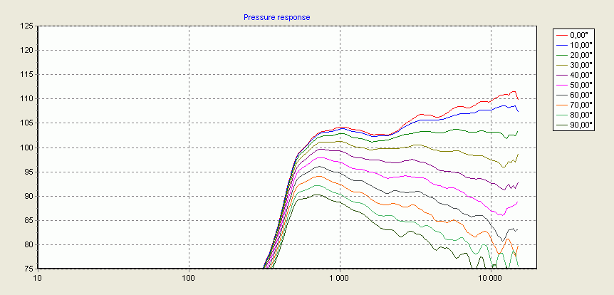

Here's one of the reasons we didn't build a T = 1.34 version; this shows frequency response at emission angles from zero to 90 degrees off-axis. It looked fine in the BEMs, nearly indistinguishable from the T = 0.707 version. But the FR would be non-trivial to equalize.
The models presume theoretically perfect drivers; real drivers are worse, frequently much worse. Combine the two sets of responses, and you can start to see why 1/3 to 1/6 octave response smoothing is so common in the high-efficiency world.
