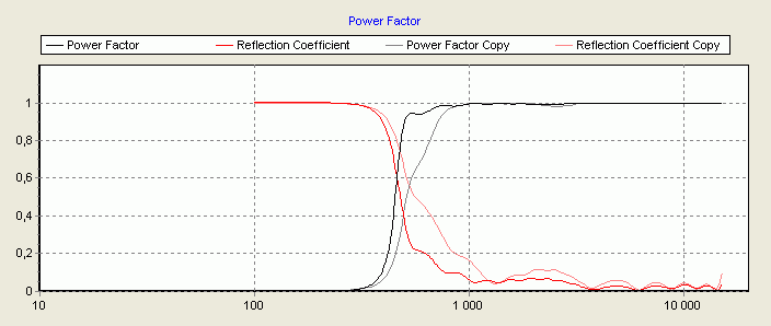

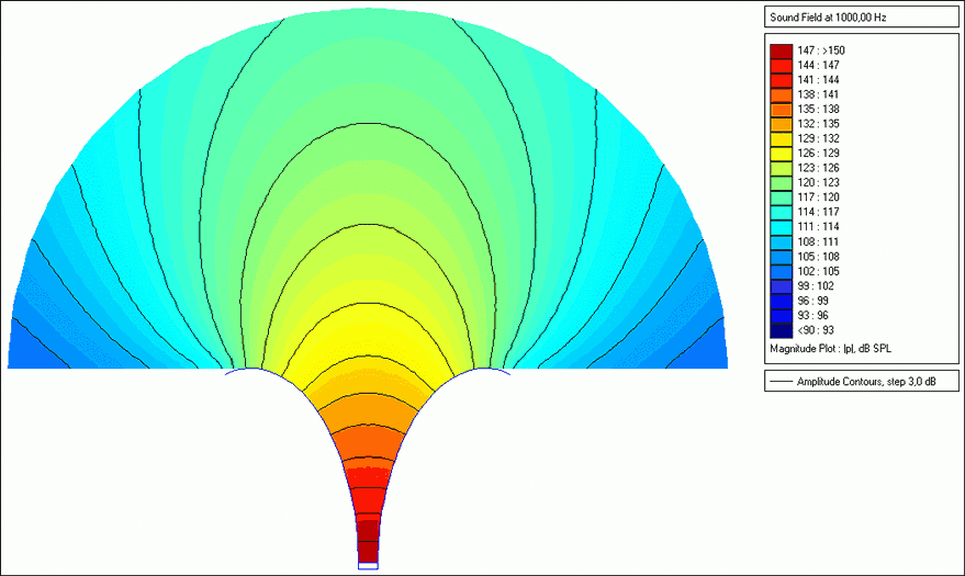

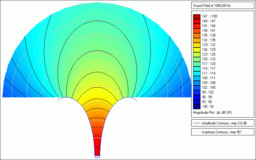

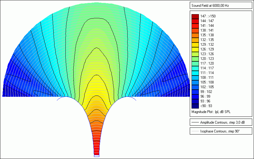

Now that we have a new thread, here's the latest BEM eye candy from Bjorn Kolbrek in Norway. The first example you've seen before in the Onken thread, it's an AH425 with a 288 driver - cutoff frequency 425 Hz, T = 0.707, 1.4" exit diameter and 8 degree flare from the compression drive. Phase plug HF cancellations and diaphragm breakup are not simulated.
The AH425 is a 16.5" wide horn with a nominal 425 Hz cutoff, and usable (resistively loaded) frequency response down to 550~600 Hz. In practice, a 800~900 Hz crossover is recommended to avoid the region with sharp group-delay variations.
BEM at 1 kHz:
BEM at 1 kHz:

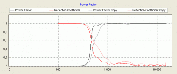

Now this is where differences start to appear. The graph shows the power factor of the two horns. The heavy lines are for the standard AH425 with a T = 0.707, and the thinner lines are for the T = 1.34 version.
The red lines show power reflected back to the diaphragm (as a percentage), while the black line shows the power radiated into the room. (Similar to SWR of an antenna.) Ideally, the load on the diaphragm should be purely resistive in the audio range for maximum power transfer and minimum reflections. It was JMMLC in private communication that made the connection between resistive loading and a smooth group-delay response - something I had not considered before.

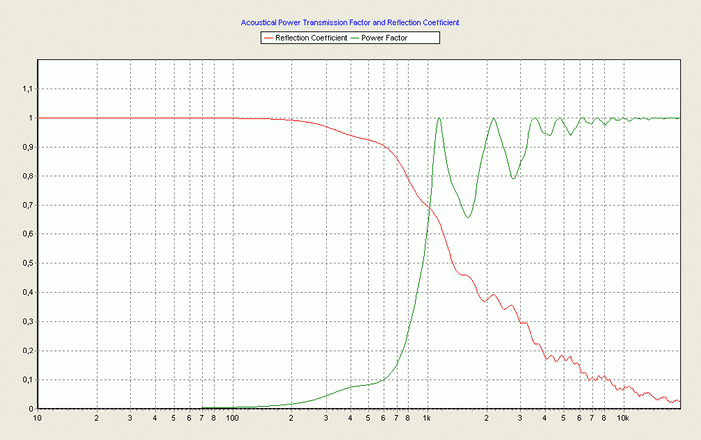

For another power factor comparison, here's a comparable-size conical horn (with no radiused edges on the mouth) with a 288 driver. The red line is the reflected power, while the green line is power radiated into the room (as a percentage). As before, these are idealized drivers with no departure from flatness due to the phase plug cancellations or diaphragm breakup. Most of these departures, though, happen at the top of the audio range, where the power factor comparisons between different types of horn converge.

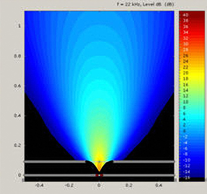

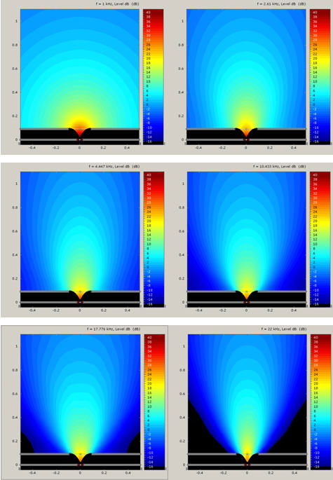

Soongsc, more data is needed. It would be nice if the pictures weren't so tiny (being able to read the frequency would be very useful), and there were 3 dB plotlines on the contours to get an idea of the actual magnitude of the falloff with angle. JMMLC horns are not constant-directivity, so the degree of falloff is useful to know.
Without magnitudes, frequencies, knowledge of the horn profile, or diameter of the throat, the pictures don't convey much information. If the simulated driver is a physically unobtainable compression driver with zero throat length, that alone throws off the simulation.
If you have access to the original data, I'd take advantage of the DIYAudio 1000 x 1000 pixel limit and post them one by one.

Well, I abused the images in Photoshop and Genuine Fractals, and this was the best I could do. At 3X enlargement, the horn appears to have zero throat diameter - although that would certainly give nice HF dispersion (at 22 kHz!), it would also seem a bit unrealistic.
No apparent throat depth either - is the compression driver assumed to be a point source? That might be valid for an Ionovac or the Acapella ionic driver, but for physical compression drivers with physical diaphragms ...
