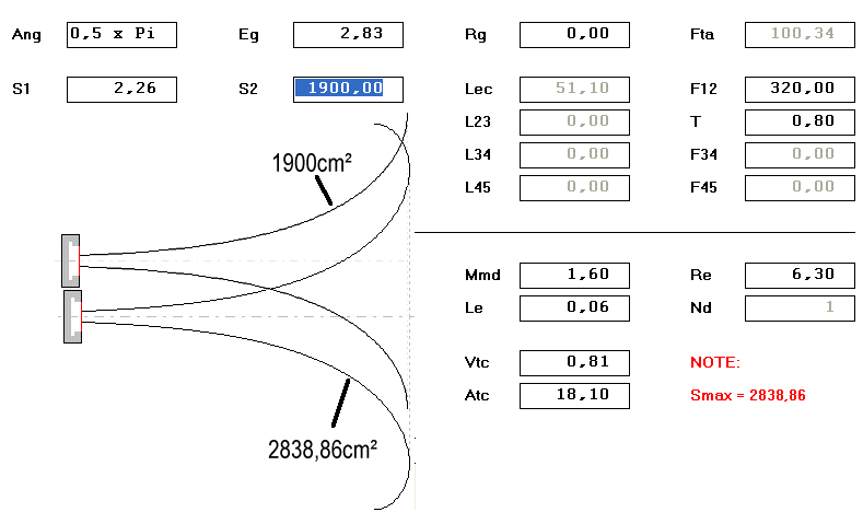

Does the program Hornresp schematic diagram for the LeCleac'h horn correct?
I don't see the mouth's profile in my diagram
did i do something wrong? or is it something to be implemented later?

Hello sqlkev,
Yes ,Hornresp, thanks to David McBean, has the right profile for a Le Cléac'h horn.
In the input window, when you enter whatever value for S2 while designing a Le Cleéac'h horn, you'll have in the right bottom corner a note in red indicating the max value for S2. This value corresponds to the value of S2 for a horn the mouth angle of which will be 360° (tangentail angle of 180° versus the axis of the horn).
As an example see the screen copy I attached for a Le Cléac'h horn having Fc = 320Hz. The S2 value I entered is 1900cm², this leads to an incomplete profile the mouth angle of which is around 180°. You can see that the red note indicate that the max value for S2 is 2838,86 cm². So you may enter that value in order to have a complete 360° profile.
You'll see superimpsed on the graph the sketches of the 2 horns, one with the incomplete 180° mouth and the other one with the complete 360° mouth.

Jmmlc said:In the input window, when you enter whatever value for S2 while designing a Le Cléac'h horn, you'll have in the right bottom corner a note in red indicating the max value for S2. This value corresponds to the value of S2 for a horn the mouth angle of which will be 360° (tangential angle of 180° versus the axis of the horn).
Hi Everyone,
Just to add to Jean-Michel's comments, and for the sake of completeness - Hornresp actually has two information messages relating to the mouth size of a Le Cléac'h horn.
The first message is displayed when S2 is less than the mouth area required for a horn having a flare tangent angle of 90 degrees - the value of S2 required for Fta = 90 deg is displayed.
The second message is displayed when S2 is equal to or greater than the mouth area required for a horn having a flare tangent angle of 90 degrees, but less than that required for a flare tangent angle of 180 degrees - the value of S2 required for Fta = 180 deg is displayed.
The example given by Jean-Michel refers to the second message.

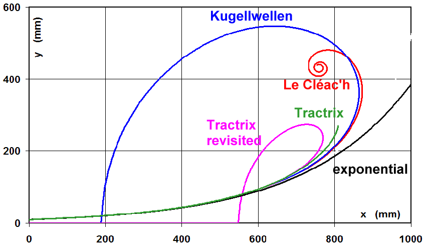

Hello Angelo,
Well that's dificult to have the same driver and cut-off frequency for such comparison.
Here in France most of the DIY tractrix horns have a square mouth.
Some horns are also modified tractrix (they use some curvature back at the mouth.
I used to listen a 2 inch compression driver on a large Avant Garde modified tractrix horn (with a throat adapter) and it was excellent, even if the Le Cléac'h horn succeed in giving a better 3D sound image.
So I'll never say that the Tractrix are bad, they are not.
Remember also that using my spreadsheet to calculate a horn having an exponential expansion the obtained profile is quasi similar to the tractrix profile on more than 80% or 90% of its length (but the mouth, so important IMHO, does the difference).
The mouth of the Kugewellen horn is more similar to the one of a Le Cléac'h horn (see attached graph)
Best regards from Paris, France
Jean-Michel Le Cléac'h
