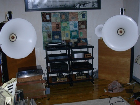

This is Azura 204 Hz Le Cleach horn on the top of a K-Horn (lowther Dx4). 10.5 ' wall to wall. And a small 550 Hz behind it. Room is to small for such setup therefore I sold Lowther and now use Azura as a low mid horn on the floor untill I build proper midbass. I stucked temporarily Tad Tm 1201 to see what it does (it starts to turn in at 300hz) Nothing is optimized (as usual😉 but I'm telling you that midbass, low mid horn is essential for horn playback.
The question would be if I get the same spatial,relaxed presentation with 80 Hz Hypex (0.7 quarter space) horn with 7" throat in a 80-500hz range??

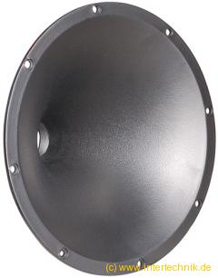

This cheap waveguide below ought to be easy to modify with throath smoothing and curved mouth, or at least smooth transition to baffle
Might even be used with small fullrange

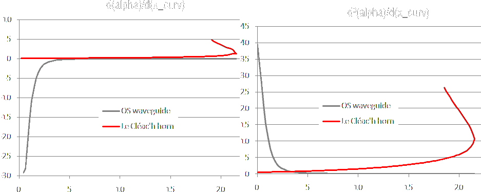

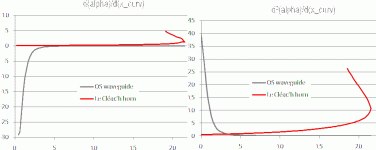

Hello,
According to Earl Geddes the production of HOMs is related to the derivative of the profile of the waveguide (or horn) and more precisely to the second derivative.
You'll find in attached file compared curves for the OS waveguide and a Le Cléac'h horn showing along the axial distance, the evolution of the first and second derivative of the slope angle of the profile versus the curvilinear distance to throat.
As we can see both 1st and 2nd derivative have greater absolute maximum values near the throat with the OS waveguide when for the Le Cléac'h it is at the mouth.
For what its worth... ;-)
Best regards from Paris, France
Jean-Michel Le Cléac'h
