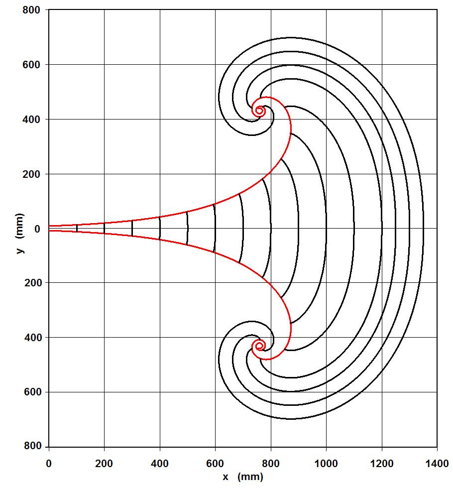

Hello Bear,
From what you wrote I can see that there something that probably I didn't clearly explained.
In fact the Le Cléac'h horn doesn't possess any lips! I mean there is no lips "added" to the mouth as it is necessary to do in a waveguide or a conical horn in order to reduce diffraction at mouth.
What you and other call lips are in the case of the Le CLéac'h horn is purely the result of the natural combination of:
1) the expansion law of the area of the wavefronts (e.g.: hypex, exponential)
2) the necessary parallelism (= equistance) of the curved wavefronts (defined as equiphase surfaces).
When calculating a Le Cléac'h horn, there is nothing special in my spreadsheets or software related to the curvature of the mouth. The curved back mouth is not intended nor provoked, it is the result of the "design by nature" of the horn.

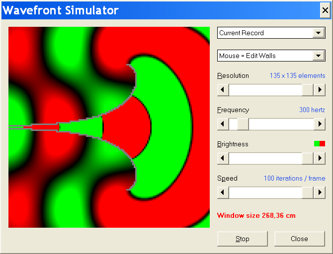

Now on the point of baffling against rolled back mouth. If we stop the profile of a Le Cléac'h horn when the opening angle becomes 180 degrees and if from this point we decide to add an infinite baffle, we introduce a perturbation of the expansion law. This perturbation induces a partial reflection of the wave energy back in the horn and have effects on the acoustic impedance curve, and therefore on both the response curve and the group delay curve and on the pulse response (waterfall, CSD...). Those effects will be more efficient in the low frequency range of the response of the horn.
That's why I prefer to use unbaffled Le Cléac'h horns the mouth of which open at 360° minimum (Hornresp allows a max profile tangential angle of 180° so an opening angle of 360°).
You may see in attached file a theorical graph of the wavefronts I calculated. Elsewhere in the thread you can compare to the simulated pressure field at low frequency.
Best regards from Paris, France
Jean-Michel Le Cléac'h

bear said:J-M,
Been following along with this thread.
I am unsure of some of the things I am seeing and reading.
Regarding a "lip" or "radius" that extends past the point of being perpendicular to the main axis of the horn...
Are you saying that the lip of the horn is best terminated by a large fat lip of considerable size? Did I see a curve where the outer edge of the lip is brought all the way back around to the rear of the horn?
If this is correct, what role does are area that intuitively appears to be unrelated physically to the wave that is launched have?
I think I am seeing that there is a suggestion that terminating the horn to a flat large ("infinite"?) baffle has benefits... are we talking after a curve/radius of some dimension has reached the point of being tangent to the plane that is perpendicular to the main horn axis? Does a larger flat baffle "work" with a "lip" that extends back past this plane (that being the "front of the mouth" where the curving horn mouth meets it)?
And, are we then saying that almost any horn expansion might then benefit from an arbitrary "lip" of sufficient dimension? And, then what is the relationship between the "lip" dimension and frequency/wavelength?
Hope I am being clear enough...
_-_-bear

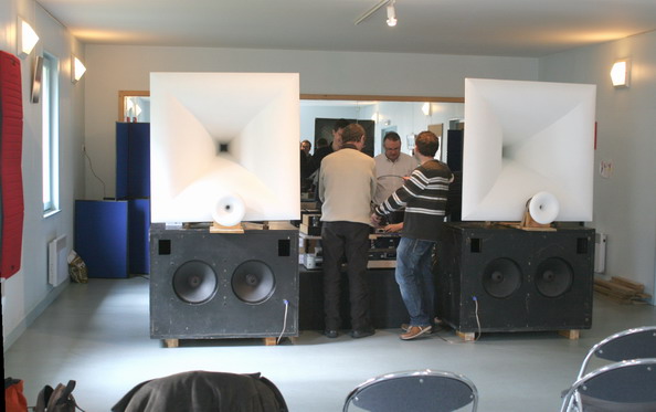

Hello Angelo,
I only attended to the listening session organized by the association Mélaudia on Sunday afternoon.
The public seems to have appreciated the large Le Cléac'h horns with their square mouth. We finished to crossover them at 18dB/octave at 316Hz (high-pass) and 4190Hz (low-pass)(both using Butterworth cells, applying my alignement/crossover method but without much measurement capability).
It was one of those rare days at Mélaudia during which people listened to music in silent (without much discussions). A proof that the music was not injuried by the system.
I am generally more critical in my comment that most people at Mélaudia and I found that the 3 ways system was very homogeneous but suffers from a bad set up.
One thing that puzzled me was the lack of progressive adaptation between the round throat of the Radian 950 compression driver and the square throat of the horn. This is a main source of diffraction at the throat and I think that some dirt things I could hear above 2kHz were probably due to this bad adaptation at throat. I found alos that the low mid lacked some presence in the beginning of the afternoon when a 6dB crossover was used and then when we turn the crossover to 18dB/octave the presence was better. A part of the partial lack of presence is IMHO due to the bad time alignment and therefore the bad pulse repsone of the overall system ( I noticed this on the note attack of the piano).
Also I think that the amplifiers were too much different one from the others and it was not the perfect match. The amplifiers were brought by different members of the association and never before they were used together. I did'nt like nor the class D amplifier used in the bass nor the SE KT 88 used for the high frequency range.
An interesting remark is that nobody complain about a too narrow directivity in the mid high frequencies (more than 20 persons were sitting in the listening room at 4 to 8 meters from the loudspeakers).
If you can have access to the following page, there is more discussion in French about that weekend at Mélaudia forum:
More http://forums.melaudia.net/showthread.php?tid=622

Hello Bear,
It is often surprising as in a horn having a very continuous profile as the Le Cléac'h horn, the wavefront is able to drag (is it the proper word I don't know) along the wall until very large distance front the throat before to "lift off".
At low frequecny this effect is more pronounced than high frequency and the wavefront, as it expands, tends progressively to acquire a bubble shape and therefor a part of it is oriented backward.
This description is probably very bad (due to my lack of english vocabulary in various domains) so you may better give a look to the attached graph which one results from a simulation under Hornresp. On other simulations as
http://www.diyaudio.com/forums/attachment.php?s=&postid=1762170&stamp=1236072228
we can see that at high frequency (6000Hz here) there is still some pressure arriving at the edge of the mouth even for opening angle larger than 180degrees and this induces diffraction
Using opening angle larger than 270 degrees and if possible 360degrees is what I recommand, but unfortunately, most builders of Le Cléac'h horns stop at 200 or 220degrees.
The frequency response curves for Le Cléac'h horns without any filtering and crossover are pretty linear until the acoustical cut-off of the horn. But the phase rotate very quickly at frequency near the cut-off and this is equivalent to have a progressive delay of the lowest ferquencies.
For complexe signals as musical notes the fundamental or first harmonics of a note will arrive later than the upper harmonics and this will be audible (the timber will be different but also some people can feel as if the geometry of instrument was a bit strained or unatural).

Thanks JM,
nice to see the Onken W cassions in action. Ca me fait de bons souvenirs. 😀
Those horns are, umm.... not small! They seem to have been well liked. So how are those big Radian drivers? They did well? I ask, because I just bought a pair of used Radain 1.4" drivers (at a good price). Hope they sound good.....
What was the driver on the treble horn?
From reading the posts on the Melaudia forum, it seems like you guys need a better treble amp. =) And I didn't know the Bryston was class-d.
Quite a system.
Quite a system.
