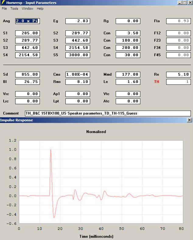

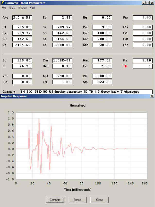

BP1Fanatic: in the Hornresp Input Parameters (Post #193) you have Ap1 and Lpt as 0.00. This is obviously incorrect, even if Hornresp doesn't lock up on it; Hornresp should probably flag this and not just insert some nominal values that may or may not have anything to do with the model. The throat chamber, and the transition form the throat chamber into the horn propper, will affect the Hornresp impulse response quite severely, and should be modelled accurately.
No problem tb! Where are Ap1 & Lpt discussed in detail regarding TH's? I do recall seeing a thread where there was a pic of a ported chamber TH in Hornresp.
I just read Hornresp Help. It states that if Ap1 = Atc, then no inputs are needed for Ap1 & Lpt.
TB46, can you explain this impulse response that goes with post #193?

From my limited understanding the impulse response is just another way of looking at the frequency response, and maybe that's too simple. I have not seen any measured impulse response graphs for a tapped horn done, and explained by, for example DSL. Most of my time spend comparing the transient responses for a given speaker in closed/sealed boxes, bass reflex enclosures, horns, tubes and tapped horns has only been on paper, and mainly in Hornresp. I spend a considerable amount of time listening to different loudspeaker designs in the 1970s, and developed a clear preference for sealed bass enclosures.
You may already be familiar with one of the better articles about the subject of measuring loudspeakers, if not I highly recommend it and its sidebar on the FFT: "Measuring Loudspeakers, by John Atkinson, stereophile.com/features/100/#". At least it seems more accessible to me than some of the more scholarly mathematical dissertations you can quickly find with the google. Also, John Atkinson points out the problems associated with any of these measurements and computations. He even delves briefly into "panel vibrational behavior" which may well be the answer to a large part of the fortuitous 3dB hole filling performance in screamerusa's furyboxes SPL response (that, and the throat/initial horn section treatment).
Once upon a time in the "collaborative TH thread" we tried to get an idea of how the TH-115 may be folded, and even though we never arrived at any particular solution I ended up with one that had what I would consider a reference impulse response for a tapped horn. When I add a small throat chamber to the design the frequency response is only slightly affected, but the impulse response looks really bad. Apparently the chamber resonances mess up the impulse response.
It would take much more time for me than I have available to form an educated opinion on the merrits-or cause-of this or that feature in the impulse response of a tapped horn, but maybe this example explains why I don't have any real opinion on the subject beyond considering something like the TH-115-Guess impulse response desirable.
Hope this helps,

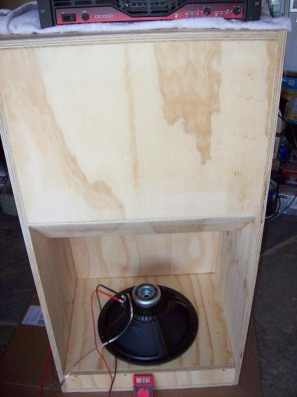

oliver:
update on my 24x24x48 box.
It was a little windy today, so I did 5.6, instead of 2.8v measurements. I did all kinds of baffle/no baffle trials, and still couldn't get rid of the NASTY 100hz null... I mean it falls off a cliff at 100.
I tried a shallow baffle at the bottom/back, and that really helped the 80-90hz....
Without a 45 degree baffle either top/front or top/back, I get a stuffy 70hz sound, and about 1.5db extra at 50hz. It's worth the trade off to lose a little 50hz to get a clean 70hz sound.
I don't really care that this sub falls off a cliff at 100 because of the way I plan on using it, but do you have any idea where I could try to change something to lessen it?
The following is with a shallow baffle at bottom/back, and a 45 degree top/back, no other bracing.
5.6v @1m

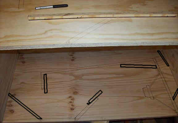

Hi jbell,

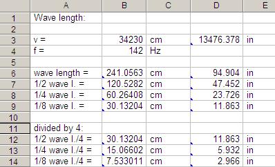

Thanks for the additional information. Those are really very impressive measurements. Even without knowing the exact dimensions, when you have a 1:2 ratio for the side dimensions there will obviously be a few common length.
I had that shallow baffle in my drawing for the 24x30x48 box, did you use a similar angle/size?
It might help to shorten L12 as much as you can, that gets rid of one 23.5" section. Your experience with the top/front or top/back corners kind of matches what screamerusa experienced with his furybox, but he lost something when he filled in the top back, so maybe top front is the place. You could even try an oversized 45 degree baffle in that corner.

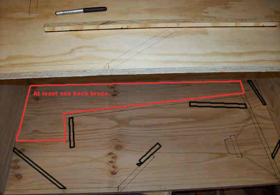

Did you brace the large back/duct area?
I would start with the S1-S2 area, according to the simulations: in most cases, the shorter the better.
Well, hope some of this helps.

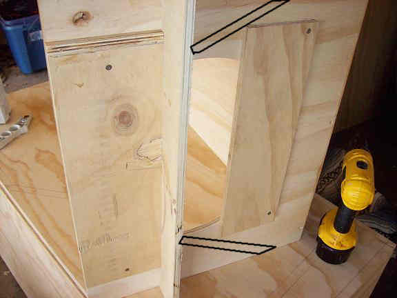

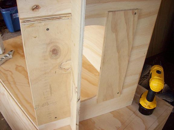

I expected some standing waves up around 150's, but not at 100.... that freq vs the dimensions I have intrigues me.

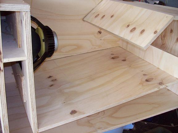

Here's some pics showing my shortened L12. I'll play around with it some more tomorrow. I didn't break in my 3015lf before measuring, and I know once done it changes things.
Right now I have a solid 102-104db from 45-95, and that's sufficient for my current need, however... that's a pretty narrow range... really need another half octave minimum.

absolutely I will put in braces oliver. However, for 'playing' purposes, I left them out.
Wind is lower today, I got to do a 28v test, 120-122db@1m from 45-95Hz. And yes panels were vibrating and leaks were happening, so it doesn't quite line up with my 5.6v tests. I think it's time to wrap this test up and get out the glue. I was really hoping for a quick one build day, 1.5 sheet cabinet that I could use for general purpose reasons.
I put the 'wings' in, but it didn't make that big of a difference. Biggest difference was the small bottom/back reflector. Scott did a 11x6 opening, I did a 14x4, so I'm guessing the wider opening made the s1-s2 side reflectors less useful. (which was my guess, and why I did the wide slot in the first place)
glue tonight, paint tomorrow, install friday... these gotta go. At least I learned a little this time, instead of repeating what I've done before.
