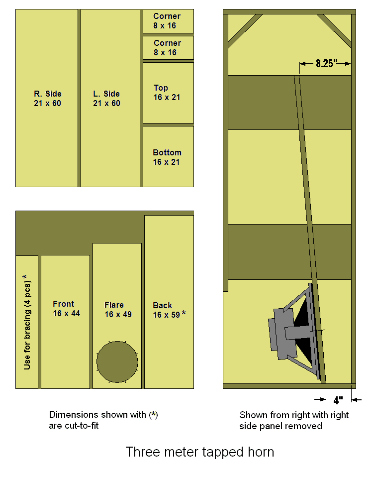

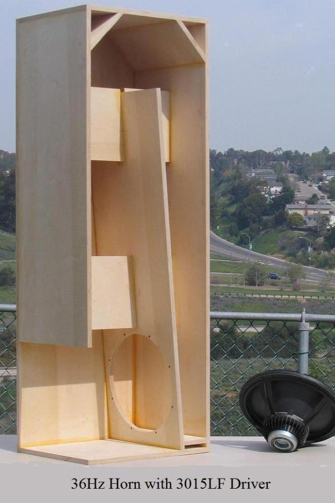

Hi JBell,
After all is said and done, I still think your 600 liter box is the winner. Screamers box looses a little bass, and a little power. It fits his needs,
but I don't think it's better. Your new box (2x2x4ft) likewise looses a
little, as does my early version (attached). It looses almost 3dB.
How does your 2x2x4ft compare?

Hi JBell,
Screamer did recommend I build Jbell's cabinets if only building 2. Does that mean 4 of Screamer's cabinets could keep up with 4 of Jbell's -that would be wierd.
Thanks!

good eye don -- have to agree. 2x2x4 does not = big box.
Scott gets the ability to transport his cabinets, My big box needs to be installed and stay put, or install wheels, a motor, steering wheel, etc.... hey, would that be considered 'bass steering?' (sorry for the terrible joke.)
I think scott nailed what I like about TH's... it's when you wind them up, as he puts it, "they get mean." People's ears (unfortunately) are trained to want to hear distortion on bass at PA levels, and if it's 100% missing, then to the ear something is missing and the bass doesn't sound 'right'. The TH gives just a little of that, so it doesn't sound like anything is missing, like with a FLH. But the key is... it's a 'little' bit, so it sounds a whole lot better than double 18 reflex boxes, and to my ear, better than FLH as well.
So, ben, wind both the T36 up and the big box TH up, and see what happens. If your experience is anything like mine with 4 36" wide T36 vs 4 of the big box TH -- it'll be an eye opener. (here's a hint of what I think you'll find, and why I suggest testing at 28v, not 2.83v.... ProSpeakers Forum - Fitzmaurice Titan 48 - Wayne Parham, October 21, 2007 at 14:31:26) and it's the reason the T36 got banished to the home of 'unfinished projects,' and eventually sold for cost of lumber.

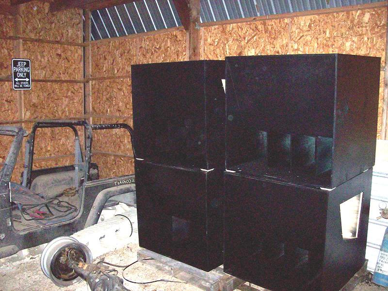

On the OT's... DON'T use the side ports -- yes they are feedback creators. If you are going to build OT's, set port tuning to about 95-100hz (you're going to cross them at 100 anyway) and put the ports in front, kinda like in this picture where I was playing with horn lengths.... I've played with ports deep and shallow in the horn face, and prefer the sound with the ports toward the front. Just make sure the port is far enough away from the side wall, or the port length/tuning won't be what you think it should be... One last thing on tops and spl charts and 2pi space. How many times does that top sit on the ground? Kinda makes sense why tops in the 'real world' have issues keeping up in the 100-200hz range, when their chart says they should be good.
Don't keep us in suspense any longer -- we want to see graphs. I never posted any, because I was sure it would look like I had an axe to grind... The bogus spl charts of the T36 STOOD FOR THREE YEARS UNCONTESTED... and every builder who couldn't reproduce those results must have a leak... blah blah blah. yea, like I would be a trustworthy source of testing.... (thanks pasc for the pics... I've roasted some hotdogs over failed cabinets in the past too...)
