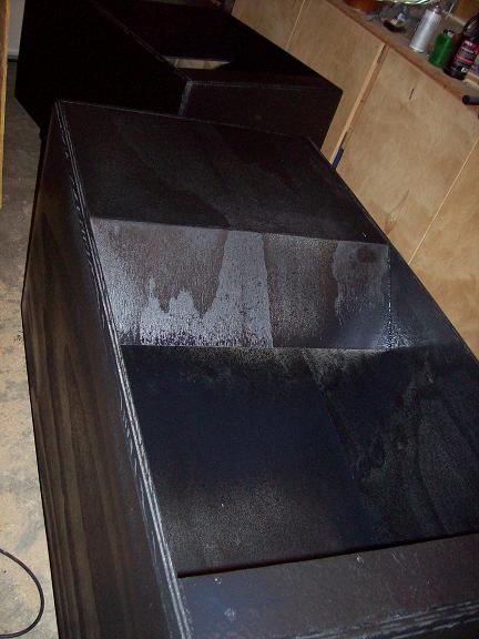

on schedule....
nice wood grain!
I always feel a little sad when I have to cover it up 🙁
Is this just an undercoat, or will you try to keep the grain look/effect?

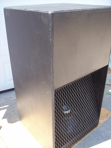

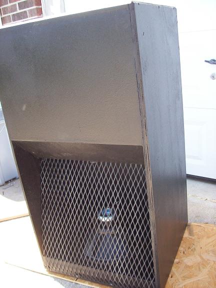

That looks good. Bet it feels good getting this cycle finished. Bye the way what wood thickness(es) did you use?
Oliver:
That's 3/4" 7 equal ply from home depot. It's void free, and I like it, as good as auroco.
I didn't take time to make them pretty -- no one will get within 20 feet of them, but they are kid proof and ready for battle....

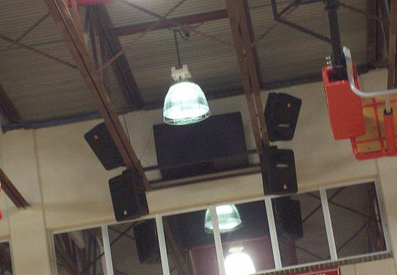

Where are these going jbell?
25 feet straight up !!!
(is this known as 'wall loading?')
and yes, nasty peaveys still sound like nasty peaveys... but now with bass!!
Wall loading
So far up the wall - are you gaining a dB or two from the ceiling too?
That's a very tidy install.
Nice job.

nope, just the 'smoke test' late last night is all I've done. There are identical clusters, end wall and side wall, and a switch to choose which is running. This way they can use the facility length or width wise. The smoke test was just using the built in HP/LP of an older crown ce4000. Acceptable volumes (80's to 90's) were achived at about 4v tops and 12v sub, so the ce sould have more than enough for this.
I was disappointed at first-- one sub sounded great, the other, well thin and ordinary... Then I remembered I broke in the driver/cabinet I did testing on, and the other 3015lf driver was fresh from box. 3015lf's MUST be broken in, and I should obviously know that.
I know indoor measurements don't mean a thing, but if you'd like later in the week, I can run a quick set.
BTW, my back is telling me to build lighter cabinets next time... but for a vibration free install, thick/heavy ply rules.

And Radiant - uh ... look at pic. They are inside
I had forgottten to mentioned I used the same 29.99 ply from Home Depot. I found some voids and it is the first time I have used Pine and probably the last. The China Birch I have been using is only $9 more per sheet. It can take a hammer lick unlike that pine. That stuff dents way to easy. But then again your aren't going to be moving.
Thanks. Missed that pic of 'em up in the rafters.
Thought they were going outdoors...I shall return to the dugout now. 😱

I can't stand home depot ply in general, and that includes the china birch -- at least when compared to lowe's auroco. I'm surprised at myself, I have of late sworn off home depot ply. The $23 cabinet ply that is 7 equal thickness is good stuff -- but heavy. I didn't happen to find a void in my cuts, so maybe I got lucky? Out of pure curiosity, I put a sheet on the scale... 72lbs ! My back was sure there was over 100lbs of ply involved per cabinet, and it was right. (The 9ga flattened steel mesh grill didn't help lighten the cabinet any either... Now that was a redneck adventure getting a 30degree bend..)
