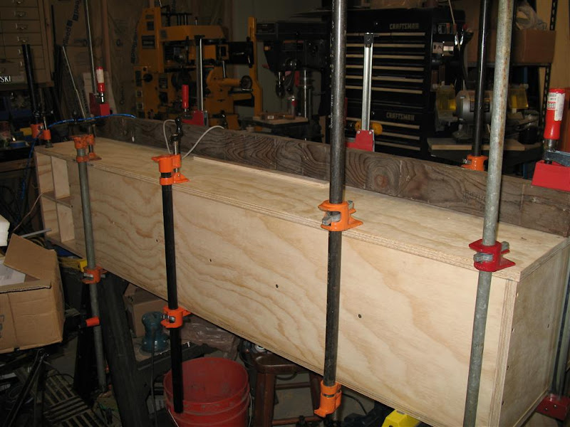

Lest you think you are the only nut - here's the current subject...
Pretty much every clamp I own on there now, still leaks a little, but it is sealed well enough for testing. I used cut nails to locate the panels, weatherstrip to seal the internals.
Maybe you are nuts, but I wish I had a workshop equipped as well as yours! Are you a professional craftsman?

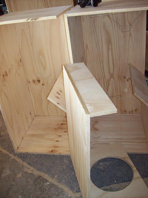

Let us know how this works out for you. Your layout drawing on the wood looks like what we have been talking about; the expansion in the S3 to S5 area looks a bit rapid (?). Anyhow, as I don't seem to find the time to built anything, I'm looking forward to hear about your results.

yea, hornresp says the rapid expansion doesn't help much, maybe a half db, but I thought it'd be worth trying. My plan is to start with no reflectors and no compression, and add one at a time and test to see what pays off and what doesn't. I have a week or so before this pair have to be ready, so I've got a little time to play. My guess is driver compression, angled sides close to driver opening, and a 45 at top/back only will probably yield the best output. My guess is about no matter what I do around the s4-s5 range, it won't make much of a difference. Since I glued the inside vs outside separate, I can move things around a little and vary the taper some. I'll just use window/door foam and screws for a tight seal during testing.
Flip, I'd like to compare this with your 2 cabinets you are building/testing, it'd be a nice comparison, since they'll all have 3015lf's.
Hi jbell,
Looks like you are already most of the way there. Keep in mind the shortened L12 as in Post #155. I did some more simulating, and there is a big difference in the transient response between short and longer L12. Actuall, moving the speaker further down into the throat (you loose a little L23) to increase L45, and simultaneously increasing S5 by angling the speaker mounting board towards the bottom edge of the mouth seemed to also help (but involves more woodworking). Keep the pictures coming .
I'll definitely do a shorted L12, that's a must. My 3015lf's won't show up till tomorrow or friday, so I hope to get some time in before the weekend. I'm cooking easter breakfast for my church, so this weekend is spoken for.

Nope - just an over-equipped and under-skilled amateur with all of it. I just do a lot more than play with subs and speakers, though there are probably 400+ drivers stored out there currently (LOTS of line array / CBT parts included in that count).

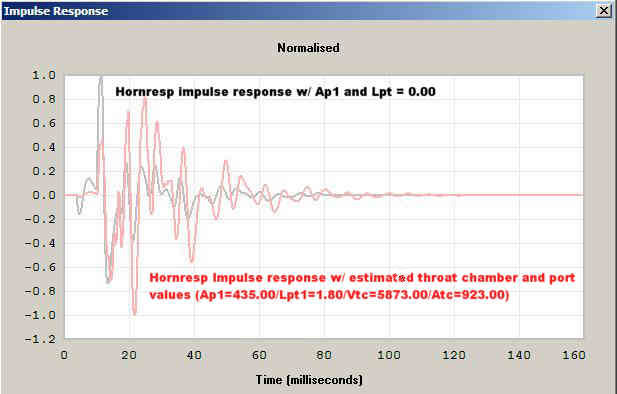

BP1Fanatic: in the Hornresp Input Parameters (Post #193) you have Ap1 and Lpt as 0.00. This is obviously incorrect, even if Hornresp doesn't lock up on it; Hornresp should probably flag this and not just insert some nominal values that may or may not have anything to do with the model. The throat chamber, and the transition form the throat chamber into the horn propper, will affect the Hornresp impulse response quite severely, and should be modelled accurately.
We see the same error in the "postbuild Furybox closer calculation.4015" (see Post #194) Hornresp Input Parameters posted on screamersusa's transfer page. There we'll also find a major change in Le to 5.40mH, which may well be the result of using a series inductor (?). It looks like screamerusa simply has not had the time to refine his documentation (and believe me, I know how that can happen).
I'm just pointing this out for people who are just starting into the tapped horn world. In building these enclosures attention to detail is necessary first in the simulation phase, and then in the building phase, or you may just end up with a pile of firewood. We may get away with "murder" in the general horn path areas and length, but around the driver every little change counts.
And then there is always the simulate-build-measure-compare-repeat cycle.
P.S.: Have a great April 01 guys.
