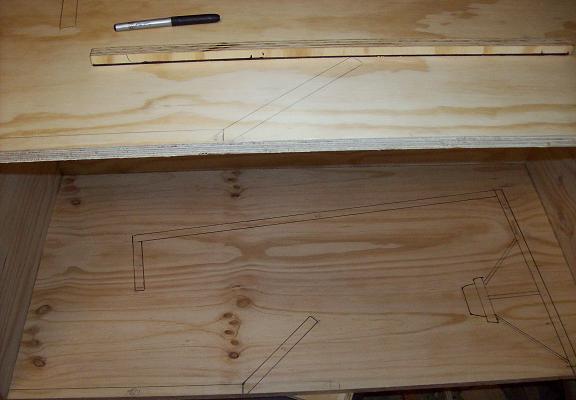

I'll see your nuttiness mike, and raise you a couple more... just started gluing these up tonight. Man I like that HomeDepot 3/4".... never thought I'd hear myself say that. I'm going to play with the front a little before the guts get glue, but highlighted is what I'm going to try first. (thanks oliver for the S5 thought.)
