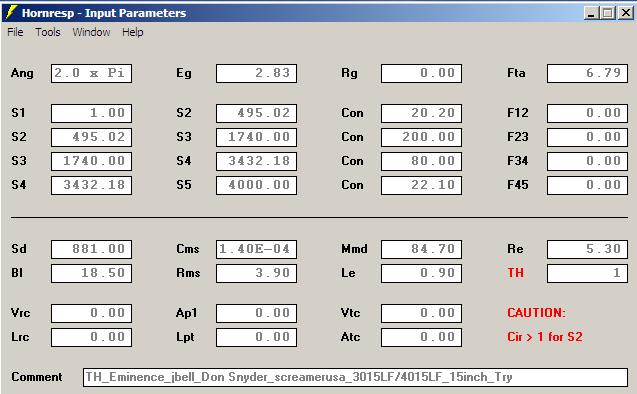

Here are just some scribbles on how you could fold a simple TH with your 24"x48" side panels.

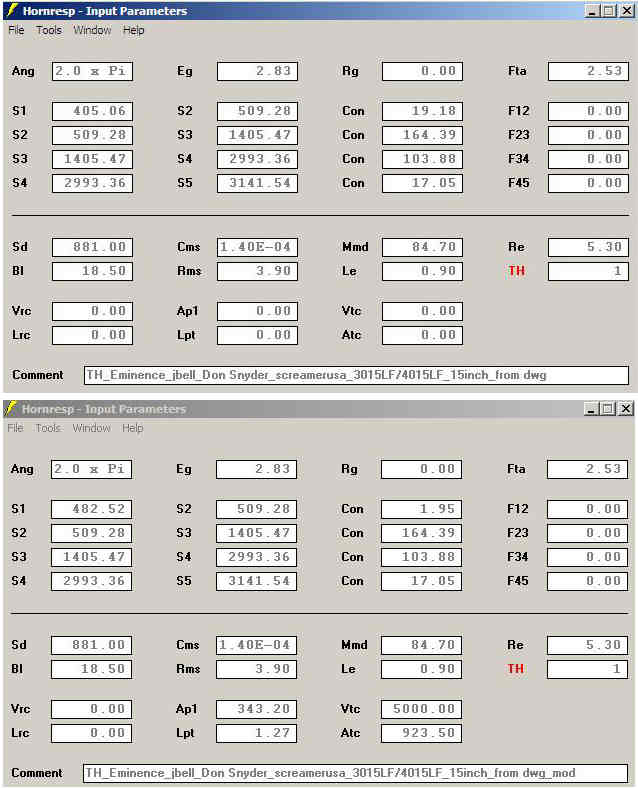

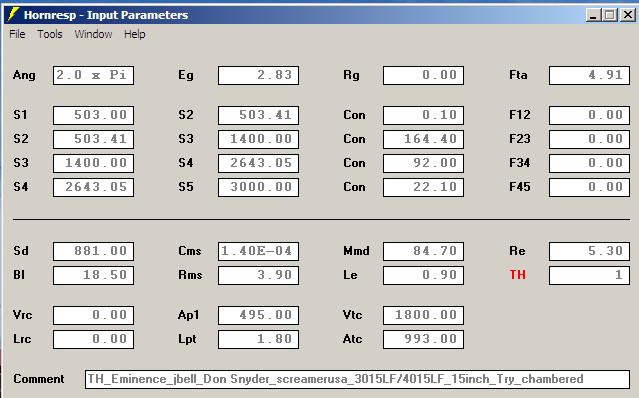

Chambered
And in case you haven't simulated a chamber in Hornresp before (that ought to keep Ya busy 🙂):
