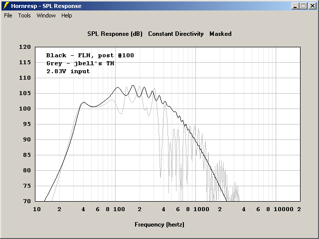

according to the sim, it seems that the folded horn specs i came up limit the cone excursion alot more compared to the tapped horn.
the tapped horn runs out of xmax at 40hz and 40V
the frontloaded at 65hz and 60V, which gives it +5db of extra max spl.
now let's fire up autocad and see if i can come up with something easy enough to built 🙂 i want to built this, measure it and compare with the th, which is already very impressive on kick drum.

just did some more modelling in hornresp, it seems that this cab would work too with an eminence definemax 4018LF, sensitivity would be about the same but it can take more power before running out of xmax, gets about 2db more output.
any drawbacks to using an 18 inch in this cab ? would the cone get damaged quicker ?
Compression ratio is still a meager 1.68. Over 2.5 and I'd start to worry. Nice find. I wonder if any other 18s would work, too? L12 and L34 would be a bit longer with an equally shorter L23.
The Electro-Voice EVX-180B is a dud. Runs out of excursion way too early. The Eminence Kilomax Pro 18A has a more peaky sim response in HR. The B&C 18TBX100 looks good.
don't really know if it's worth it though, while this cab get alot of sensitivity it seems to run out of excursion pretty quick, a frontloaded horn in this size can get the extension and sensitivity too, look at those hornresp inputs i posted earlier, but the excursion would be alot lower, according to my hornresp sims it would get about 3 - 4 db's extra output vs this tapped horn.
you mean post#100? Mouth is 4500cm2 compared to 3000cm2. Excursion looks less in the passband, but the humps are at different spots though for basically the same linear regression. FLH would have to highpass a little higher to escape its peak before the Vrc took over. And yes, the excursion peak in the passband is higher for the TH before the cab resonance which is lower. I don't know, I'm confused.
