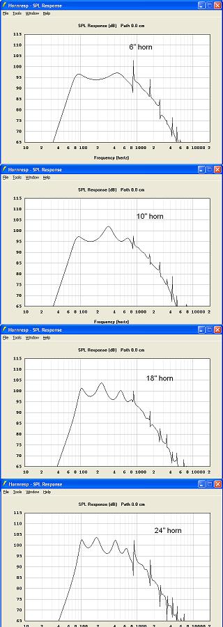

I've built several prototype tops with varying length horns, from 6" to 18" long. I can tell you the longer horns seem to carry better at distance. Also, the taller you go, (driver-wise) the better it carries at distance. (think line array)

Jim, Did you try anything longer than 18" for the 10" mid horn? I'm hoping for some gain down lower than 200hz.
Or, do you think the BW will suffer?
I'm thinking something like a TSE-111. Although they run the 10" to 3Khz so, it may not array vertically too well.
on the mid-top horn length... If you believe hornresp (and I do) over 18 doesn't help much... at least spl-wise with my experiments. It's always a balancing act to get the port and the horn to match up, so you have something useful.
Others better than I could probably do something with more than 18" straight horn.. but then you are carrying a top that's more than 24" deep... so I'm not sure it's worth it.
BTW -- a tse-111 doesn't go below 200hz either -- right?
The 2 best length's are 6 and 18 in my opinion... otherwise you get fantastic gain in the 'boxy' region that you then have to eq away...

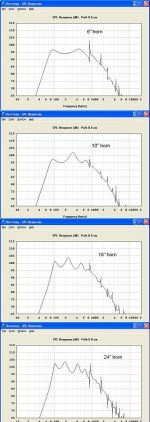

Here's my reasoning for 6" and 18". (see pic) Yes 24" gets you a little more in the midbass area, however once you start getting that long of a horn, horizontal dispersion really starts to suffer, and it's really only a long long throw cab. I kinda found that out the hard way on my 'dual flare' 18" long horn tops. While the dual flare works well for midbass, it kinda chokes the upper mids on horizontal dispersion. Because of that, I'm going back to just a single flare, from 3.5" to 24" wide in 18" in length. That seems to be the best overall compromise.
hope this was helpful.

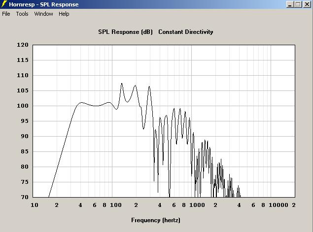

i just noticed something while playing around with hornresp, it doesn't seem to do much for the response to make the cabinet at 75% width, the response even seems to flatten out a bit more within 1 db from 40 to 100 hz ?
is this right if i calculate it this way ? at 75% with, so it becomes 18 inch instead of 24
s1 becomes 450
s2 becomes 588
s3 becomes 2280
s4 becomes 2430
and then i got this graph:
it doesn't seem to loose much vs the original plan, or am i overlooking something ?

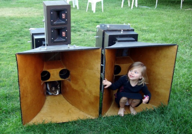

Yeah, I know that boxy thing of which you speak and the horizontal problem when you go long. These are my "honkers" I'm trying to give away. I had a bite today over email, but the guy chickened-out when I mentioned he'd need an EQ to level them out. But the real kicker was when I told him if he used the Eminence Delta Pro-12As with 1200W per side he'd get MaxSPL=124db @ 33 feet. Instead of wow, he freaked and thought they where inefficient ****** craigslister flake like all of 'em!
Lets see, that's 144db at 1M... and meOW that hurts.. at the kids and cat's position.
maybe Wi would be interested...
