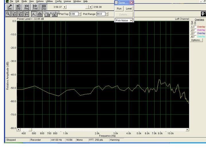

I had to dig in the 'way back machine' to see what I had.
I can't remember if this was no eq, or if I had applied a db or 2, I know I have VERY limited eq applied in the dcx2496.
I originally went to drastically tame the 8khz piezo spike, but in the end, I didn't completely eliminate it. Leaving it let the system seem 'crisper' even though I know it should have been eq'd out. Also notice, the complete lack of the 500hz 'boxy' sound that you get with a 10" long mid-horn. It was breezy enough that day (from memory) that I was only looking at 350hz on up.
I wasn't using smaart for this (didn't have it on my laptop at the time) so this is Spectralab, creative usb mp3+, art preamp, and superlux ecm999 reference mic. Measurement in the stands, about 10 yards to the side of the press box, about 15 yards to the front of it.
Oh, and tops integrating with the TH... well, let's just say a big grin happens anytime I listen to this system
that's about all I can remember from a year back.

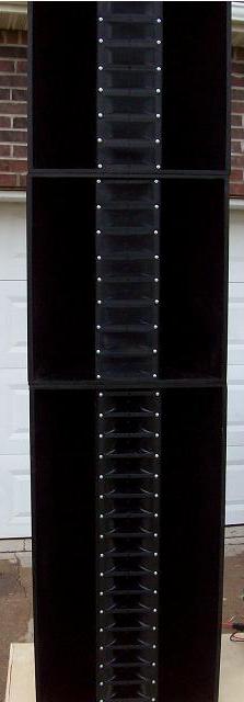

Impressive!
Folded or straight horn? Looks like a BF box but, I recall you stating otherwise.
How many did you end up with to keep up with the TH3015s?
I'm very interested as I have a stack of Beta 10s I need to do something with.
straight horn... I didn't want to mess with a mid-high w-bin.

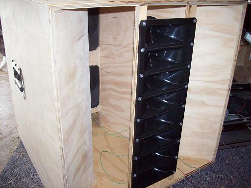

I've built several prototype tops with varying length horns, from 6" to 18" long. I can tell you the longer horns seem to carry better at distance. Also, the taller you go, (driver-wise) the better it carries at distance. (think line array)
I used a quad driver cabinet to cover the field, a pair of dual driver side fills, and four single driver short fills to keep up with the four TH cabinets. A pair of ep2500's and a dcx2496 round out the system. Believe it or not, it's running from a single 20amp outlet. 🙂

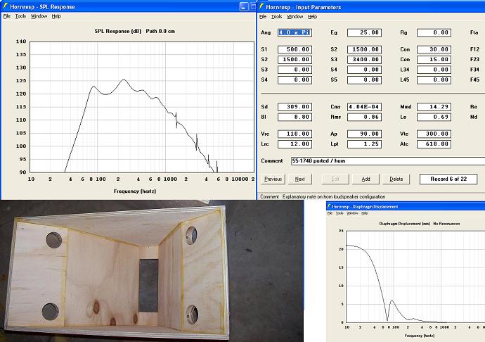

Did some playing around with hornresp, and it appears that the dual flare box I'd built awhile back, still seems to come out pretty good in 4pi space. I've learned the hard way, to ALWAYS use 4pi when designing a top. Also as you stack, the response evens out, and is not near this lumpy.
Anyway, if you are interested, your beta 10's would do very well in this style cabinet. Notice the bump at 250hz, instead of 500hz... If you want more details, I can provide them. (or maybe don will be kind enough to draw this up in cad, like he did for the TH.)
What I have simmed is a dual driver cabinet, 24" cube. If you stack 4 cabinets high, that'll be 8 drivers, and 132db@1M, and with some nearfield line array propagation, well, these should carry pretty well. If you stack 6 cabinets high with all 12 of your drivers, that'll get you 135. That's rock concert level a long ways from the stacks.
Attached is the hornresp sims, and a pic of a single driver test cabinet. I started cutting out ply tonight to make some dual driver cabinets for my park pa gig later in the summer.
cabinet details:
Dual 10" top.
build 24" cube shell.
horn path, two flares
13" long x height, 20degree at horn throat, 25degree at other end
8" long 45 degree at front of cabinet, square against joining 25degree angle
Where above two boards meet is approx 6" from front and 6" from side.
horn throat/driver mounting baffle, is 12" by height, with 3.5" wide x 8" hole, driver centered over hole.
Note, rounding top and bottom of driver opening slightly, instead of square hole sounds better.
Ports can be either deep in horn (even on driver baffle) or toward front of horn. If ports are 'back in horn' it lowers cabinet tuning.
Best sound with subs+tops is with ports tuned to 80-95hz with tops crossed at 100hz.

Looks like that's a sim of the 55-1740 driver? http://www.mcmelectronics.com/product/55-1740
Looks to be very close to the Beta 10.
http://www.eminence.com/proaudio_sp...il_link=BETA-10A&speaker_size=10&SUB_CAT_ID=2
I'm amazed there's not a big hole in the response from 800-3K using the piezos with this. Although, I don't know how I'm gonna fit my 2" HF in there without a huge front baffle.

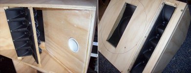

Just happen to be browsing, and saw your post. Here's a pic of one I was playing with, using the port deep in the horn throat.
Yes, if you use 3.5K piezo's you get a big hole in response, right where you don't want it. If you use 1800hz piezo's, you don't.

If you really don't know what to do with a pile of beta 10's, here's a couple more suggestions.
I really like the 6" horn for small room kind of stuff, and the monitor isn't bad either.

The 6" horn box has a modified version of BF's "melded array" of 3.5k piezo's. Basically goldwood piezos, cut and glued together to make an array.
I was skeptical, but as with all drivers, when there's a bunch of them, the response flattens out.
The monitor is also a cut array of piezo's.

I just slapped together some OSB into a flare like your and placed it in front of a test box.
A quick swept sine wave looks/sounds promising. A peak around 200-250 and falling above 900hz. Roughly what your sim shows. It definately has more impact listening to drums.

On mcm, they are big on 'discount codes' somewhere I have a flier with the $19 price and code, but I don't see it right now. My summer catalog has 16sc06, which will get you $22.51 price, which is still pretty good. A vertical line of these cheap-o drivers really does more than you would think.
As to the HF roll off. Filling in between the driver and the baffle plate (look at my monitor picture) helps, as does a 2.5k 12db/oct LP filter on the woofer. I know this design is kinda lacking at 100-150hz, but with the overlap between the subs/tops at 100, this seems to integrate well with the tops coming on strong at 200. Also, if you run your port tuning up to 100hz, you'll minimize your excursion in that range and you can push a little harder.
