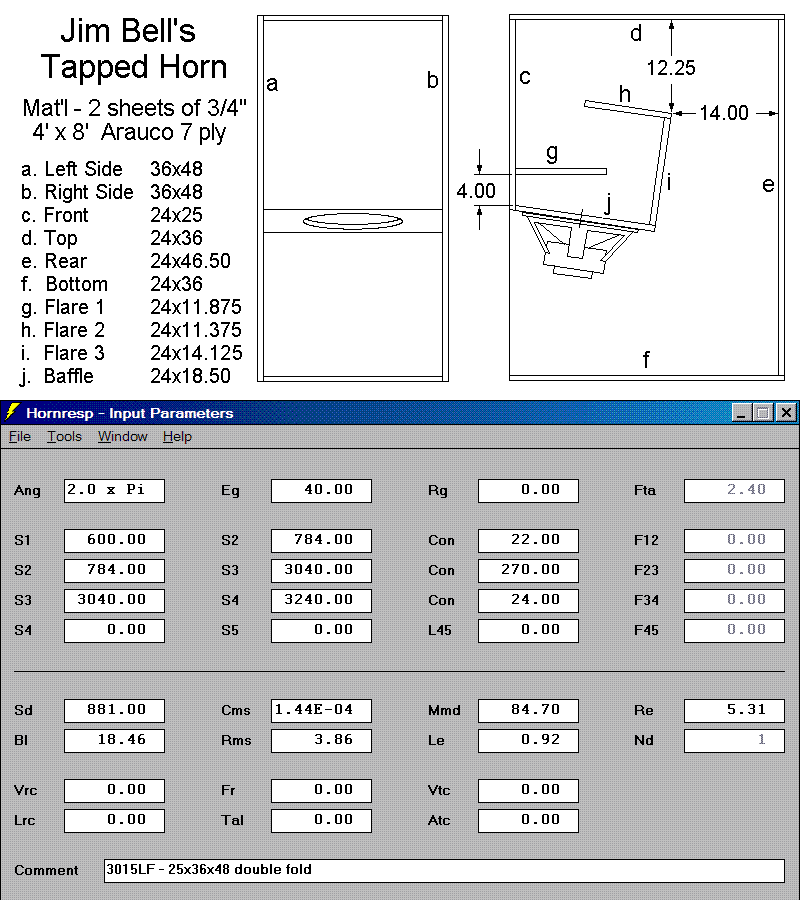

Jim has posted everything you need above - it is literally a connect-the-dots type build. All dimensions are in inches, the hornresp parameters are in centimeters.
From jbell's post:
For anyone who wants to replicate this (not sure if anyone does) It's 46x36x25.5 wide. (because I used 3/4" 7ply arauco)
Points of interest in plan layout: 1st point is 10.75 down from top, 8.5 from front. 2nd point is 12.25 from top, 14.25 from back 3rd point is 18.5 from bottom, 16.25 from back.
Those are the horn fold (toward outside) measurements.
The front panel is 25.25 long, and the throat is exactly 4".
From that and the pic above showing the fold, you can get to everything needed.
Hornresp params are 600cm throat, 3000mouth, 16.9,235,16.9
Point 1 is at the left side of the picture of the open horn, point 2 is in the middle, and point 3 is at the right. These three are the only points required for layout, the rest is connect the dots.
Good luck with your builds.
edit: clarification of units and measurements

The 3015 LF is one of the more popular drivers for TH's used for PA. There are several other designs for this driver in the "collaborative" thread, as well as a number of different folding topologies discussed. If you expand your search beyond the diyaudio site, there are a number of other pertinent discussions and designs that are well-documented on the web.
Jim's design plays to 40 Hz with authority (102 dB 1W 1M 2pi). It is -5dB @ 35 and -12dB @ 30 Hz. It uses an efficient folding pattern (no wasted internal space), and is already too big for your use. Physics and basic horn theory tell us that a 35 Hz horn will (with all else being equal) be even larger, regardless of the folding pattern used.
Taking the 3015 LF driver, placing it into a lower-playing tapped horn, then designing that tapped horn with a smaller mouth will cost you efficiency through the passband as well as increase the driver's excursion. It can be done, and may even yield a flatter response, but you will most likely not get the same SPL capability and you will reach driver excursion limits sooner. Jim's design was chosen based on maximum output within a given passband and a given amount of space for the installation.
In fact - a TH for the 3015 that is -0 dB @ 35 Hz is also 5 dB less efficient than Jim's through the passband, but requires essentially the same cabinet size. Additionally, 1W excursion increases approximately 20% due to the lower frequency. There is no free lunch.
If the 3015 is too big, consider the 4012HO. It also performs very well in a tapped horn, will reach the frequencies you want, and requires a cabinet that is approximately 1/2 the size. The efficiency is similar for the two drivers in a cabinet capable of an honest 35 Hz.
Once the driver is chosen, there are only four variables in the simplest form of a TH (which Jim's is L12=L34, conic flare). Area at the throat, area at the mouth, length, and location of the tap.

I'm surprised that it's so wide (24" inside). Most tapped horns on the BIG thread are barely wide enough for the speaker.
I've done some CAD, and I get a path length that's 30-40 cm longer than the 17/230/17 that Jim reported here. Not a problem, as length is a good thing.
Am I doing something wrong?

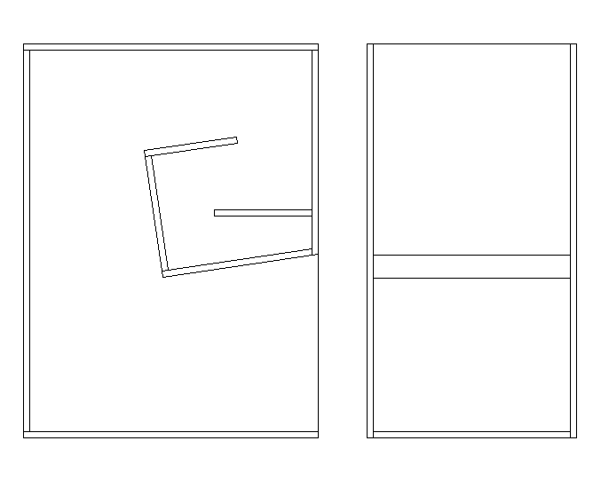

Here's my version of Jim's Tapped Horn. I ran this by Jim, and he suggested that I share it with the forum. This thing is BIG, over 600 liters, but that's not a problem for a fixed install.
The average guy should be able to get all of the saw-work done at a decent lumber yard, and complete it in an afternoon. If all the 24" cuts are actually 23 3/4", and cut with one set-up, he can even use PVA and everything will fit perfect. If he's got a router and a laminate trimmer bit, he can even make it pretty.
The angle cuts on the front and the baffle are a little over 8 degrees, but Jim said he left them square and used PL Polyurethane expanding adhesive. No bracing is shown, which is either brave ... or foolish. Jim put triangles in the two back corners (see pic earlier in thread).
