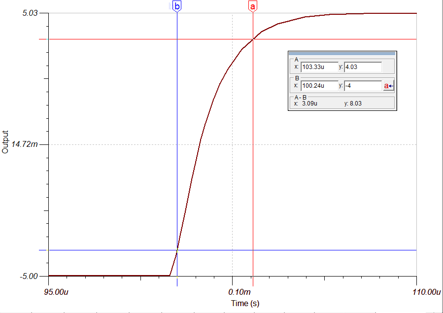

I test at 10kHz and higher to see how difficult the Darlington's are to drive.with my setup i got with 10kHz just 3,4V/µSec is that good?
with setting the bias of vas up to about 14mA i just got 4,1V/µsec
And how slow they are.
Shouldn't be more than 8ma bias from 2nd gain stage.
If turn on time is poor difficult to drive at high frequency. likely why I mentioned I have abandoned BDW83/84 also Tip142/47
Of course differential slew is limited with such simple design as well.
Maybe I run some new tests, havent played with BDW83/84 in awhile. Slew is measured at 10% and 90% of peak.
So 10 volt peak to peak would show 8 volt peak to peak. 8 volt divided by Delta Y/X

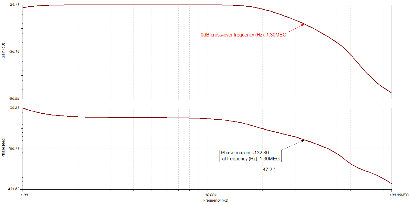

I tested BDW transistors to re fresh my memory. Not to hard to drive actually, better than TIP types.
10 kHz 10Vpp 5Vp 2.6V/us Slew Rate
Phase Margin 47

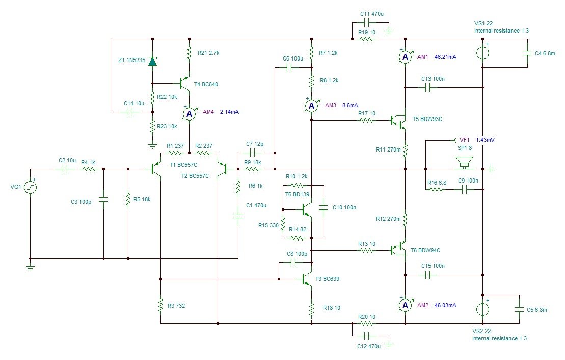

i am sorry i do not want to blame you. because of keeping my ideas of BDW93/94 for this smple amp. it is just i bought it for AA9MD.
it is my first "big" amp to try to "design" and build.
it was partly fun....because if i want to finish something i go deep in the rabbit hole...as good as i can of course.
slew rate 10% -90%---thank you
Phase Margin 47

i understand that to push current for nothing doesnt help. generally i build a bit bigger heatsinks becausee of better cooling. up to now i dont use mini housings for amp that can more then 20WATT at 4R.
but other things i do not really understand or missinterpret it.
Q1:why are base resistors needed. the darlingtons are slow so why?
Q2:you set the input filter downe 18k and 100p . ...instead of 220pF/22k...is that because of getting faster response from the "beginning" of the amp?
Q3: CCS is set is i to ~2mA...wow its the same as me 😉 . you did a other stabilisation with zener - it is the "better" version ...okay i have the Bob C. book but not read yet. it has about 770 pages but feels like 3000.😆
Q4: you re-config the degen of input LTP back to 237R -this fit to the degen 10R at Q5 and now we have degen factor of 10:1...right? less resistor value is not needed because current is just 2mA.
Q5: C7 FB cap and C8 miller cap of Q5 has to be changed. that was clear for me that in the real amp or a guy like you can better simulate it as me.
Q6: Bootstrap cap and resistors: the ratio is 1:1. R7 1k2 and R8 1k2?. i read somewhere it should be a ratio about 1:4-dont know why and where i read that...wrong? cap just 100µF...because of faster charge/disscharge?
Q7:C13 C15 are miller caps for the Darlingtons prevent oscillation - easy to implement for my for my prototype
sorry whitedragon because of my noob questions
kr
chris

Q8: you use at the zobel network a 6.8R instead of my 10R - that is for faster damping or?

Q1 base stoppers used mainly for high frequency oscillation and stray inductance. Usually in board design if those pathways are short and trace is small usually many get away without them. poor practice either way ,board should include them. the value can be 10 to even 100 ohms.Q1:why are base resistors needed. the darlingtons are slow so why?
Q3: CCS is set is i to ~2mA...wow its the same as me 😉 . you did a other stabilisation with zener - it is the "better" version ...okayi ahve the Bob C. book but not read yet. it has about 770 pages but feels like 3000.😆
VBE is sensitive to high frequency issues. and any surging from output section can cause oscillation. So even just a small impedance like thin short trace helps adding just 10 ohms is more a guarantee. If traces are long or lead wires to transistor can be up to 100 ohms. Needs to be on board regardless, yes in this case kept value low. Wont slow down transistor at all. Protects mainly VBE from big surges from the output section. Also why decoupling on power rail. 10 ohms and 470u traces can also be small at that point. Small traces have resistance already 10 ohms guarantees impedance not a easy path for surges. Good isolation for sensitive VBE with good layout, short small traces and added impedance from resistors guarantee decoupling from oscillation. Any further high frequency issues is tamed by small 100n capacitor tied across VBE..stable stable stable
Q2 I set gain with R9 at 18k value for R5 will always match this value. yes high for good impedance, matches R9 value so it wont cause DC offset at output.
much like servo circuit we need ref to ground and R9,R5 will always be matching. I keep 18k or higher for impedance. R4/C3 1k 100p is generic input filter to remove Radio Frequency interference/cell phone etc etc. People make wild magic guesses for this circuit. is easy 1k 100p good enough. if radio frequency interference still a problem raise 100p to 220p or 330p normal equation to determine frequency of simple RC filter.
Q3 yes good read to understand, short answer LED voltages can vary I just use zener, more stable over wide temperature range. LED assume 2 to 3 volts so current source impedance is higher if you use higher voltage reference for current source. with typical .7 to 1.4 volt ref expect current source impedance maybe 1meg if you raise voltage ref impedance is higher or better 2 meg. you can use 6 or 8 volts etc etc, but loose that voltage to the rail. So current source for say 2nd gain stage. We use feedback type so you only loose .7 volts to the rail. With differential dont matter. We want current source to be stable over wide temperture range so DC offset on output doesnt shift at higher temperatures. With low distortion circuits with mirror differential we can get better distortion performance with higher impedance current source. So higher voltage reference like 3 or 6 even 8 volts more useful for nice 2meg or higher current source impedance.
Q4 yes 10:1 basic rule of thumb, yes can allow Cdom capacitor to be made lower to maintain good phase margin. This case Cdom remained high to get 45 degree margin. I could raise degen higher to get better phase margin, but yes current is high. Any higher value than 200 to 300 ohms at 2ma current it would cause distortion to go up. I cant lower Differential current lower than 2ma because will have issues driving simple VAS. if lowered to 1ma then yes degen value can actually go higher. Even with max degen and Cdom at 100p phase margin was still around 40 degree so I added small C7 cap across feedback. I just raised the value till I finally hit 45 degrees with generic standard cap values ended up being 47 degrees.Q4: you re-config the degen of input LTP back to 237R -this fit to the degen 10R at Q5 and now we have degen factor of 10:1...right? less resistor value is not needed because current is just 2mA.
Q5 I wont go higher than 100p would rather be lower for better slew rate, but phase margin wasnt good enough still at 100p
Degen was maxed and finally more added to feedback path to finally hit 45 degrees. Technically little more advanced to calculate what cdom should be.
Simple amp, whatever, same old 68 to 100p. More a issue with beta enhancement transistor added, and cdom will get significantly smaller
Q6 value left higher to more likely maintain current and keep voltage drops the same, doesnt usually happen current is kept constant with resistor after the Capacitor. First resistor voltage/current will swing a little more
Since the cap in theory provides constant voltage. Like any current source, you wont have constant current without a constant voltage. capacitor should be large enough since it causes a phase shift at low frequency. Distortion at low frequency could increase if not large enough. Depends on resistor values.
1.2k and 100uf is about 1 Hz filter or likely where phase shift happens so no big deal. It could actually be 47u even 22u. I tend to keep it large. If the cap used for higher voltages. I guess it more about board space if you dont want a huge cap. Such low voltages like this a 100u wont be that big.
We can just do AC analysis in sim to see if there is a phase shift to high. 100uf will be more than large enough, specially at higher voltages when you resistors can be 2 to 3k or higher
Q7 power decoupling caps, high frequency is usually your biggest problem so the small 100n need to be as close as possible to the power transistors on the board.
larger caps around 100u to 470u should be as close as possible too. They are larger so harder to place on the board. The 100n are small and very much need to be as close as possible. If the wire length or trace length going to the big power supply caps is short you can often get away 100u to none. If your power supply is far away with leads its good to use 220u to 470u close to the power transistors. I didnt even show them in the schematic. Small amp like this with linear supply you can put rectifiers and main large caps right on the board if wanted.
There are still some issues. It is a very simple amplifier and the simplier they are the more careful you have to be in order to get the very best out of it.
Many problems are solved now but there are still some to improve.
1. The current generator with a zener diode is noisy as all zeners are. If there is a little imbalance between T1 and T2 that current (noisy) will add to the input of the amplifier. It is better to replace the diode with a transistor with the base to T4E collector to T4B and emitter to + supply rail. The R21 should the be R3/2.
It works identically good with BC557 as BC640. You can look at the super amps like the wolverine and they all have current generators with transistors.
2. You dont need the R1 and R2. They may reduce the risk of self oscillation but carefully values of C7 and C8 takes care of that.
2. R19 reduces the open loop gain of the amp. 0 ohm will give about half the distortion.
3. You probably dont need R17 and R13.
4. i would choose the R19 and R20 a lirttle bit higher, 47 ohm, to get less hum modulation when the amplifier is clipping.
If you never play that load it does not matter.
5. I test all my amplifiers in TINA ( can be downloaded from TI:s homepage). It is Spice with a simplified outer layer. And it works the same but dont have all the features.
First i connect the C2 to ground instead of the generator. Then I connect C1 to the generator instead of ground.
Now you have the same amplifier but inverting. You only need to add a measuring point at the base of T2.
Now You can see the open loop gain and phase as the difference between VF1 and VF2.
There i optimze the C8 value. You will see that a high value reduces the open loop gain at high frequencies so take the smallest value with a smooth phase curve.
Then I go back to the original noninverting configuration and optimise C7 to have a smooth high frequency roll off. Normally you dont have to adjust the C8 any more.
About the layout there is a lot to say.
Normally an amplifier layout is using a ground point near the input. From that separate leads go to speaker ground, The connection between C4 and C5, connection between C11 and C12 and C1 + input ground very short.
The lead between T5C to C4, C3 and T6C must be short as it is high current with high distortion going that way and it transfers magnetically to other leads nearby. It is easiest to mount the T5, T6 and T6 on the same cooler to get best possible thermal tracking.
I would replace R14 to a 220 ohm trimpot.
Good luck! It is possible to get a good performance of a simple amplifier if you just optimize it carefully.

Test it in TINA (it is free) and make your own decistions. You can make bode plots and noise test there and decide on your own.
Distortion test is very diificult so i would skip that. The amplifier did improve a lot with the suggestions from whitedragon. I didnt have the lust or power to make all the changes to the original scheme so respect to him.
Continue on the way to be your own expert.
