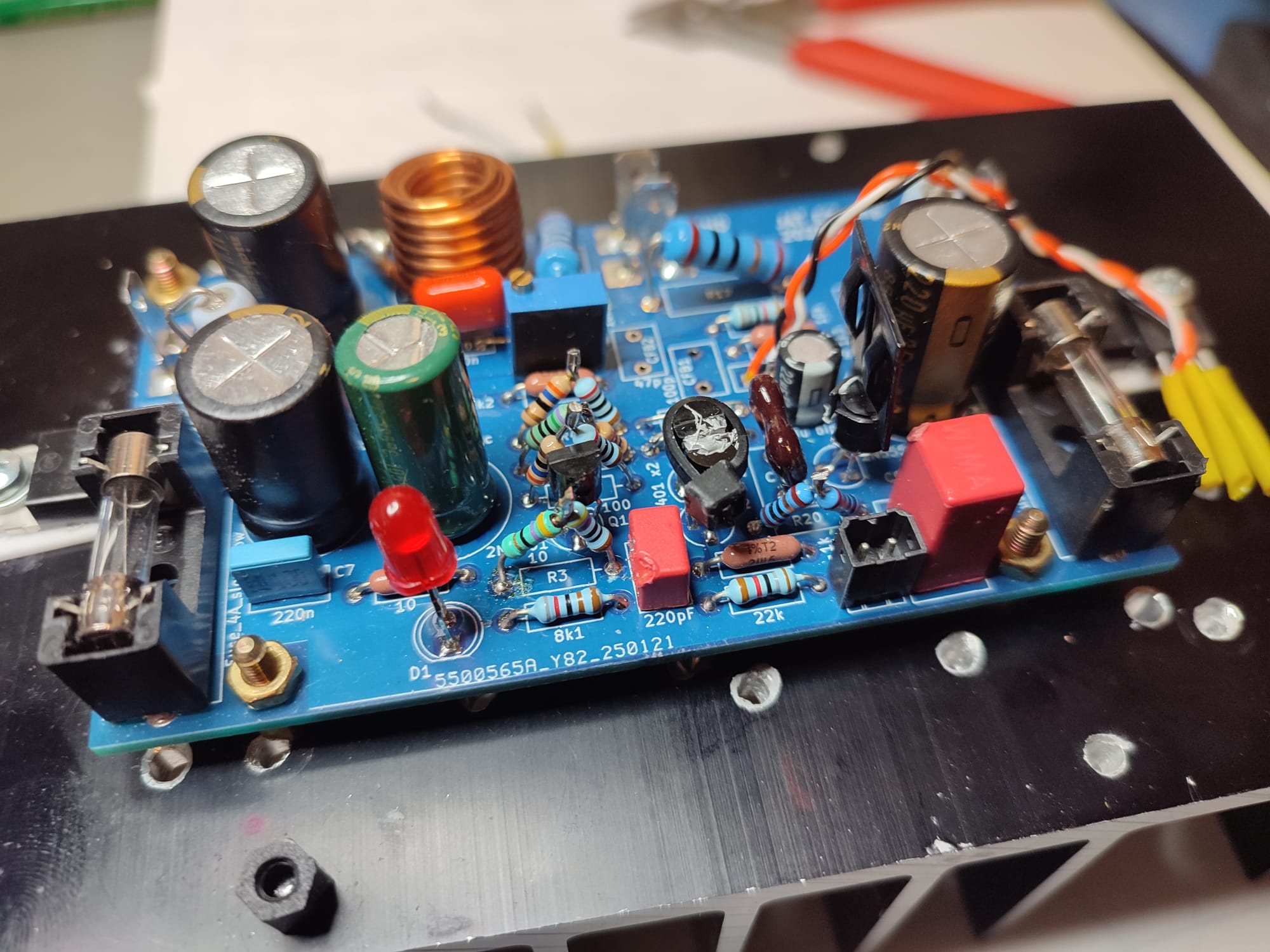

My bootstrap amp when powered the first time it shows -50mv dc offset. After matching the input ltps it instantly dropped to a steady -11mv. Not an ideally low measurement but it sure is an acceptable range. 🙂
the transistors at the input LTP are matched.

Usually what will cause any offset is the input differential.
Why I use 1% resistor for simplified amps.
Otherwise normal audio practice would be to try and match the input transistors.
And by default the board design should mount them flat to flat for any amplifier.
They should be thermally bonded flat to flat, little heat shrink to hold them together.
Same with mirrors should be thermally bonded.
Otherwise is interesting why diy audio doesnt see more designs with dual transistor packages
since they are thermally bonded in same package. And usually well matched/ laser trimmed.
Such as FMBM5551/5401 dual matched package
Old school was 2N6795 and many others in dual matched can/T0-78

yep...i do so....
i personally made my matching of TO92 like this.
warming lamp- so i get about 40°C and then match with DCA75pro and pres 4 time the test to get a last valid reading.
then VBE and HFE match.

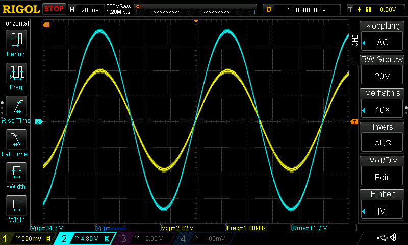

Hi
the R channel is also in operation and shows the same.
gain 24,7dB andthe same fg high (4R 250kHz, 8R 280kHz) and fg low 3 Hz at 10WATT.
quiecent current is set to 120mA per rail.
the only thing i have to correct is the max power at 4R for both channels. i forgot to set the OCP higher at my PSU. now i get 11,7Vrms into 4R so it is about 34WATT.

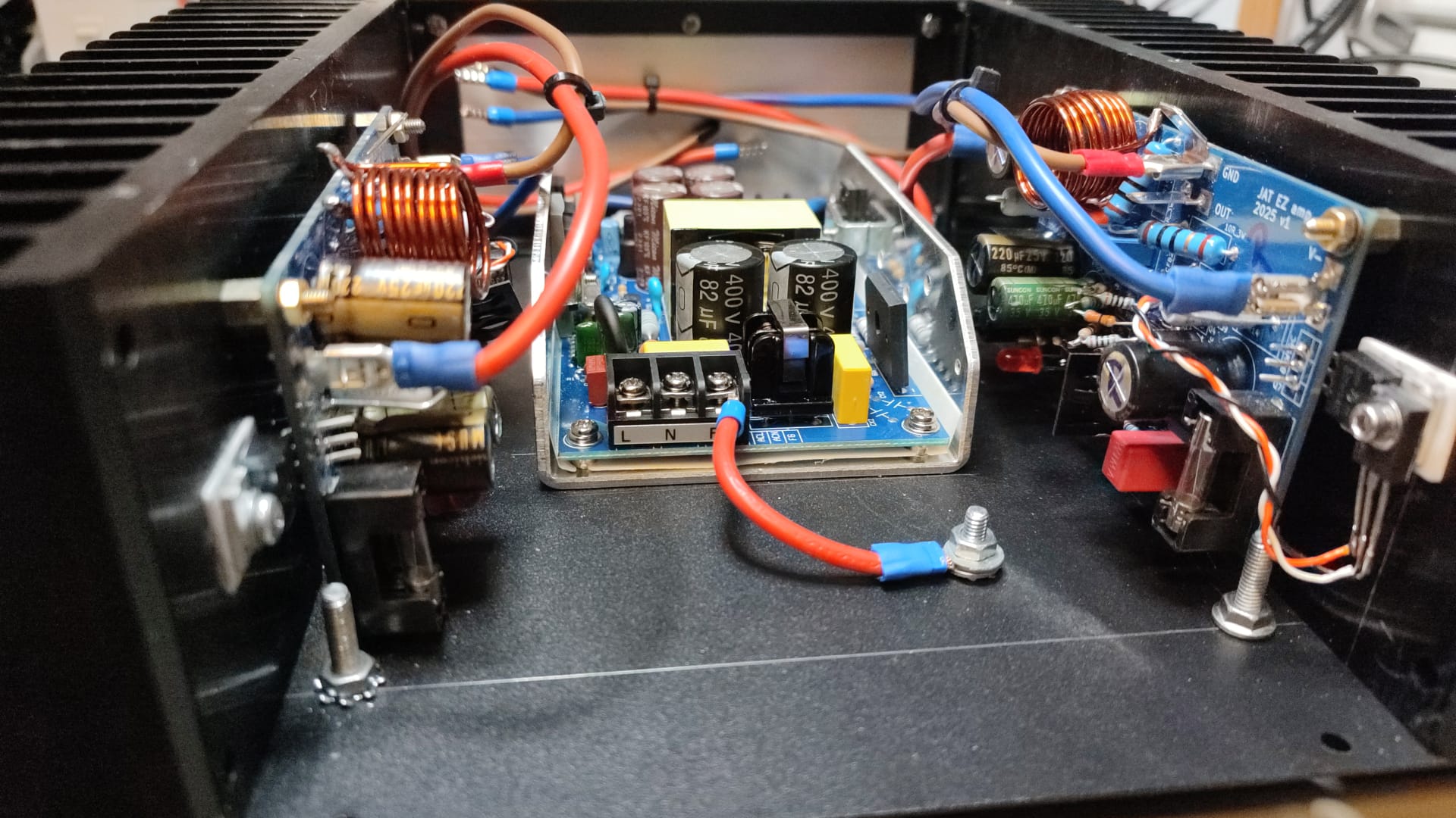

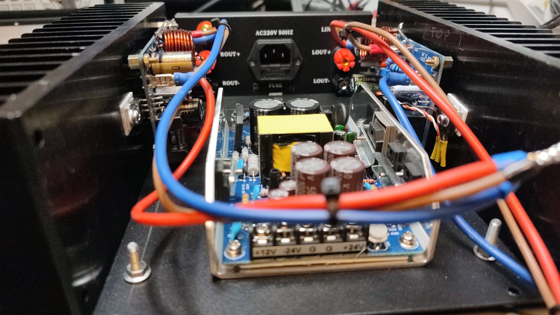

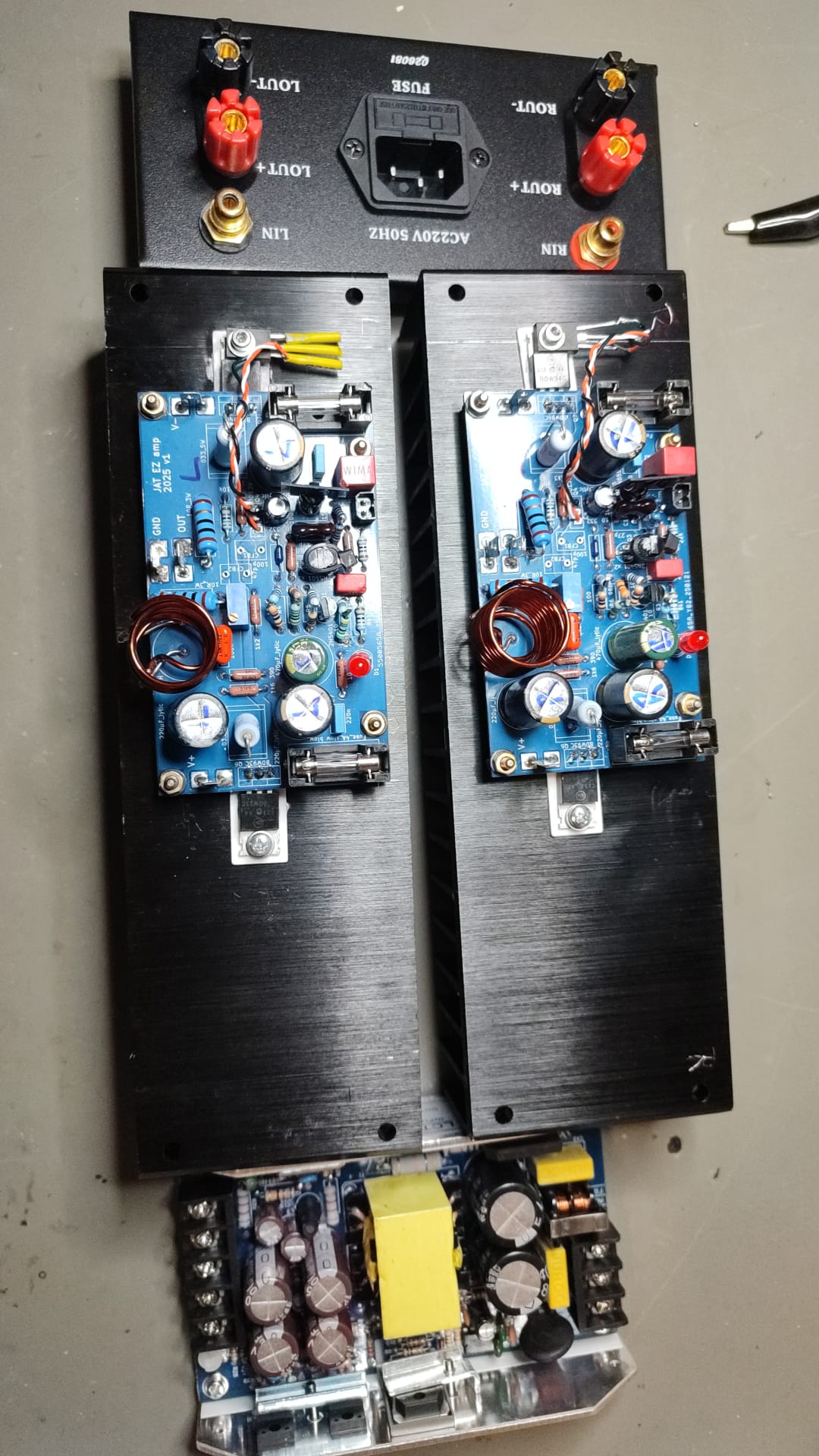

Good eveneing,

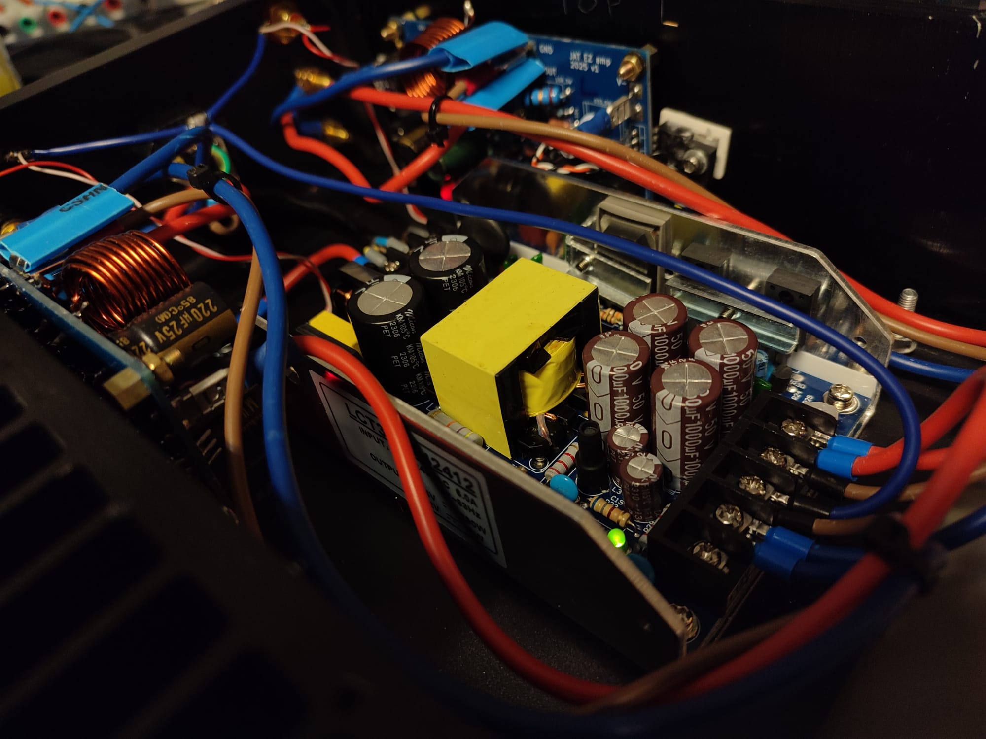

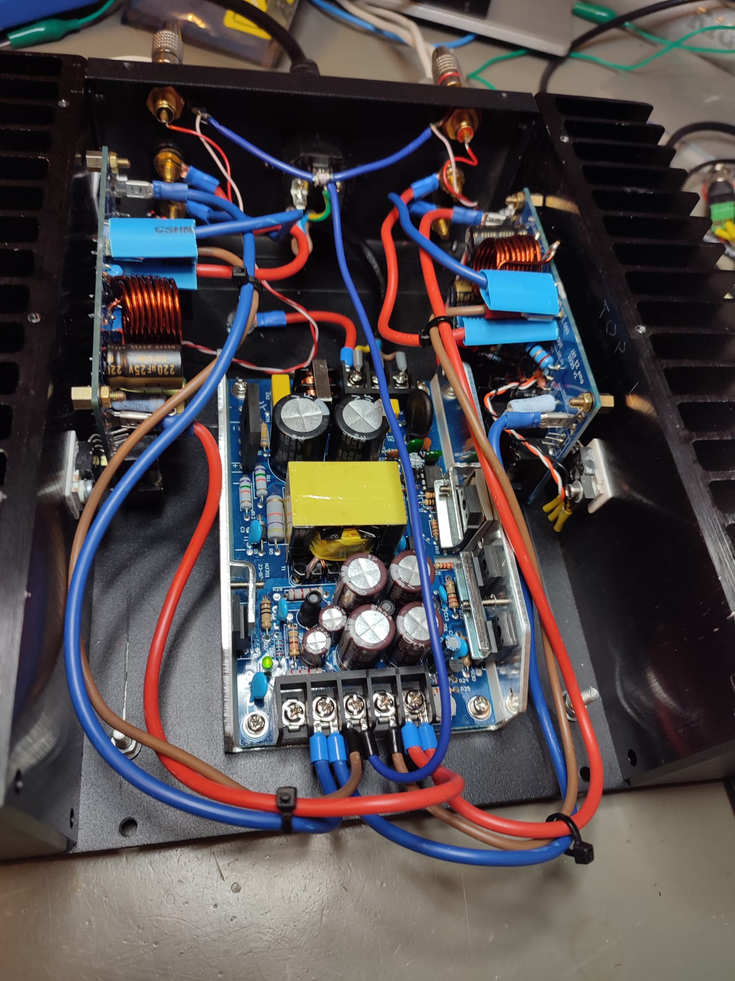

meanwile i build the amp in a very small housing with a SMPS by Aliexpress 24V +/- rail.
next step is the RCA connection..
have fun
chris

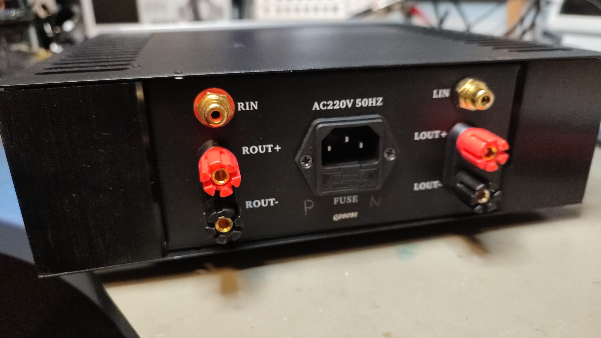

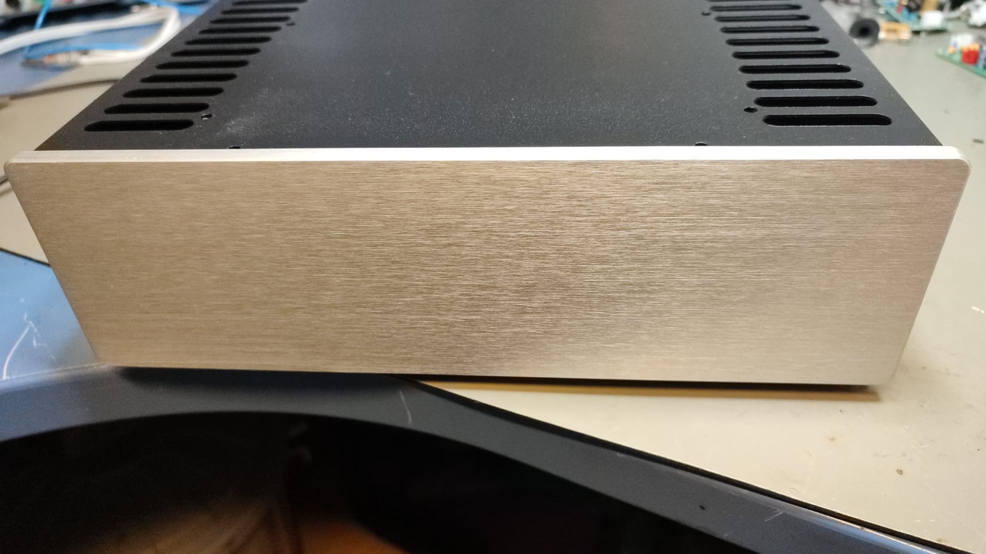

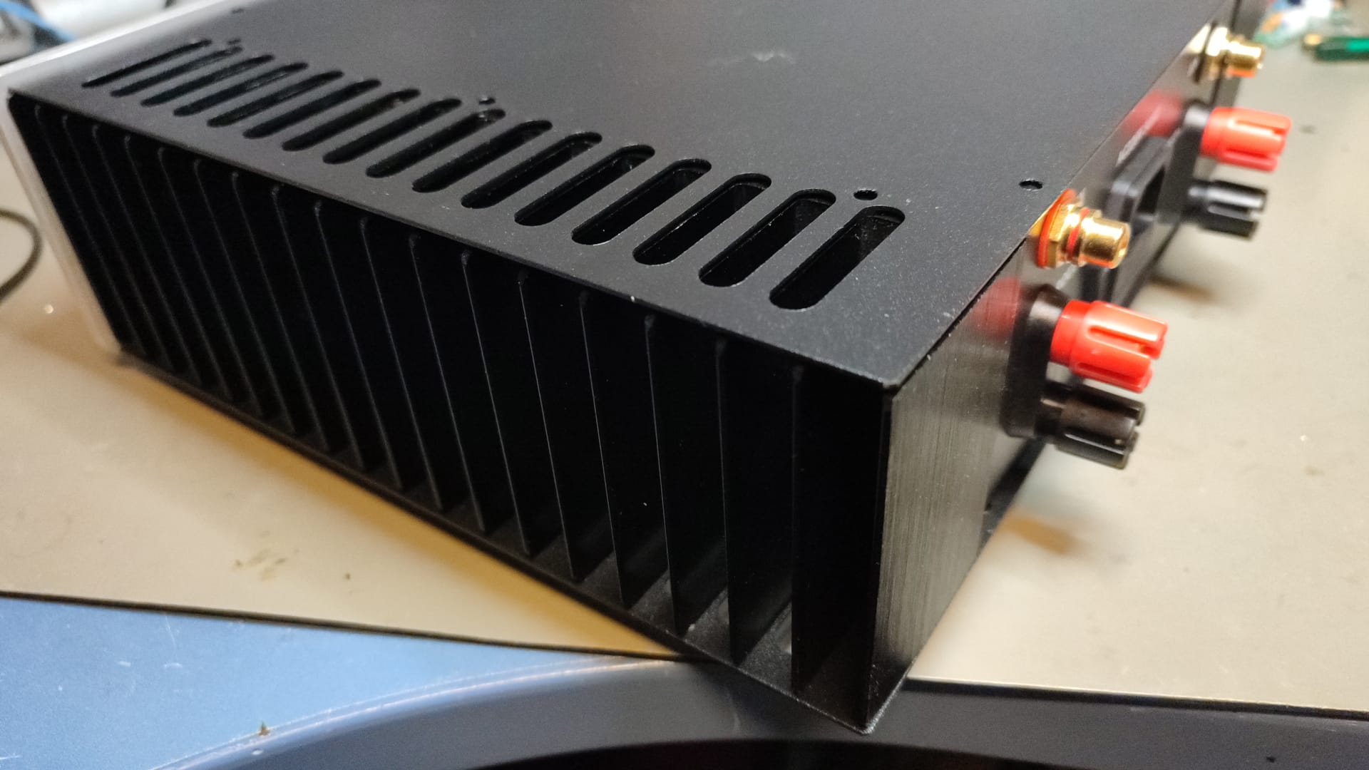

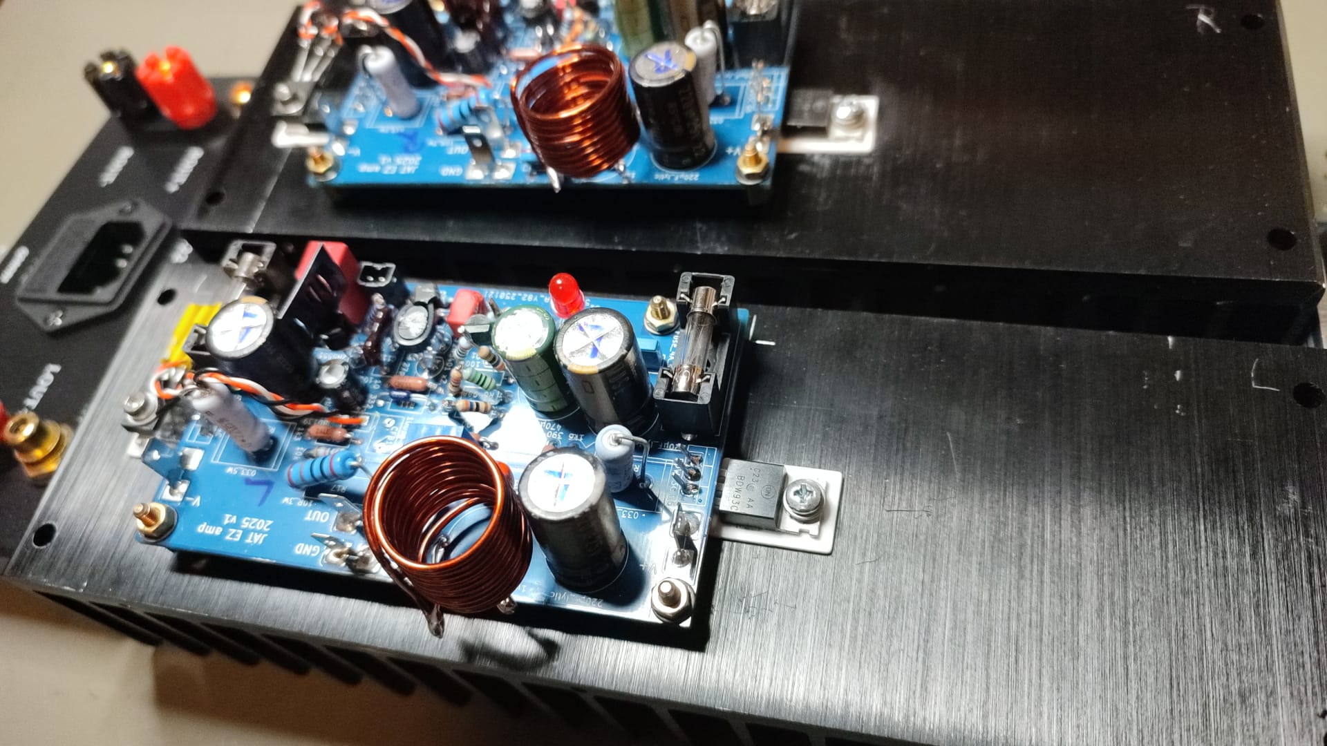

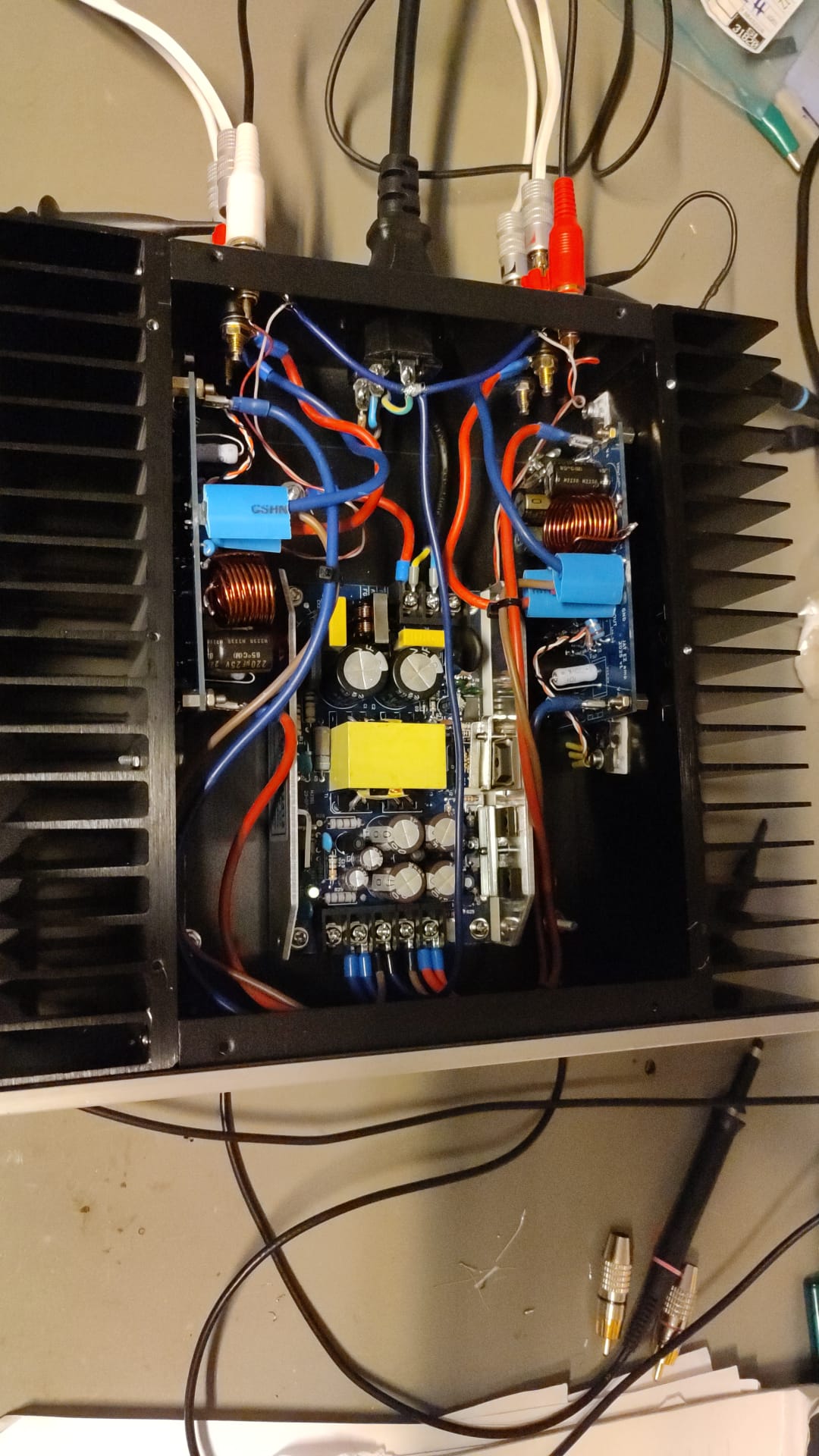

Hello
the amp is finished and sound check was okay. it is a compact housing and not much space inside.
here some pics
DC offset is 5mmV at L ch, 8mv at R CH- this is because thes chines SMPS has unsymmetrically voltages. -21,04V - 21,10V
but it is fine for me. power on/off is noticable but not too critical. at tswitch on i measure 42mV DC offset but after 2 minutes everything is fine.
here some pics

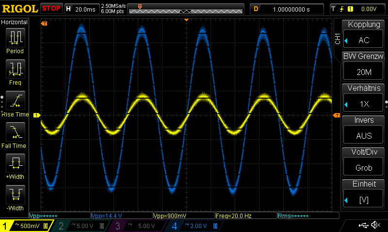

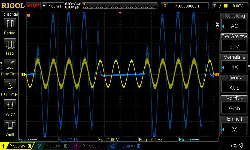

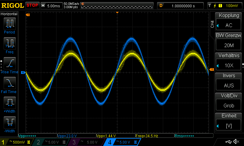

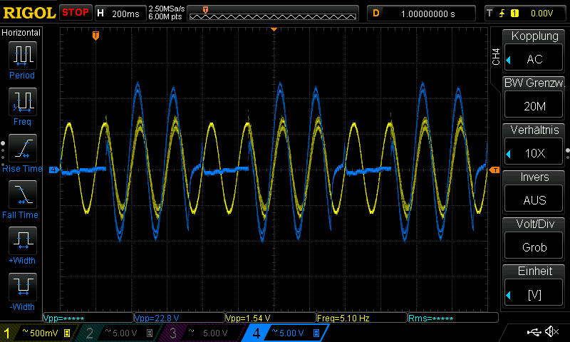

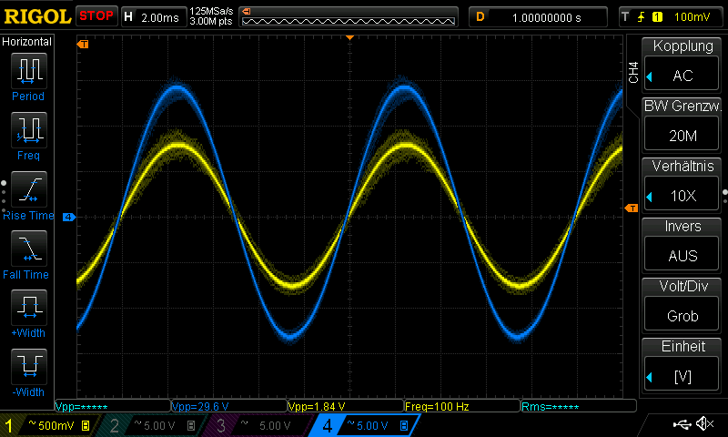

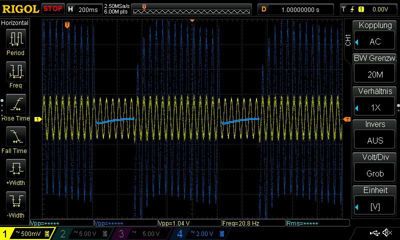

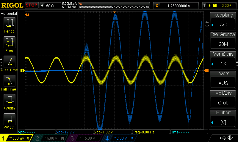

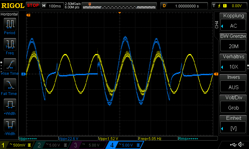

The SMPS from Aliexpress is not so fine during test, why i will explain to you.
i have no problems during listening but the behavior is strange. i explain:
i want to check the upper and lower fg and i found a hick up mode at the SMPS at low frequencies.. hick up mod at a SMPS means a kind of OCP -over current protection - and the SMPS shuts shortly down - check if the "short" is gone - want to try again and goes again in the hick up mode.
yellow input signal
blue output signal at the LS connectors
yellow input signal

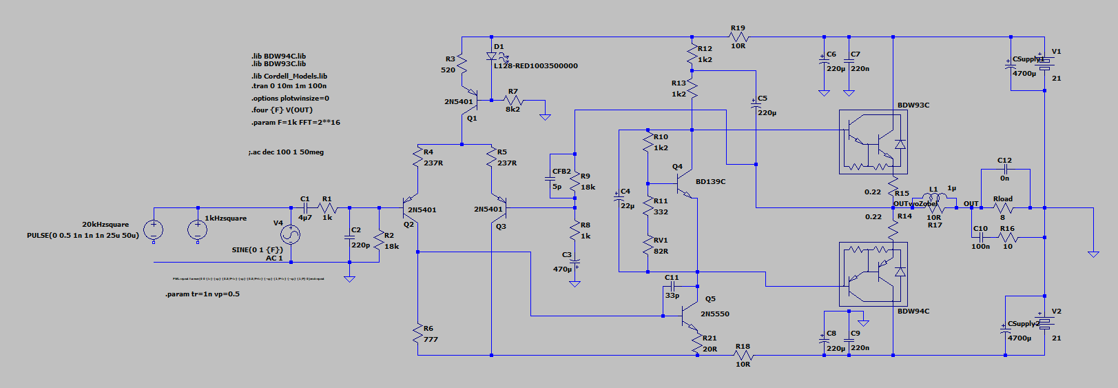

to close the phase 1 with darlington BDW93/94C and a lot of help from WD and Minek and for sure Peter (KICAD) -thanks again.
here my last LTspice file.
i changed the VAS from BD139 to the 2N5550 at the database i am too lazy to implement the 2N5551 (in real amp).
i re-check the power dissapation of this little guy (To92) with a current of max 8ma and a voltage swing of about 38Vp i got just more then 300mW -so its okay if you do not push hours hard. i use a heatsink on this transistor.
for a version 2 of this amp - my ideas:
have fun
chris
- all values updated -like my real amp
- caps should be marked with + at the mask
- C4 is bipolar -22µF i used (mooly amp), my
- use isolated TO-126 TTC004BQ as Q4 to be save about isolation with ouput transistor
- R20 VAS Q5 is now 20R to get 6mVDC offset - it dependas on your rail voltage and LTP matching and idle current
- delete CFB1+CFB2
- add a bigger ouput transitor like the 2SD2390 (old Darlingtons in TO3P housing vom Denon AVR)
- ouput transistor is like WD wrote - a lot of possiblities - MJE15028, DV44HV, or any other cheap one
