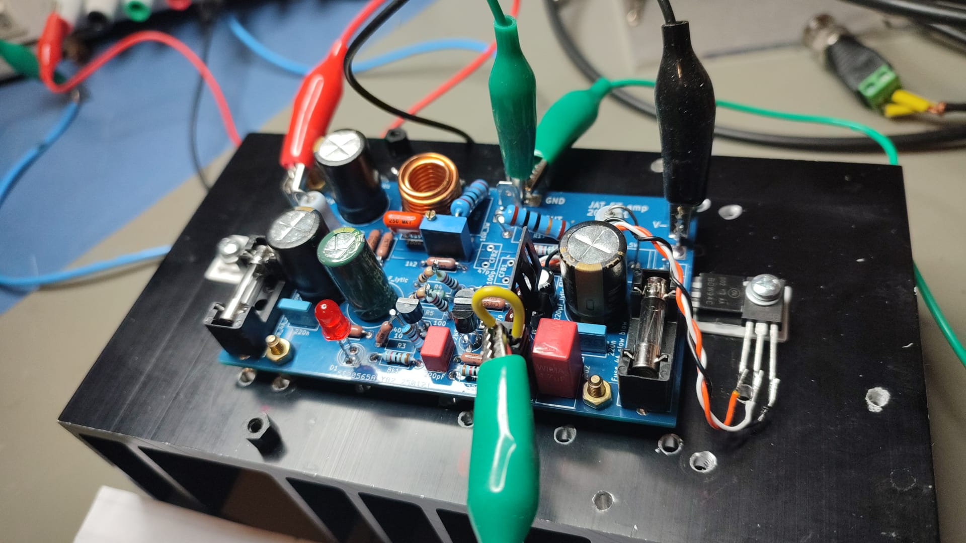

Hi
first PIO-Putting into operation.
i use a 0,65K/W heatsink for first try.
IMPORTATNT -signal GND and PWR GND must be connected with extra wire.
VAS is use Tohsiba TTC because it is isolated...may version at home for BD137/139 have the metal surface - and i am to lazy to use additionally a cutted isolator
DC offset is -204mV
red LED gives 1,72v so its too much -CCS gives 2,85mA
trimm pot with 200R is fine to adjust the bias to 50mA each no heat at 21Volts rail. 😉
current at VAS line is about 8,3mA at R20 (degen. resistor Q5)...okay
if i measure from GND to the base the pnp (BDW94C) is more open --> 1,46V, NPN is just 1,04V
have to check the values maybe tomorrow.
have a nice evening
chris

Nice work Chris, dc offset can be significantly reduced by matching the input pair. If that didn't work you may have to reduce the values of the degenerators, I guess you are using too high a value for a slower devices (2n5401). I am judging from the schematic in post #97.
My experience with simulation, a dc offset of about 1mv gives you a much closer result in the real world build.
Albert
edit: I was late to realize that you are using TO-126 for the VAS.
Albert

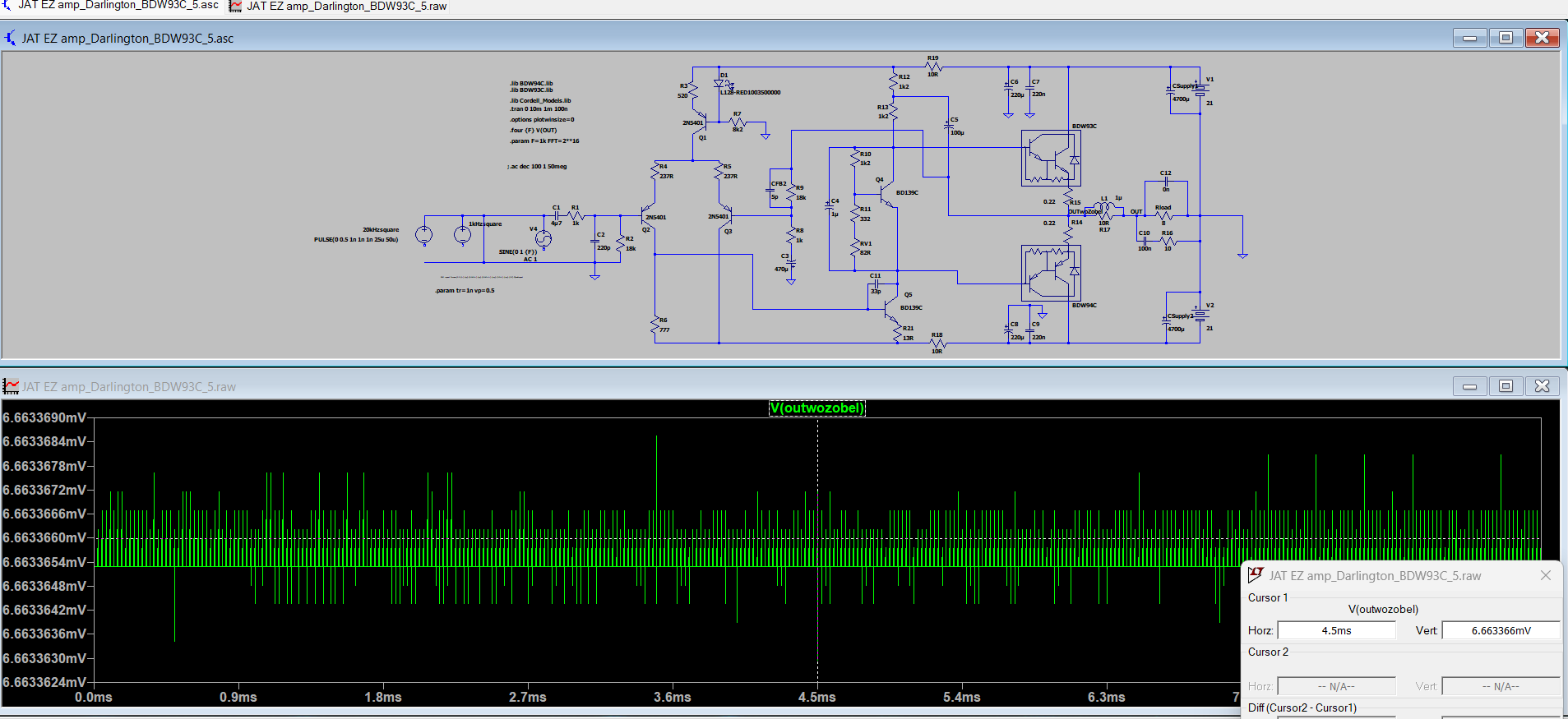

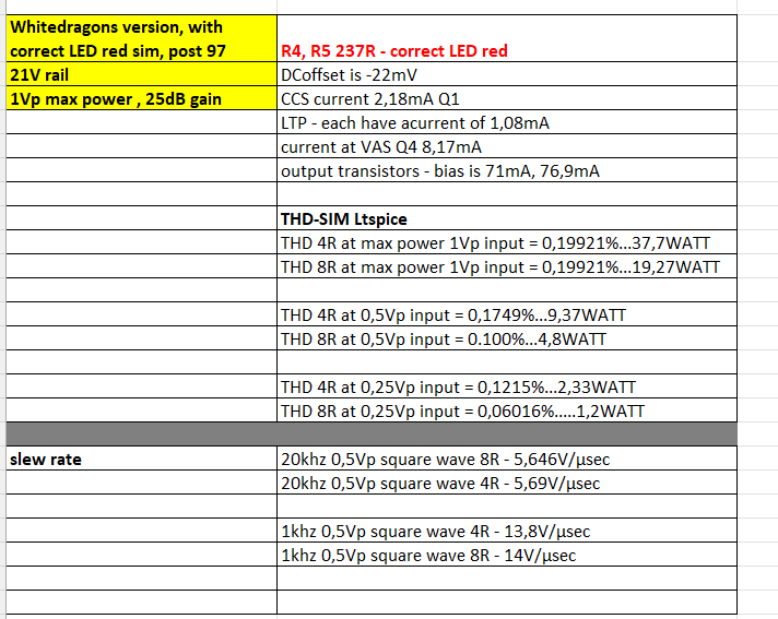

i did a sim if is use the real value for the voltage of the red LED.(1,74V) its easy to find a diode.
i have to change the R3 (CCS) to 520ohm to get my favorite 2,1mA. then if to change the R6 to about 777ohms to get a perfect balance at my amp. DC offset is then 6,7mV.

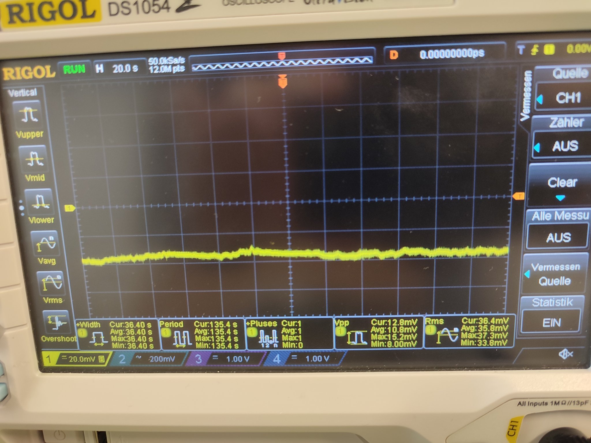

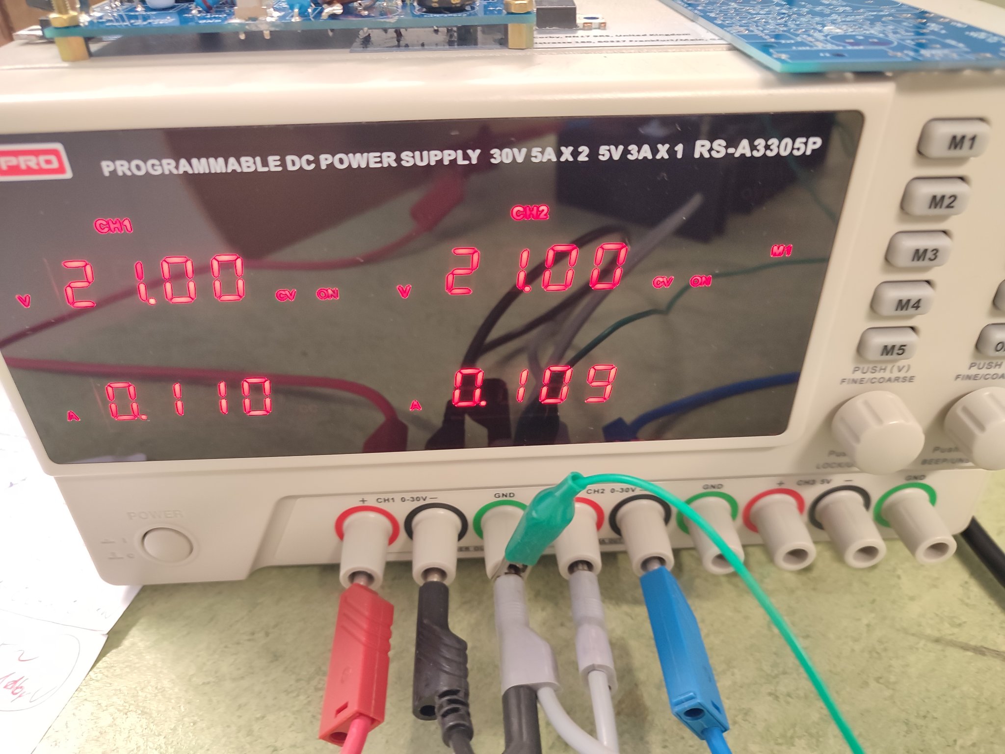

Hi
i just let run at idle current of 106mA / 21V rail since 6 hours and wverything is fine. DC offset is about -33mV. i let run the scope to look at some graphs.
current is now stable also the DC offset is not ideal but stable.
no heat - everything is less then luke warm 😉
kr
chris

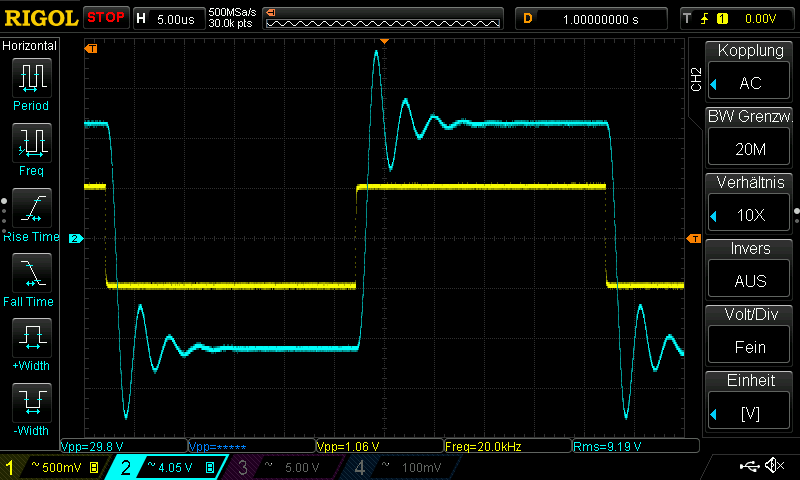

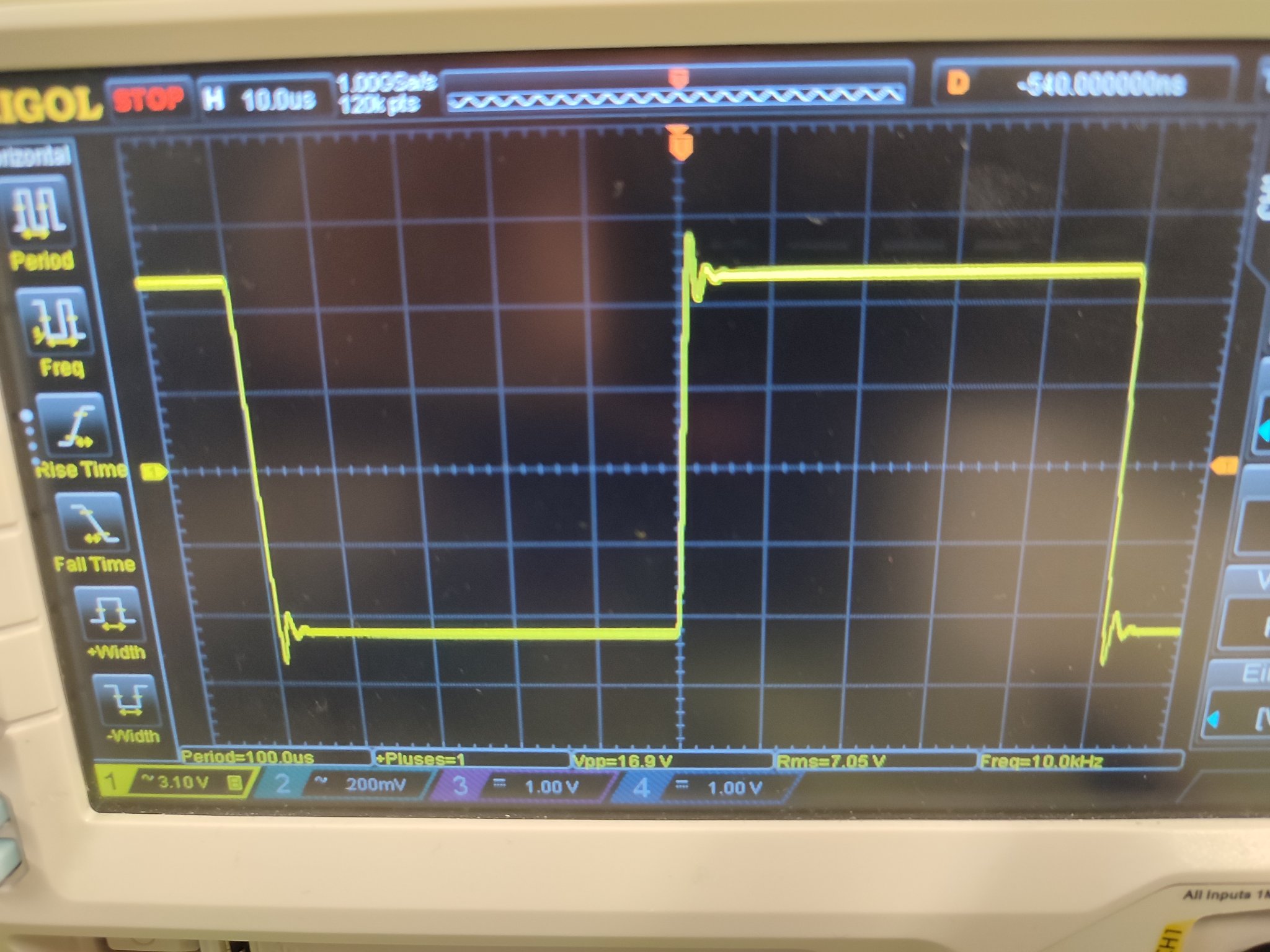

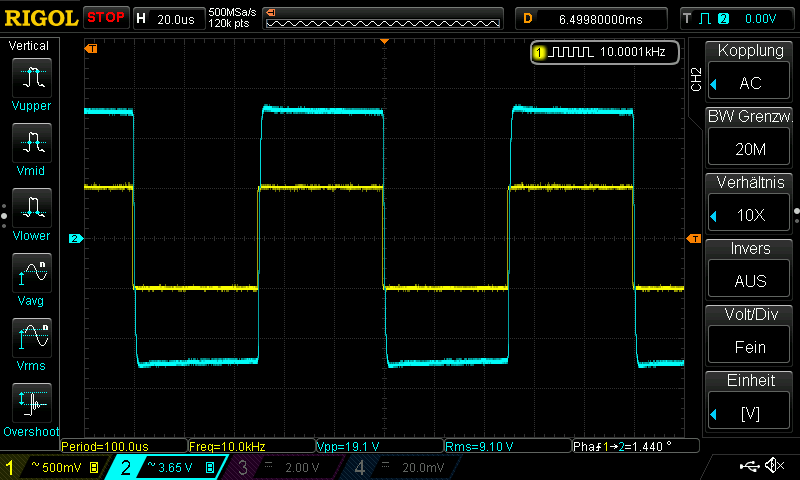

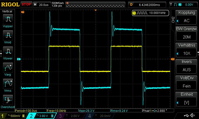

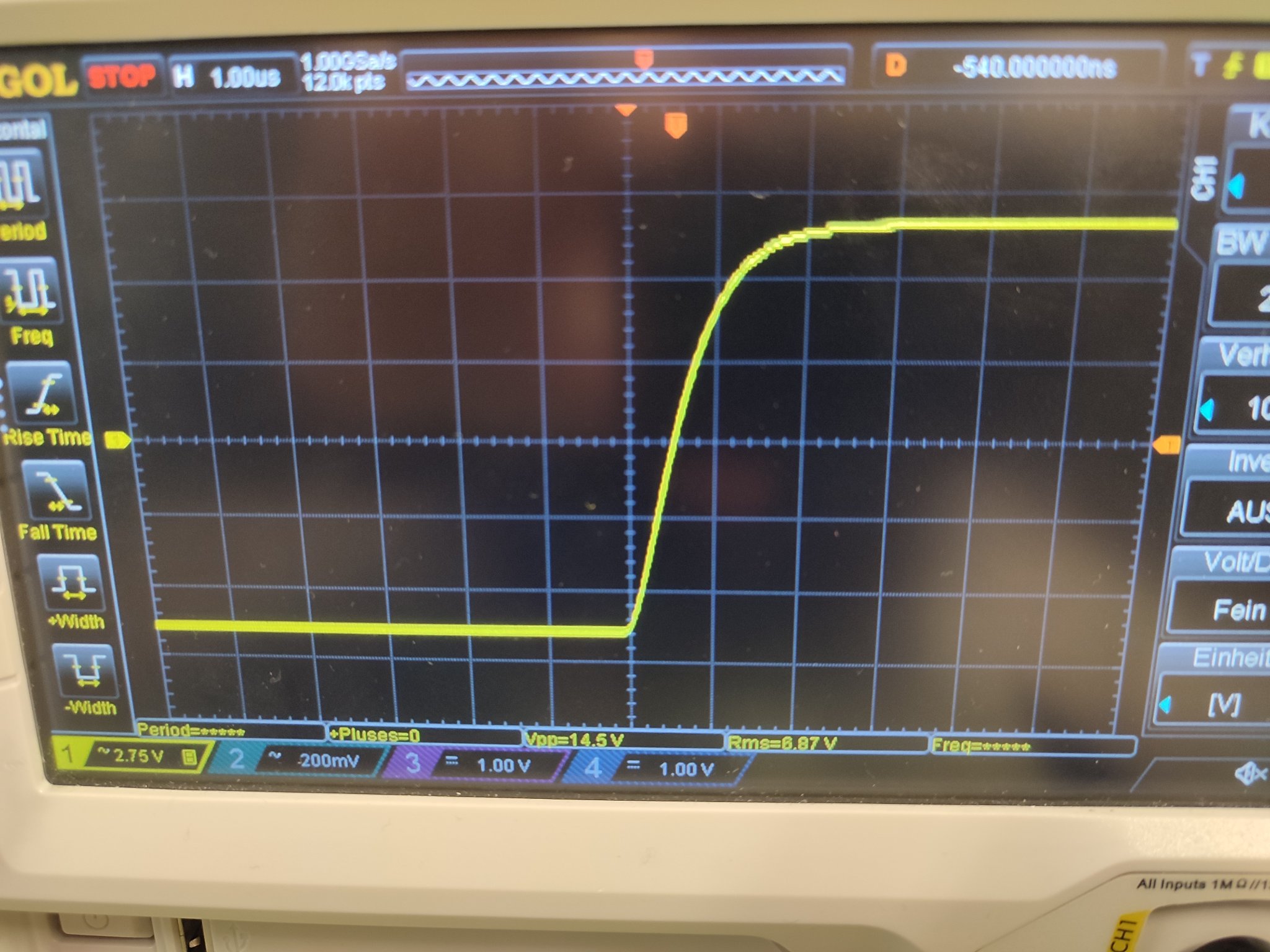

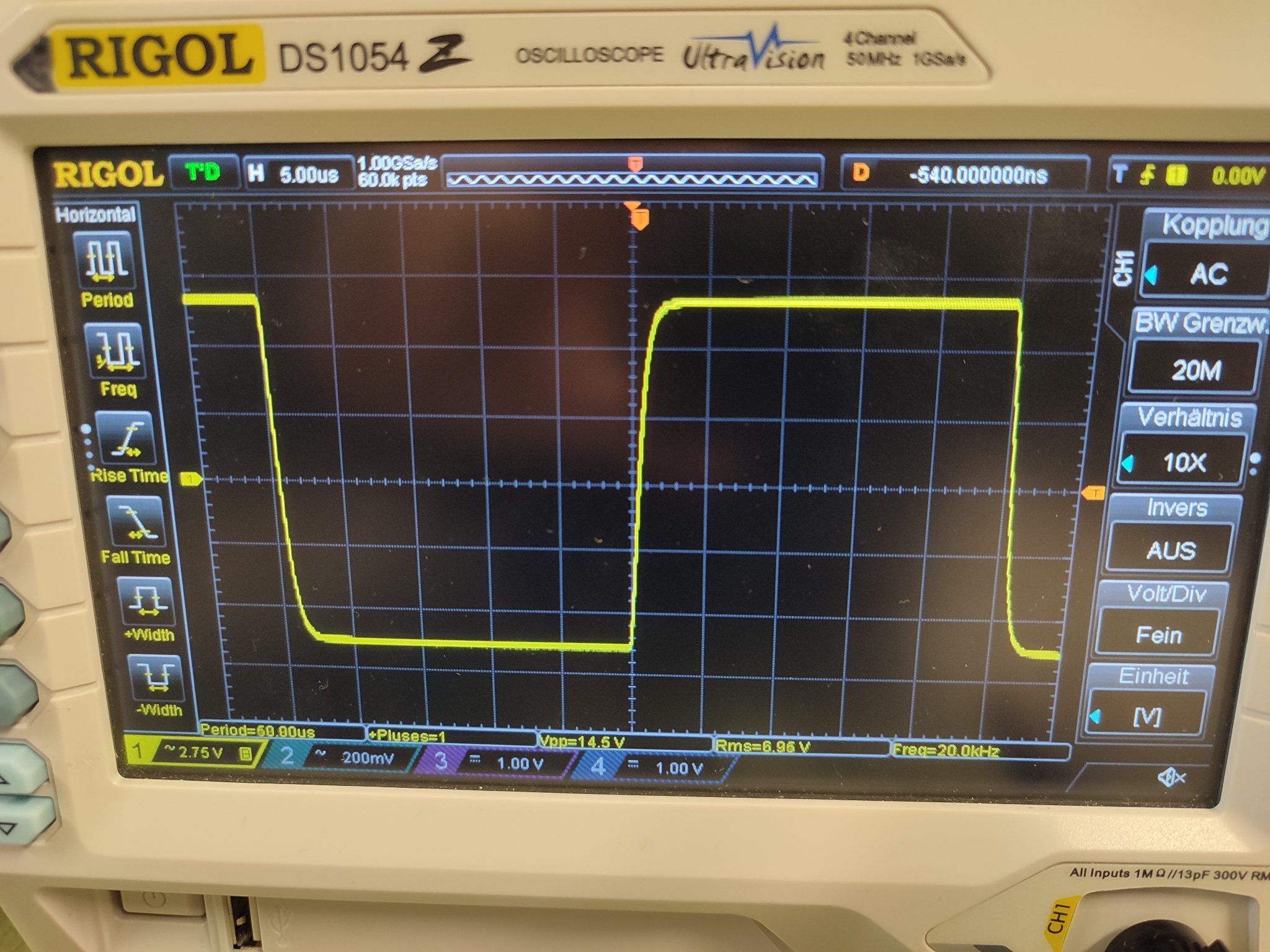

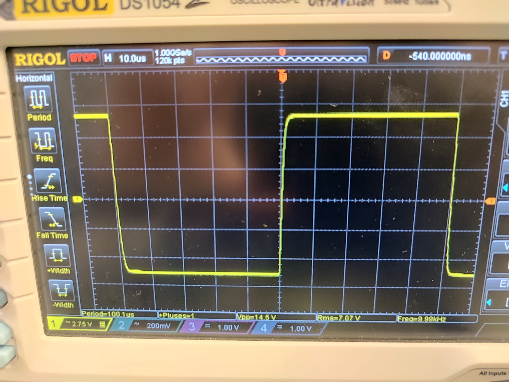

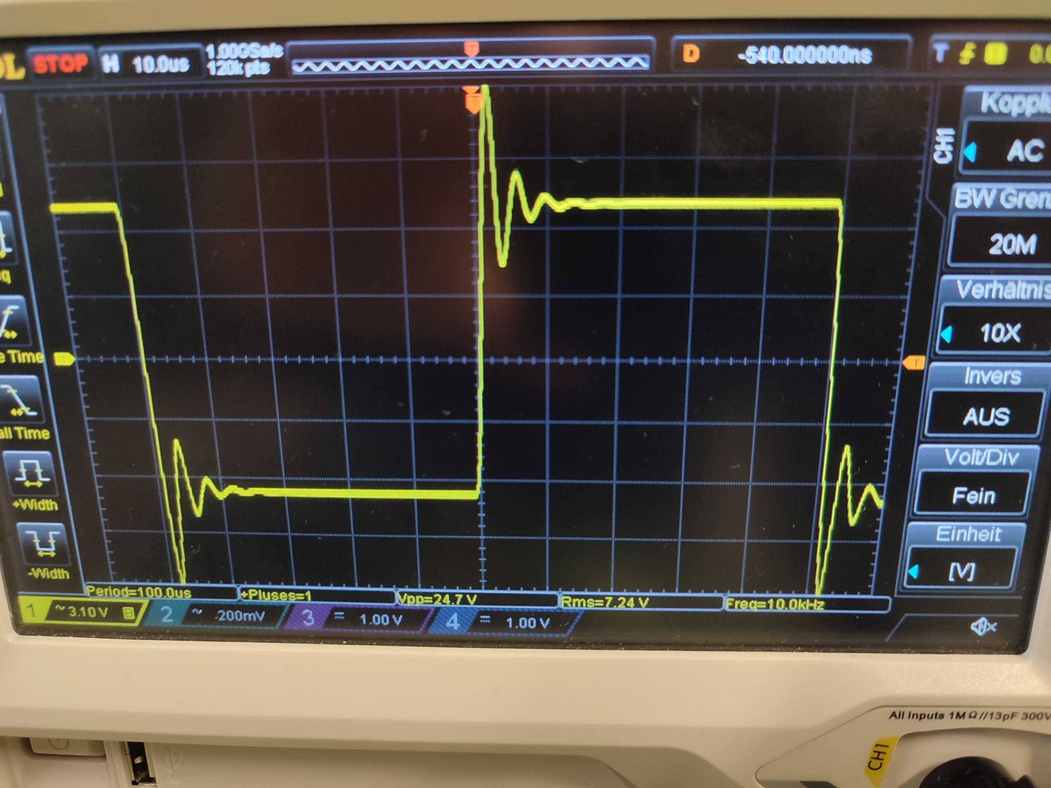

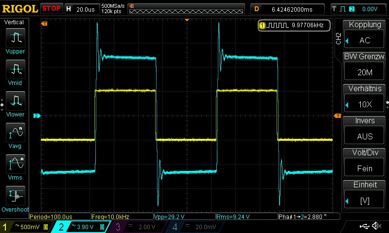

hi
here is a first test with 9R and just to small 5W/18R resistors parallel.
this amp is stable with 10kHZ and 100nf and 390nF at about 5WATT
sine wave i test is done with about 7,4WATT and the upper fg was with 9R load 280Khz
not bad 😉
kr
chris
not bad 😉
kr
chris

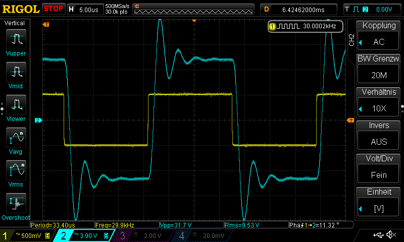

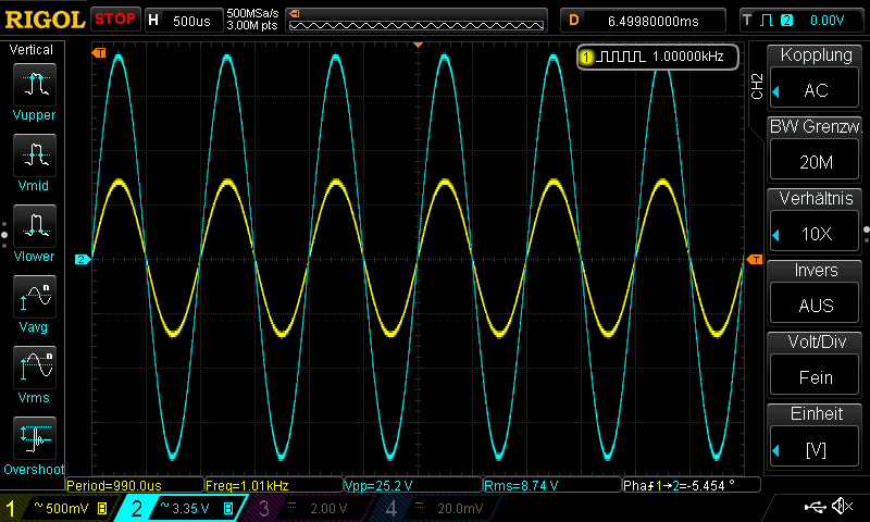

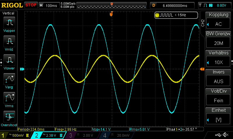

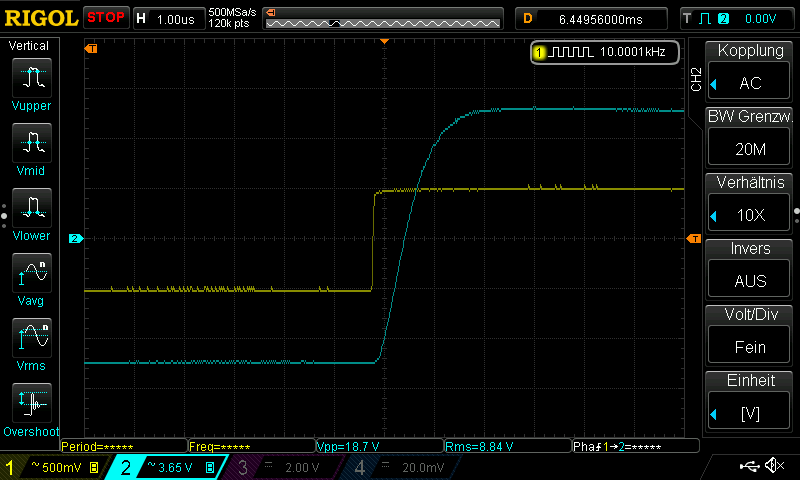

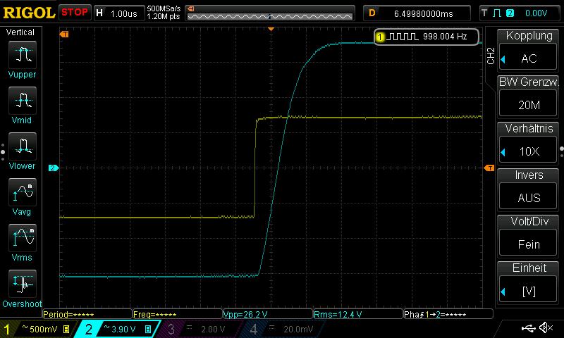

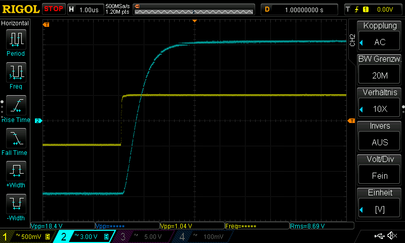

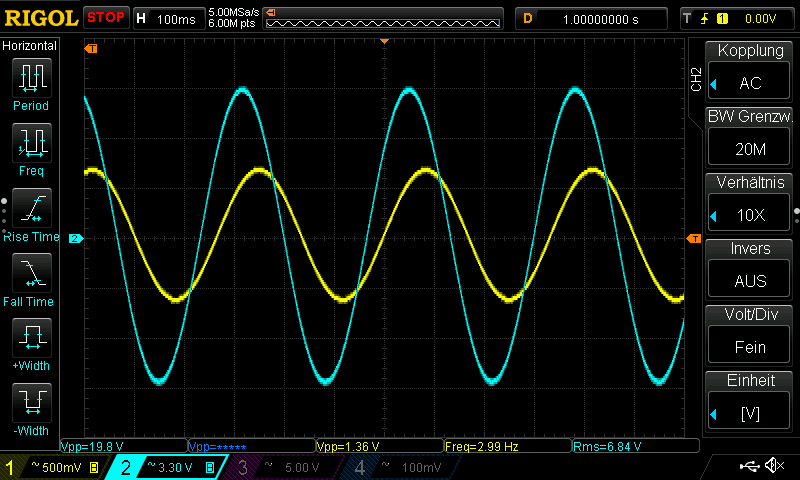

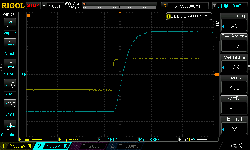

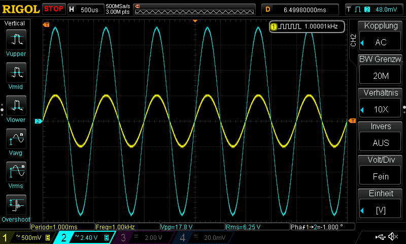

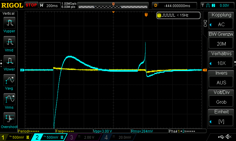

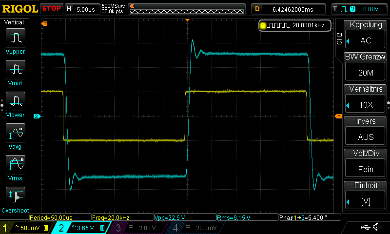

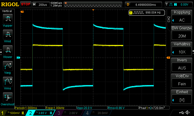

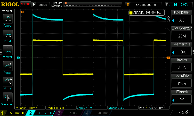

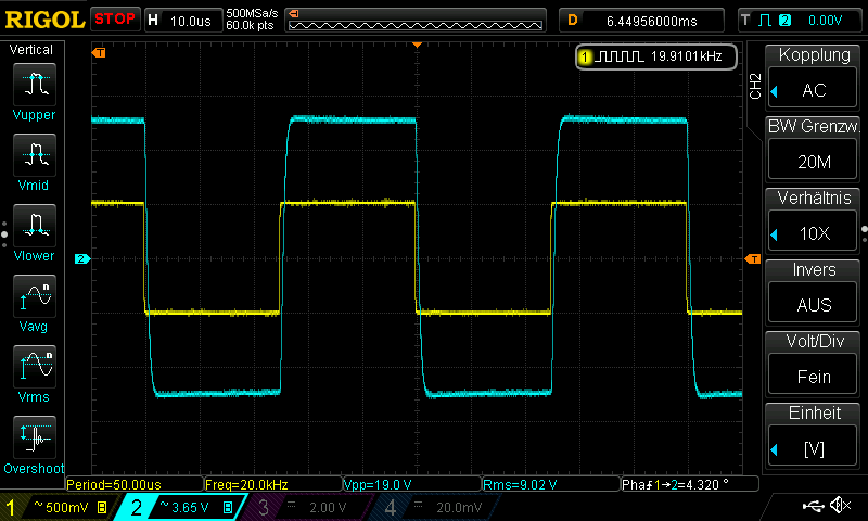

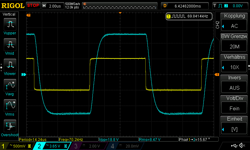

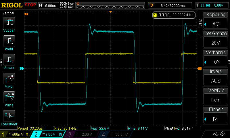

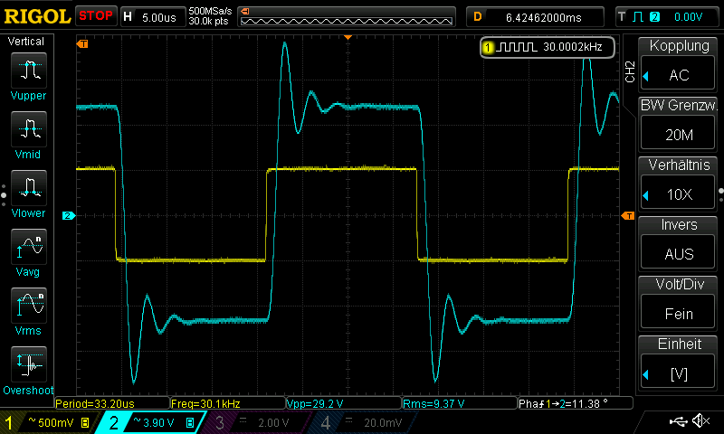

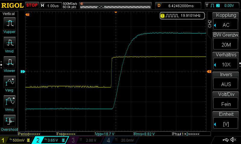

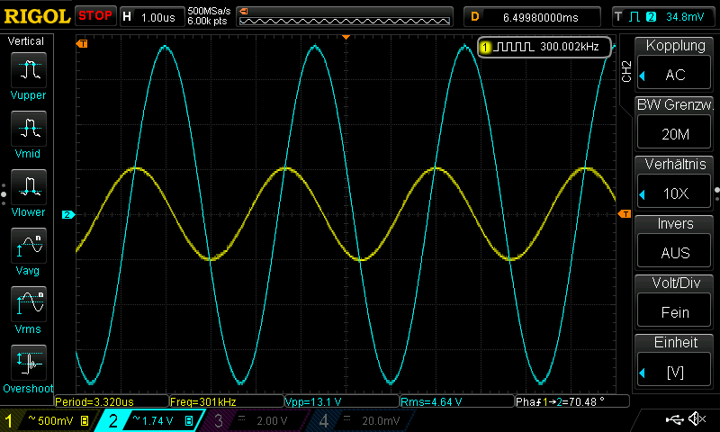

Hi
here are some measurments with my smal load resistor. the values can be read in the filename

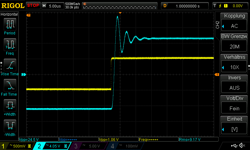

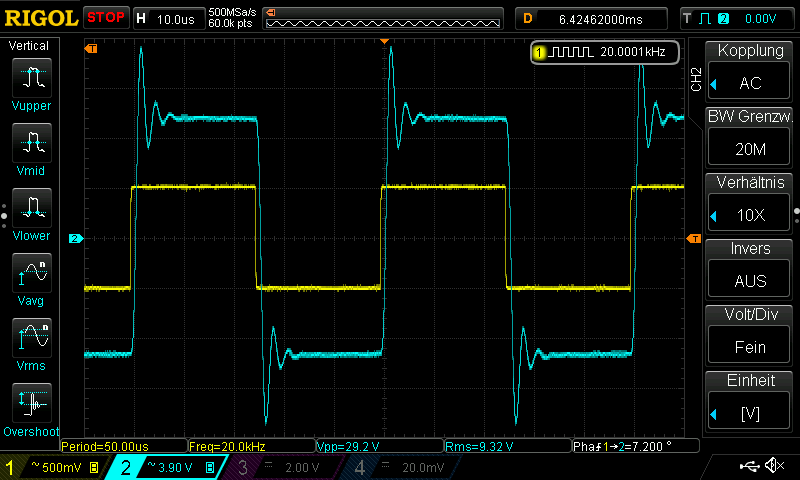

square wave at 9R and about 9WATT with cap load.

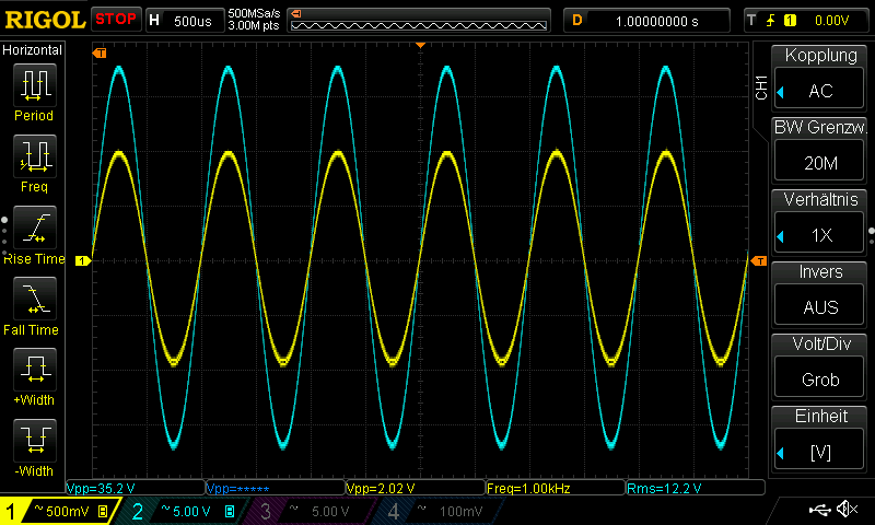

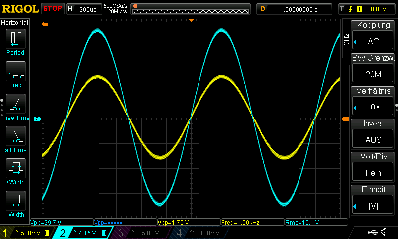

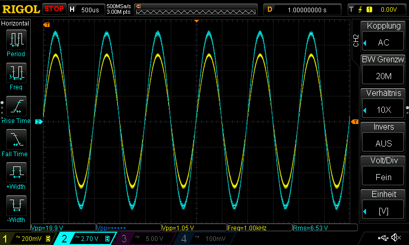

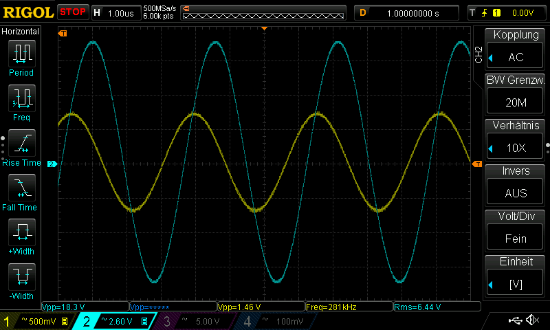

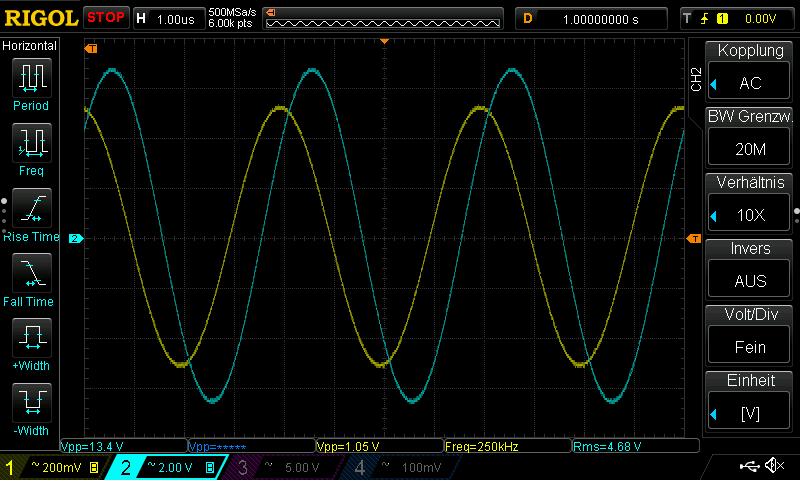

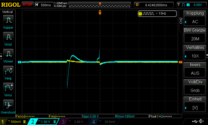

hi
some measurements at 4R and 8R with my L channel.
still DC ofset with 21Vrail too high for my taste.
at home i´v got -48mvDC offset...
tests are fine.
tests are fine.
