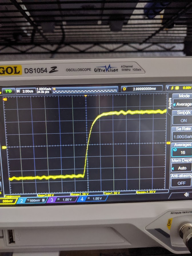

I added an input filter of a 10k in series with a 100 pF shunted to ground, fc of about ~160k.

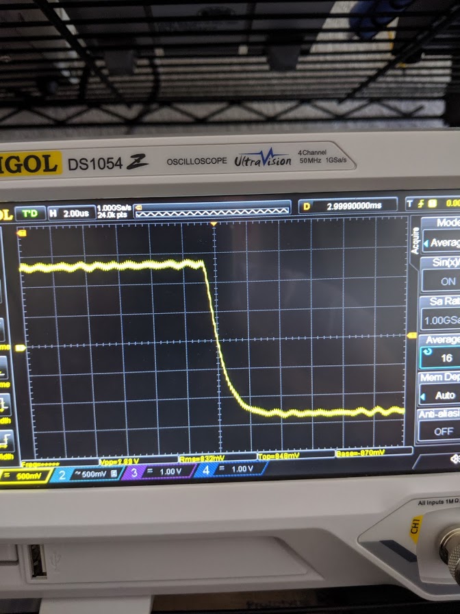

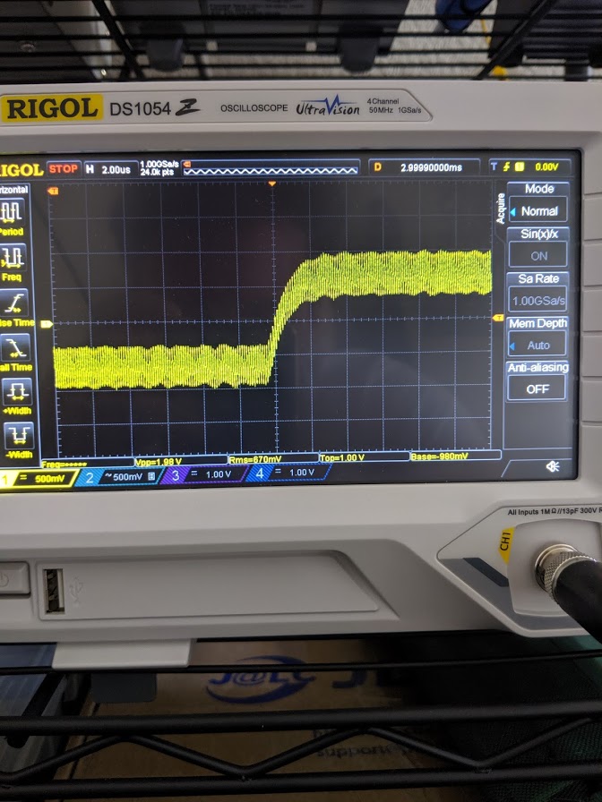

Here are the pics of the square wave response. This is no load.
When I turn on amp and have nothing on input/load (other than oscilloscope), I see the 8 MHz oscillation, that's still present.

There is still a problem due to the 22R stopper resistors and the diffusion capacitance between the base and emitter of the output transistors acting as a low pass filter.
As a general rule a dominant pole created by Miller capacitor in the Vas needs to be at least 10 times more effective than any others present in the circuit.
That makes a compelling case to reduce the stopper resistor values to 2R2.

I see. So the 100 pF across the VAS is fighting with a pole that the base stoppers 22||22 ohm + output transistor capacitances is creating.There is still a problem due to the 22R stopper resistors and the diffusion capacitance between the base and emitter of the output transistors acting as a low pass filter.

I'll pick up some 1 nF caps, don't have any on me right now, that's why I had to resort to 10k + 100 pF.

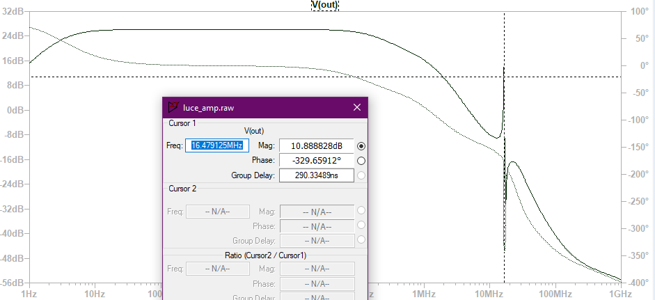

Just simulated again, just a normal AC simulation, looking at output after the zobel network.
Just noticed the big spike at 16 MHz which I'm seeing in real life on the scope.
Picture attached.
EDIT: when I change R14 from 2.2k to 10k, the 16 MHz peaking disappears.
Could R14 be the culprit of this oscillation?
Picture attached.

Just added another 2.2k resistor in series with R14 to ground. R14 is 4.2k now, 16 MHz oscillation still present at output, seems cleaner though.

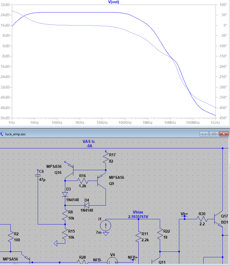

EDIT: I notice when I turn down VAS Ic, the 16 MHz hump starts to get smaller.
Replace current source circuit with an ideal current source. If that fixes the issue, the culprit is your current source.
Hmm... Good point. This might be it.Replace current source circuit with an ideal current source. If that fixes the issue, the culprit is your current source.
EDIT: In simulation, if I put a 1 nF across CE of Q16, hump goes completely away. This might be my issue.
EDIT2: I have a realistic value of 0.1 uF, going to try that. Looks good in sim.
EDIT3: I soldered the 0.1 uF ceramic type cap between the C node of Q16 and the E node (or V+ rail), and in practice it didn't seem to affect the oscillation at all :/

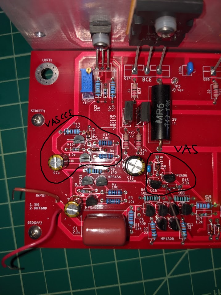

Can you post some images of the insides of your hardware that we might see if this provides any clues.

Will edit this post.Can you post some images of the insides of your hardware that we might see if this provides any clues.
The component references on the physical board are not the same as the ones in the schematic FYI.
It was my understanding that while earthing the heatsink within a chassis is a necessary safety practice (also necessary while prototyping in a higher voltage environment), troubleshooting the amplifier before mounting everything in a chassis was the correct approach.From this shot it appears the heat sink is not connected to earth - I suspected that might so. The best way to sort that is to put everything in a chassis and establish a proper earth system for the electronics.
Do you think earthing the heatsink will solve my oscillation problem?

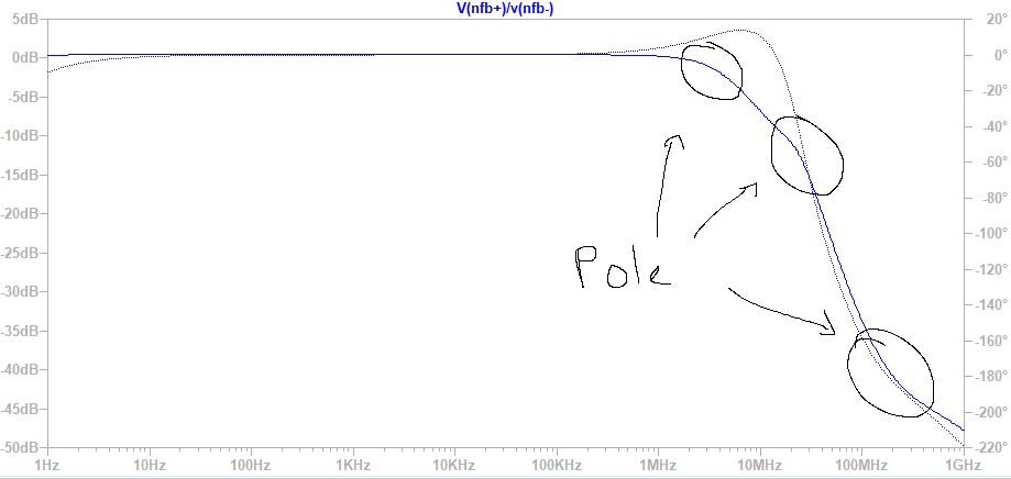

EDIT: I've attached a plot for gain and phase margin, a little unsure if that hump of phase is bad / how it affects reading off the phase/gain margin.
Also, am I correct in saying those rolloff points are poles?
16 MHz lies on -9.57 dB of the bode plot, is this my feedback factor? 22k / 1.2k?
