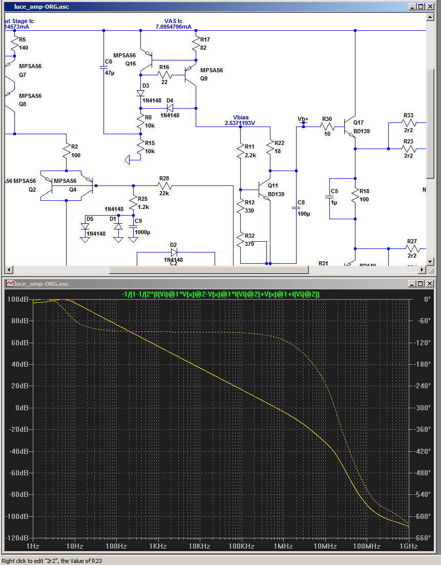

EDIT: I've attached a plot for gain and phase margin, a little unsure if that hump of phase is bad / how it affects reading off the phase/gain margin.
Also, am I correct in saying those rolloff points are poles?
16 MHz lies on -9.57 dB of the bode plot, is this my feedback factor? 22k / 1.2k?

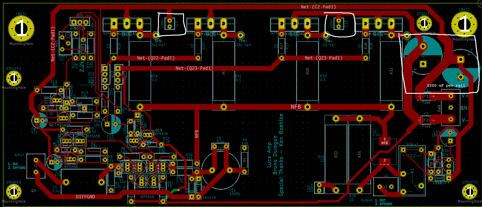

For some reason the image of your board shows you have not gotten around to reducing the value from 22R to 2R2.

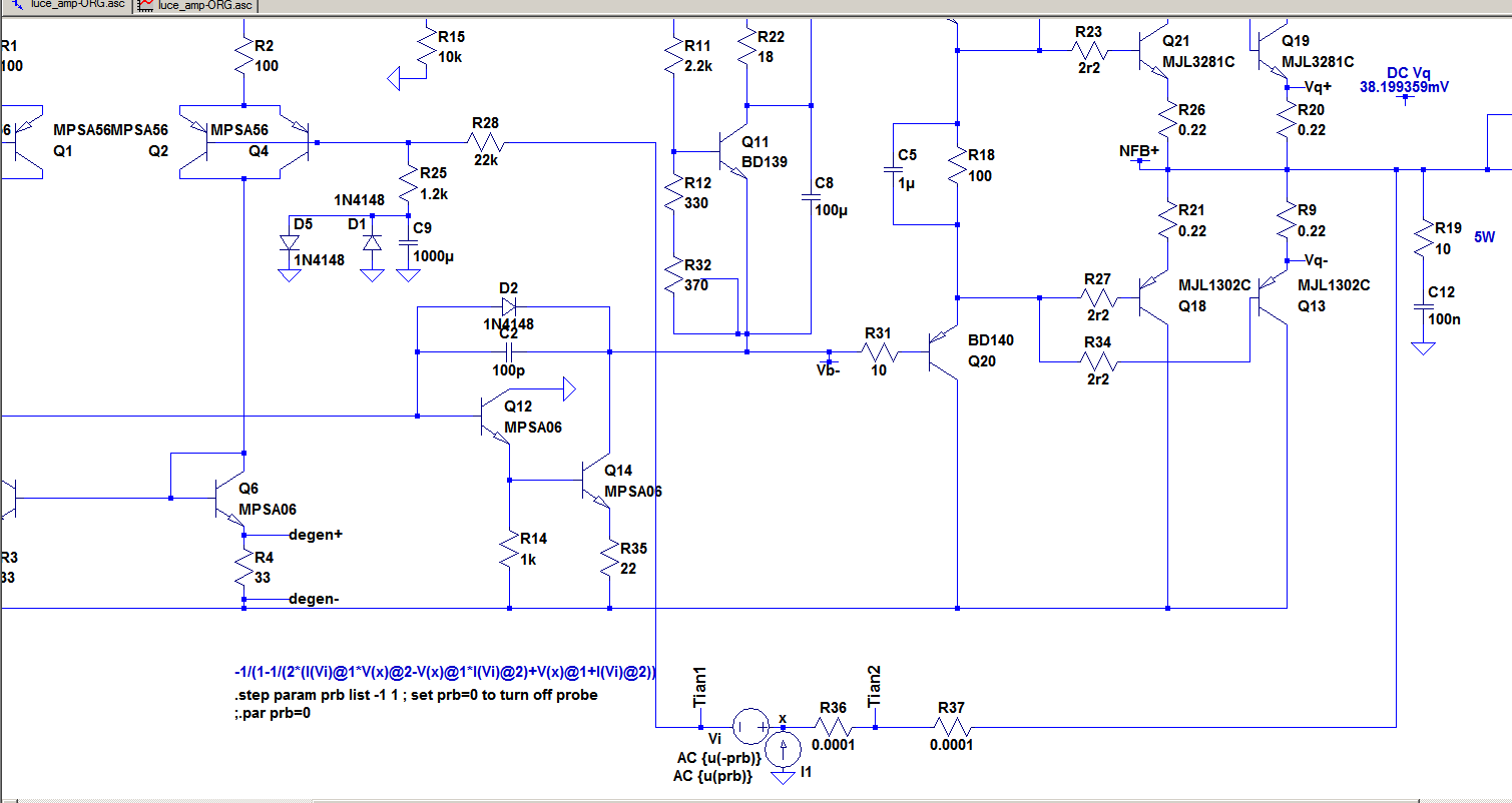

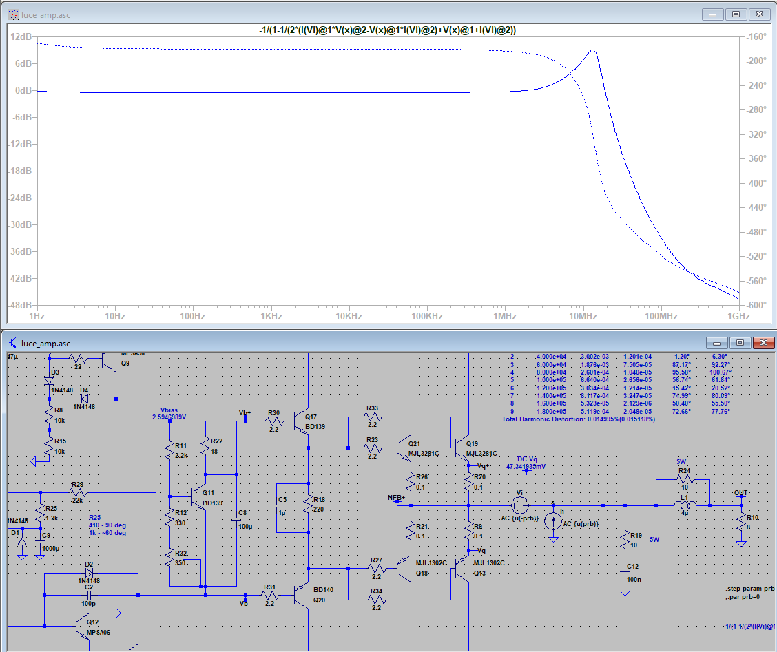

I looked at the circuit using Cordell .models and could not see the issue at 16MHz in your simulation.
This could be down to differences in .models used - some people don't trust those provided on manufacturers websites.
The .asc is attached. After you click run click on vout in the header of the .raw file that results, delete V(vout) in that space and then paste in
-1/(1-1/(2*(I(Vi)@1*V(x)@2-V(x)@1*I(Vi)@2)+V(x)@1+I(Vi)@2)).
I have left that in a comment field on the .asc file where it can be copied.
Also in that dialogue box select cursors 1&2 and click enter.
In the next window drag these cursors to 0dB and -180 degrees. Use the side arrow keys for fine adjustments.
The dialogue can also be dragged for more convenient viewing.
My simulation encompasses the whole circuit including the rf low pass input filter.
The the stability margins look good however the gain at 1Hz is very high so there is a lot of feedback and layout is important.
The gain slope has the shape of a kneecap in a part which looks irregular.

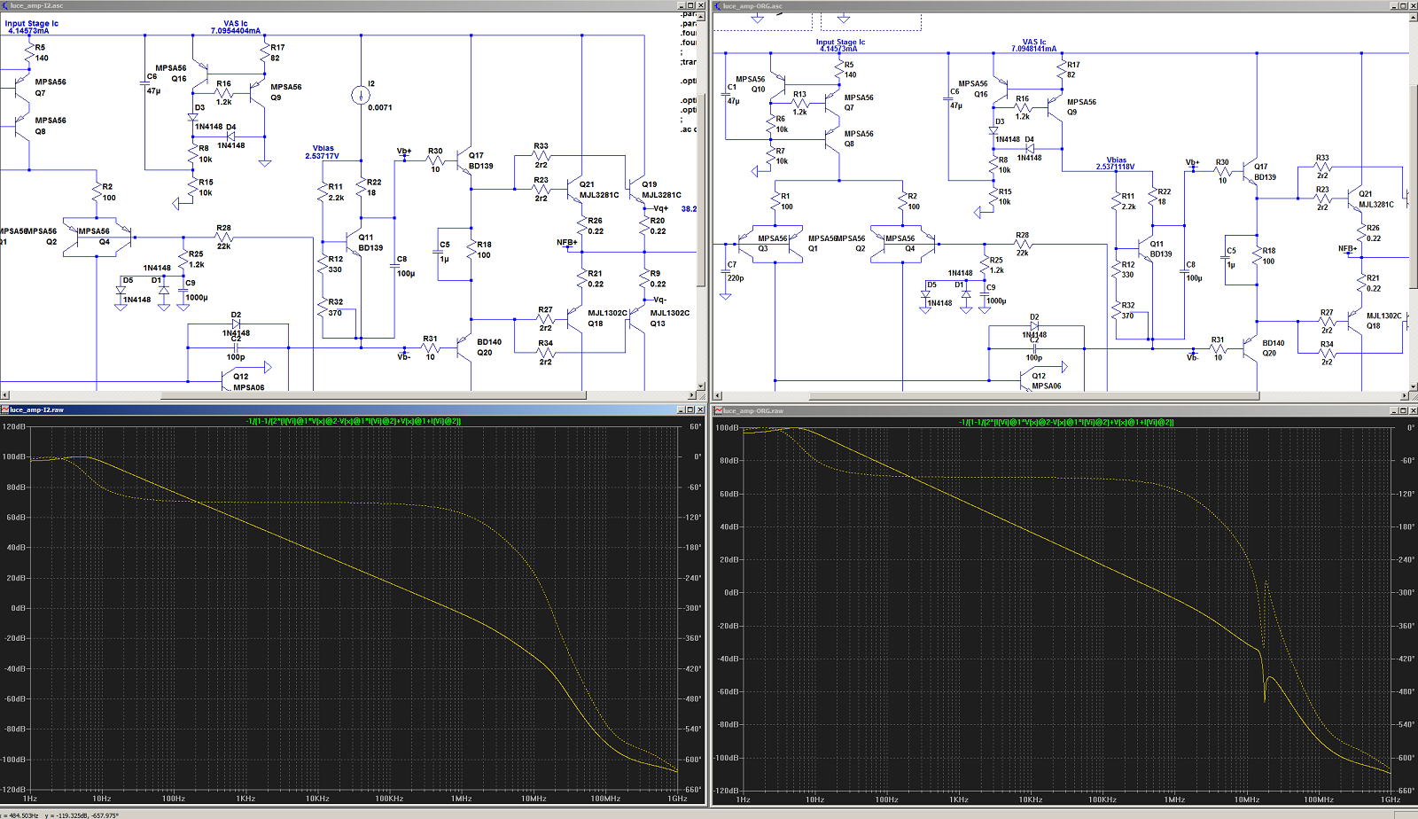

I replaced the CCS in VAS stage with an ideal current source and the loop gain plot is all smooth. Perhaps worth a bit more exploration into the CCS circuit. See the attached screenshot of after-before side-by-side.
p.s. reducing the base stopper at the CCS (R16) from 1k2 to 47R also smooths out the loop gain plot completely.
In the schematic on the left, did you change R16 to 47?I replaced the CCS in VAS stage with an ideal current source and the loop gain plot is all smooth. Perhaps worth a bit more exploration into the CCS circuit. See the attached screenshot of after-before side-by-side.
EDIT: just realized that's the picture with the ideal current source, my bad.
Thank you for the loop gain expression. I noticed in your schematic, you're taking the feedback point from after the zobel network. Is that correct? It was explained to me you put the zobel AFTER the feedback.I looked at the circuit using Cordell .models and could not see the issue at 16MHz in your simulation.
No, I didn't. In that screenshot the left side has the CCS disconnected and the VAS is instead loaded with an ideal current source I2 (7.1 mA).
Please see attached screenshot with R16 changed to 22R. Since the loop gain plot starts to have this "wrinkle" at R16 = 68R, I would not use anything higher than 22R.

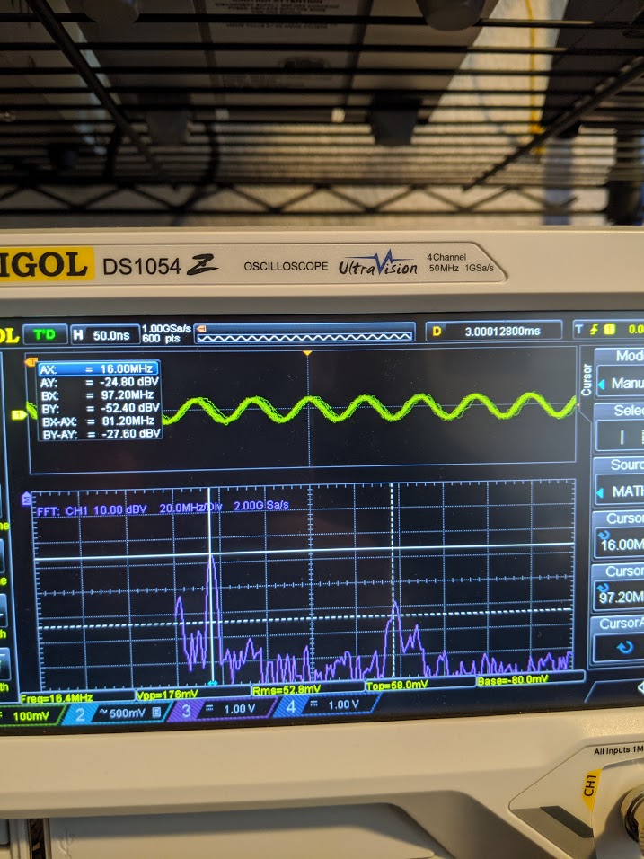

In sims, it seems I have a 75 degree phase margin, seems okay. Just taking a look at the frequency response after the zobel network, I don't see the 16 MHz oscillation either anymore.
On the bench, I changed the 1.2k base stopper to 22 and I'm still seeing the 16 MHz oscillation. But, I still haven't changed all the 22 base stoppers in the driver and output to 2.2, so there's that. Going to keep investigating.
EDIT: here's a probably not trustworthy FFT
EDIT2: Also, even with the 22 ohm base stoppers in, and everything like how I have it in real life, I don't see the 16 MHz peaking in the direct frequency response from the output (in sim) anymore.
EDIT3: I just put my dummy 8 ohm load on the output. The oscillation goes from 177 mVpp to like 16 mVpp. I'm going to try the square wave test again and see if it looks any better.

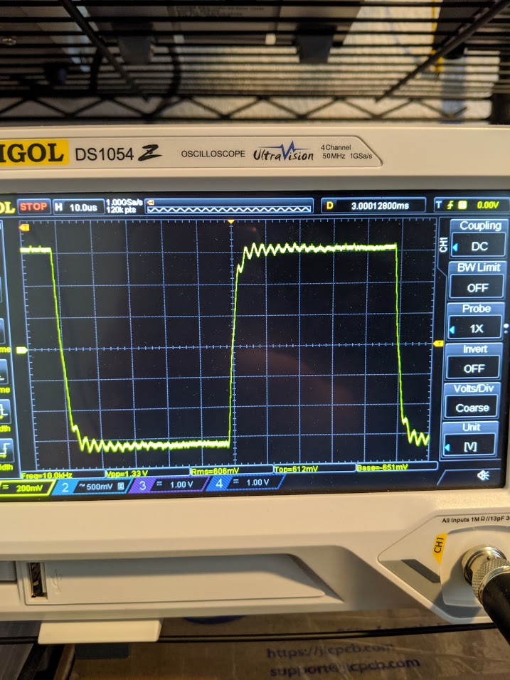

This is the square wave response after the third edit in post 50.
8 Ohm load, 100 mVpp 10 kHz square wave. Input filter of 10k and 0.1 uF before the 2.2 uF coupling cap.
Yes.You do have decoupling capacitors in place on your PCB (C3 and C4), right?
From nattawa's plot, it should be pretty stable. Sometime, absence of decoupling will make weird things.

100 ohm resistor, R4, next to feedback capDo you connect DIFFGND of input and GND of Power together at some where?
I remember from one of your photo, DIFFGND just is floating there. The amp will not work correctly if you leave DIFFGND floating.

- Is this too much ringing?
