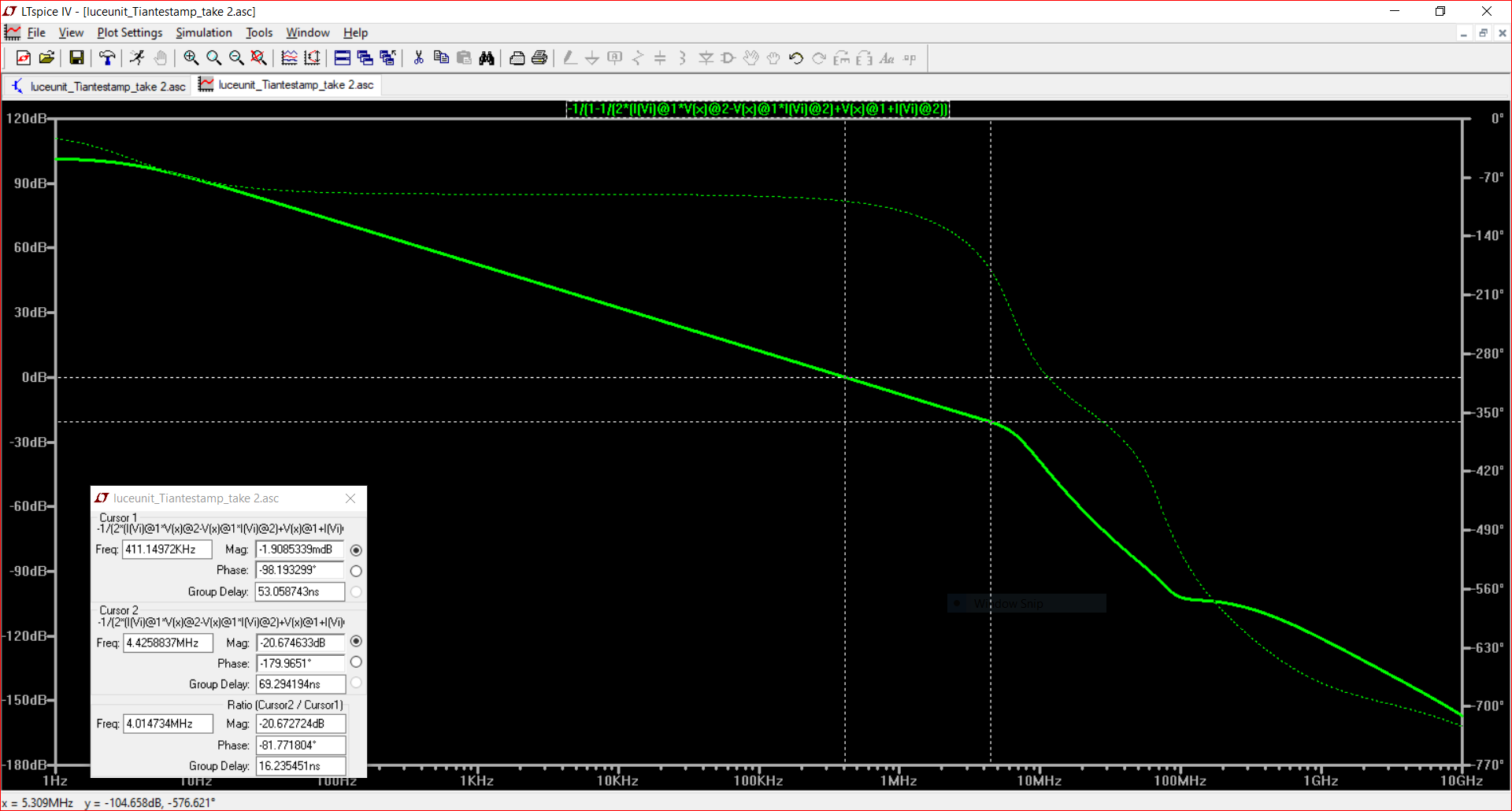

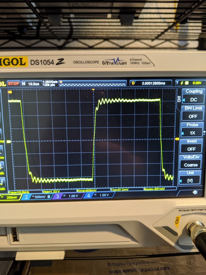

Is this too much ringing?
Do you think degenerating the Q16 of the CCS for the VAS could affect the peaking? I degenerated Q14 and the oscillation did not go away.
EDIT: I'm wondering too if a base stopper between Q16 and emitter of Q14 is necessary.
Hi drinkingcube, simulation shows no impact degenerating Q16 has to the loop gain plot.
By the way to answer you question about the RC filter on the power rails, it seems to be a common practice to add filtering like the screenshot to the front end supplies.

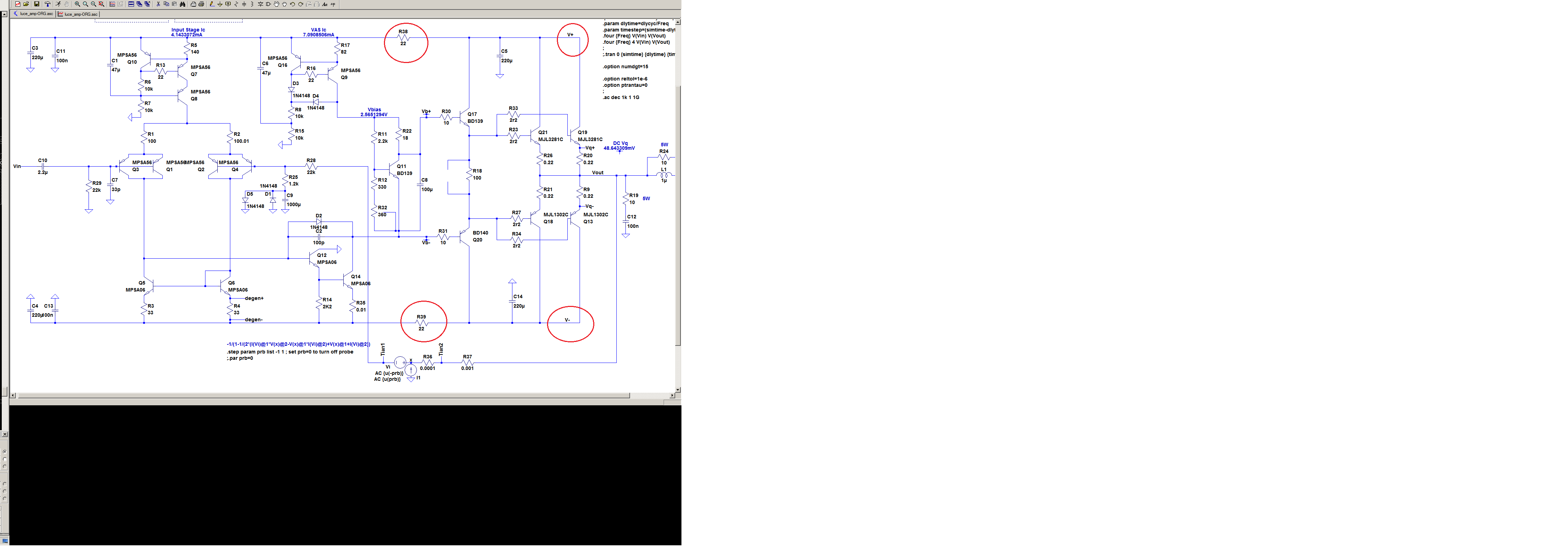

The voltage drop across the 20R is negative feedback into the base of Q14 reducing the Vbe.
sgrossklass commented about the high level of current in the input stage which still applies. In terms of juice it allows over indulgence on the part of Q14.
You will have to hack your pcb to incorporate the 20R or base stopper resistors. That would not be necessary if the current levels in the input stage are moderated.
I have looked at this with an increase in output stage standing current - the resultant plot is attached. See what you think.
At a practical level constant current circuits have good supply rejection and you have these in your positive rail.
The charge carriers in a transistor travel from the emitter to the collector and you have a number of these connecting to and exposed to the negative rail which will see switching artefacts from your output transistors.
You need to have some mitigation especially if you are dealing with 10kHz square wave tests.
An RC filter for the small signal negative rail section of 100R plus 100uF would be sufficient.

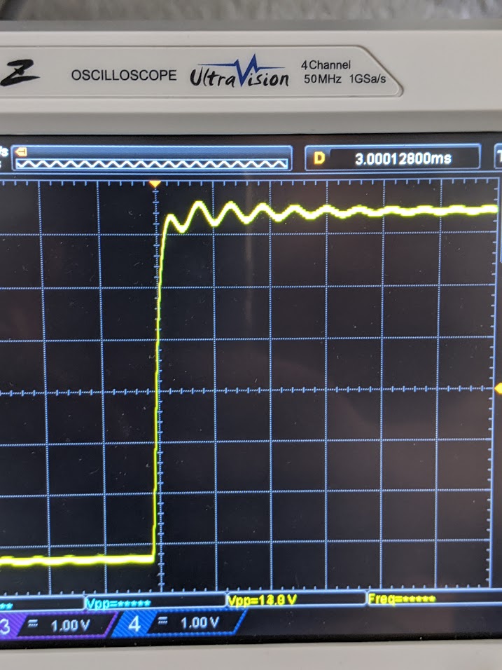

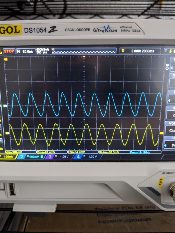

Not sure I'm alone or not but this scope shot has puzzled me,
https://www.diyaudio.com/forums/att...91d1569867713-ringing-img_20190930_112054-jpg
The ringing frequency appears to be nowhere near 16MHz, it is too low a frequency to count 1,600 cycles of it per one 10 KHz square wave period, as would a 16MHz frequency. The ringing ought to be something the loop gain plot does not show us.
Hmm... that's a good point to ask ourselves, would 16 MHz be visible on the square wave? I guess not really, in this case.
I think I was kind of viewing it like, "the 16 MHz oscillation is obviously there, so SOMETHING must be oscillating so if I fix the 16 MHz oscillation hopefully the square wave response would look better."

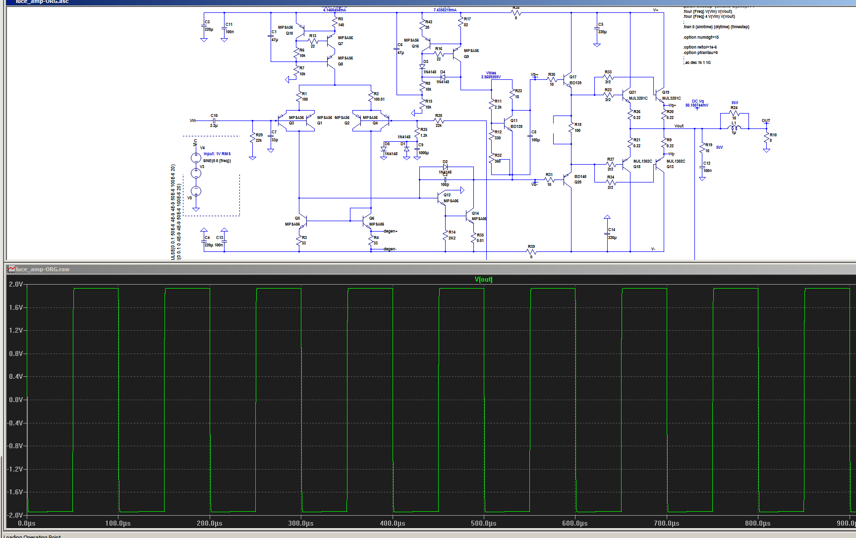

Transient analysis with 0.2Vp-p square wave. the output waveform is flawless😀 no ringing, no 16MHz. 😀
Haha, my sim is showing a perfect response as well 🙂

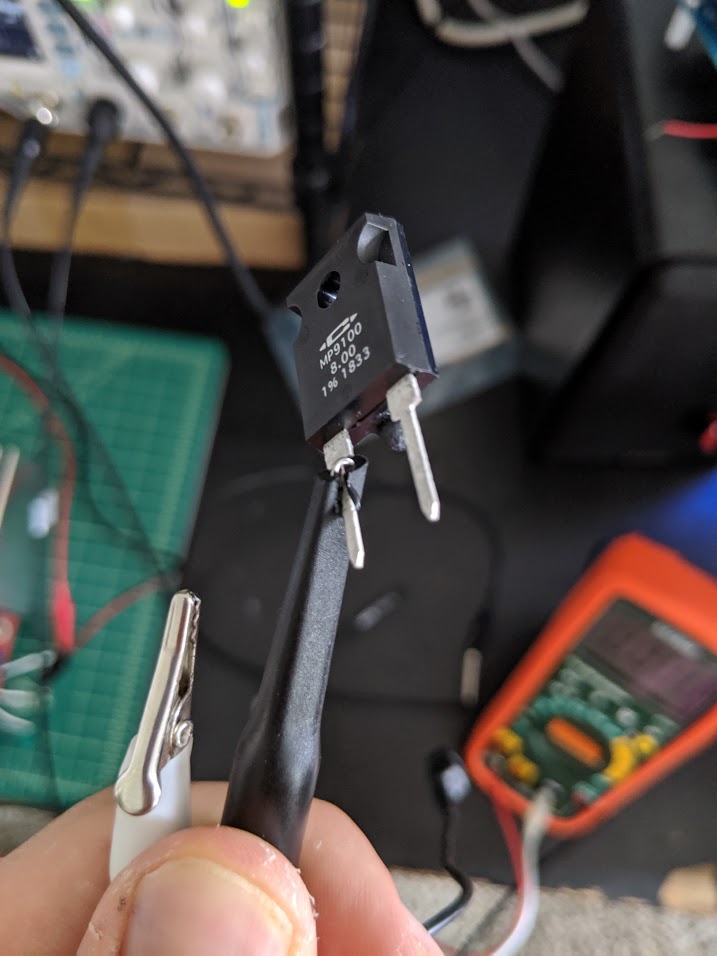

I'm powering the amp off two bench supplies, and I'm not sure if that could introduce ringing at all, but I'm wondering if maybe the issue would go when I build the PSU.
After I do this random processes note taking I'm going to fire it up, put an 8 ohm load on it, and see if I'm still getting the weird behavior from the square wave, maybe even see if it goes unstable with some capacitance across the load as well (at low output levels - for safety).

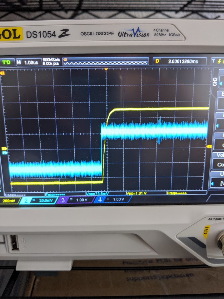

EDIT: Very intersting, I'm seeing almost the EXACT same 16 MHz oscillation at the input, with nothing on input or load (other than oscope)
I'm sorry, R4 is connected to DIFFGND and GND through the ground plane. GND through the ground plane refers back to the power supply. Am I understanding what you are saying correctly?
Measure the resistance between DIFFGND and GND, if it is not zero, you are doing it wrong.

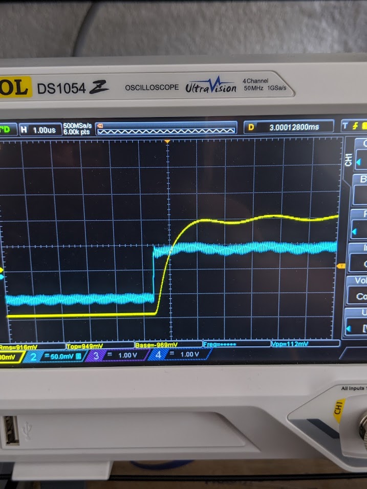

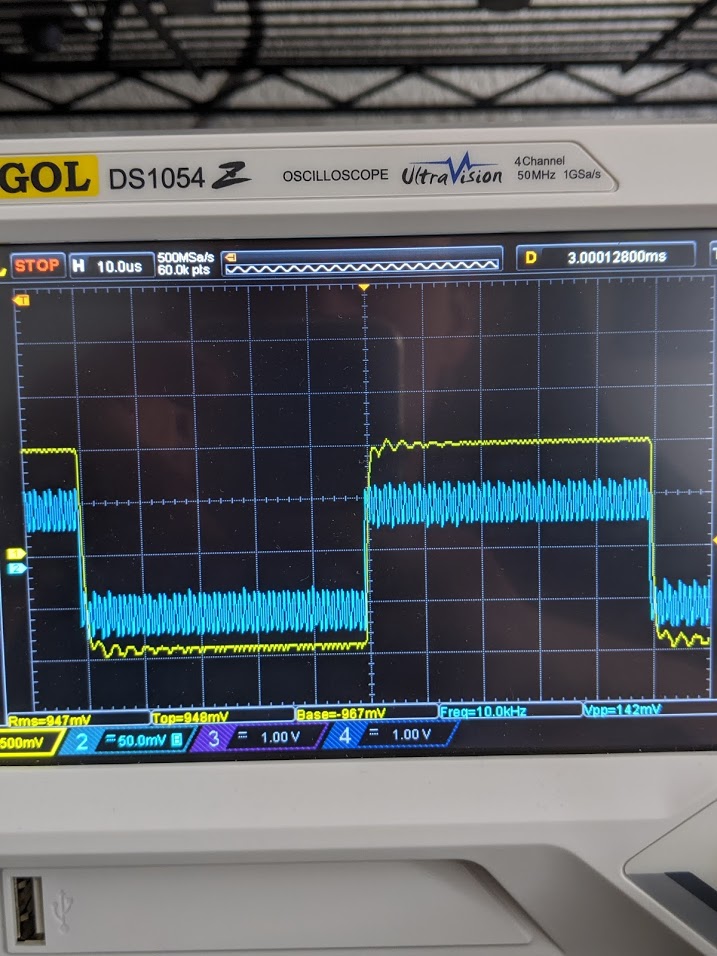

Interesting stuff from looking at the input as well, going to edit this post with pictures in a sec.
Left to right: (blue - input, yellow - output)
1. 8 ohm load, scope on input, scope on output
2. 8 ohm load, scope on input, function generator on input, scope on output
3-4. 10 kHz square wave, 8 ohm load, scope on input, scope on output, 3 is a triggered view, 4 is scope just running normally

Brothers.
I am here bearing good news.
The source of the oscillation has been found, and fixed. Attached is the square wave response, looking absolutely gorgeous.
jxdking, your suggestion about a signal showing up at the input node and the LTP CCS being unstable was completely on point.
mjona, first I tried your suggestion about reducing the LTP current, went from 140 R to 220 R for R5. To no avail, this did not stop oscillation, maybe decreased it.
Then I thought to myself, what the hell, I remember natawa saying just for safety I should change R13, the base stopper for Q7, from it's value of 1.2k to something more conservative, like 10, or 22.
So, my next step was to carry out just this. I went from 1.2k to 22, hooked up the supplies, put the scopes on, and while viewing the o-scope with NO LOAD, all I could see was noise. What an amazing feeling. I put the function generator back on and tried the square wave. Looks amazing, thanks for all of your guys' help. Really something special, thank you. Looking forward to building the second channel up, with all the modifications:
- 220 R + speedup cap in between driver emitters
- base stoppers to 2.2 instead of 22
- base stopper of CCS from 1.2k to 22
- degeneration of Q12 to 4.4k from 2.2k
- degenerate Q14 with 22 R
Again, thank you all so much, the help is so appreciated.
EDIT: Attached is another picture with 8 ohm load and higher amplitude of square wave.
EDIT2: Attached is what happens when I try to do a max power test haha. Gotta put it on heatsink. Actually, just took a look at it, the dummy load is busted haha, reads 11 ohms now crap.
