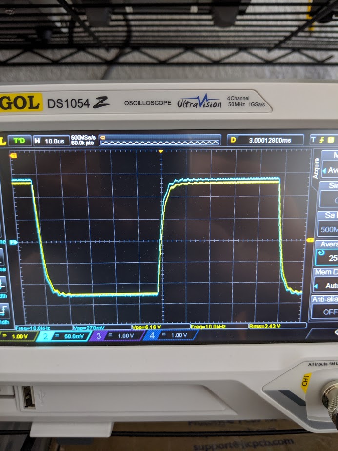

Here's the square wave with a 10 ohm load (blew up my 8 ohm dummy load) and the input slowed down.
10k R + 0.1 uF input filter, no series 1k to the input cap, and it seems to have gotten rid of the ringing with/without the load attached.

Hi drinkingcube, that wave form doesn't look like the 10K-ohm - 0.1uF LPF is in working. 10K-0.1uF makes -3dB at 159 Hz and should have flattened your 10KHz square into almost a straight line with wiggles of a few mVp-p.
Crap, sorry I think I remembered it wrong. I'm pretty sure it's the 100 pF from earlier. Let me check my post history.
Yeah, post 27, Is this too much ringing?
That's my mistake sorry

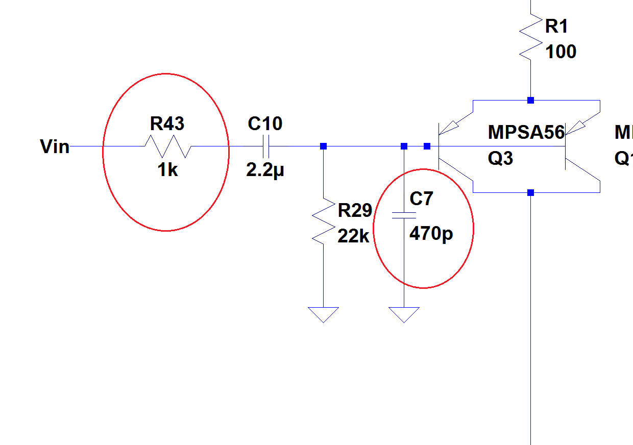

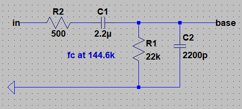

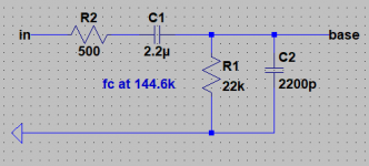

The LPF that you were given suggestion about looks like the R43 and C7 in the attached. Doesn't have to be 1k-470pF, can be other combinations with your available Rs and Cs as long as the product is around 0.47E-6, with R43 in the range of 100-2K ohm.

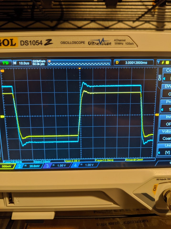

See attached pictures. Is the slight overshoot from the 60 ish degrees of phase margin or am I seeing it slew limit as the input square wave is overshooting as well.

This is quite a lot different from the image shown in post 105 - that was without any load on the output.
The peak-to-peak voltage is lower in the latest image and seemingly at the component level the LPF is the only thing you have changed.
The peaking looks like loss of high frequency gain (-12dB/Octave) within the amplifier.

LPF has changed, Vpp levels have changed, response doesn't change much at all when I increase input levels.
Post 105 had a 10 ohm load, and so did the picture you're commenting on in your post.
With that input LPF and the signal amplitude there shouldn't be slew limiting. Since we are still seeing the ringing (that's now riding over the overshoot), we probably could bet on that it was not caused by slew limiting.
Was the input signal trace on the scope ahead of or after the LPF? If after, would you be able to probe it ahead of the LPF as well with a third channel of the scope?
Yes. It was scoped before the lpf. After I do my weekly 10 hours at work I can scope it.
If that is the case (that the blue trace in post #110 scope shot was probed off ahead of the LPF), which I hope not, then the ringing is more likely the result of the function generator interacting with its load than being generated by your amp --- your amp had been being fed with garbage to begin with.
