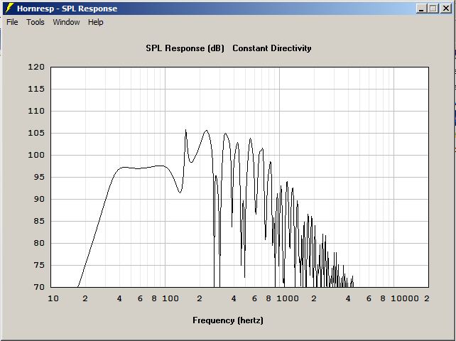

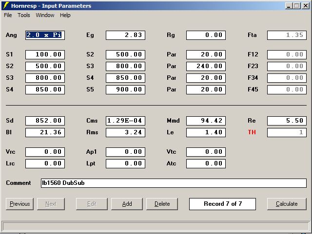

How does this look using the Ande LB1560 which I think sims way better than the LB15-1 in tapped horns and only costs $50 extra. Can anyone see anything wrong with the charts? I
That plot does look nicer and its nearly double the power handling, i would definatly rather use that speaker, provided it it doesnt have problems. Is this plot for the cubo 15 extended though?

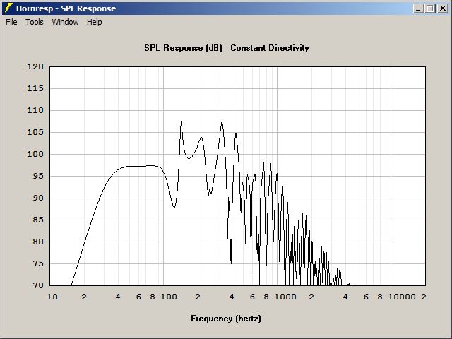

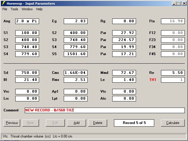

Hi FreakyShotGlass,
The Hornresp input posted in Post #82 does not seem correct. When double-clicking on the Sd value I do not get the manufacturer's T/S values. Also, using the values in your input screen I do not get the same Hornresp SPL plot that you are displaying. A Sd of 852cm^2 gets you closer to the manufacturer's T/S when using Hornresp to recalculate the values.
I'll attach the manufacturer's data I used as displayed by JD's Sound & Lighting, and a Hornresp input screen with T/S based on Sd=852.
Thanks for the info tb46, did not know that you could do that double click on sd thing and was kinda of guessing the sd since annoyingly it is not published. I will tweak the design with this new info and see what I can come up with.

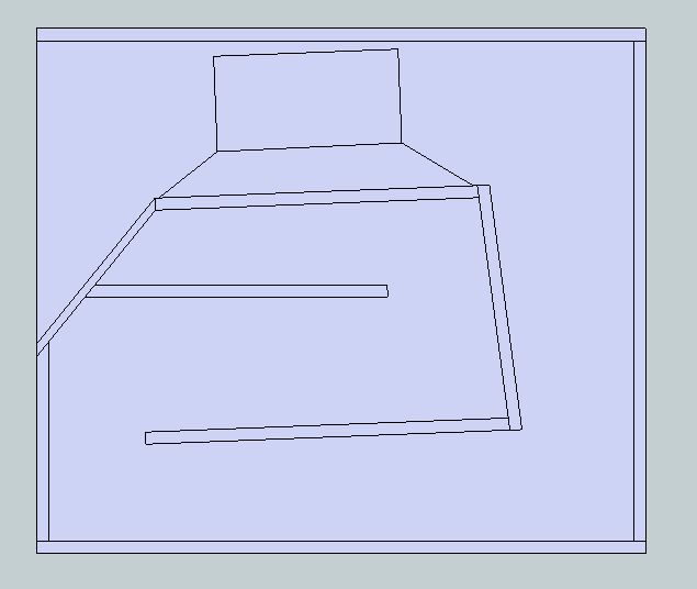

After a bit of tweaking with the new specs as pointed out above for the lb1560 it is obviously a great driver for tapped horns. Here is a 196L that shoulod get down to 35hz with some oomph.
