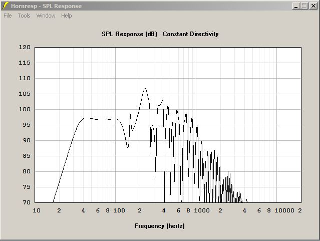

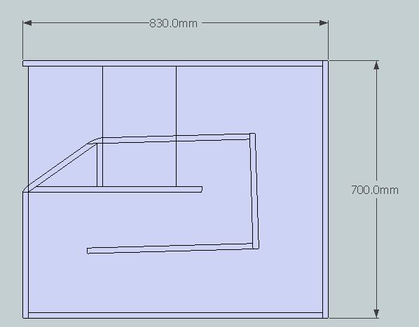

so you want a ~200ltr cab that does 35hz flat with the ande LB15-1 driver ,like djims sim from post 103?
something like 45 wide 60 deep 80 high?
Pretty much yes, as long as its portable and carry-able, like the ss15 is (under 30kg)
If not I will continue with the plan for dedicated boxes for the studio/home and PA.

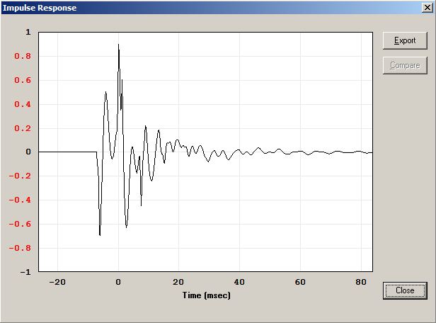

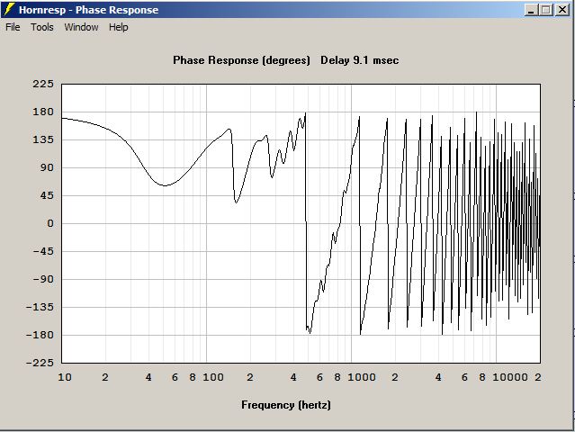

If you can I would highly reccomend the LB1560 instead of the LB15-1, I have found that in general it just sims better in TH's. This is as low as I could get a design with decent SPL and still <200L, I'm sure some of the guru's could improve on it and I'm sure that the folding scheme here isn't the best.
