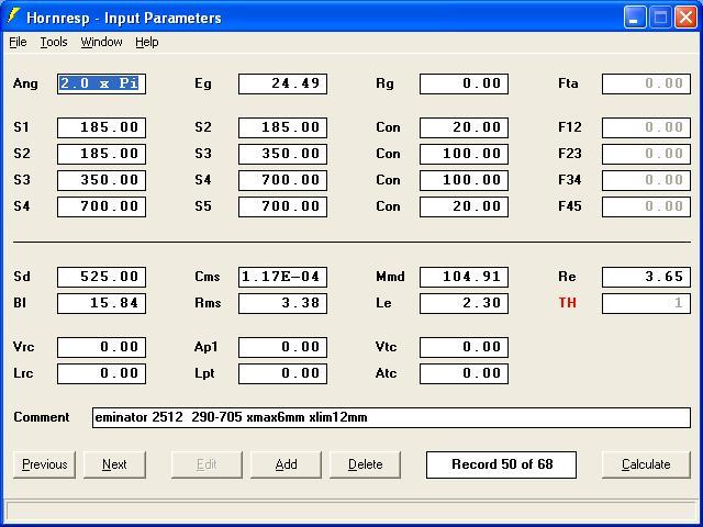

How about this...
Emininence eminator 2512 driver (which is cheap) Other 12" drivers work as well.
It's a 'cute' pa sub... aka small, just like you are asking. 17x20x22 About half the size and half the output of the ss15. Find a wall or corner for it, and it works exceptionally well. (about 130db@50hz with 150watts)
If you've built other folded cabinets, the attached picture should give you all you need.
That looks really good actually :D. Do you have a link to the thread of this design, if it has one? And would the lab12 be a lot better in this?
That sure is small, Even a bit bigger and higher wattage would be better but that's the best I have seen so far and a definite option.
Thanks Jbell,
no build threads -- I've built them for dance studios using a philips HTIB to power them. In that setting they work really well.
Delta 12lf (and the 4 ohm 12lfc) is another driver that works. LAB12 not so much. This design doesn't really have the gain of a typical TH that I design -- it's primary goal was cheap build and small size. (wholesale 2512 is $64, buy.com has them for $71 each) However it takes 2 of these to equal a single ss15. 35hz high pass required.

The red dots were so no one would confuse which side of the board the measurement was to be taken on. It's just a cell phone pic of my template board. (I always do templates of all of my cabinets. and funny thing is... this one is on the back side of the ss15 template...)
Draw it out full size on a scrap piece of plywood and it'll all make sense. No I've never put it into cad.

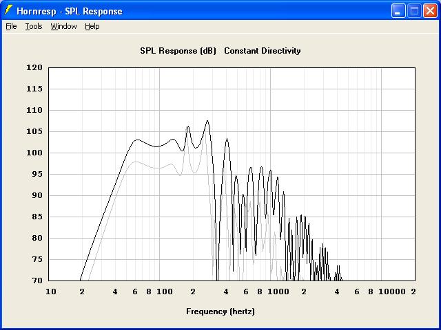

This cabinet has almost exactly the same response profile as the ss15 at -6db efficiency. Double cabinets/power and you get back that 6db. Now max power... that's a different story. 4015lf's etc for the ss15 get you more under the hood so to speak... vs drivers available for this little cabinet. I also don't think this cabinet would keep up with flipc's TH mini-clone with the 12ps100 driver for example.
What this cabinet was designed for was for a $100 sub, that's small enough to be acceptable indoors (living rooms, etc..) while still giving PA level sound if you can find a corner for it. Specifically I designed it for my brother and dance studios where 150watts at 4ohms was the power available. (his girl is quite the dancer) There are some denver studios that have good sound these days...

and if you want to build the 12" box... making it 2" deeper (lengthen all horizontal boards by 2") gets you about 5db more 35hz, and doesn't mess up the taper enough to worry about.
The big thing is to find a 12 that works great in this box that will take the power you want to put into it. The eminator 2512 really doesn't want more than about a couple hundred watts before its outta gas, and the delta 12lfa takes more power, has a bit less xmax, a bit more xlim... so it's a little more 'goof proof' but really doesn't get you much more overall spl.
