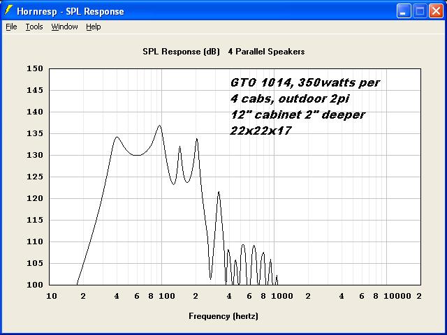

Got what you need.... can you get the single coil 4ohm GTO1014 cheap?
Goes to 35hz, needs 30hz highpass. stays within xmax at 350watts.

@revboden witch sub is that sim?
lab12 gen 2
