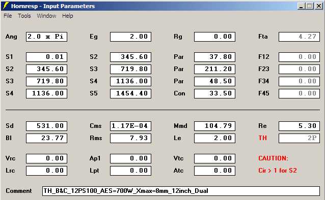

I just revisited and changed around an old design for 2ea. B&C 12PS100 in a tapped horn. For a first try it didn't come out too bad, and it comes in at 282L external volume (9.95ft^3), or 207.3 L_net in Hornresp . These are on sale right now at Parts Express.

This driver was the best one we tried in TH12, pass-band 24dB/8ª from 40 to 96Hz.
SPL is good, despite not that impressive, but cone control is great.
