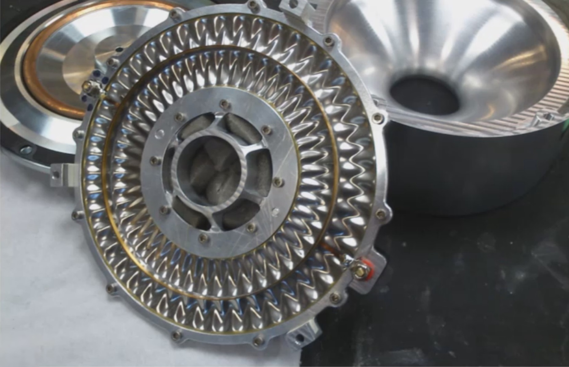

The Axi2050 is quite special, you might want to scroll through the thread to find out.
Just a glimpse at the diaphragm suffices.

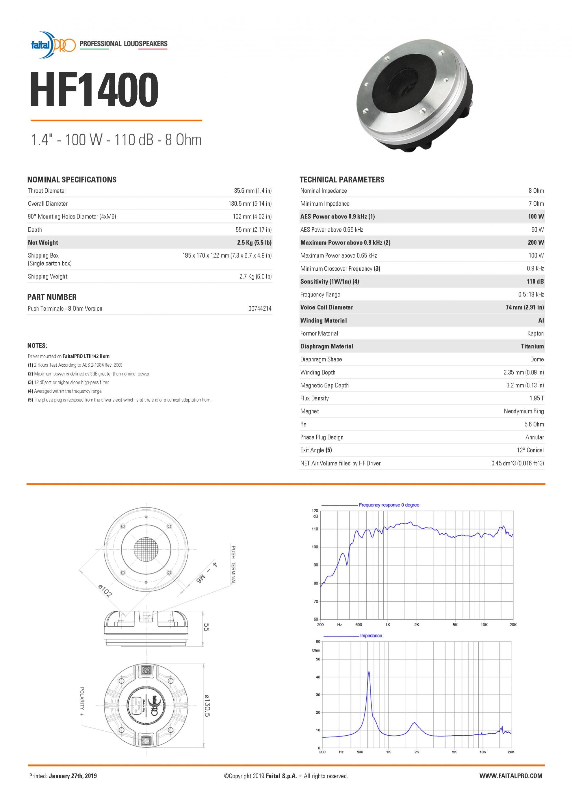

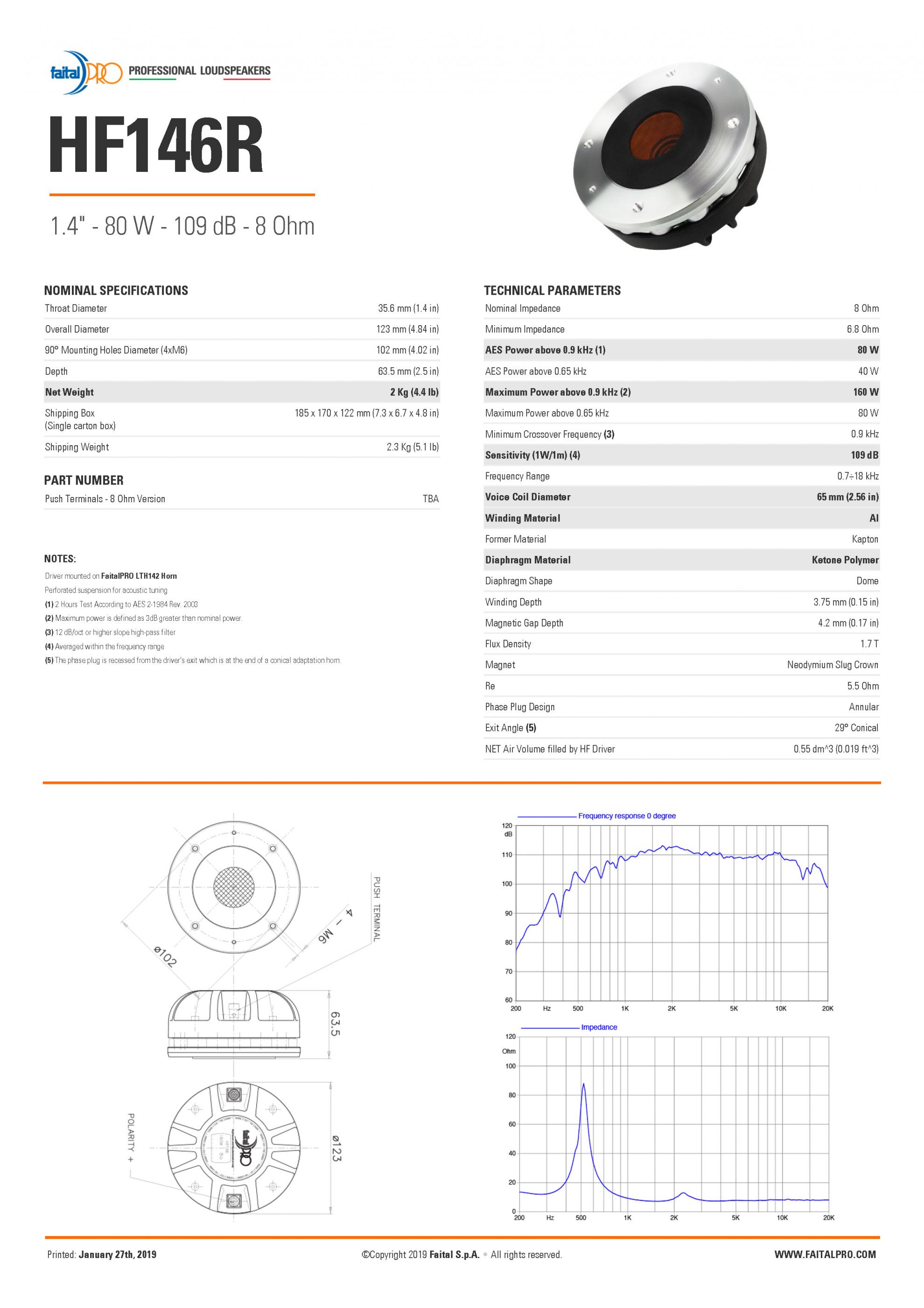

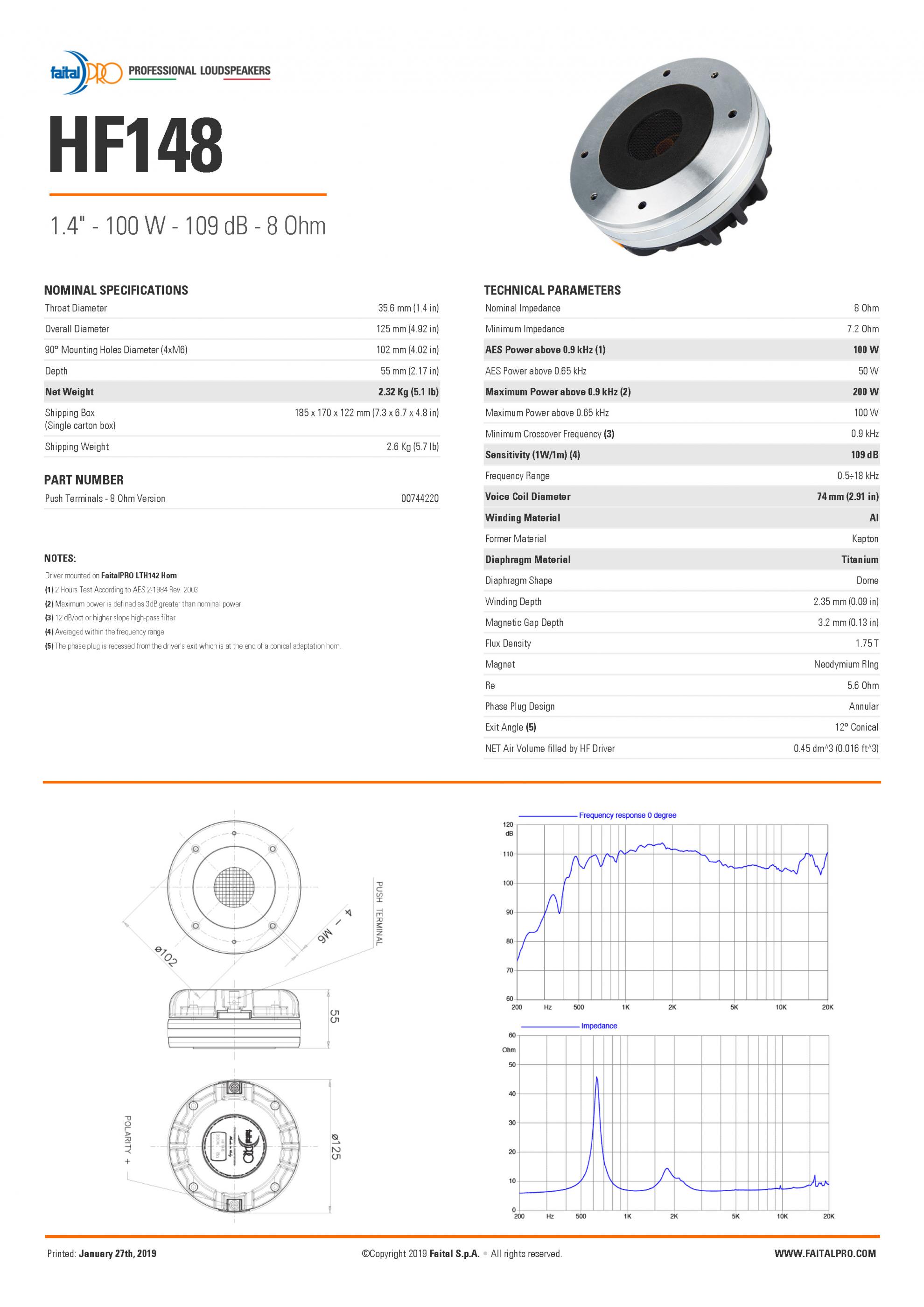

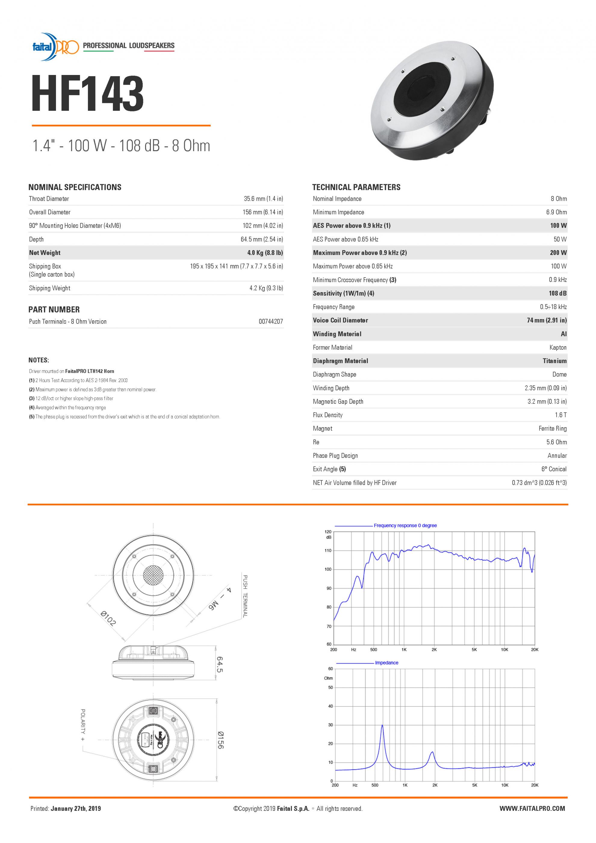

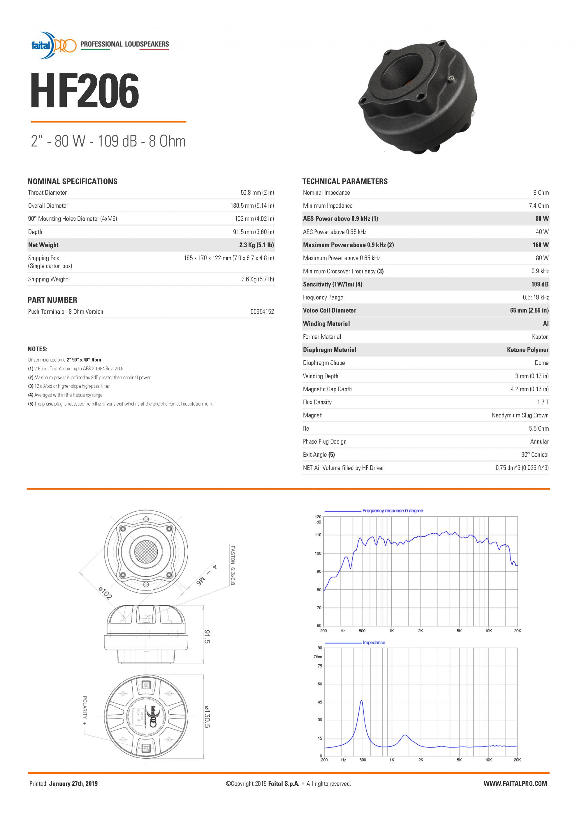

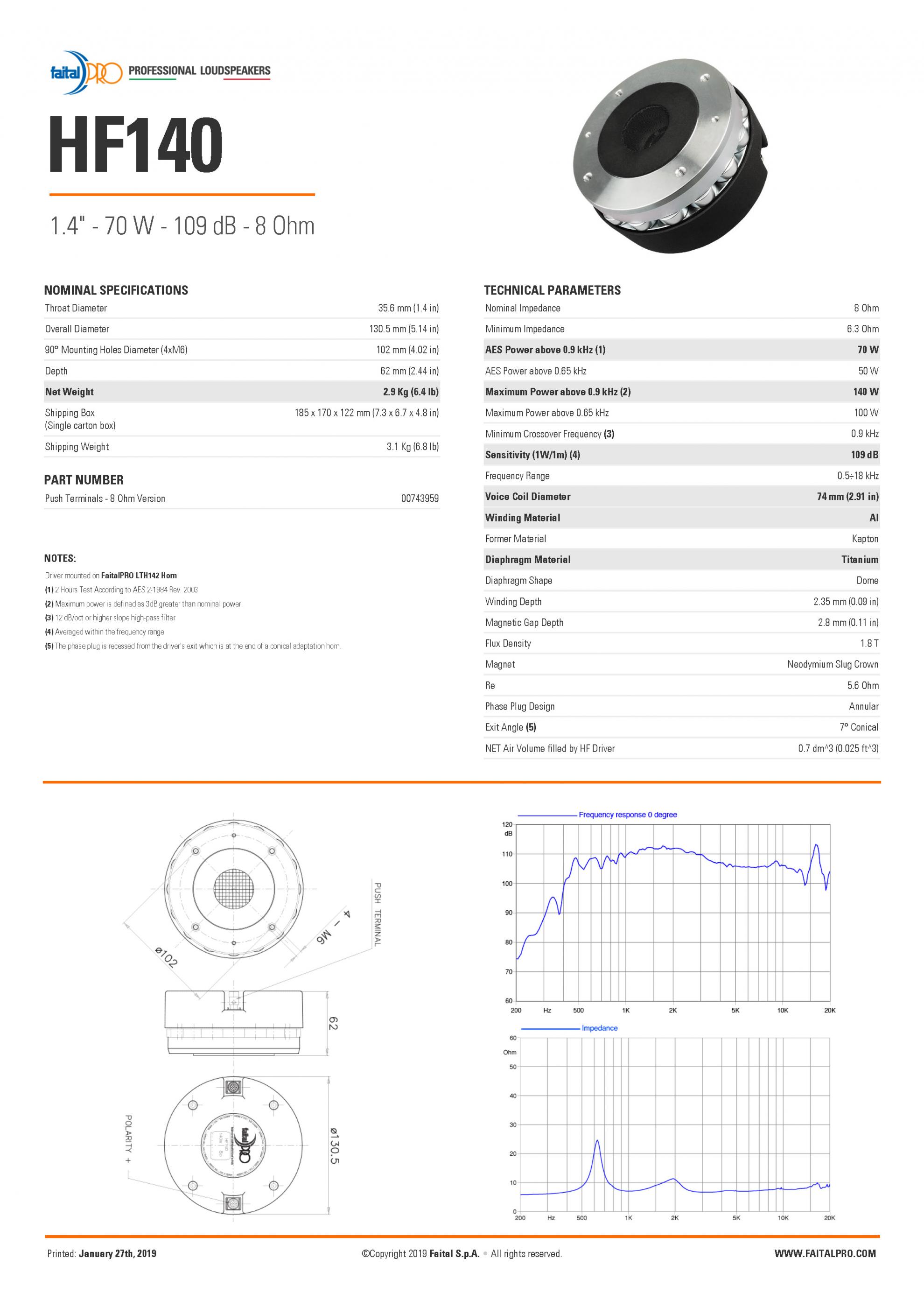

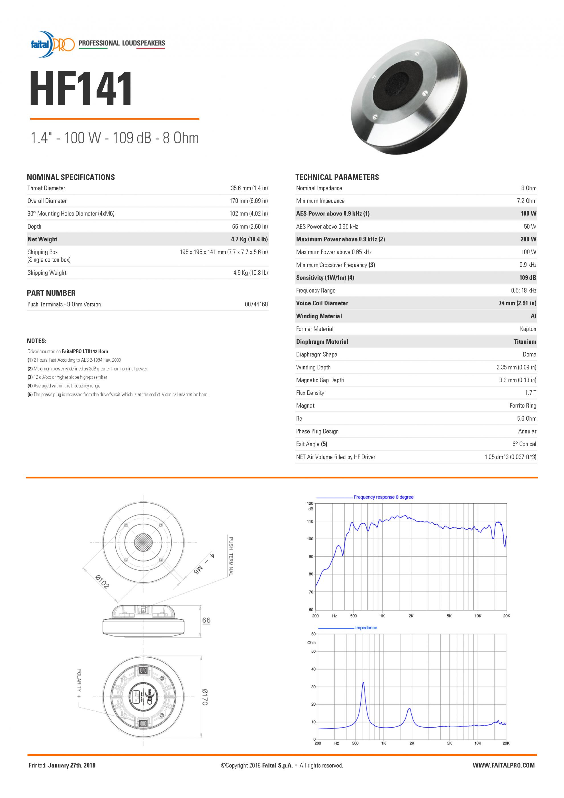

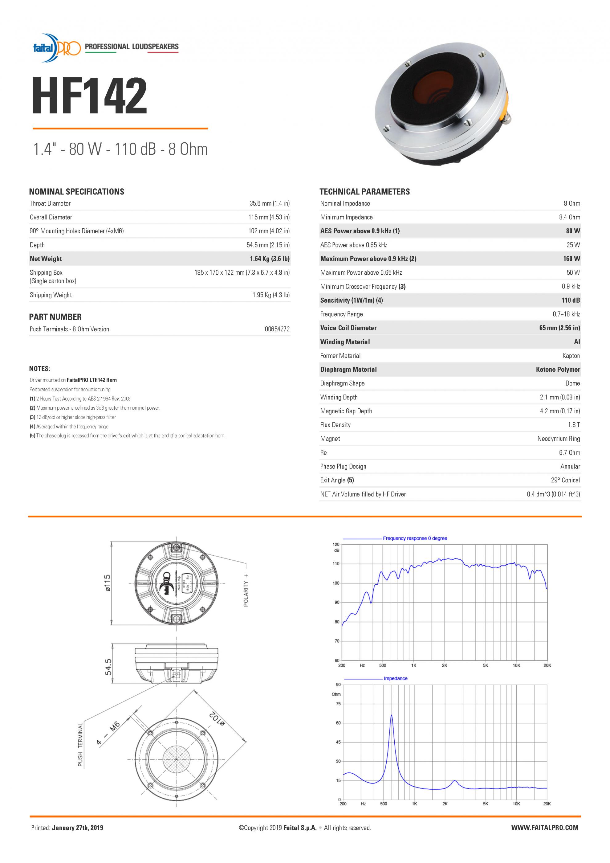

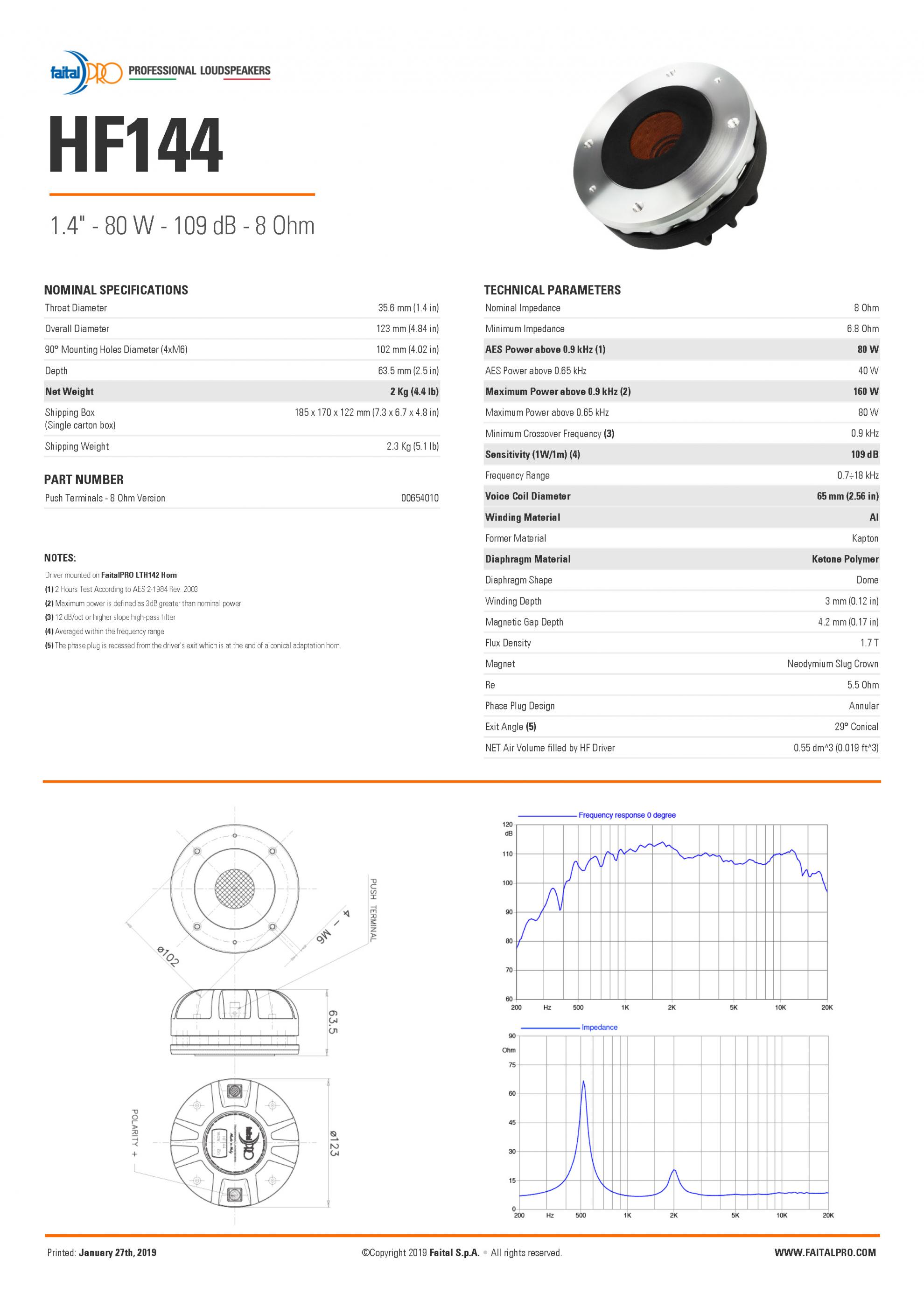

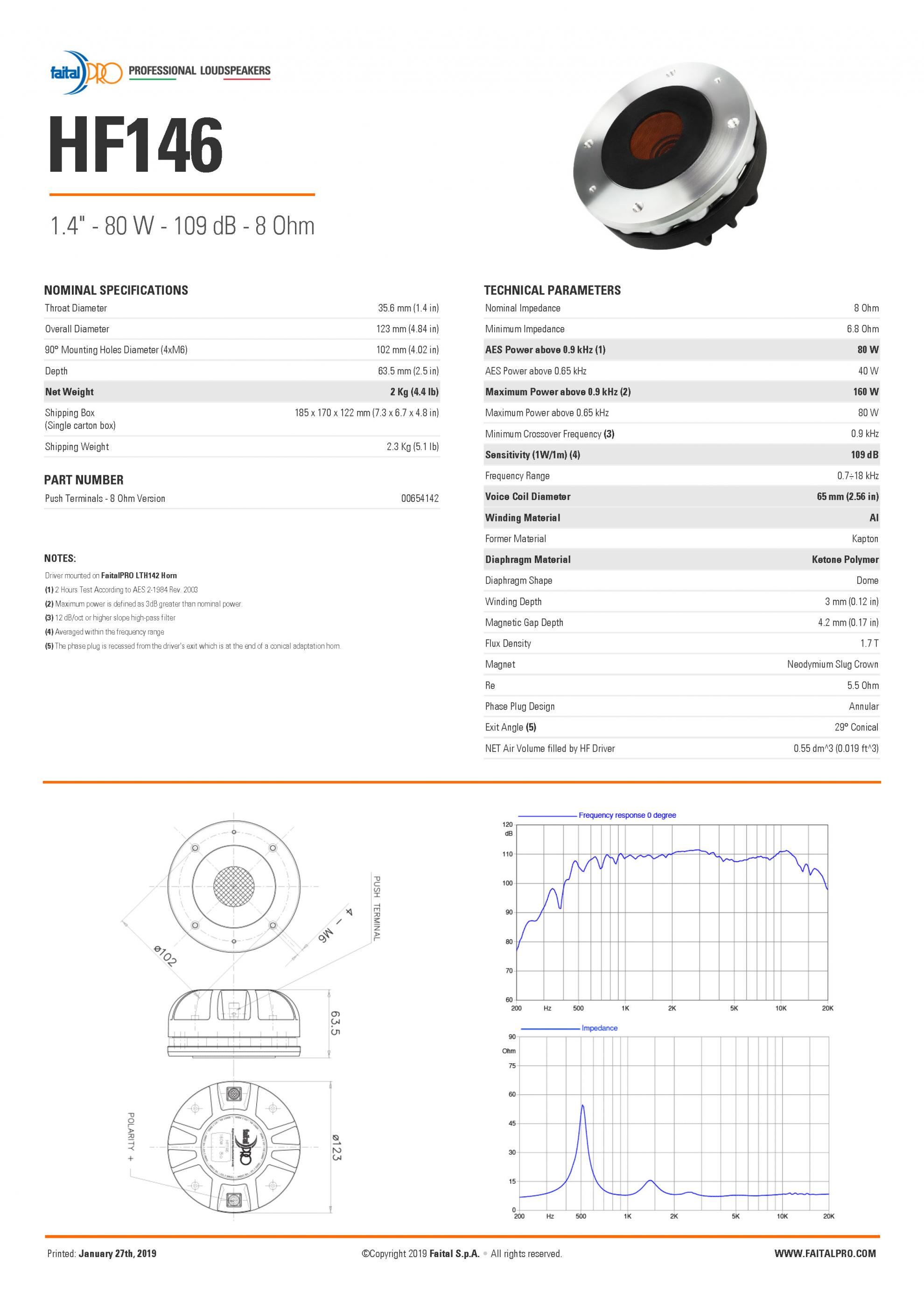

FaitalPRO 1.4" 8Ω Collection:

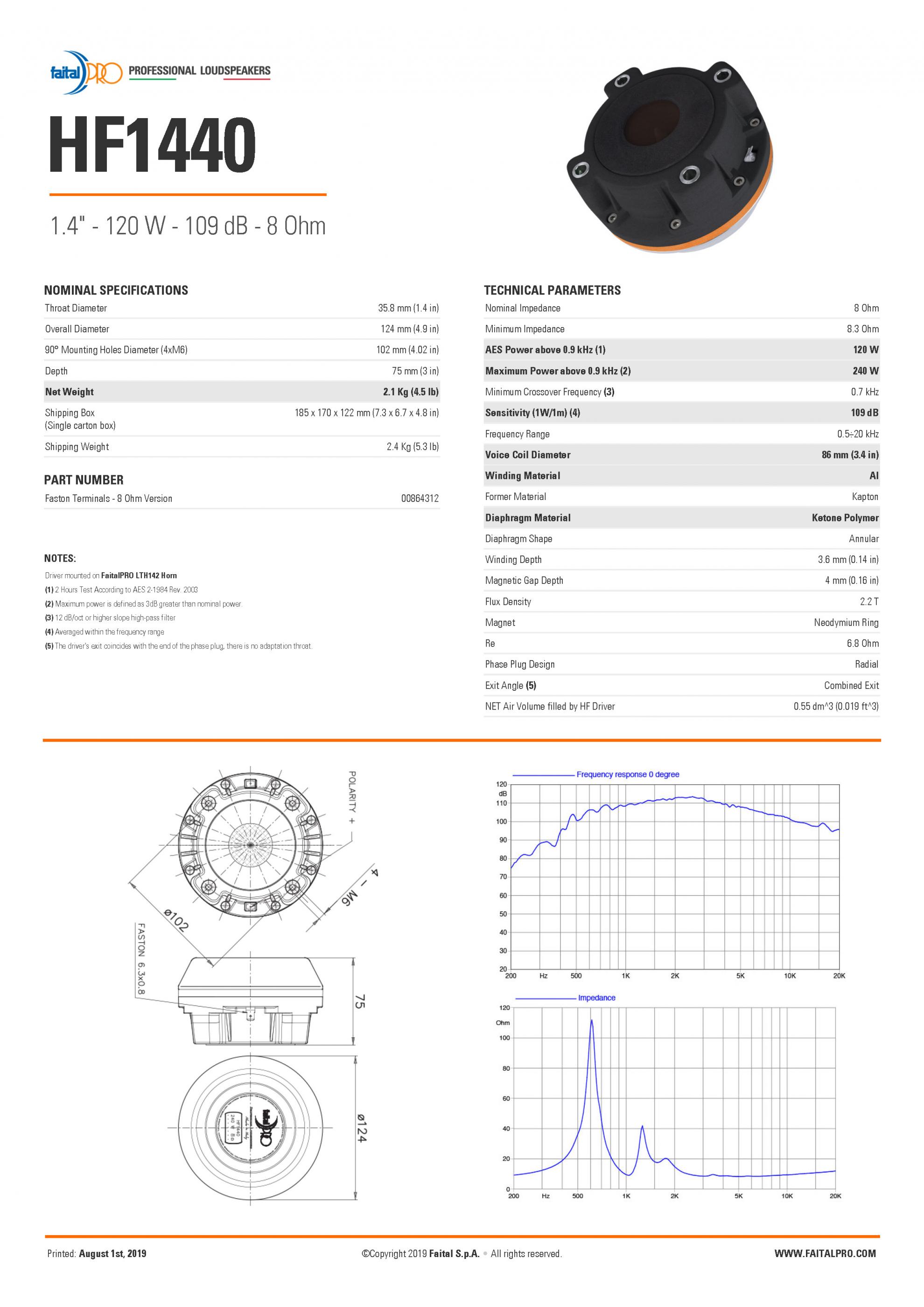

Which 1.4” would u choose Ro808 to pair with the mr 564 and why? Would going for the 1” units still be a suitable choice for better High freq quality? (Noting that the 1” won’t be able to play as low)

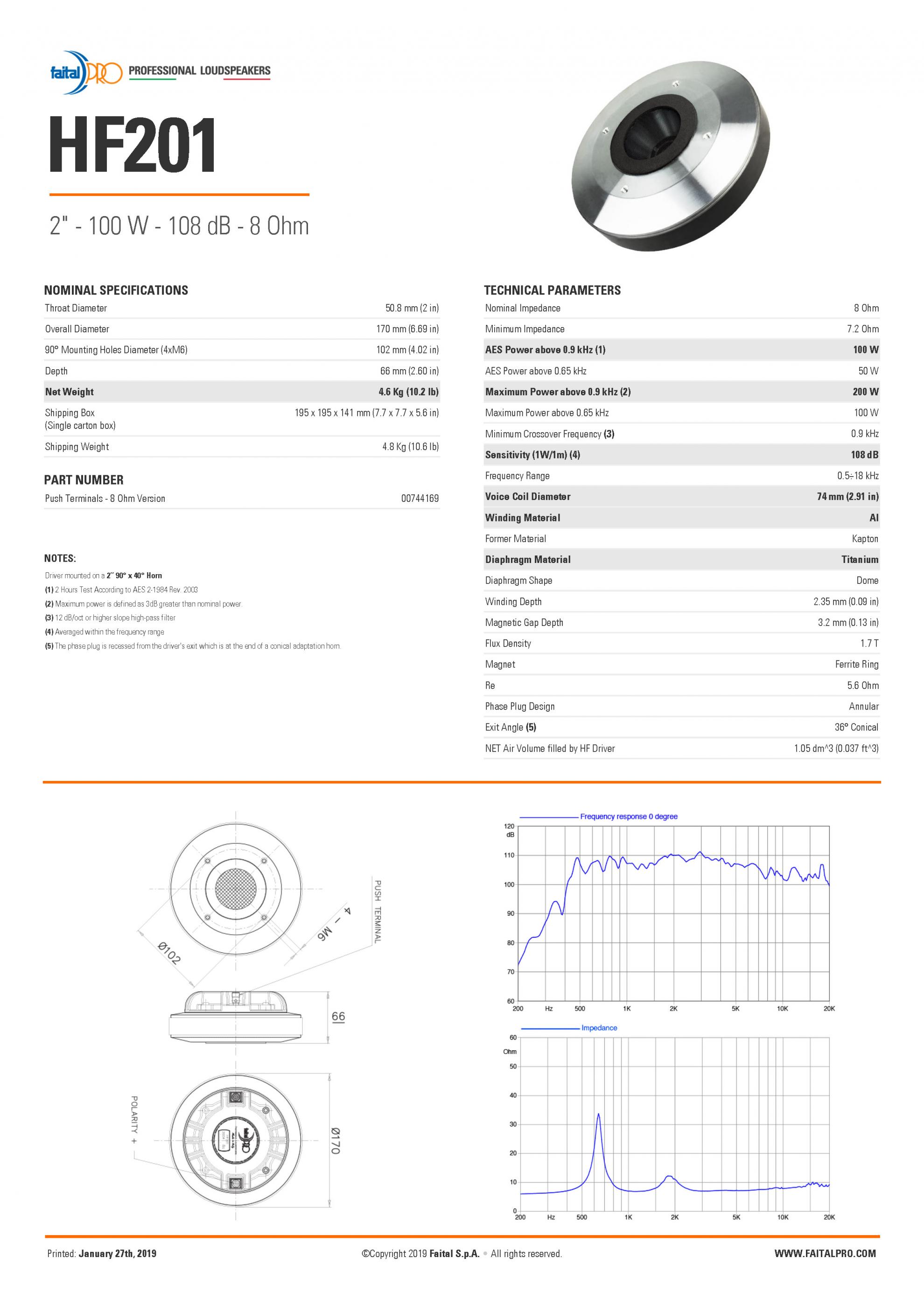

Have you ever listened to a 1.75" diaphragm driver around, or worse: below 1000Hz?
If you haven't, Weltersys' High Frequency Compression Driver Evaluation may enlighten you.
He recorded short sound clips of different drivers that can be downloaded.
WRT the MRII 564: this is pre-eminently the kind of horn to be used with a 1.4", instead of ruining the rather unique properties by using an adapter.
I would suggest to scroll through the specsheets of the 1.4" drivers posted above. You'll notice different diaphragm sizes and materials.
1.4" drivers offer the best of both 1 and 2" (exit) worlds.
They usually allow crossover points as low as 700Hz (or lower) and are capable of clean output up to 15kHz.

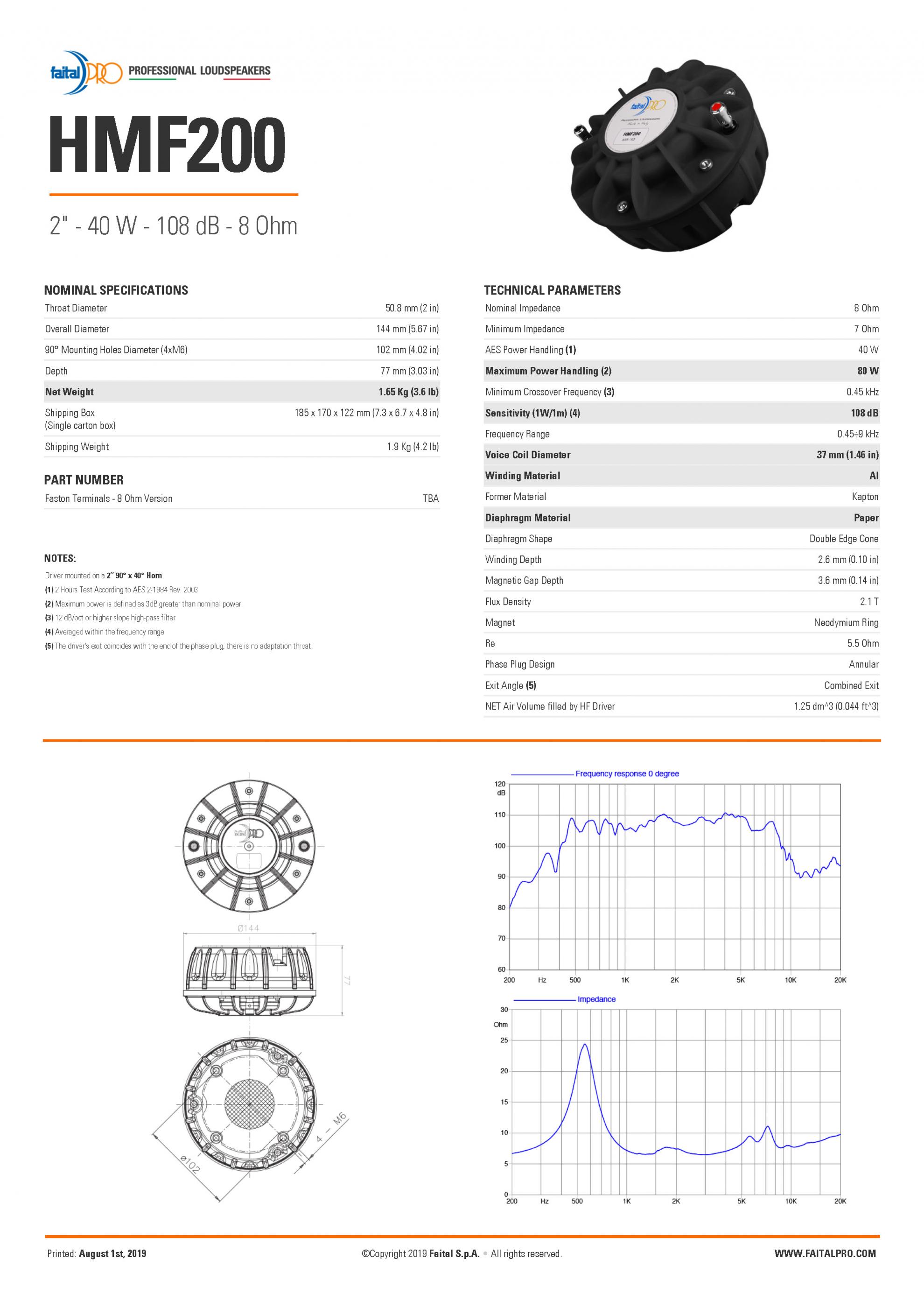

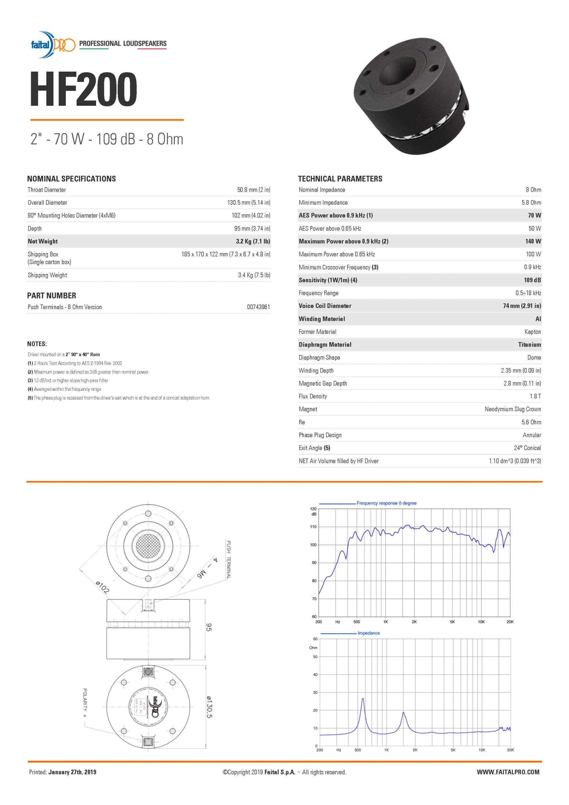

When you look at the HF200's response curve and consider this driver is highly praised, then compare it to the curve of the HF1440,
it's obvious why the latter driver is much anticipated (at least by me).

HF1440 only 8 ohm, my favorite driver 🙂
I see. Thanks for your thoughts Ro808.
I think I like the HF1440 datasheet the most if I had to choose from the lot from Faital. I cannot find it for sale online anywhere though..
The Beyma 1.4" plots seem impressive and similar to the 1440 too?

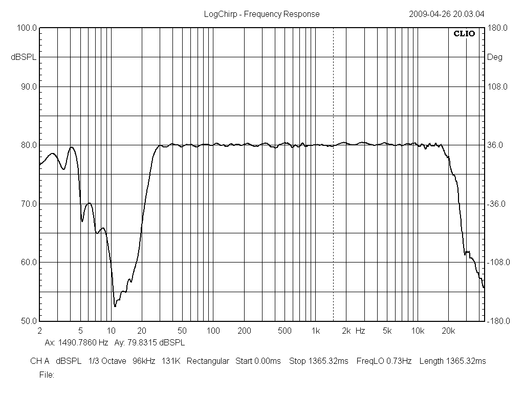

10 years ago, member Lindell built a nice 2-way tower using the 755Ti, Beyma TD385 Horn and a 10" PHL 3002.
The thread is called: Flatter than flat.
This is a preview:
This is a preview:
- Is it possible to cover the whole spectrum, high SPL, low distortion with a 2-way?
