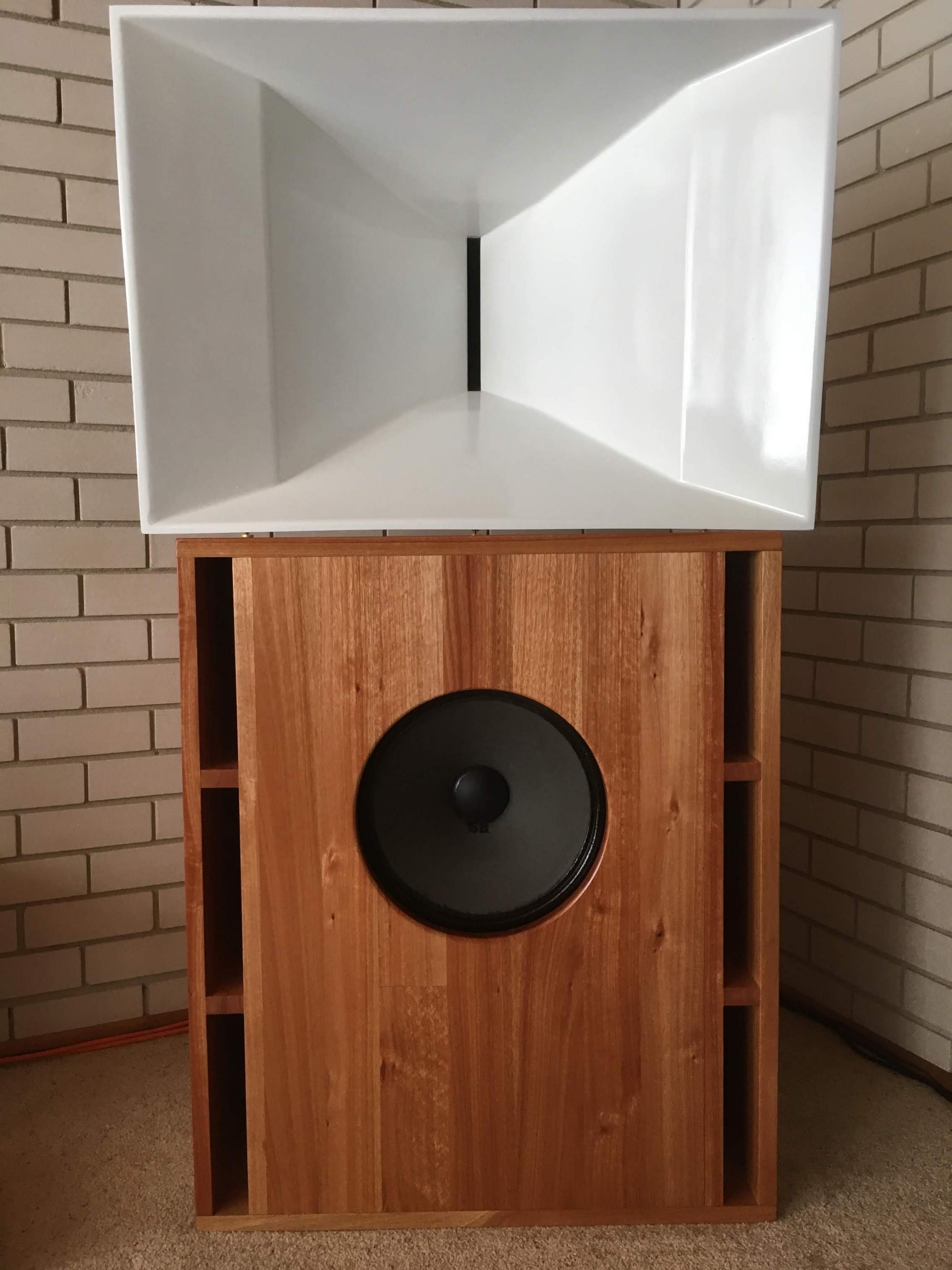

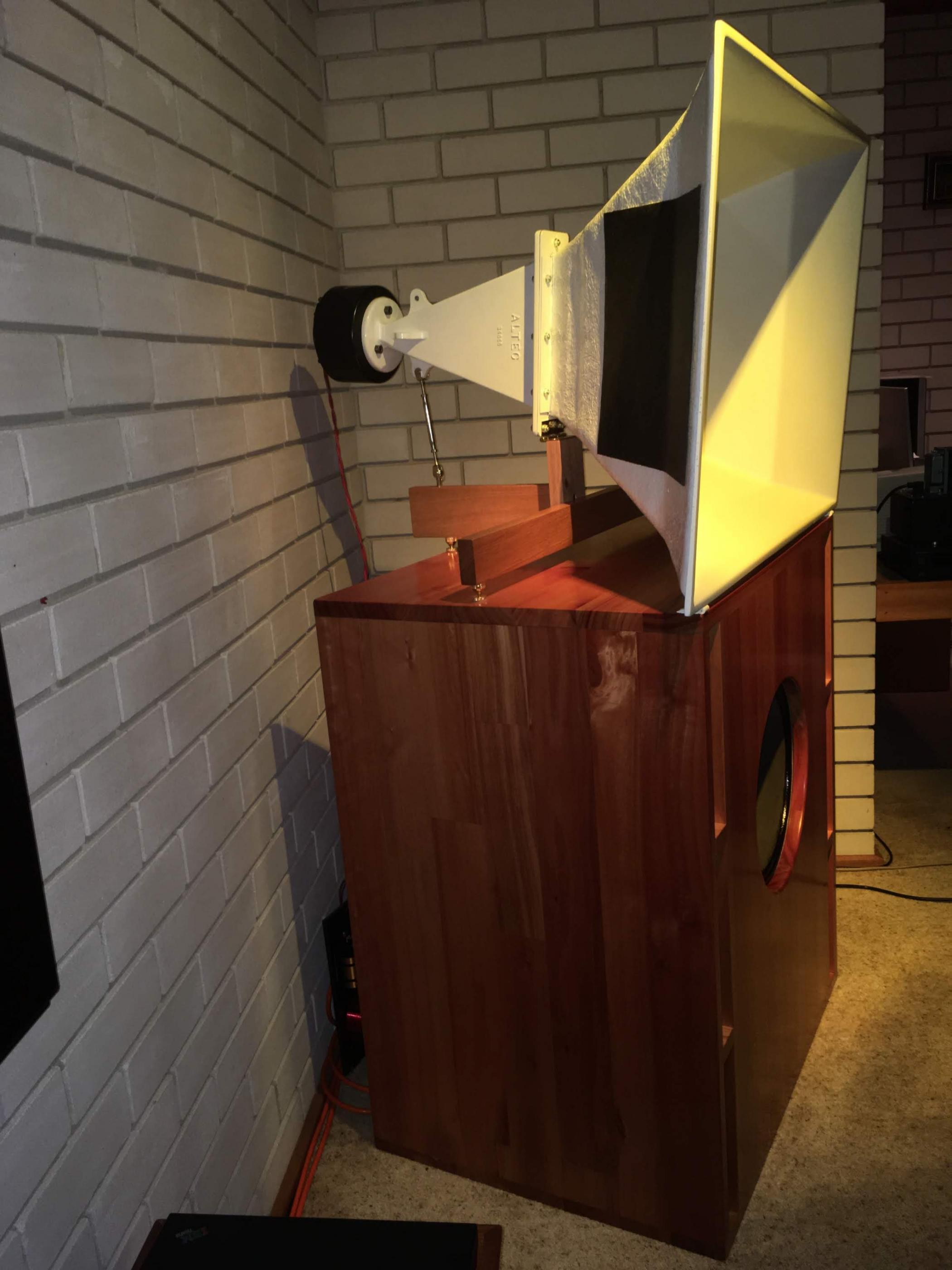

Is it possible to cover the whole spectrum, high SPL, low distortion with a 2-way?
images and details taken from stereonet australia forums.
"Altec MR94B Mantaray constant directivity horns with 288C compression drivers and Altec 413-8 bass drivers in Onken designed cabinets re-tuned to 33Hz.
Passive two way Hiraga crossovers suited for 24 ohm compression drivers and 8 ohm bass drivers as above.
Overall very smooth, detailed and gets down to 25Hz with no effort. No sub required most of the time."

Very nice! Poor driver match up, but guess it's 'slim pickings' when wanting Altec 'down under' and still better overall than most 15" woofers.
Won't 'dig down' to ~16 Hz like the Santiago's original 411, but if it's doing < 30 Hz with authority, not too shabby after cheapening it up.
