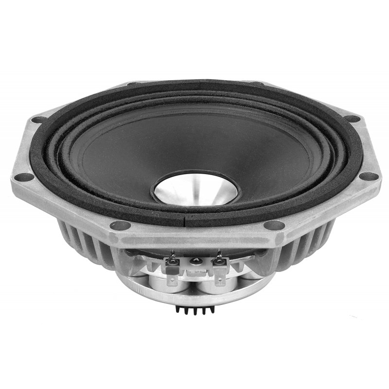

Personally, I don't like the thick roll surround, even less for this coax. Together with the CONEX spider the Santoprene™surround contributes to the rather low Fs of 57Hz. This is useful for a small stand alone coax design, but unnecessary for the Monitor 8.12.
Again, if I would clone the Monitor 8.12 Mk2, I wouldn't use the Eminence for woofer duties.
Some may consider this useless fetish/OCD, but I tend to choose drivers from the same manufacturer, especially if woofers are concerned.
With roll surrounds in the coaxes, there should be roll surrounds in the woofers as well.

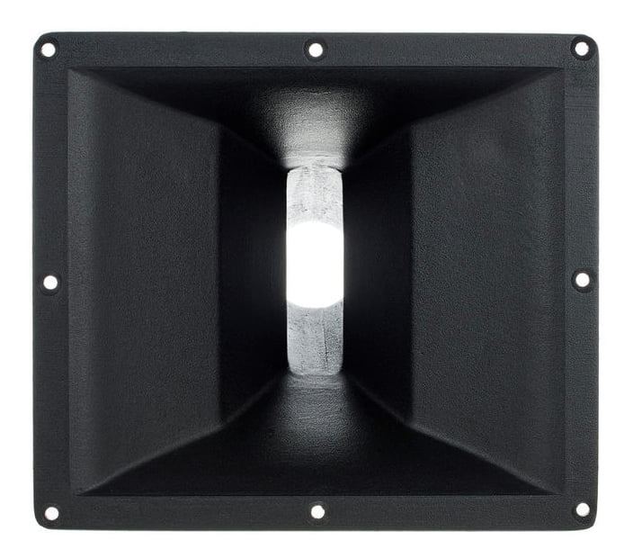

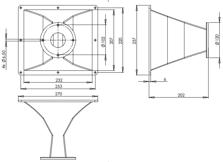

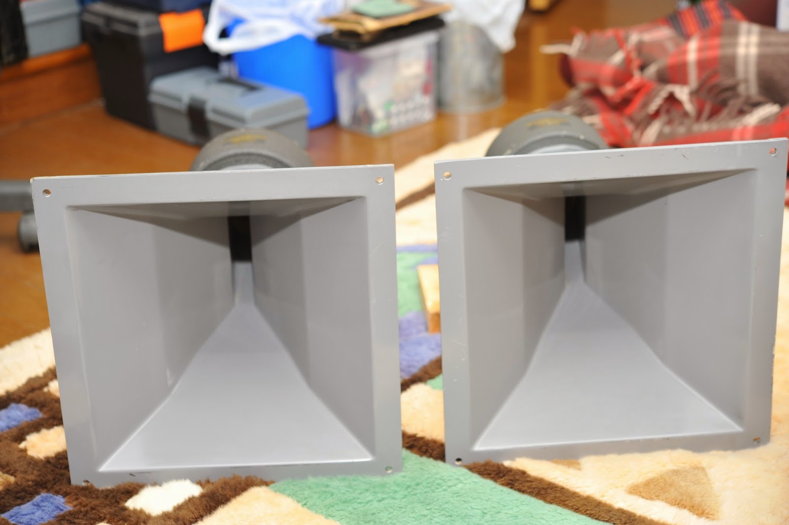

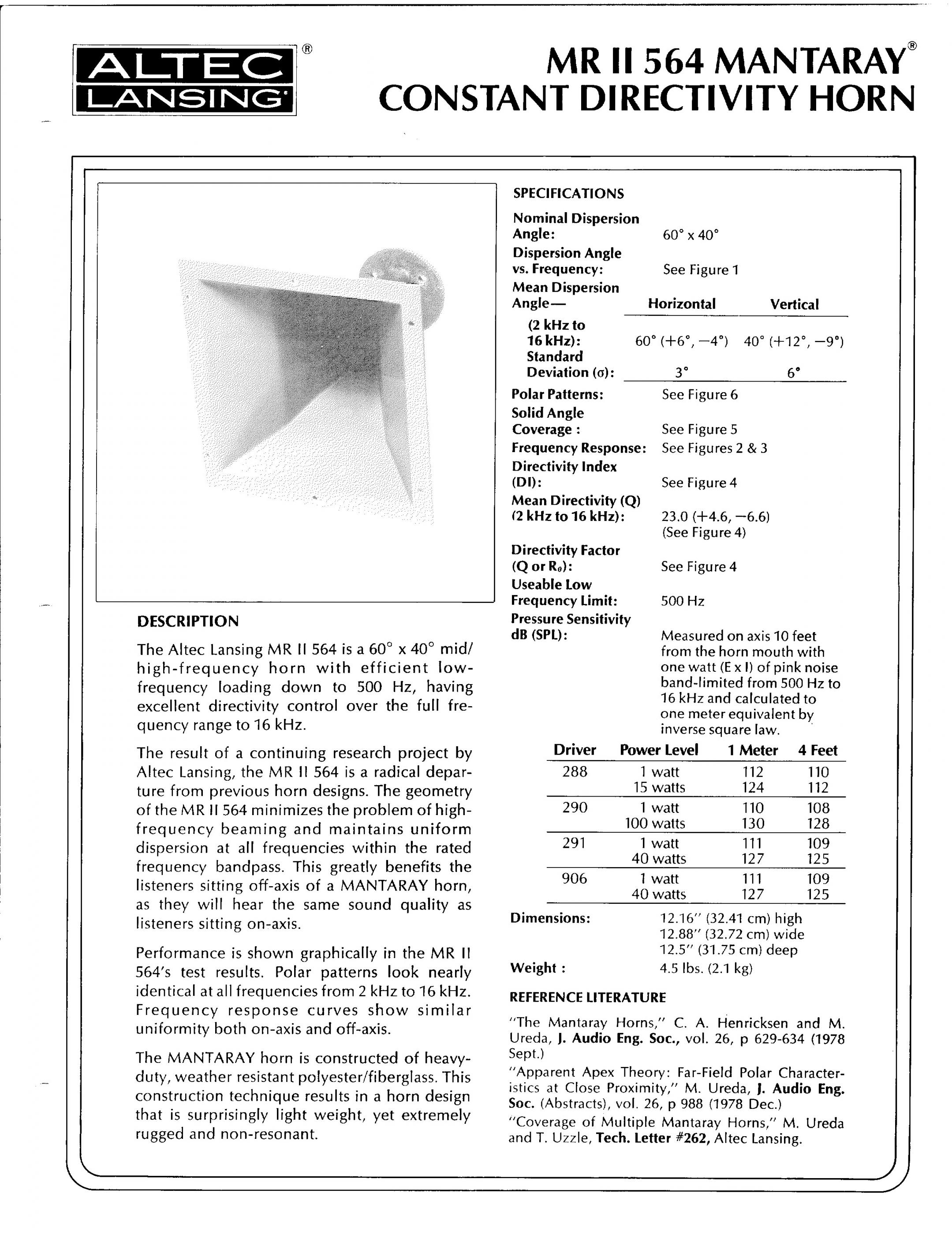

Are these horns a good candidate for 2-way setup?
Not too shabby as diffraction horns go: ALTEC LANSING MANTARAY MR II 564 SPECIFICATIONS Pdf Download.

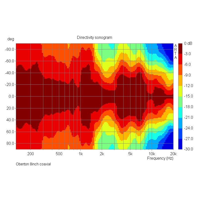

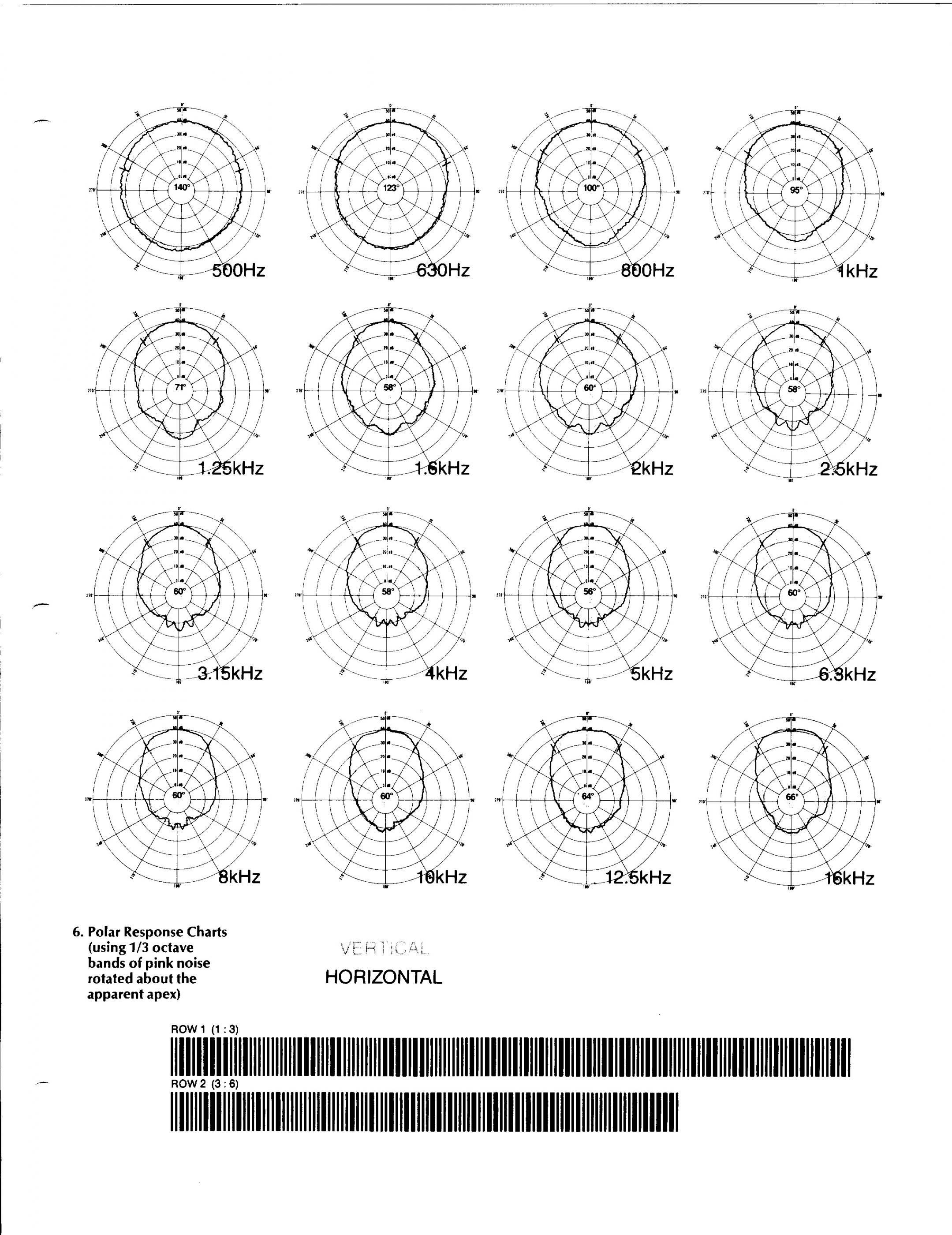

60degrees horizontal, in real world listening, will that equate to a relatively narrow sweet spot?
The dispersion of my kitchen speakers is in the same ballpark. For proper stereo listening one has to be selfish. But for casual background music it still works quite well though.

You have to draw it out on a scaled floor plan to be sure, but 60 deg 'fits' a lot of rooms whereas 90 deg often must be over toe'd in or centered in the room corners to keep them off the side walls unless setting fairly close. Definitely better for THX reference HT.

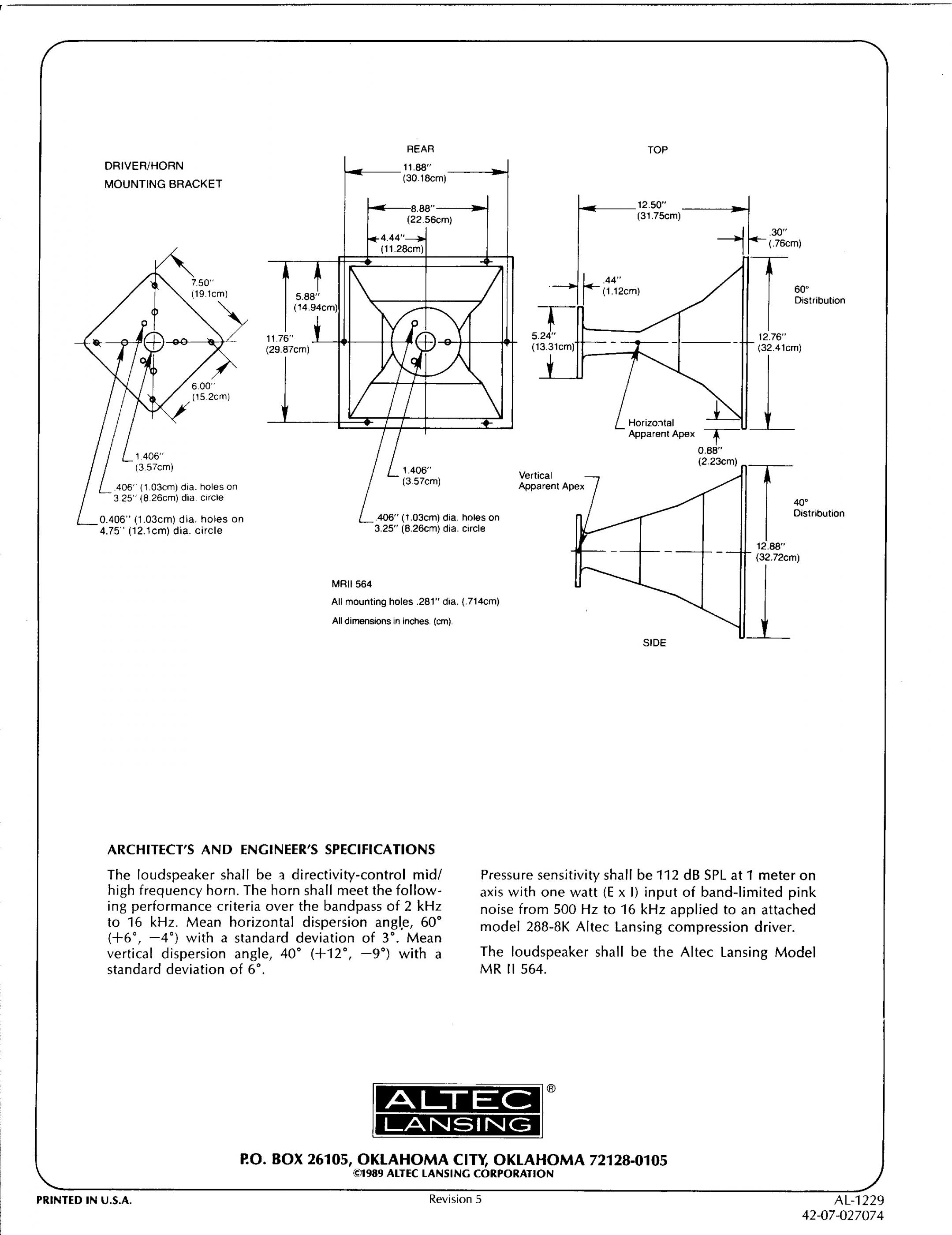

The 60x40 dispersion is about the max for 2" exit drivers without resorting to extreme diffraction.

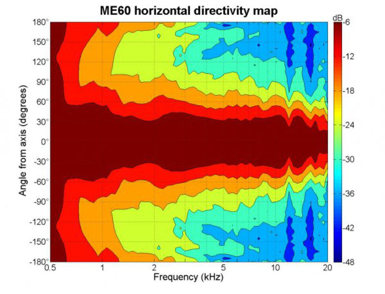

The MRII 564 is considered one of the best (sounding) Mantaray horns. If you search, you'll find plenty of reviews.
I am not familiar with this particular horn, but I own B&C ME60s which is a slightly modified clone of the MRII 564.
If you look at the dispersion graph and polar maps, you'll notice there's no pattern flip all the way down to 500Hz.
This may not be a necessity, but it's still a nice feature.
Such a horn could work nicely in a long room, that's deeper than it's wide.

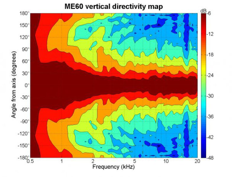

I'm sure I could think of something to say.. but all I want to know is the 40 degree vertical, is it chosen for a commercial or domestic reason, is it for power or pattern?no pattern flip all the way down to 500Hz.
Both for power and pattern, I would say.
60x40 is a common dispersion pattern, used for many popular horns like the XT1464.
These horns are designed with commercial applications in mind, which is not to say they can't be used at home.
Charles is one of the many happy XT1464 owners.

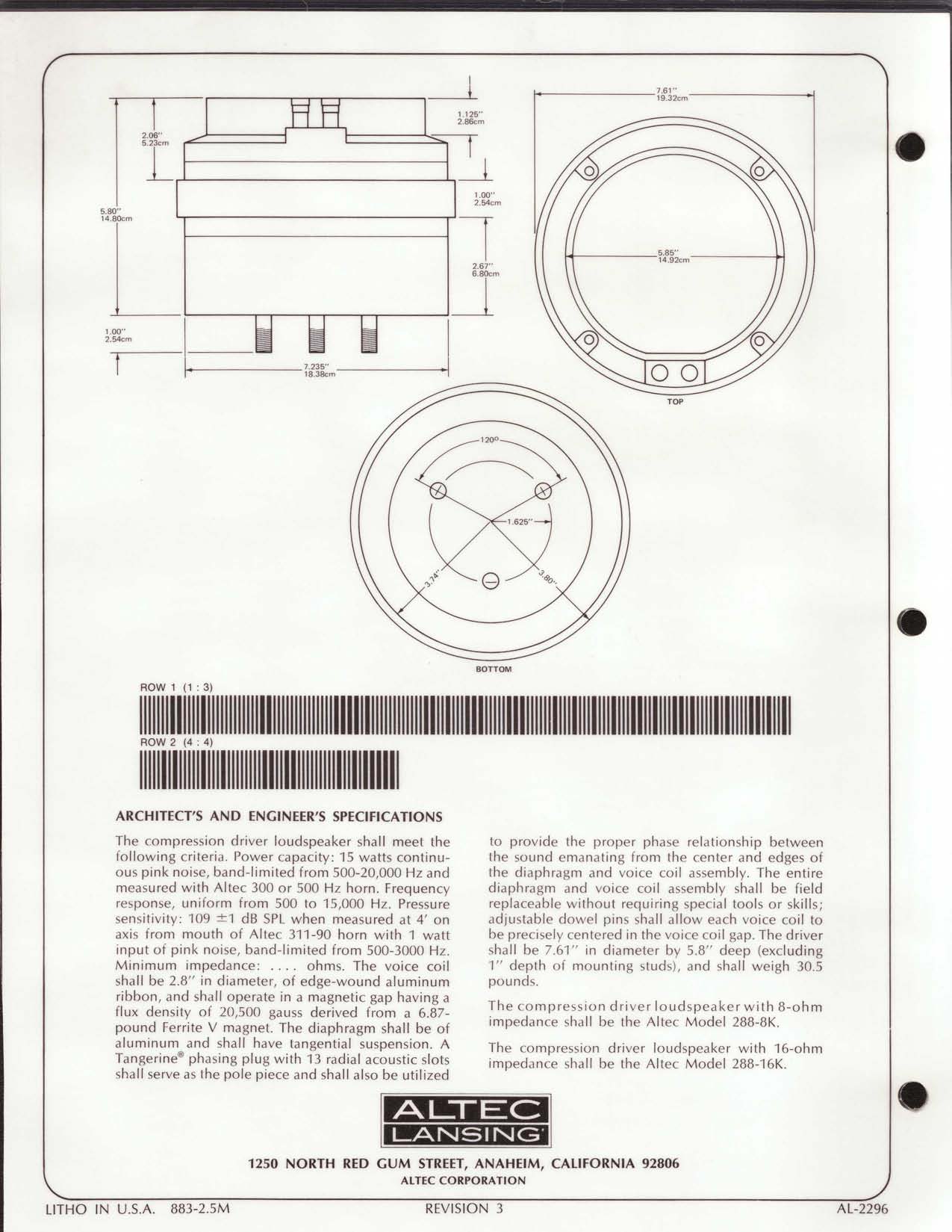

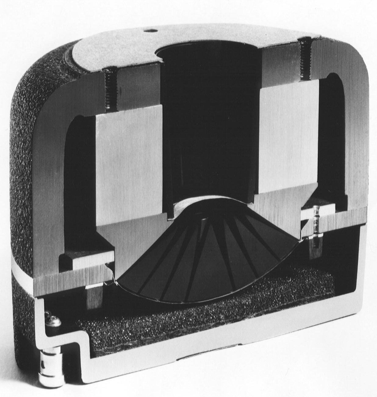

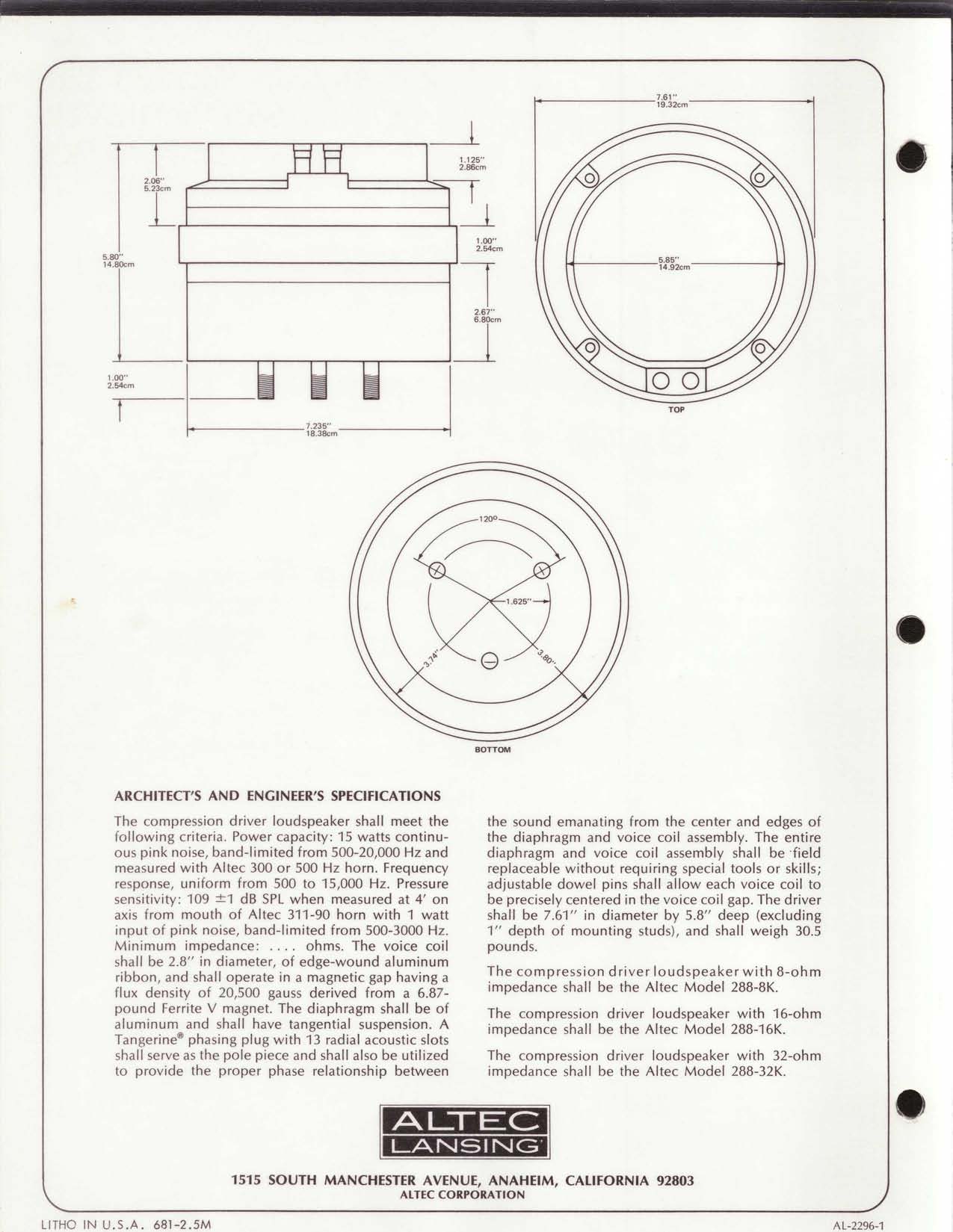

If you compare dimensions of the MRII 564 to those of the ME60, you'll notice the former is nearly 12 cm deeper.
This in order to match the long snout of to the oldskool Altec drivers, which are decendants of the JBL 375 / WE 594A.

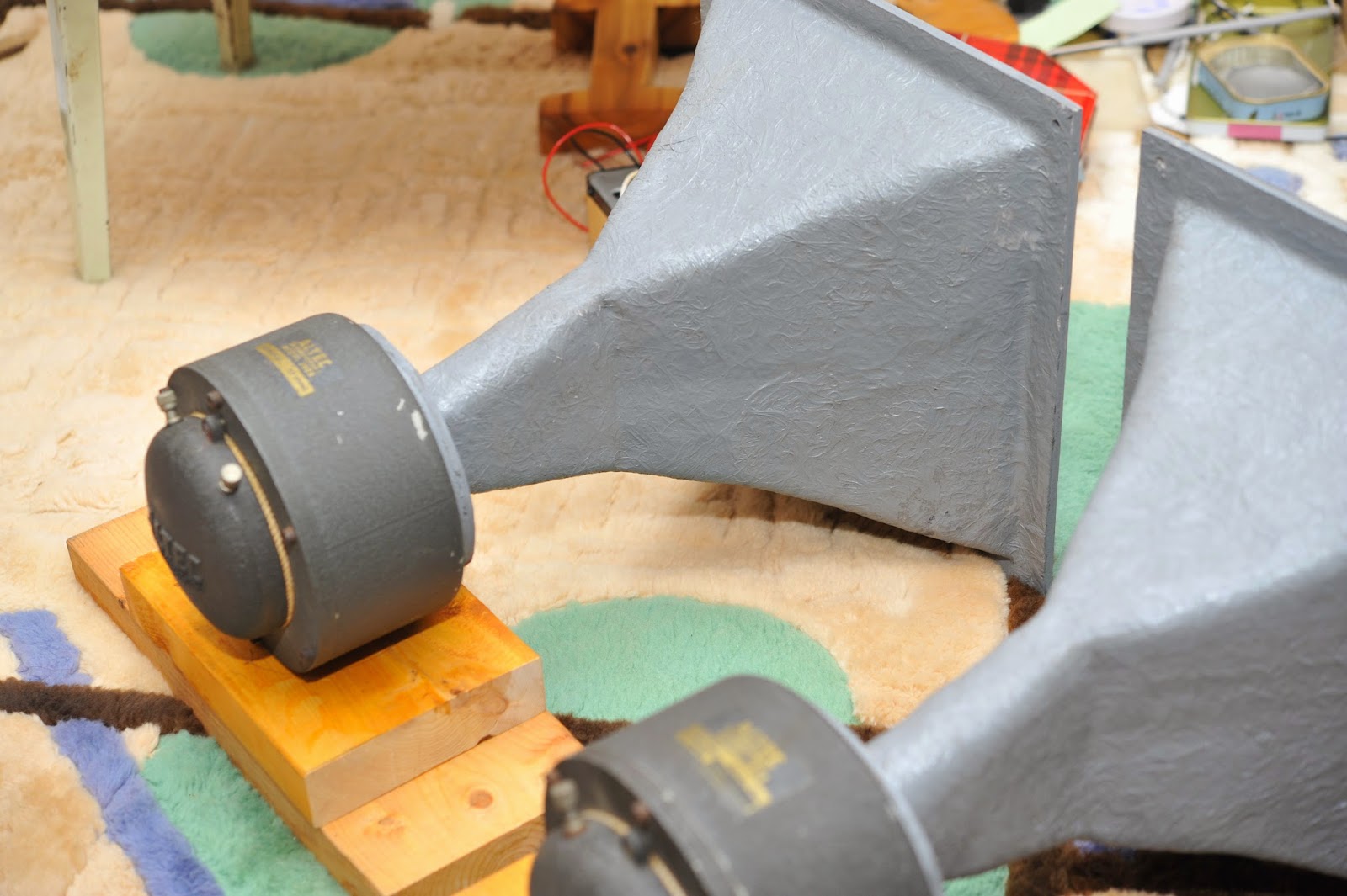

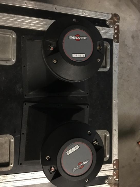

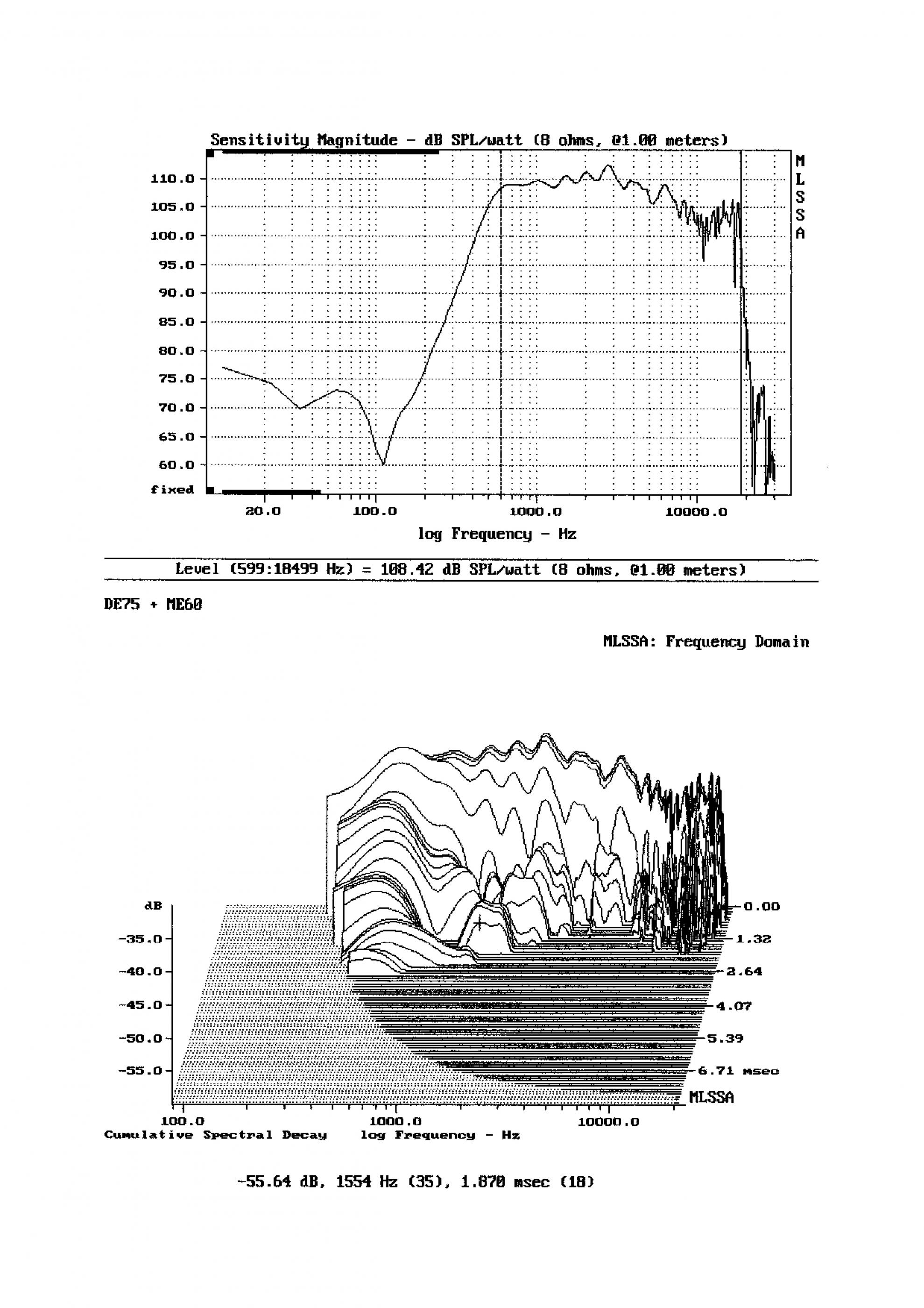

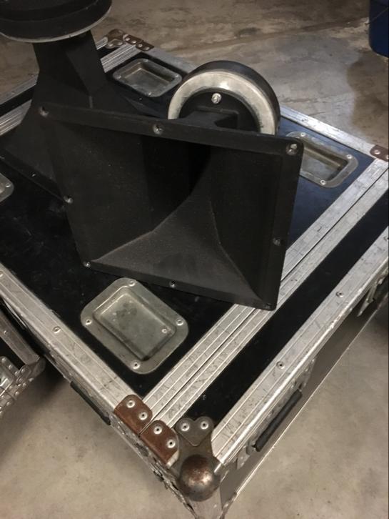

My ME60s with (pancake, 34,7° exit) DE75 drivers:
(I attenuate/EQ these to about 95dB, mounted to much bigger horns. The breakup is better behaved than with many newer 2" drivers and there's no need for tweeters.)
