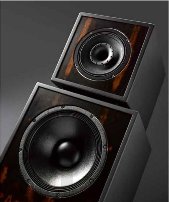

Indeed, and for this reason I would like to return to coax woofers once more.
Following the posts on the German manufacturer and the Bullfrog earlier, I want to highlight the so called "Monitor" Series.
These consist of a coax top + bass cab, both box shaped.
There are 3 models: 8.12, 10.15, 12.18 and guess what... the numbers indicate the size of the coax and bass driver respectively.
This concept includes some of the Bullfrogs features, with a few perks and at least one inevitable drawback: it's bigger.
However, the Bullfrog including the stand is quite bulky as well.
I'll focus on the 8.12.

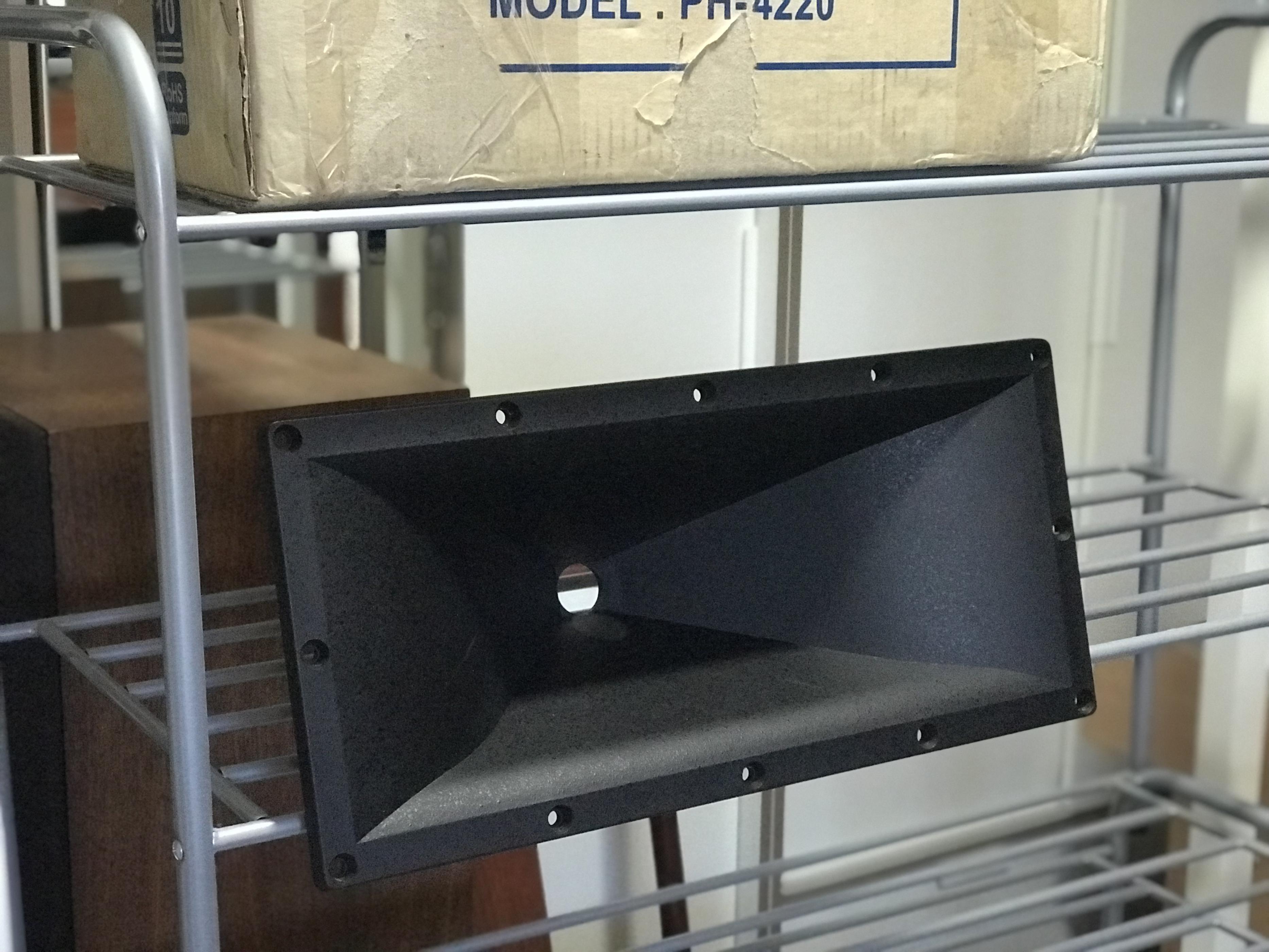

Anyway, first component of my 2-way project has arrived. Paudio ph-4220 horn (a slightly taller version of the jbl 2370). The horn is very plastically and will certainly need some deadening. Not as big as I was anticipating either. Oh well!

It has come truncated. The shallow vertical angles require protruding lips to provide control to a frequency equal to that of the sides. It would be taller than it is wide unless you want to cross at a high frequency.Not as big as I was anticipating either. Oh well!
Or.. choose exactly where it blooms, and cross to round.

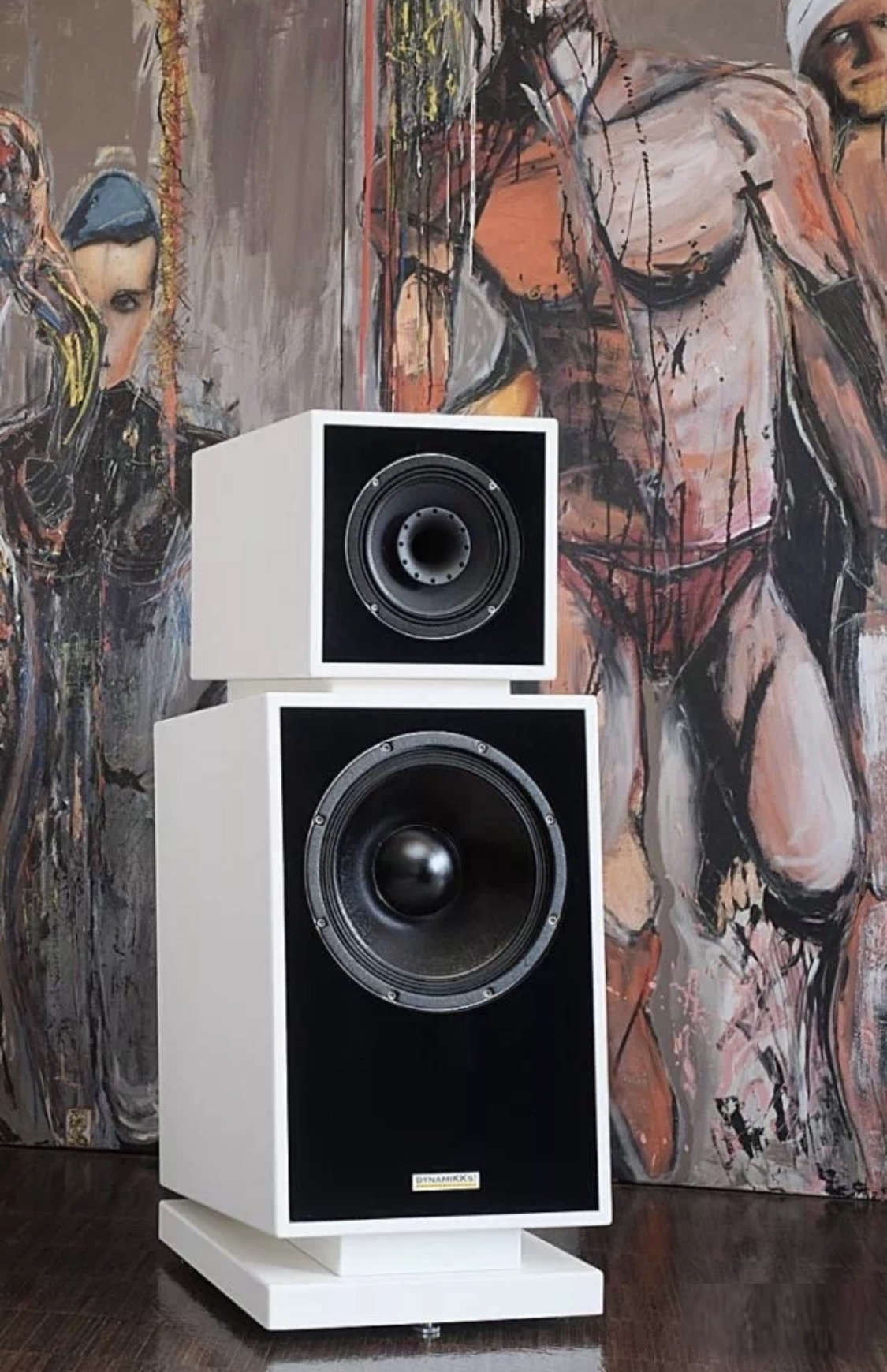

The Monitor range of loudspeaker systems are effectively 3-ways, or 2-way + bass, depending on how you look at it.
I think it's a nice concept, not without flaws, but which loudspeaker system is?
The white 8.12 above is the Mk1 version, which is interesting because of the low cost drivers.
In recent years raw driver prices have increased considerably, but a few years ago the drivers for a pair of 8.12 Mk1s cost around €400.

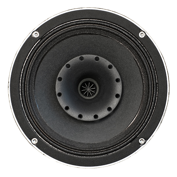

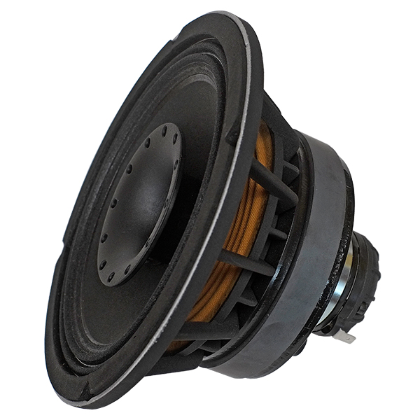

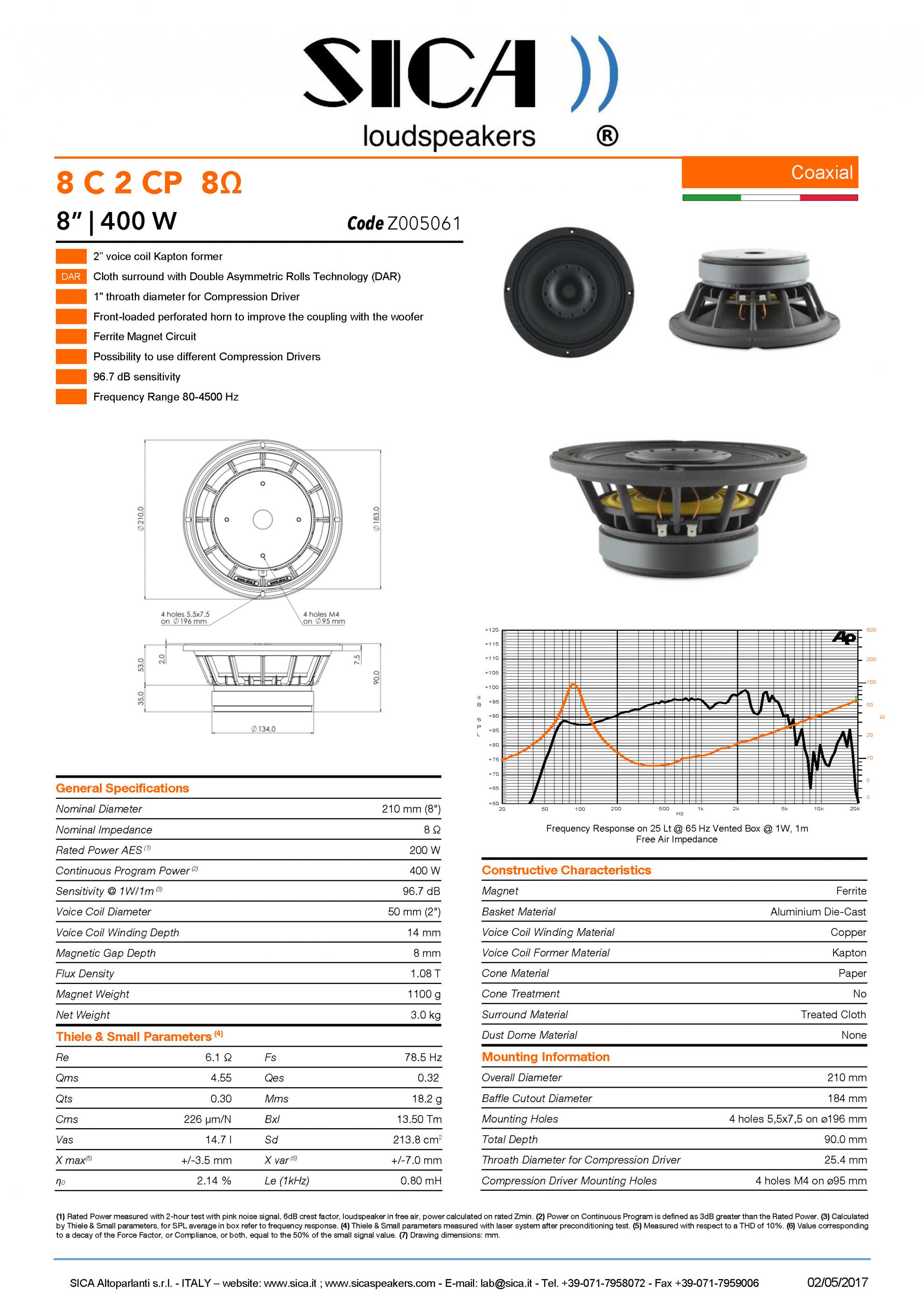

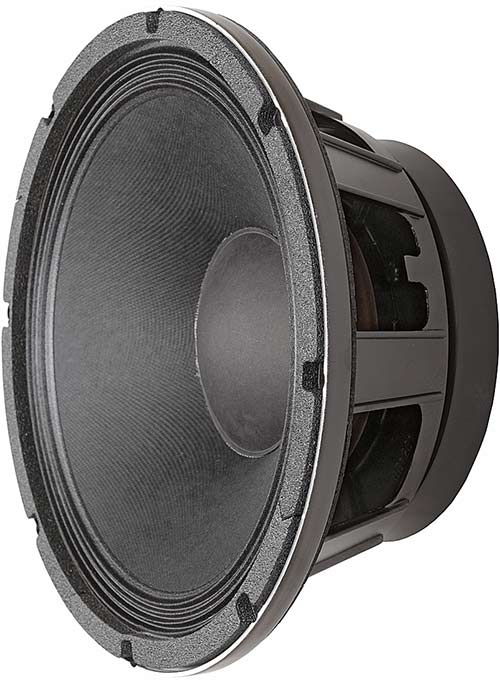

Coax: SICA 8 C 2 CP

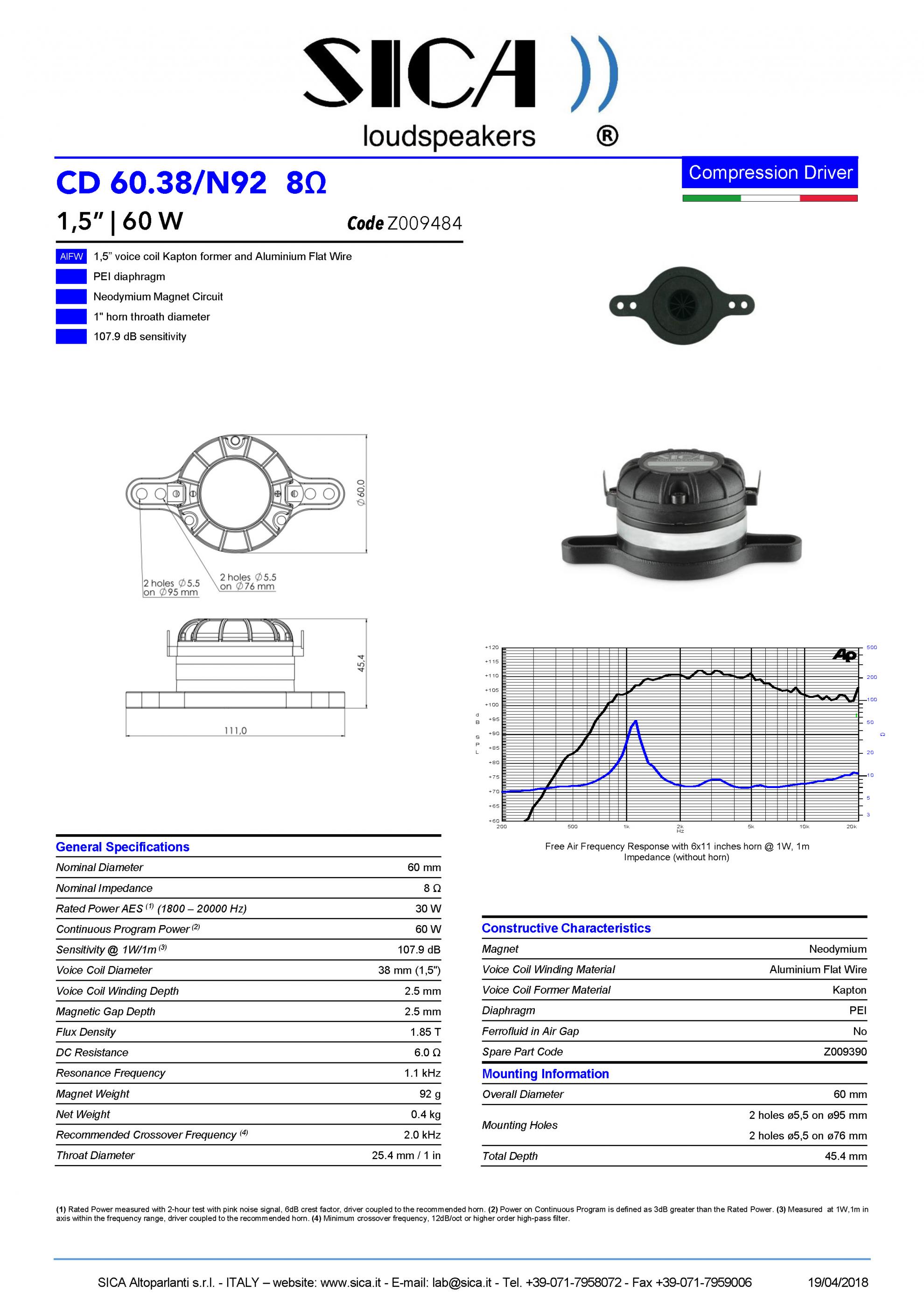

Compression Driver: SICA CD 60.38/N92

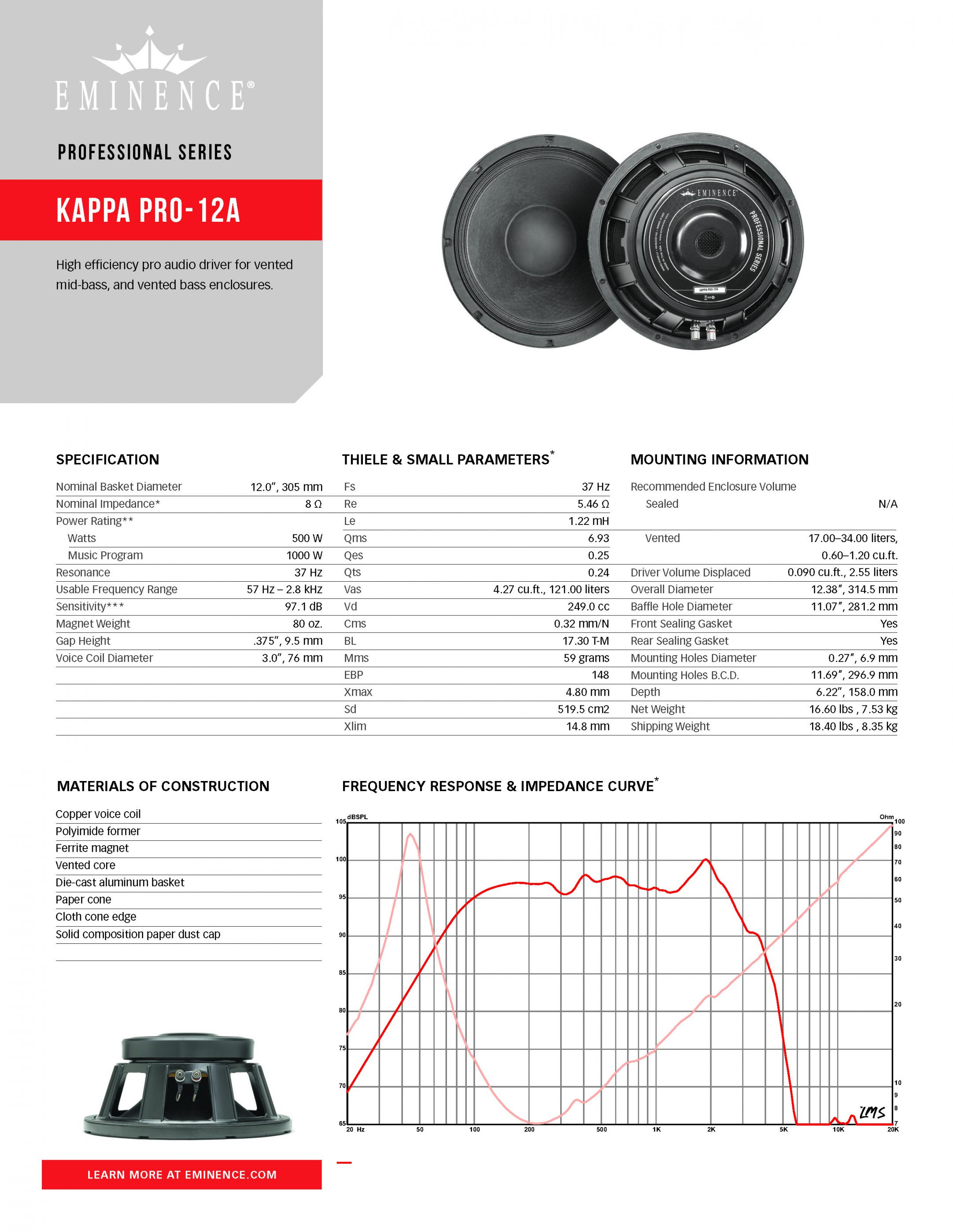

Woofer: Eminence Kappa Pro 12A

It's relatively unknown outside of Europe, but the SICA CD 60.38/N92 is a nice little driver.
I've heard it in some PA cabs and it sounds like a high-end softdome tweeter on steroids.
Not suitable for crossovers below 1500Hz.

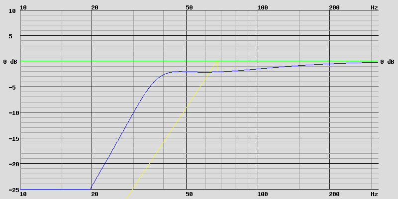

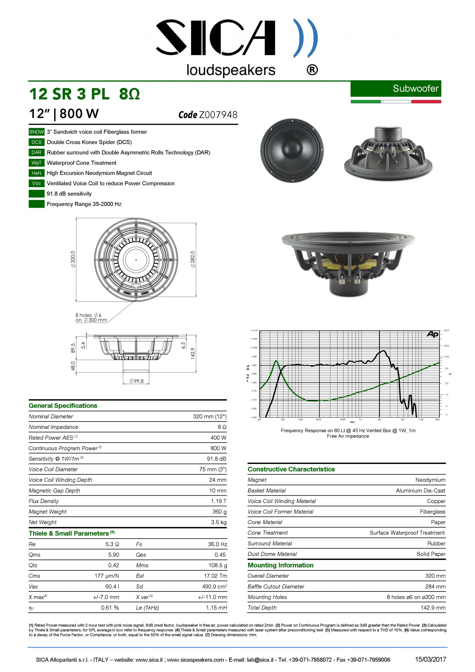

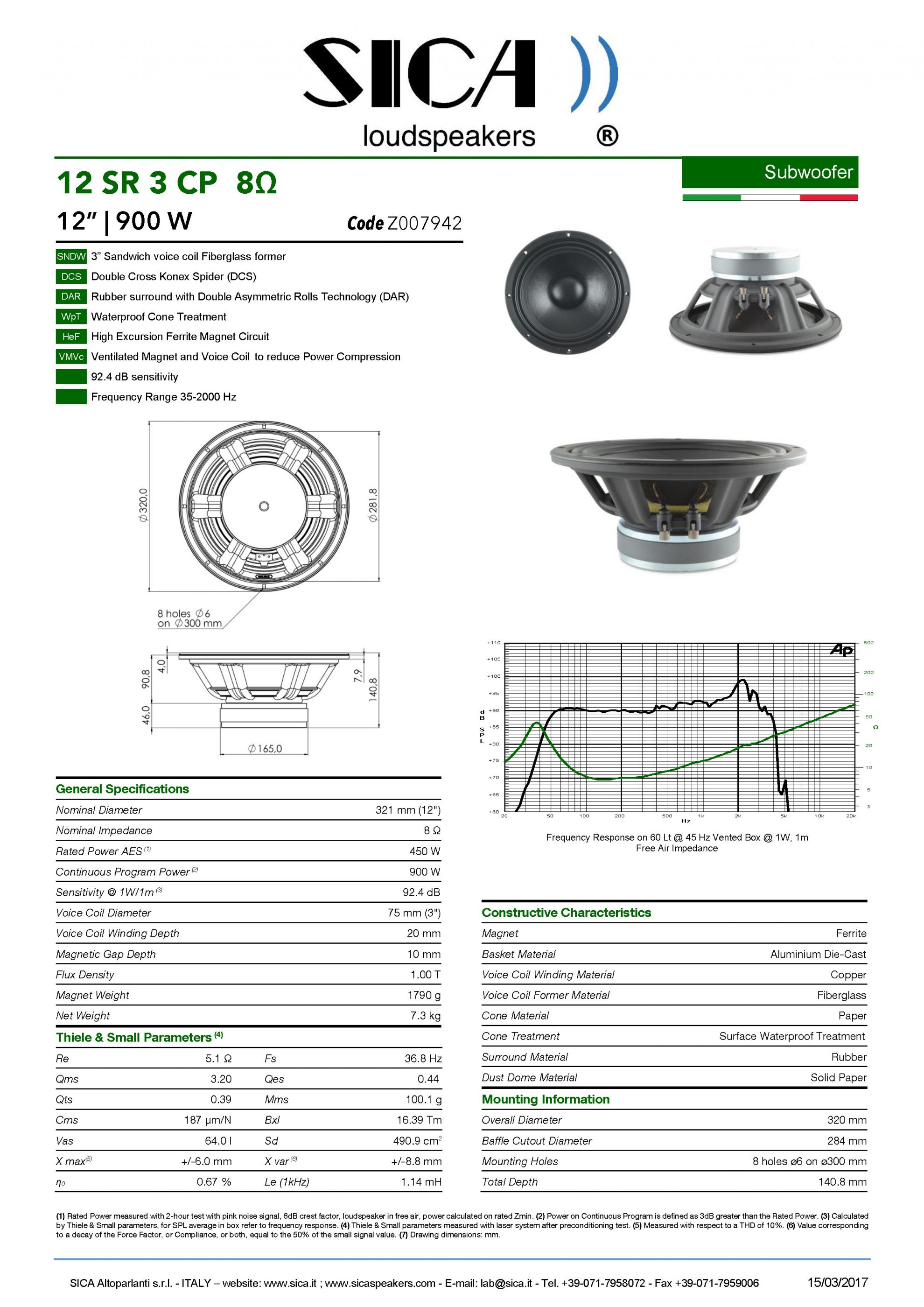

If I would build a 8.12 clone, I would probably go active.
Moreover, I would exchange the Eminence for a SICA bass driver as well.
2 options come to mind:
- SICA 12 S 3 CP (Version 2018)
- SICA 12 SR 3 PL.
Both would work in a smaller cab, but in a large volume BR cabinet the latter driver would reach the 20s.

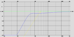

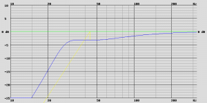

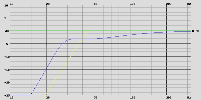

2 quick sims:
- SICA 12 S 3 CP v2018, VB = 165.0 L, FB = 38.0 Hz, the 0 dB corresponds to 95.2 dB
- SICA 12 SR 3 PL, VB = 150.0 L, FB = 28.0 Hz, the 0 dB corresponds to 94.4 dB.
2 quick sims:
