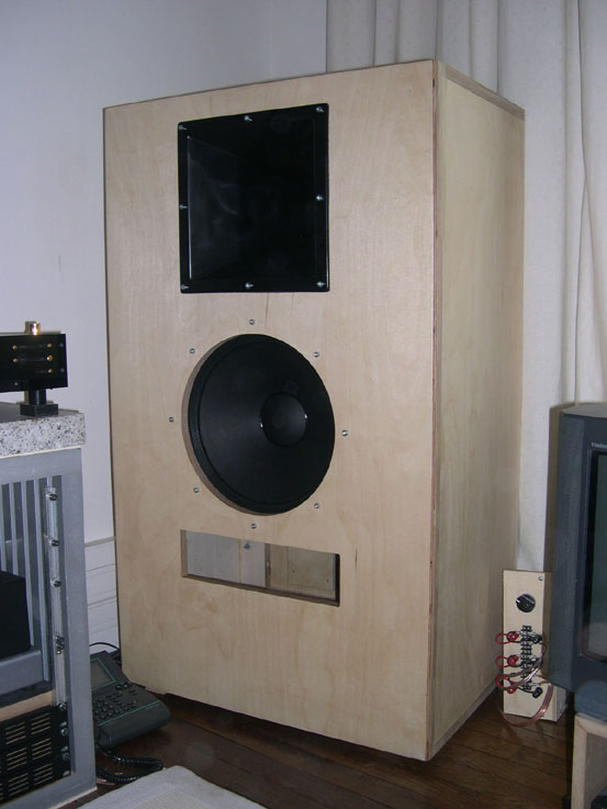

In view of the Monitor 8.12, there are a number of interesting smaller details.

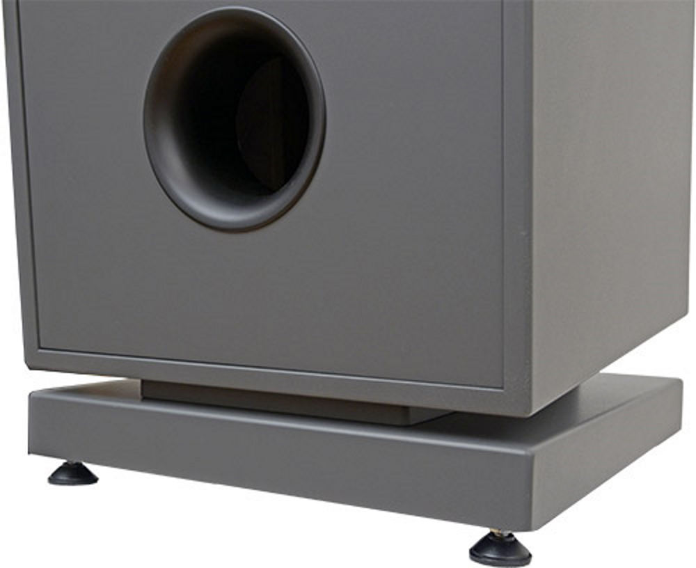

The top is closed and the bass bin is BR (inverted fase), rear ported and tilted backwards by 5°.
Quote:
"The manufacturer claims it makes the following acoustic sense:
While there's some marketing BS blended in the above statement, I personally also prefer a rear ported BR cab. Even more so with bigger cabinets.

The Manufacturer cites desirable room coupling to advice against free room placement. Half to a full meter of front wall proximity is optimal says he; and that it really doesn't sound like bass reflex. Particularly the low bass works better with rear ports as the speaker then acts as quasi bipole to make room modes less critical"
This quote, again, includes some bold claims. However, I tend to agree with the statement regarding the sound.

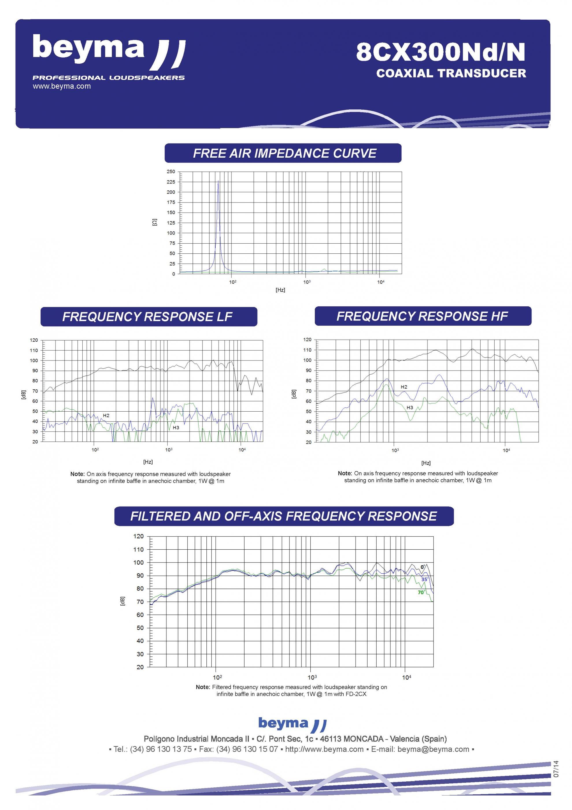

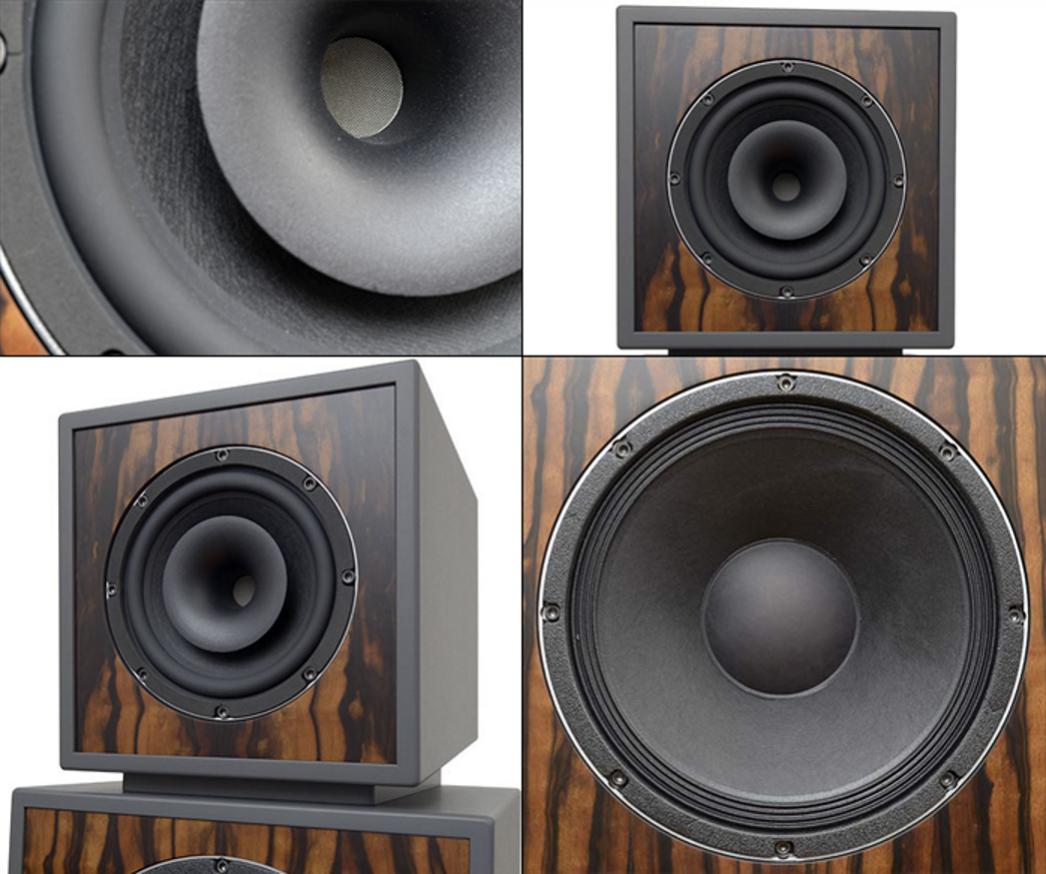

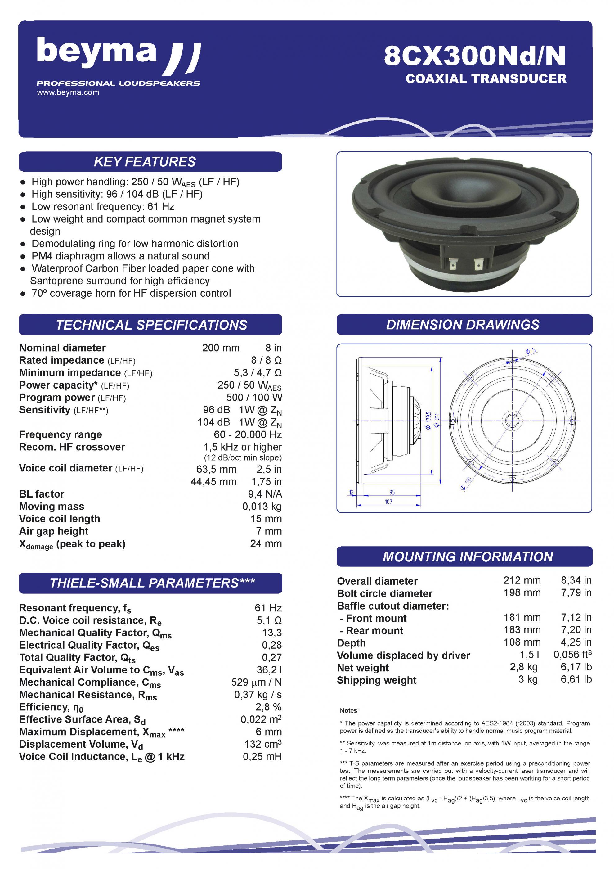

As stated, for the 8.12 Mk2, the SICA 8 C 2 CP was replaced with the Beyma 8CX300Nd.
There's no doubt this is a higher end coax driver. I am not convinced it's actually 250% better.
Personally, I don't like the thick roll surround, even less for this coax. Together with the CONEX spider the Santoprene™surround contributes to the rather low Fs of 57Hz. This is useful for a small stand alone coax design, but unnecessary for the Monitor 8.12.

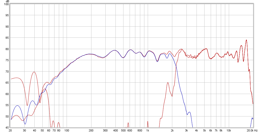

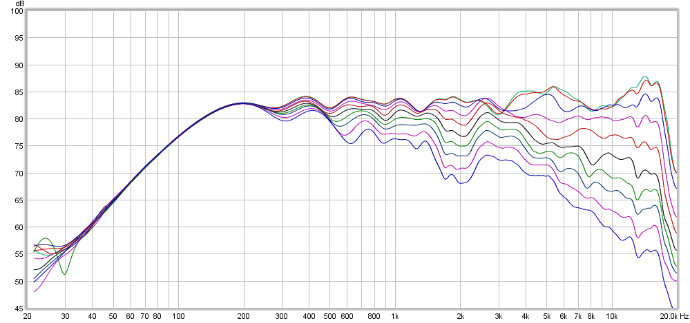

Member mtg90 of avsforum developed a custom XO for the Beyma which, judging from the graphs, looks promising (the 5th & 6th image shows the results).

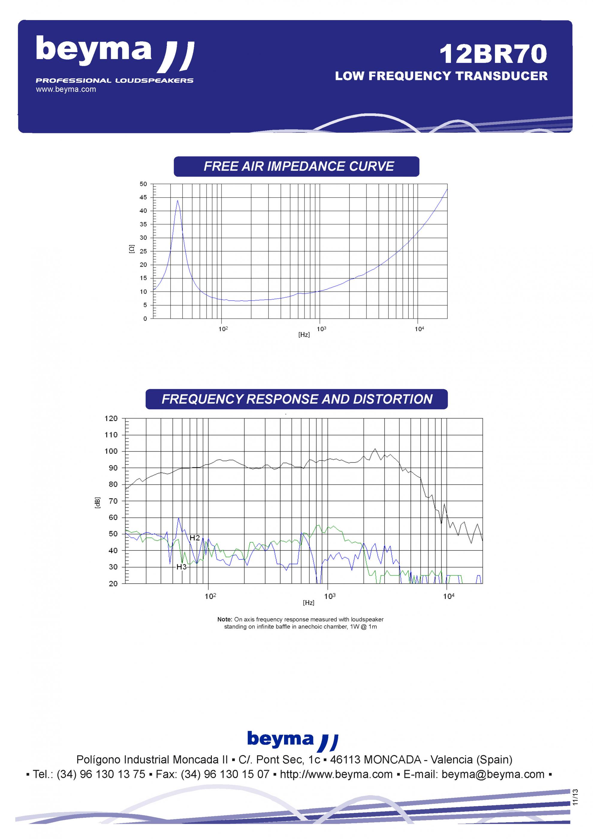

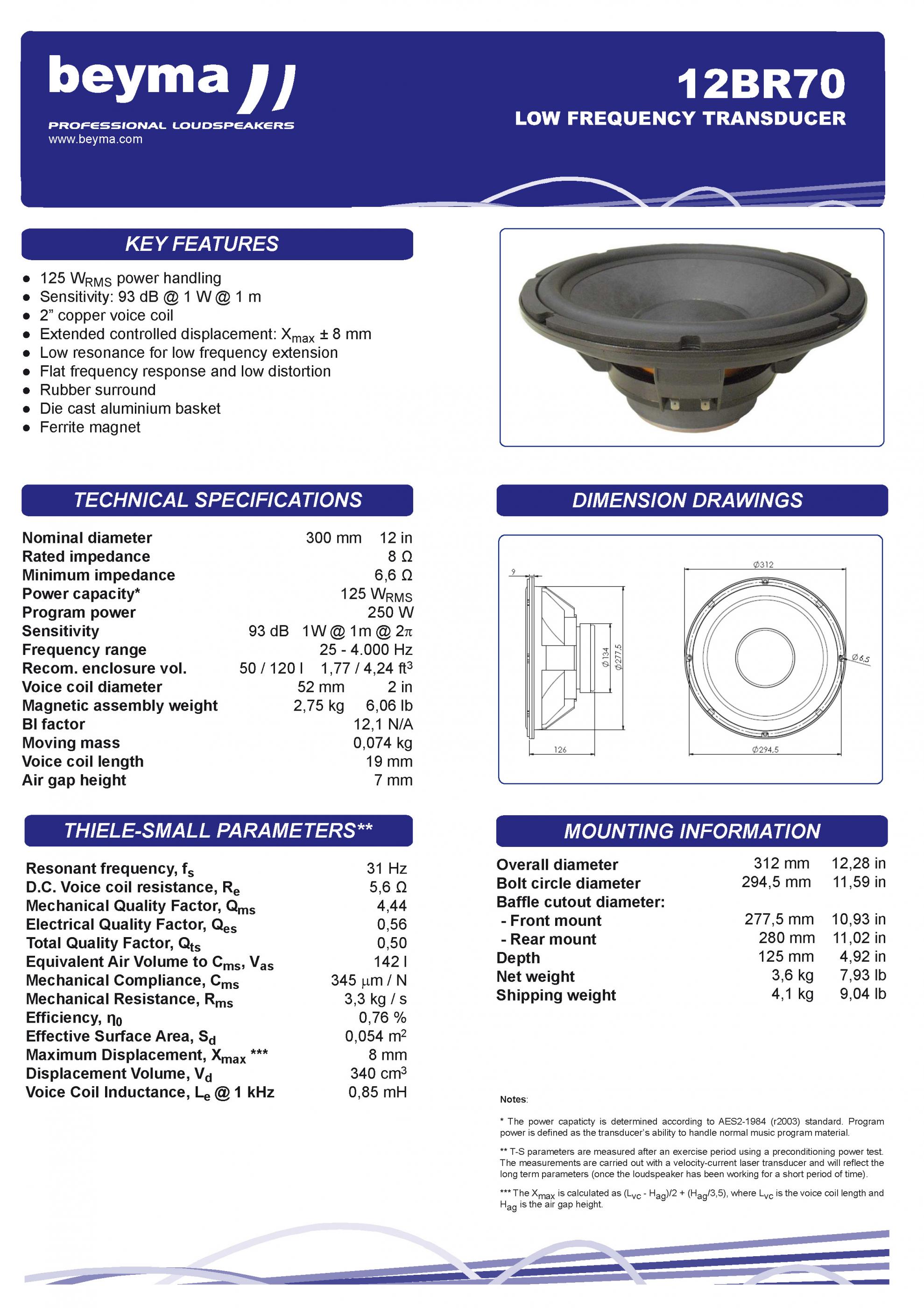

Which is convenient, because Beyma offers a few of such 12" woofers that could potentially transform the 8.12 clone into a (near) fullrange system.
The Beyma 12B100R is similar to the older JBL pro woofers with foam roll srrounds.
Again, if I would clone the Monitor 8.12 Mk2, I wouldn't use the Eminence for woofer duties.
Some may consider this useless fetish/OCD, but I tend to choose drivers from the same manufacturer, especially if woofers are concerned.
My current system is a mixture of brands, so perhaps I am not that freaky?
Wrong!
With roll surrounds in the coaxes, there should be roll surrounds in the woofers as well.

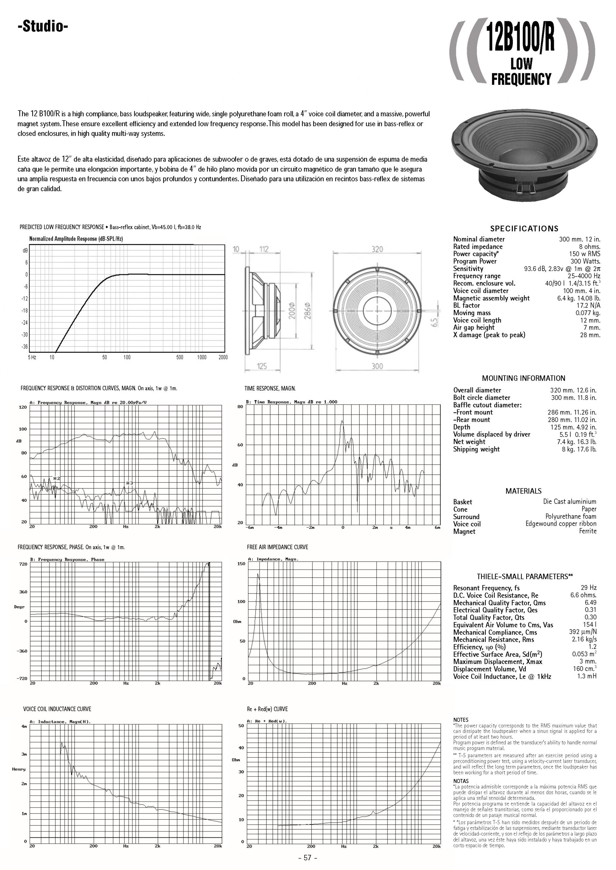

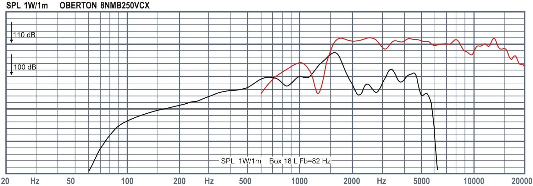

Another nice coaxial, used in one of the latest products of the same manufacturer, is this Oberton 8NMB250VCX.
