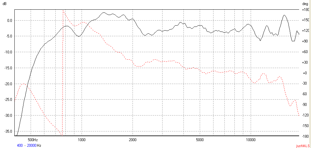

Here is a comparison of HF200, HF204 and CP750ti: Driver comparison: Faital HF200, Faital HF204, Beyma CP750Ti at Jabo 72 horn - Technical/Modifications - The Klipsch Audio Community
Looks like the polymer diaphragm has the edge on the low end. There seems to be an issue between 2 and 3 kHz though, which can also be seen in the datasheet.

Yes. I'm wondering about the sudden rise in distortion at 1Khz. You see that with almost all of measured drivers over there. I think it's a measurement issue. To bad that they did not measure distortion below 1Khz
This seems typical for Listen SoundCheck distortion measurements, depending on the driver and chosen algorithm.

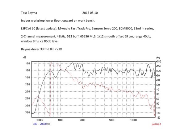

Beyma response curves are some of the most true to life representations I’ve come across. I was able to find community taken measurements to confirm that, I don’t think I can say the same for a lot of other big names.
