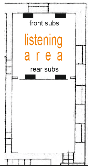

Thank you for explanation. Now I don't understand rear subs up to 200 Hz. Imho you will hear them.There are rear subs, planned for the final configuration. Those subs will be ran as high as possible 120hz-200hz is my guess
Personally, I prefer front subs and other ways to solve room problems. I am using DBA.
There are front and rear subs planned. If I play up to 200hz, its possible I won't like them. 120hz is chosen by THX for good reason. The sub area will be carried by front and rear subs....A double bass array? =DBA. Doesn't this require front and rear subs? I guess the rear subs aren't increasing headroom at this point though.....Thank you for explanation. Now I don't understand rear subs up to 200 Hz. Imho you will here them.
Of course they require ! But rears aren't audible. It may be better to use 3-4 feet of absorber on the back wall if possible.Doesn't this require front and rear subs?

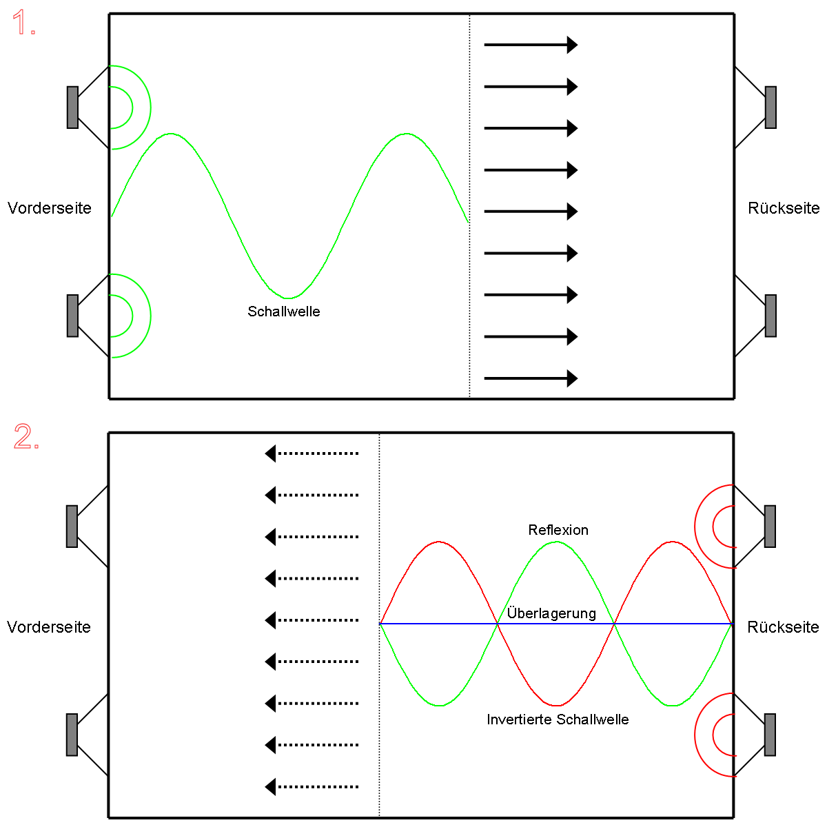

Less orthodox, including different placement of front and rear sub(s), subwoofer arrangements can be used depending on the required upper frequency with same effect in bandwidth. If source sub(s) are at front wall and sink sub(s) are at rear wall, rear(s) inverted and delayed by room length.

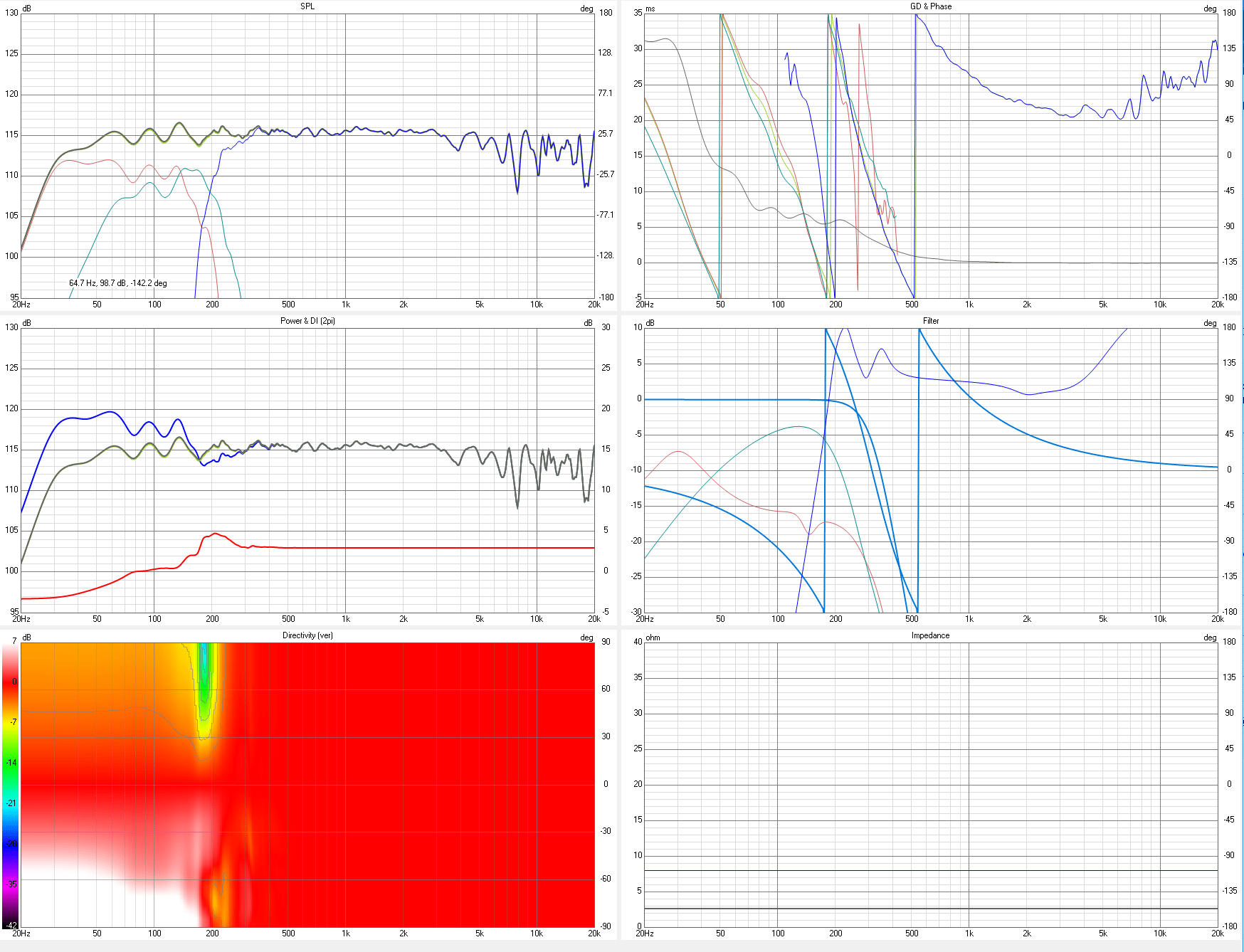

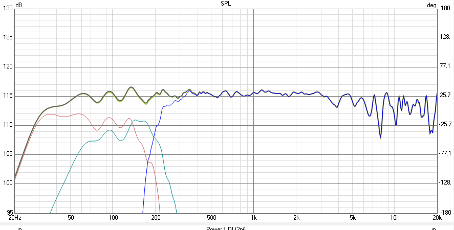

I think you are saying to not vent this thing at the very least. I am partial to the 4th order bandpass myself, and if there ever was a good one, for a sub that can fit in your house, this is it. I think I solved the summing issue, without FIR, playing around with VituixCad. This would be a rough draft at best, and some of my struggle had to do with a time delay parameter misset. This is the type of crossing idea I had all along, I just wanted to be sure that I could create good summing through the whole woofer section. Of course in situ, everything changes, this is just practice I guess. Don't forget that the polar of the horn isn't true to life, but by 200hz it should be omni like on the vertical, so I think there is some truth to this ballpark sorta anechoic sim.Remember that I've built plenty 6th order bandpass designs before so I have a feeling for how they work. IMO the slot just makes everything more problematic.
I think the vertical polar at crossing, could be improved.
