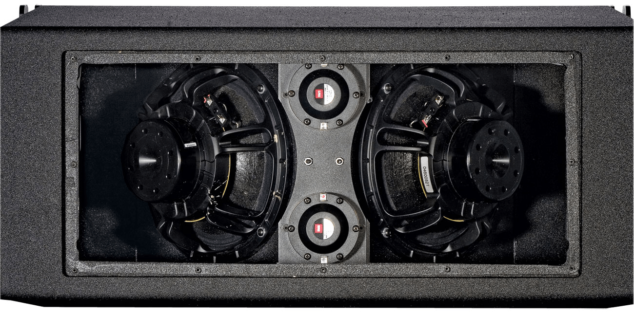

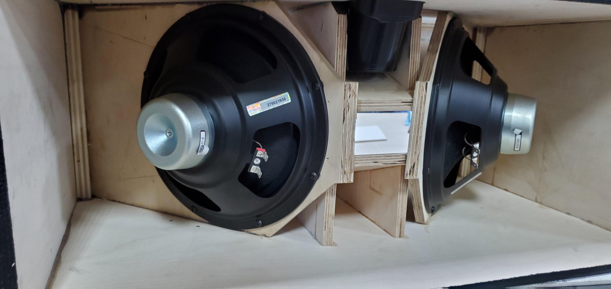

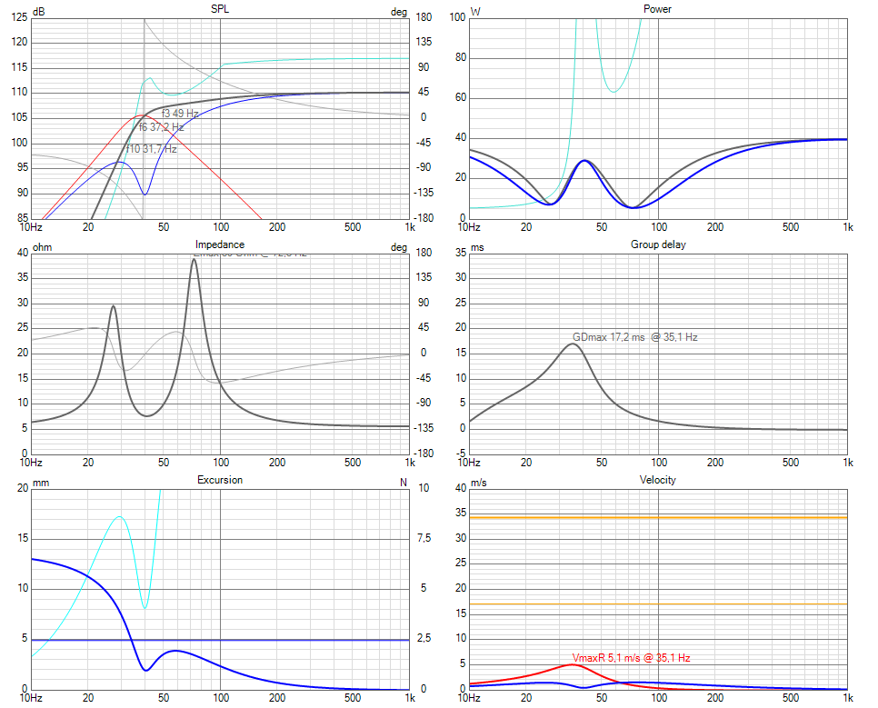

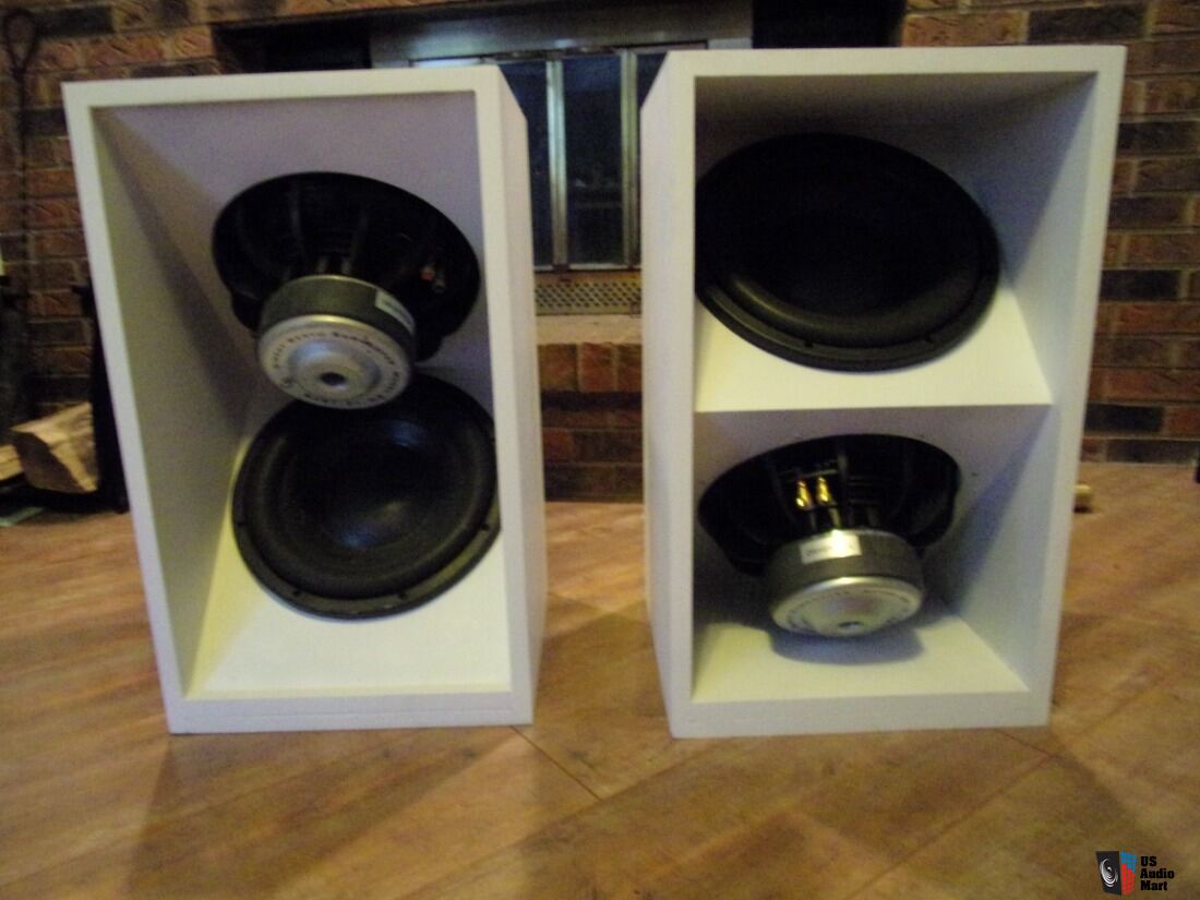

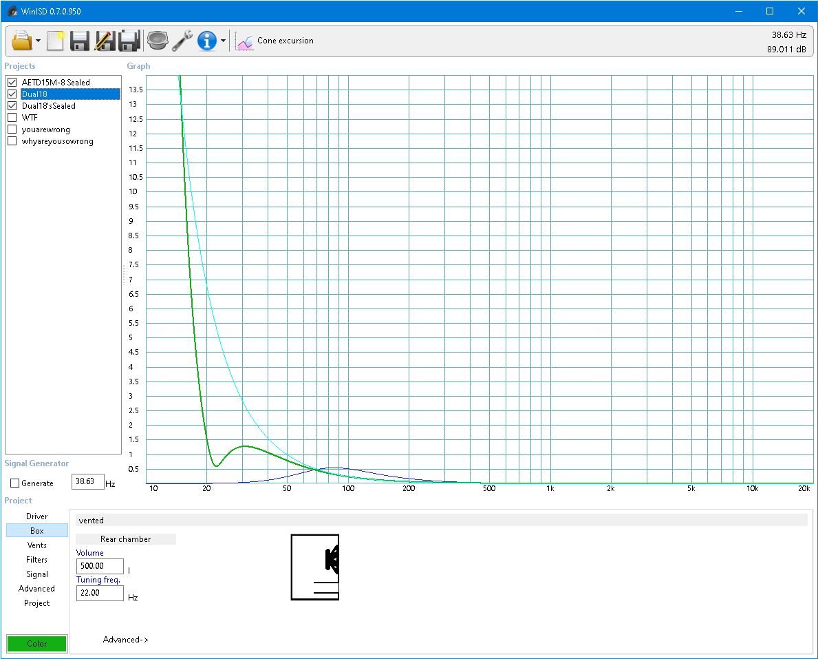

My woofer section is in the picture above. I am contemplating, an alternative configuration known as TMM. Also pictured above

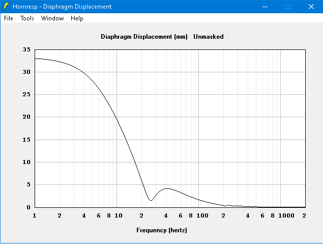

The excursion of a TMM with 18"s plus the planned rear subs...looks like this at 116db/1(green)

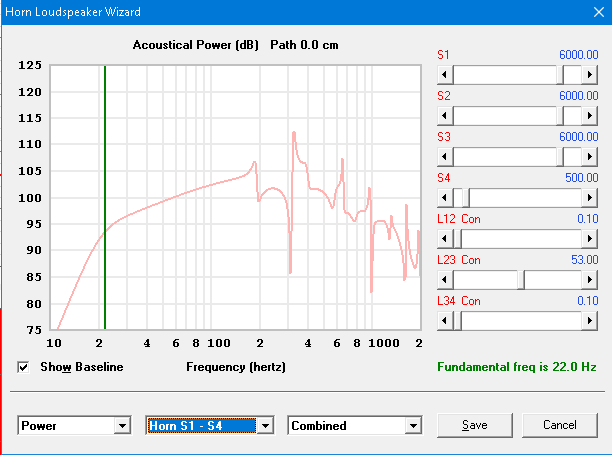

The reason I am contemplating this is because I am much more confident that I will be able to cross over the Axi+Horn at 200hz. I am trying to weigh pros and cons of switching the woofer section to Dual 18"s vent tuned to 22hz. I forced FR flat on the above Green plot. Excursion is below 1.5mm with the vented 18"s at 116db/1m
The Dark Blue line is actually 4 15" sealed, representing that portion of the spectrum, if I kept my current set up, and added rear subs. it is not forced flat but is rolled off at 65hz with a 4th order Hp in addition to the natural roll off.
In light blue is 8 sealed 18"s representing the current sub section (pictured above) plus rear subs that I have yet to build.
Everything is at 116db/1m force flat, except for the sealed 15, which is 116db/1m but with a roll of at 65hz.
In trying to nit pick the designs, I suggested that the PPSL has some phase flipping that limits the amount of summing/coupling to occur between the PPSL and the 15" sealed mid in their crossband. With dual 18"s on the face of the enclosure they would sum about perfect from 200hz down to cutoff.... I could theoretically fix phase with dsp and the PPSL would sum better with the 15. Potentially. I haven't tried in simulation yet, to get a picture of what can be done. The PPSl has usable output to 200hz it could play to XO if desired.
Once again, if I chose a TMM, excursion is still very low in comparison to my current configuration... It would be also, essentially, "Simpler"....We have talked about how, Simple, in an engineering perspective, is desirable.
So woofer section faceoff......
sealed 15+Sealed or vented 18' PPSL
vs
Dual Vertical stacked 15's in really big box tuned to 22hz, lightly dampened.
all while trying to including rear subs to show final excursion.

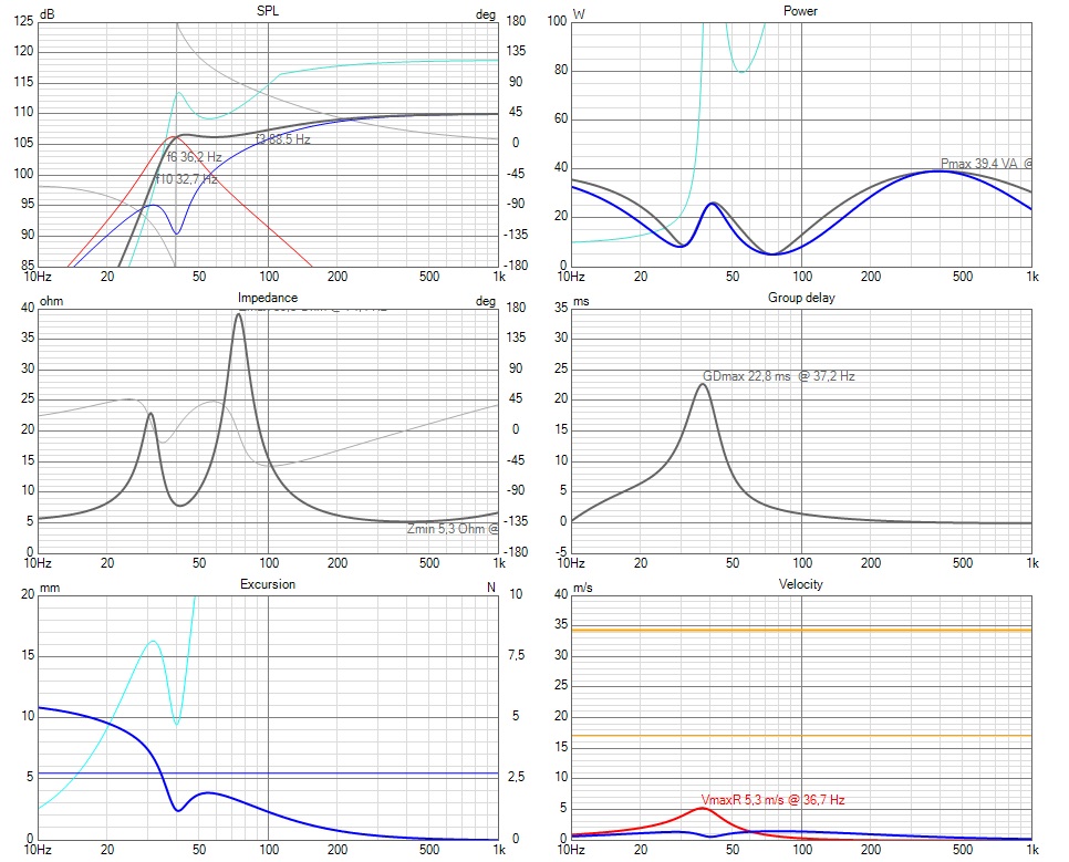

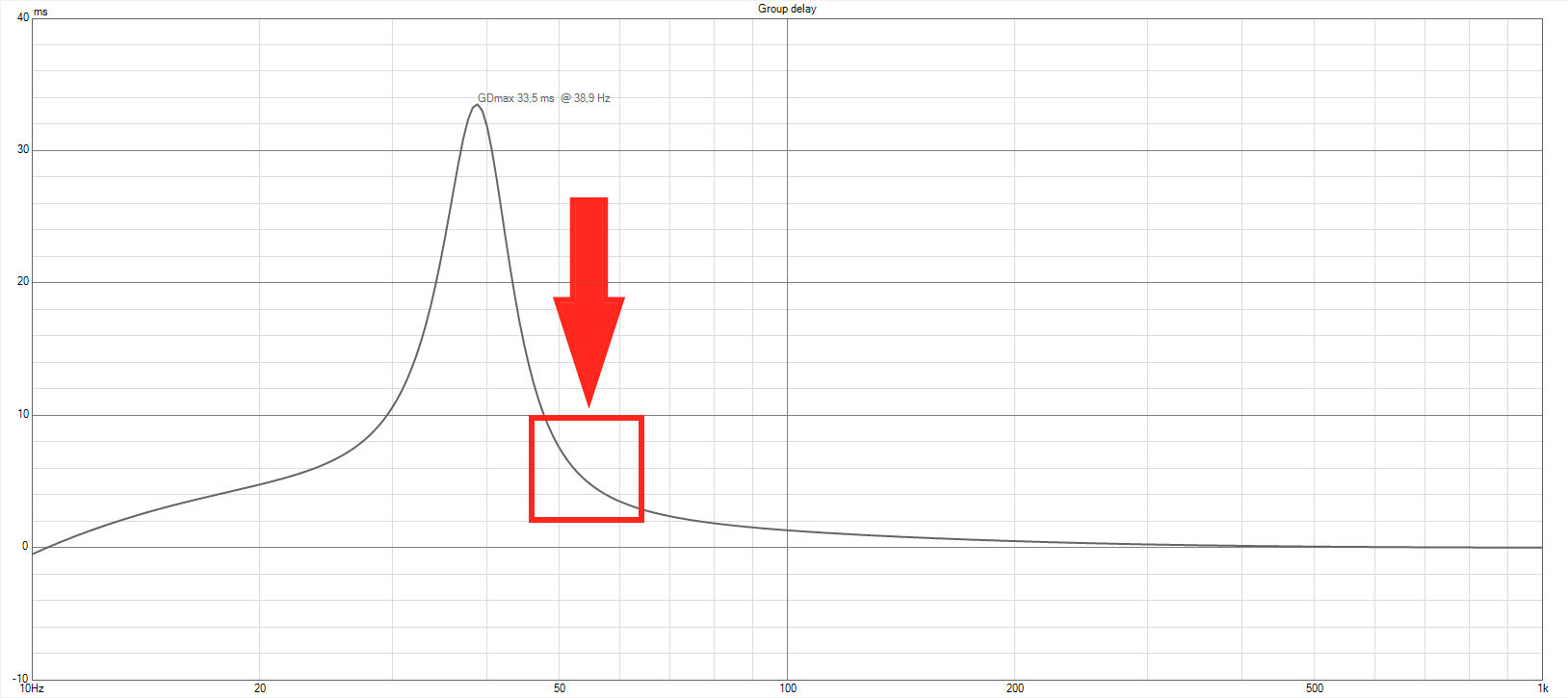

Following the visit to the local audio show and the experiences with 'slightly larger and more sensitive than average' 2-way hi-fi speakers, I was inspired to see if such acclaimed systems could be improved at a considerably lower cost.

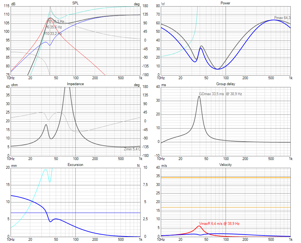

I selected 2 woofers, which seem suitable for the job. The concept implies a relatively high sensitivity - still fairly low efficiency though, so that a tube amp. or a quality A/B amp (like the Topping LA90) will suffice in most living rooms.
Both woofers in 80l BR tuned @ 40 Hz @ 40 W Power:
Both are budget woofers, the first from a respected professional audio manufacturer, while the second woofer is made in China and about 50-60% cheaper (and Le is 10x lower).
For comparison, the woofer that's used in a lauded, but very expensive 2-way system. Same cabinet size and tuning, but 65 Watts to achieve the same SPL:
Of course this is desirable, but there are some response irregularities in the upper region of the usable range, which are also visible in the measurements of the commercial 2-way speaker.
As previously stated by Dr. Geddes, the midrange should ideally be as clean as possible. My selected woofers need to be crossed lower for optimal directivity matching. However, the response is cleaner, even in the optimal xo region of the latter, least efficient woofer.

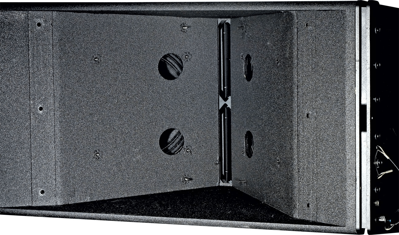

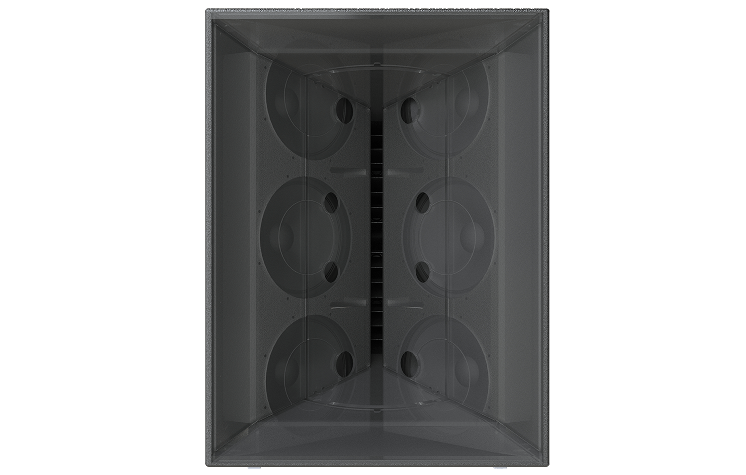

I believe a stripped down redesign could potentially make it a very capable hi-fi or studio speaker. A single BMS 4594Nd + 4x 4" or 6" + 4x 15" or 18" should suffice. And while it works, I'd rather get rid of the combiner and instead optimize the throat section and possibly add curvature to the horns.
I'd probably also convert the low section to this; remove 2 and bring the remaining 4 closer together:View attachment 1111323
Although I have serious doubts about severe manipulation of wavefronts for hi-fi applications - bearing in mind the 18Sound XR1496 in the
Ø Audio Icon, this concept appeals to me.

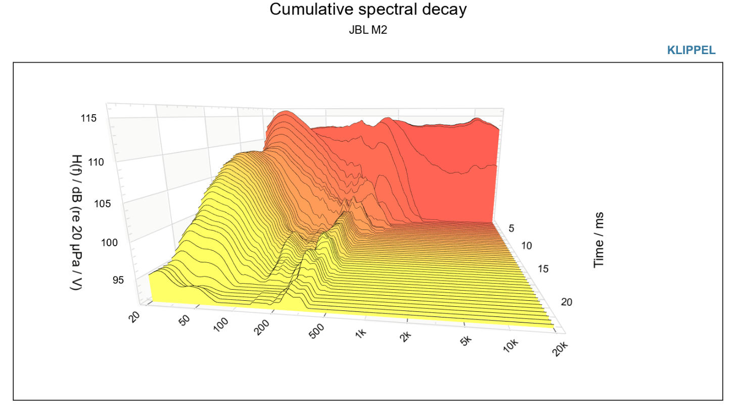

Just noticed Erin deleted the m2 decay measurements from this thread, and his website🙃
Even my threads asking him to share them are gone....

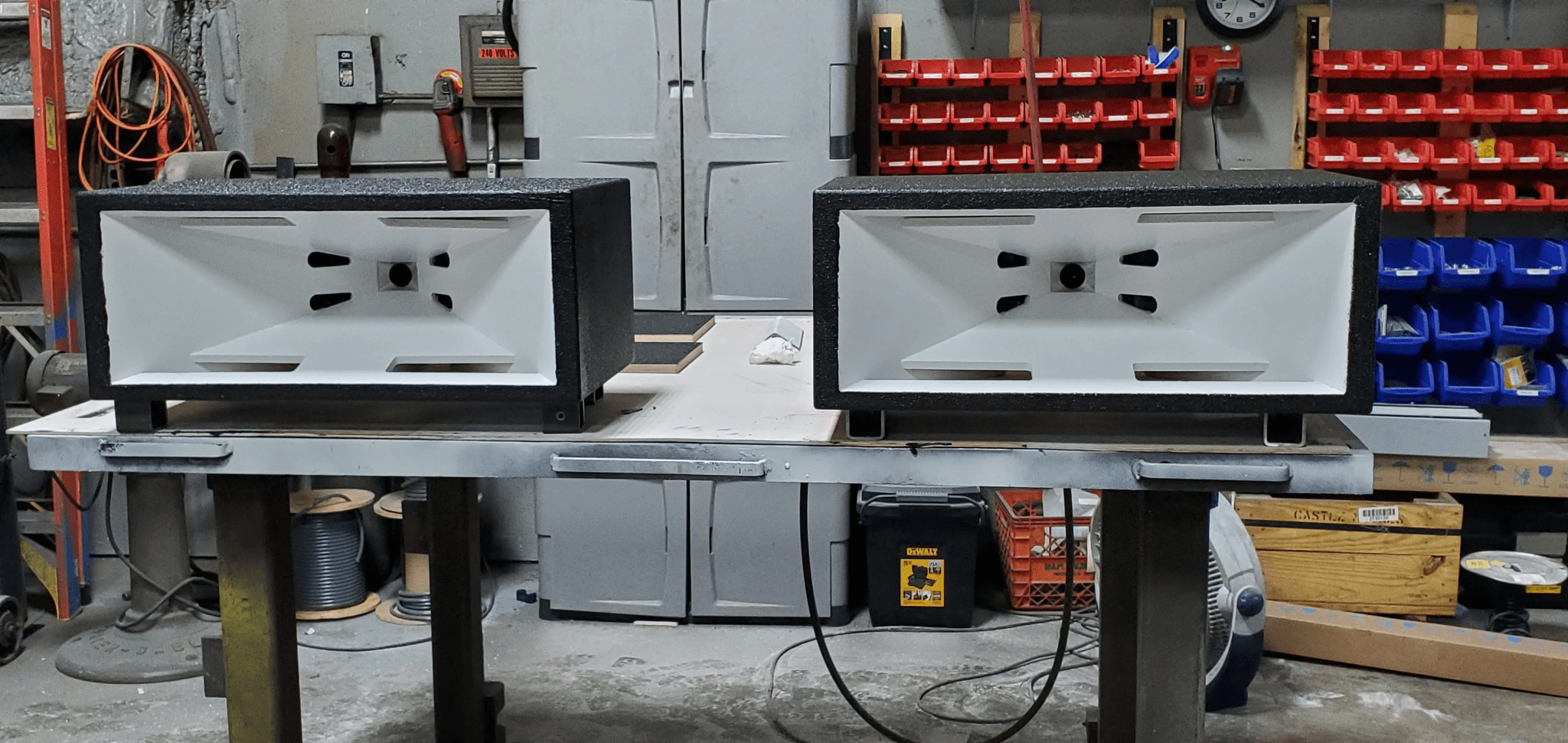

Art Welter's SynTripP with regular throat.
A smaller vertical acoustic load angle to increase power transfer, similar to radial horns.
