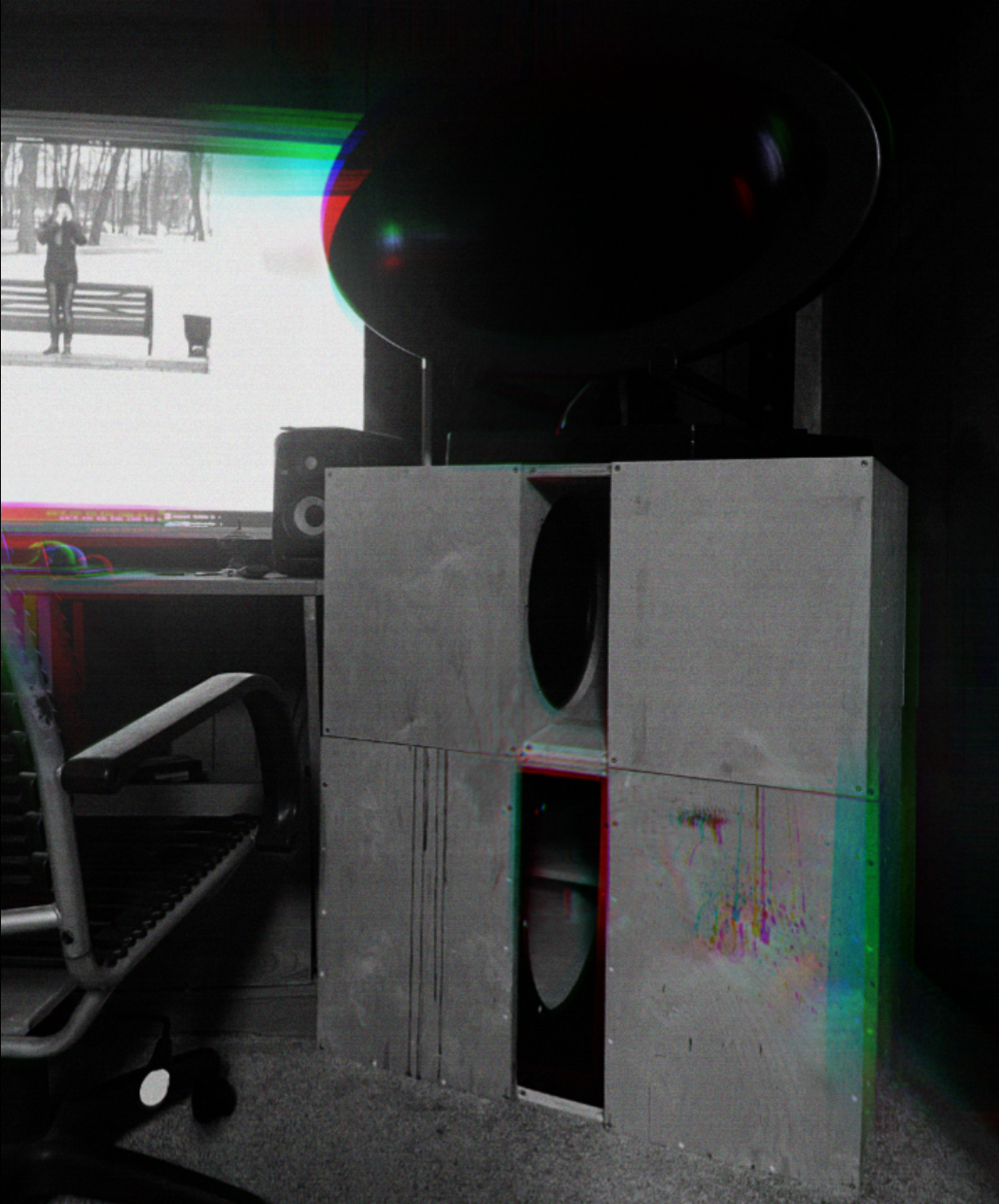

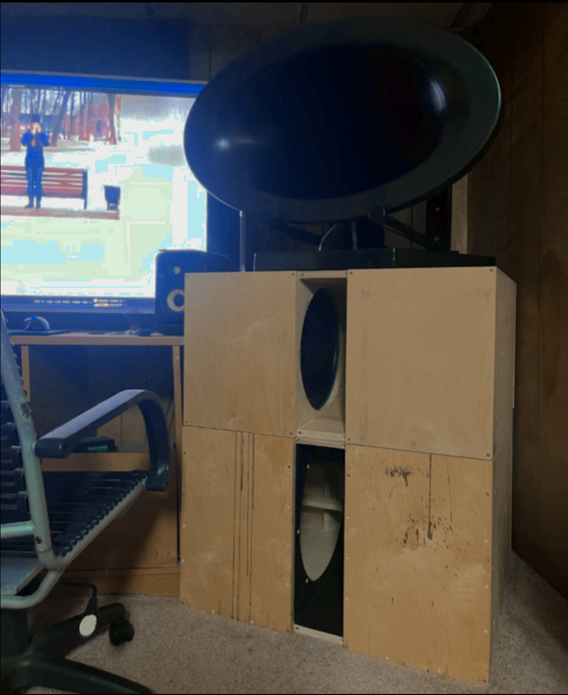

Its starting to take form. I won't like the horn height until it sits as close as possible to the top of the enclosure. Its strange to think something this size could sum very well at close range but as long as I get the horn down to where I want it to me, the concluded sound shouldn't very different than the first iteration. The plan is to test first with just the upper pair of woofers.

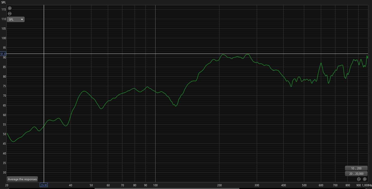

I do have good news, this is the frequency response I got during a quick measurement, but this was before I realized a driver was crapped out. In doors at about 16"

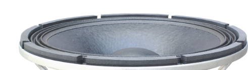

the woofer may or may not be blown... I am going to have to remove the woofer and start from the basics... there is a noise and I can't source it. Also, there is only one set of wires coming from the plug that have power...
So confused right now.... if I loosen up the mounting screws I don't get the noise........ I could theorize that the frame is being torqued but should be virtually impossible...
This foam is planted onto the back side of the baffle, depending on how the mounting screws are torqued its causing voice coil rub... wtffffffffff
