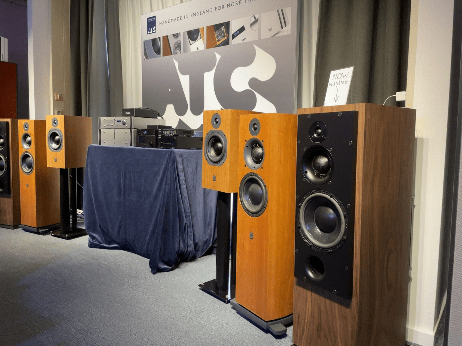

Some time ago, Krivium made apt comments about ATC, based on his experience.
Let me put it this way: there are reasons why people like Mark Knopfler exclusively use ATC in their studios.
My biggest complaint is their low efficiency which (almost literally) seems to suck the 'life' out of the music.

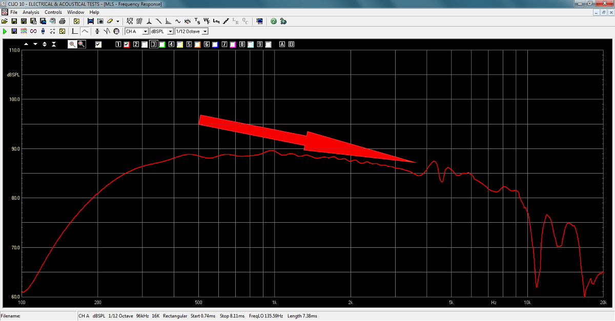

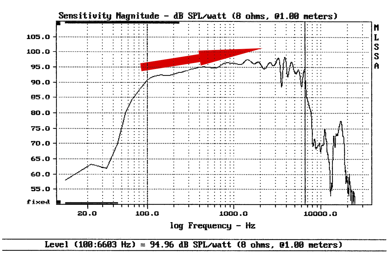

Which is better/preferable, apart from 5 dB higher sensitivity of the 2nd?
Depends mainly on the objectives/application, I think.
It has been many years since I heard a ATC speaker. There was nothing lifeless about it when I listened. It also sounded flat.Listened to these for a short while:

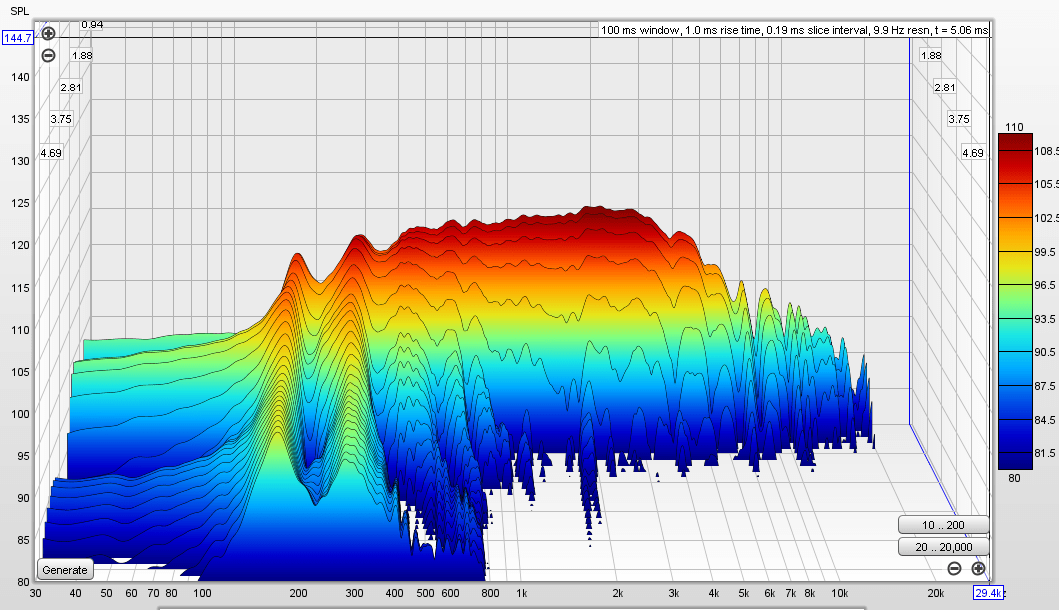

Even if it's a somewhat apples to oranges comparison, here the effects of material/motor/design-inherent damping characteristics vs the intendend passband are visible, giving a glimpse of (true) energy storage that leads to low(er) efficiency, albeit good looking plots.
What (exactly) is lost/remains in the subsystems?
This multifaceted phenomenon cannot be fully qualified, quantified and measured, even though 90% of ASR members probably think otherwise.
At some level, subsystems will most likely start to exhibit Malkus-Lorenz waterwheel dynamics.

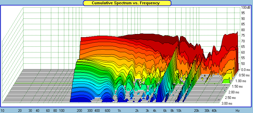

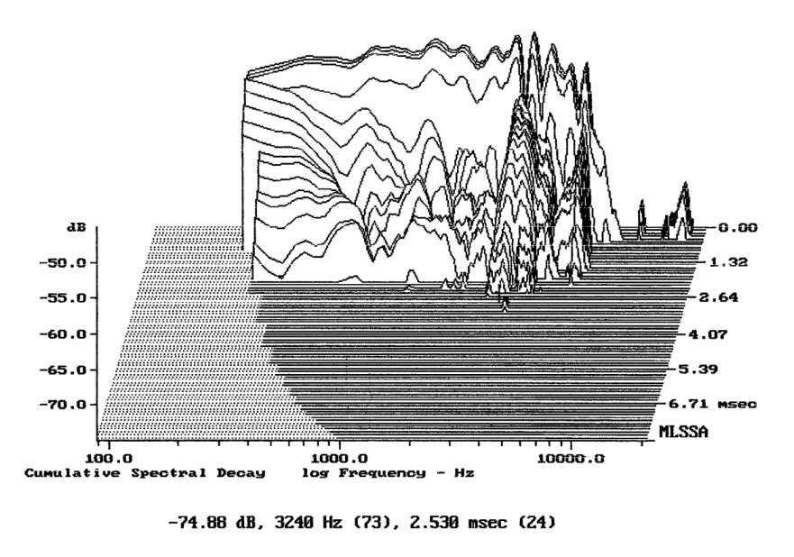

As Jeff Bagby's review shows, the ATC 75-150S is a different beast compared to the regular non-S version. However, I would never combine a dome mid with an ribbon tweeter, not even a RAAL 70-20XR, because of the completely different material and radiation characteristics.
The problem is that ATC's own SH25-76S dome tweeter is much less sensitive, requiring the midrange to be attenuated, which is not only a waste of efficiency but downright undesirable.
That said, there are plenty of examples of very good midrange domes used in highly rated systems.
