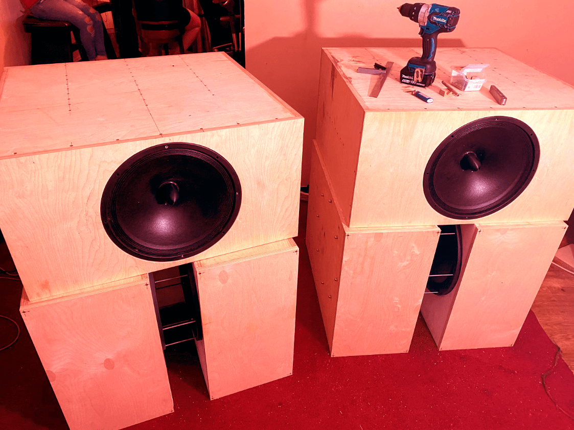

The stands are pretty heavy. 10guage steel. The horn is heavy. Approximately 3" thick walls. Maybe 65lbs each without driver 🤷🏽‍♂️

Compare n contrast to my design. Just imagine the my horns are there 🤔

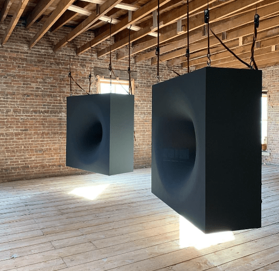

What if I create mounts in the front and rear that suspend the horn in the air? Leather straps maybe?
