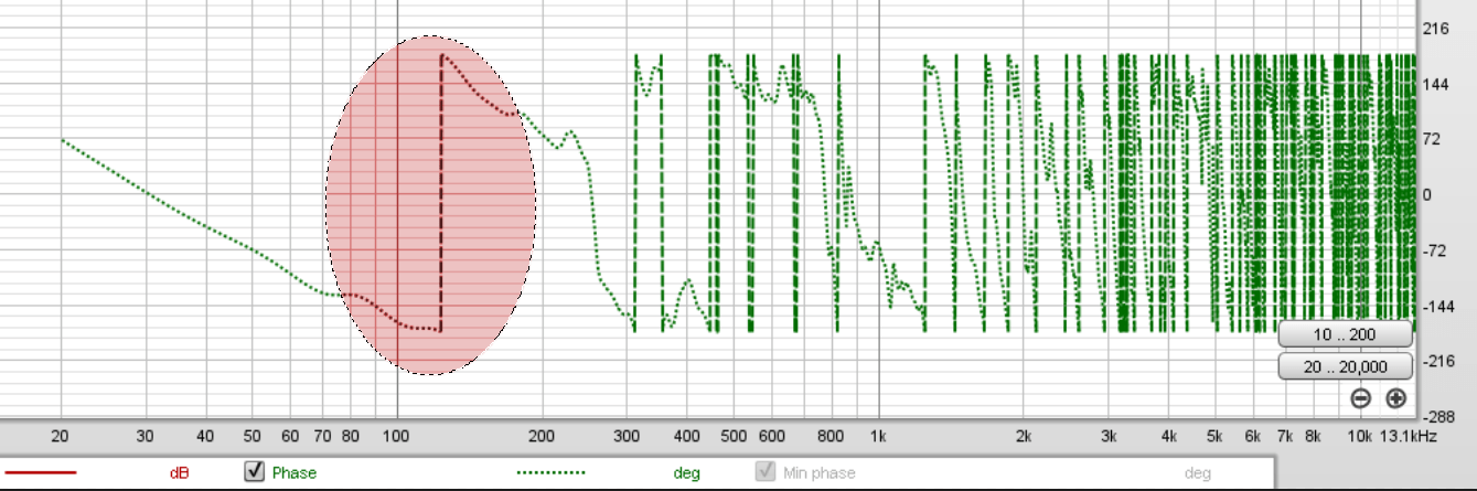

This is a close up measurement from the PPSL sub...Can this be fixed, Via DSP

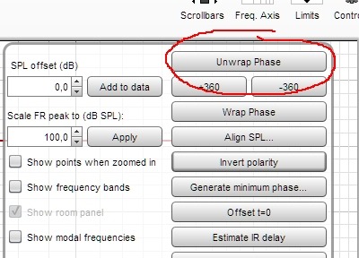

It's a "phase wrap", meaning the representation of phase stays within 360 degree, from +180 to -180, see the index on the right. Each time there's more phase rotation than either +180 or -180 you'll see a dotted vertical line and can trace it from there on. That's the "wrap" part. You can "unwrap" the phase in REW.
So that sudden jump you outlined isn't a phase jump, it just means you've passed the 180 degree line, you can continue following that graph at the bottom line at -180 degree.
You wouldn't want to use DSP to linearise a "phase trace" of a 500 ms measurement window though... at least, I wouldn't. You don't see the phase result of the driver by itself, you see the phase as generated by the total measurement, with the room noise and all reflections included.

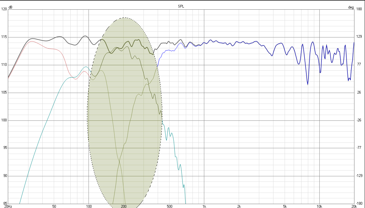

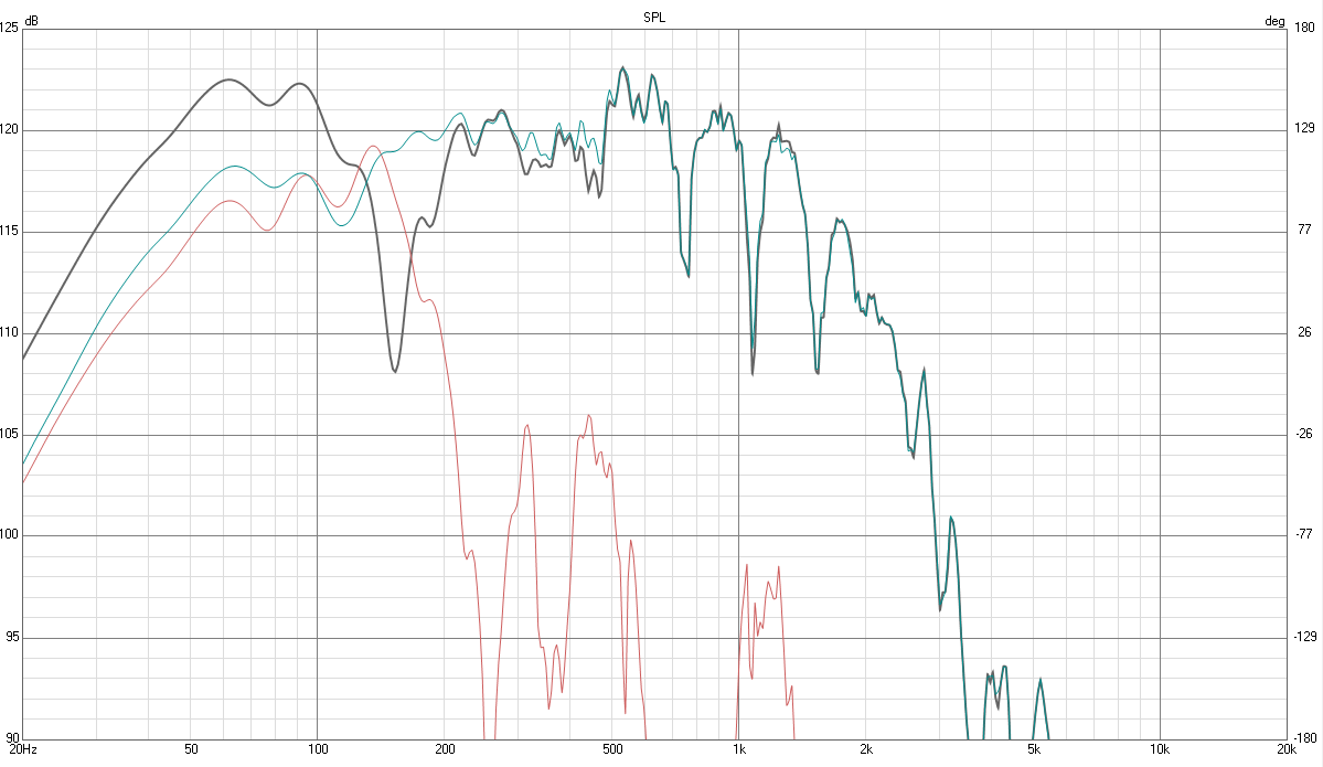

Ok, heres what summing looks like in the raw,
Sub inverted.
Thank god its alot better with the XO I used but I feel like summing drops off near 100hz (in the current xo design) and I blamed the phase....when I look at the phase I see what I showed in my last post....
Am I going to be able to create perfect summing or not? its just a matter of having everything in phase right? Is this normally or easily accomplished with my situation is what I am trying to research.
I don't like how I have some cancellation here, right before 200hz....I also am going to try to design a XO bringing the PPSL to 200hz....but I am saying that I would like it to sum perfectly with the 15".... in order to do that, phase alignment has to take place....Is that a big deal? Meaning, should it be easily accomplished or am I trying to perform brain surgery?

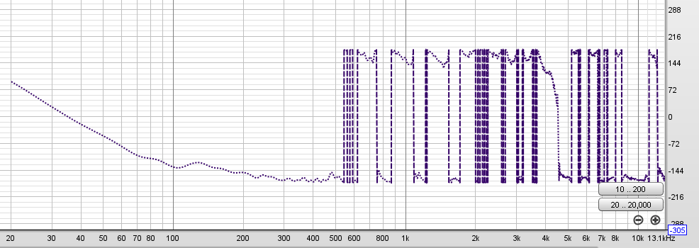

I would think that I need to make the PPSL phase look more like this (15m)
I pointed to the anomaly in the phase between 100 and 200 as culprit but coincidence does not equal causation, so I come to the board.

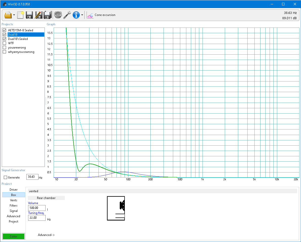

"trying to including rear subs to show final excursion"
There are rear subs, planned for the final configuration. Those subs will be ran as high as possible 120hz-200hz is my guess. So, when judging excursion character of the mains I included the acoustical output of the planned rear subs. The green line represents 8 18's (forced flat FR). the mains together have 4 18"s, and another 4 18's to represent the rear subs. 4+4=8. So if I ran vertically stacked 18"s up front. The green line represents excursion required for 116db/1m. Running these 18"s to the XO at 200-300hz. Everything would be Vented in this scenario
Or I could just leave it in its current configuration, of 15" over dual 18's in PPSL. If I can create perfect summing using DSP, this configuration is much more efficient as long as the 18"s are vented, but even if they aren't the excursion never touches the 15" so headroom in the midrange is higher.
Headroom is not a problem for either scenario. Its been suggested that fixing phase to cause perfect summing between the drivers should not be an issue, so it kinda settles it for me. I can also leave everything sealed and still not worry about headroom due to the high xmax of the 18"s....and then it would be up to me to decide if I need the increase in lower frequency headroom. If you look at the light blue, that is 8 sealed 18"s.....this is what the excursion of the mains would look like in combination of the rear subs, flat FR at 116db/1m.... I think could leave everything sealed and be ok. :LOL:
