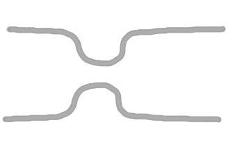

this is likely a lacking expression of the BR ports I saw in the video but when I seen it, my first thought was, Oh we can 3d print that....I remember the guy commenting that the restriction didn't introduce more noise, also eliminating the need for more damping
I guess its the flair that reduces noise? and the smaller CSA serves as a High pass filter?....Wow its not even that complicated.
If it works well....one could possible get away with a larger than usual BR port that doesn't bleed midrange excessively, and maintains the efficiency of an undamped enclosure, tune that bad boy to 20-25hz....what we talkin? 500cm2? 1000cm2? lol

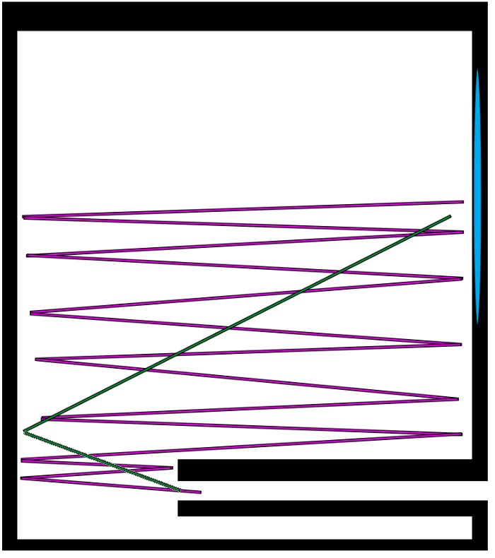

if anyone understood the physics of acoustics enough to easily explain how port CSA effects the amount of midrange and treble that comes through, I'd appreciate it. I don't think I ever fully understood why folding helps in this area as well...I just accept that it is lol
Something to do with how higher frequencies travel, and diffraction....path to the Port and CSA of the port.... but I'm not sure how to look at CSA's function in this.
I would theorize that some how treble has to take a longer path length to get to where its going, if where its going is out of the way and the way its pointed is not directly at, where its going....Does that make sense>?lol Like its high directivity lowers energy by increasing path length...
Lets say that purple is treble and green is mid bass.....The lower directivity of the mid bass sends more energy at angles that can take shorter paths out of the port.... Then I guess that a smaller CSA would serve as more Surface to reflect energy back into the enclosure.
The question is, how restricted is too restricted.....Lets say with the 500cm2 BR Port....if we placed a flared restriction into the line, how low is too low.....How effective is the flair for reducing noise....exponential flair? The ol 15-20m/s or less, that won't exact work.....I would design the port at desired final CSA, then incorporate the flared restriction from there, but velocity in the restriction is going to peak, then what? I mean velocity would fall off again but.....no noise whatso ever from the flair? I mean does fairing 100% reduce noise?
