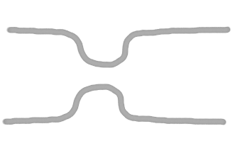

View attachment 1115281 ..I remember the guy commenting that the restriction didn't introduce more noise, also eliminating the need for more damping
I guess its the flair that reduces noise? and the smaller CSA serves as a High pass filter?....Wow its not even that complicated.
If it works well....
Did "the guy" have any measurements to back up his comments?
Effectively, what you have drawn is a small, short port with a larger resonator at one end.
The restriction would result in an acoustic Low Pass (high cut) filter, and lower Fb than the full sized cylinder (if that's what the cross section is supposed to be) but the reduced port area would make it whistle at high velocities. OK for low dynamics, fart generator when turned up.

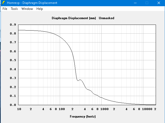

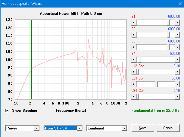

This is one of my Axi+Horn sim, at high spl

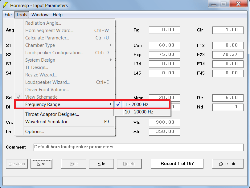

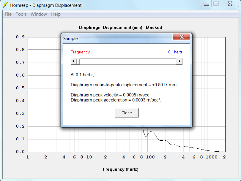

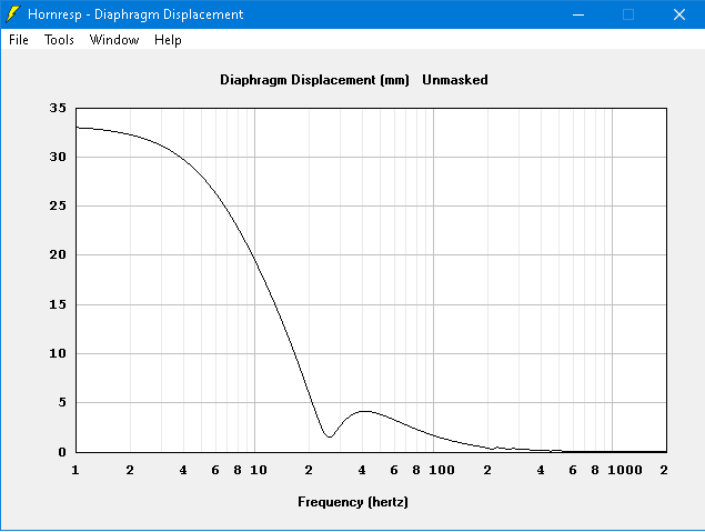

I know my Hornresp simulation is lacking BUT.....is there a reason why the excursion doesn't continue to go into oblivion on the LF side?....Is this what the excursion trend line, of a 15", looks like past F on a BR, if we could see the rest of the trend past 10hz??? I think so...
Sooo, I think I missed something. Its been sort of confusing jumping between trying to keep track of where excursion is, via THD and where THD is at, 1m....Horns are complicated in that manner and spl gets high quickly within the throat.

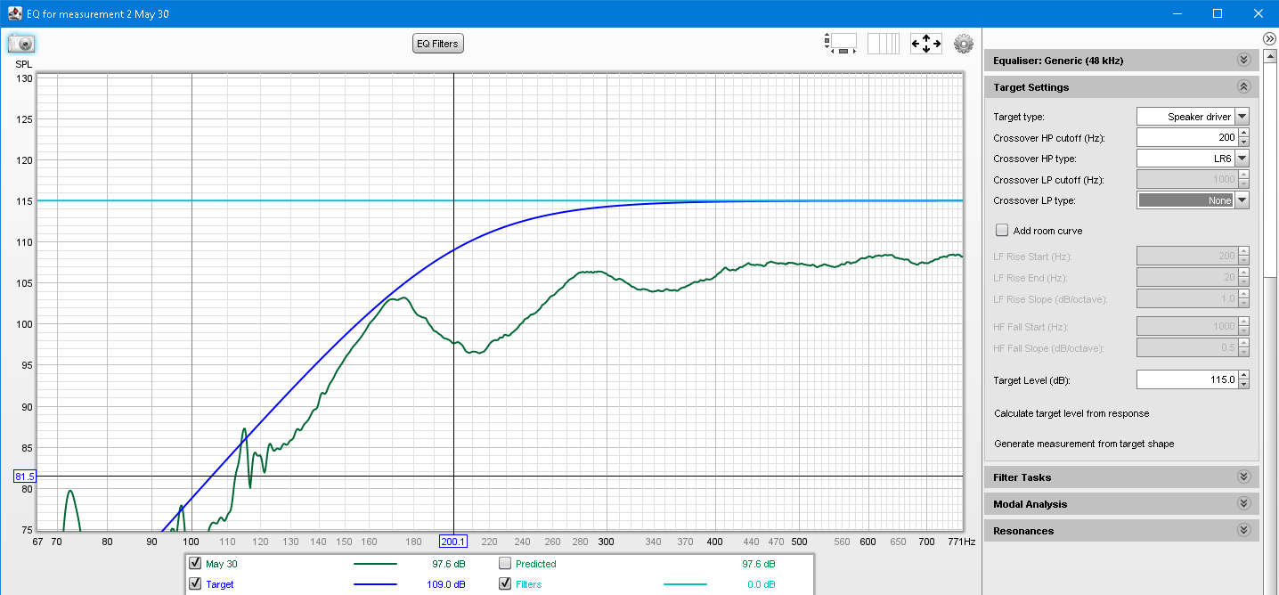

Turns out I have a lot more headroom than I thought and that the 200hz XO is not only, a likely reality, but I could potentially go lower with a steep enough filter....🤯
Huge plot twist for me at least

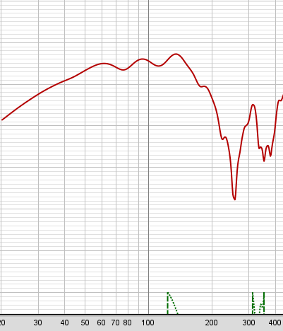

So heres my last effective voicing in blue (actual measurement NA ATM) 115db, ~1m, indoors, THD peaks at the 200hz ~24% 2nd order but is lower below and above....Looking at the null in the raw outdoor response in green...makes perfect sense....So even though THD high, it would lower if we lowered the mic or and there is no issue that I can tell yet, below 150hz.....I was just thinking that I need to run 2 tone test for modulation and see what it shows me. In the past I've ran one tone at say 20hz and another at maybe 7khz and played with EQ until I found good a good voicing. Not sure how that played out with the current voicing.
With the addition of the mid woofer, Thd will lower at 200hz.
While playing passband at 115db/1m, 200hz is at 109db...add another channel for stereo and we are down to 106db. Thd is fine in both cases.
So....I need to verify what it is, I think I know. I do know that I can use steeper filters, that will improve excursion, ever more. If things are looking up, I could be inspired to do something different with the woofer section, being that 200hz is well within 18" territory.

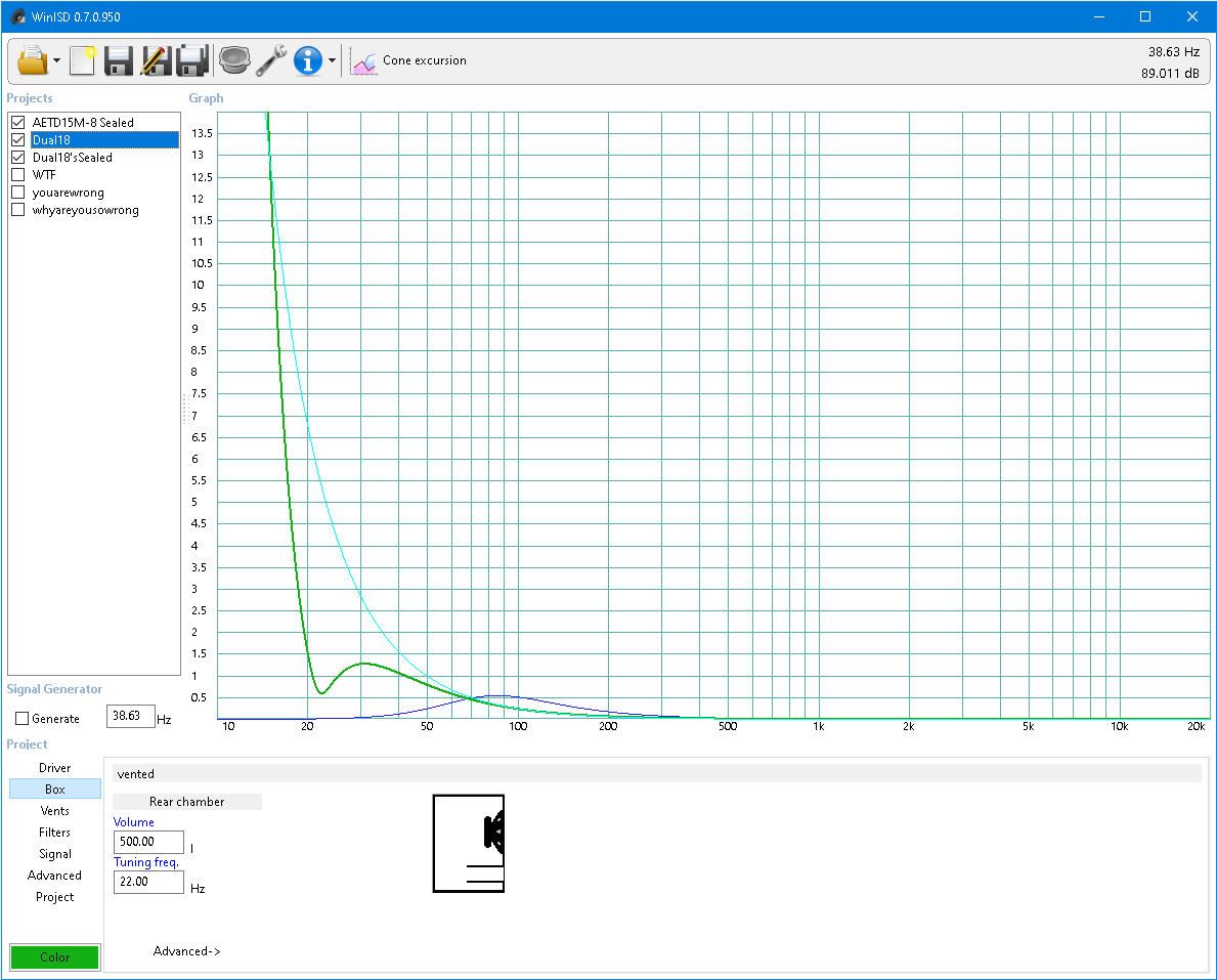

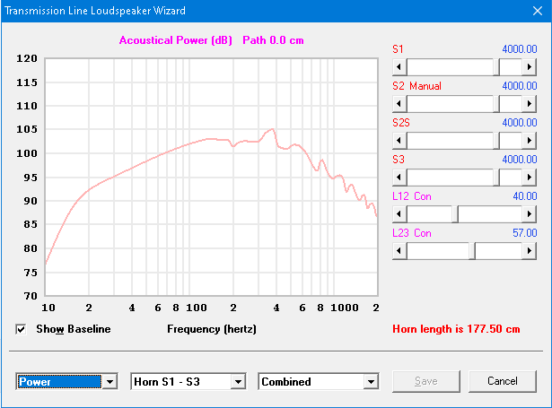

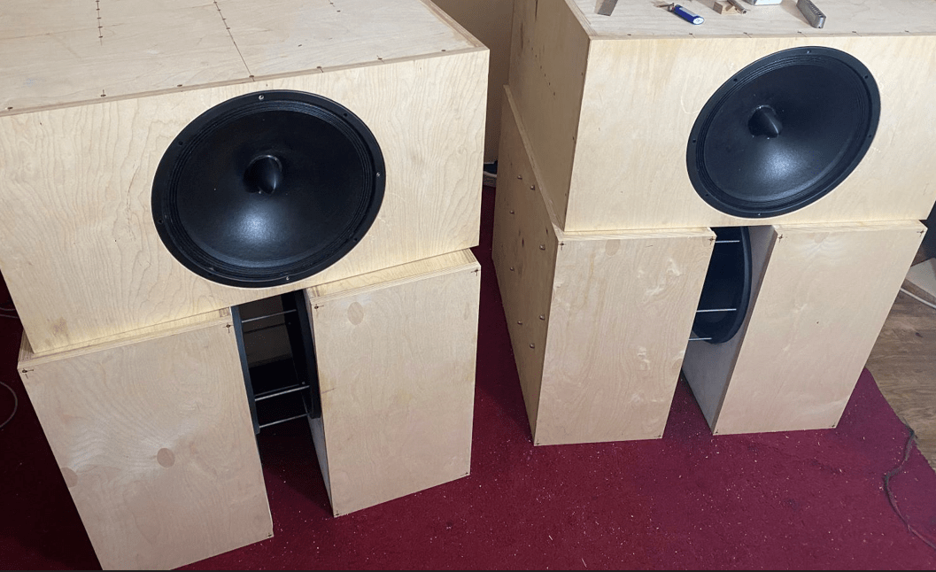

I need some opinions, I am playing devils advocate with my current design. Being that I can most likely, easily cross at 200hz, to the horn.
.If I use Offset horn and a little bit of stuffing I can clean up the FR pretty good. Offset horn, automatically generates Path parameter, and allows damping in the sim. BR does allow damping in the simulation and I think I should have set a Path....not sure yet.
So now the question is....should I Lol
2 18"s facing front, to create a TMM crossed at 200hz....~500 liter enclosure tuned to 22hz (approximately the above sim)
Or
1 15" sealed mid crossed to 2 18"s PPSL(sealed or vented)....
Both situations, as long as the 18's are vented, excursion is below 1.5mm, when an approximation of all drivers are included in sim. Below 1.5mm at 116db/1m...When looking at mains and rear subs ballpark dynamics, half space.
The PPSL has some phase issues that limit summing to mid 15". That can be fixed with phase EQ, supposedly, and the PPSL is good to 200hz
The PPSL could be sealed or vented. Right now its sealed.
Vented Dual 18's in a TMM in combo with rear subs, has not a lot of excursion. This is ~116db with FR forced flat, in green
I think the imaging would be better with a TMM, midrange might be better as well... The effect of spaced out, multiple, redundant, bass sources would stronger with with TMM, resulting in a smoother FR in the room....It looks good on paper but I am unsure. I'm sure I can get some good remarks to help me see clearly

Too many TLAs and incoherent writing for me to understand what it is that you are actually asking.
what exactly? is anyone else confused, plz let me know, which part exactly, I did not explain clearly. So that I can elaborate. Cause I really want to know your opinions.
I may be forgetting what it is that you don't already know, causes one to explain things, as if you already know the backstory, etc.
My woofer section is in the picture above. I am contemplating, an alternative configuration known as TMM. Also pictured above
The excursion of a TMM with 18"s plus the planned rear subs...looks like this at 116db/1(green)
The reason I am contemplating this is because I am much more confident that I will be able to cross over the Axi+Horn at 200hz. I am trying to weigh pros and cons of switching the woofer section to Dual 18"s vent tuned to 22hz. I forced FR flat on the above Green plot. Excursion is below 1.5mm with the vented 18"s at 116db/1m
The Dark Blue line is actually 4 15" sealed, representing that portion of the spectrum, if I kept my current set up, and added rear subs. it is not forced flat but is rolled off at 65hz with a 4th order Hp in addition to the natural roll off.
In light blue is 8 sealed 18"s representing the current sub section (pictured above) plus rear subs that I have yet to build.
Everything is at 116db/1m force flat, except for the sealed 15, which is 116db/1m but with a roll of at 65hz.
In trying to nit pick the designs, I suggested that the PPSL has some phase flipping that limits the amount of summing/coupling to occur between the PPSL and the 15" sealed mid in their crossband. With dual 18"s on the face of the enclosure they would sum about perfect from 200hz down to cutoff.... I could theoretically fix phase with dsp and the PPSL would sum better with the 15. Potentially. I haven't tried in simulation yet, to get a picture of what can be done. The PPSl has usable output to 200hz it could play to XO if desired.
Once again, if I chose a TMM, excursion is still very low in comparison to my current configuration... It would be also, essentially, "Simpler"....We have talked about how, Simple, in an engineering perspective, is desirable.
So woofer section faceoff......
sealed 15+Sealed or vented 18' PPSL
vs
Dual Vertical stacked 15's in really big box tuned to 22hz, lightly dampened.
all while trying to including rear subs to show final excursion.
