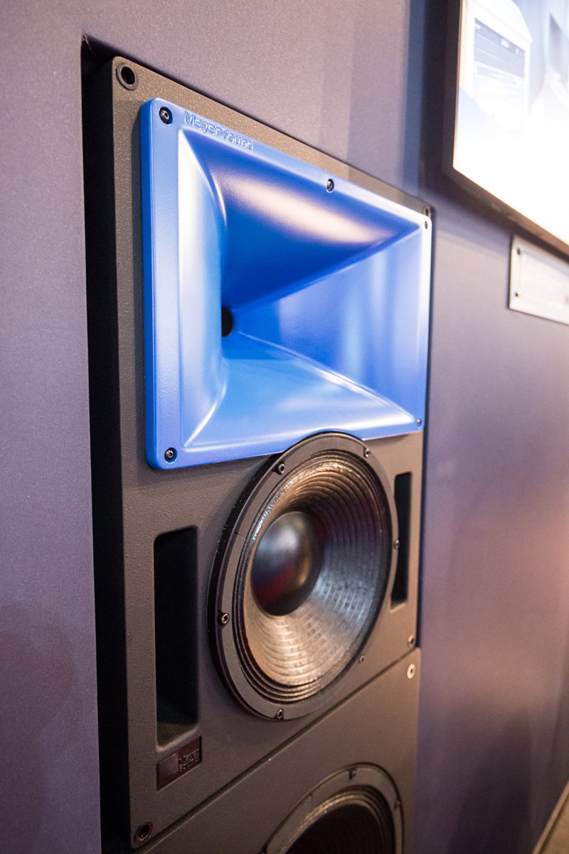

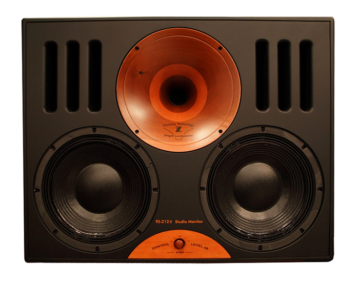

This is an artistic impression of Holland & Newell's famed (hyped?) AX2 horn, used in both products:
The bigger brother is a 3 way with 2235 used from 16 Hz to 120 Hz, 2226 from 120 Hz to 482 Hz, and 2445 from 500 Hz and upwards.

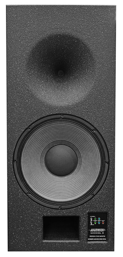

Are Faital CD better in terms of quality (for hifi I mean) than beyma for example? Something crossed around 1khz.
The woofer of that Electromotive Model 5 monitor is looking suspiciously similar to my Beymas.
