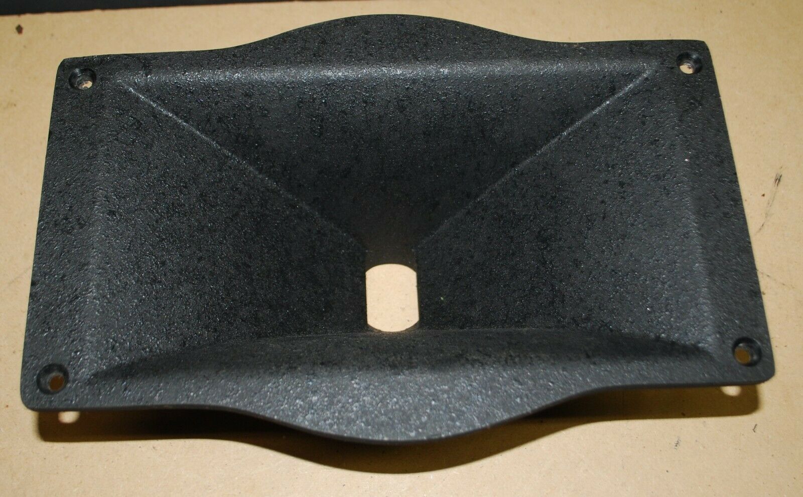

Apart from the shape of the slot (sharp/smooth edged or bubble-like) it's the location of the slot (along the z-axis) that determines its impact on the response.
Nearly all JBL horns, from the bi-radial days up to now, are a combination of a slot near the throat and 'bubbles' towards the mouth, in the vertical, horizontal or both walls. The M2 waveguide can be considered as the culmination of decades of R&D.
I assume the further back the slot is, the better in terms of resonances etc, right ?
In general yes, but the physics of diffraction slots is very complicated.
I have yet to find research that's all encompassing in this respect.
Most research is done using BEM/FEM, because as far as I know, there is no such thing as a unified mathematical theory of diffraction slots.

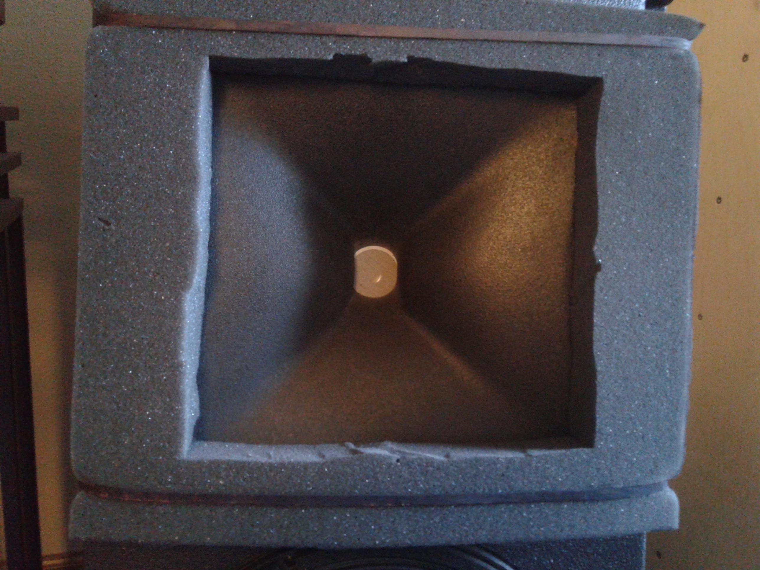

There's a white rim visible in the upper section of the throat. Is the driver properly aligned?
I think so, but as it turns out, the junctures in the horn do not affect performance.
Visual psychoacoustics do play a role though! 🙂 (WAF role too!)

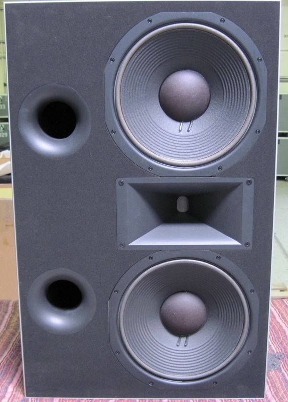

One of JBL's most elegant horns:
If you reduce the throat size from 1.5 to 1", increase the vertical coverage angle by about 10-20° and add roundovers, you'll end up with something like this:
Hmm, maybe not.
Stock from factory.
Great, another thing to do..........
Adding 1 - 1.5lbs of acousta stuff helped the mids in the jbl.
