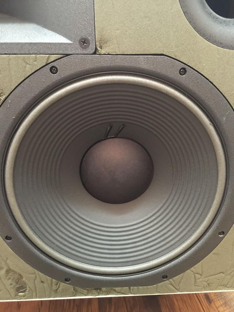

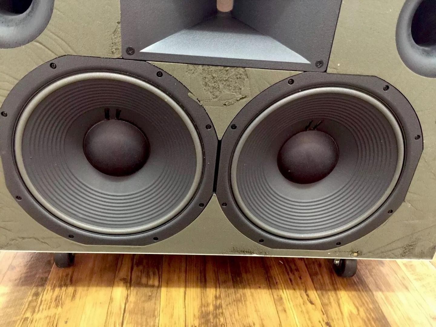

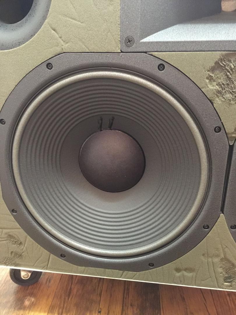

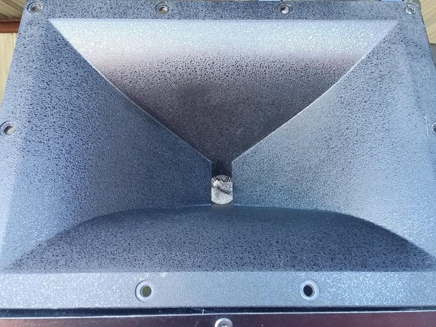

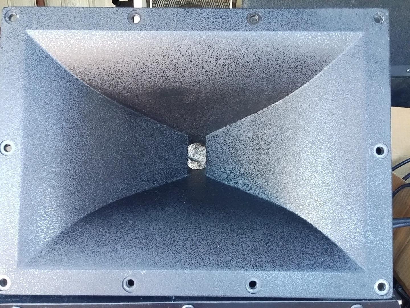

Is this what the Nextel on your DMS-1s looks like?
jbl-studio-monitors-model-dms-matched_1_f936987bb1413001c4bcf43bf3f60077 (2).jpg276.3 KB · Views: 379
jbl-studio-monitors-model-dms-matched_1_f936987bb1413001c4bcf43bf3f60077 (3).jpg163.5 KB · Views: 378
jbl-studio-monitors-model-dms-matched_1_f936987bb1413001c4bcf43bf3f60077 (4).jpg170.2 KB · Views: 343

The stuff on the baffle of those DSM-1s above doesn't look like Nextel,
it looks more like foam.

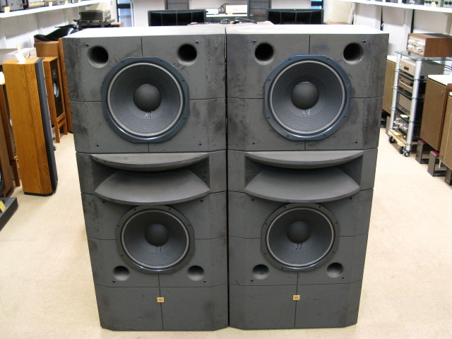

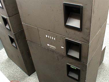

Yes, that is a foam. My one looks more like this JBL M9500, while not as bad as this. I think this M9500 is damaged by humidity and the owner tried to remove the stickiness. My one is not damaged by humidity, no stickiness, thanks to north eastern weather.
Nextel may have some kind of acoustic damping effect, but I don't think JBL advertised the finish of M9500 that way. AvantGarde does?
Well, I happened to find this. 🙂
(Google translate) JBLテクノロジーの変遷 | the re:View (in the past)
”In M9500, Nextel coating is done to stop the extra noise of enclosure, and it can be said that it is designed like a monitor."

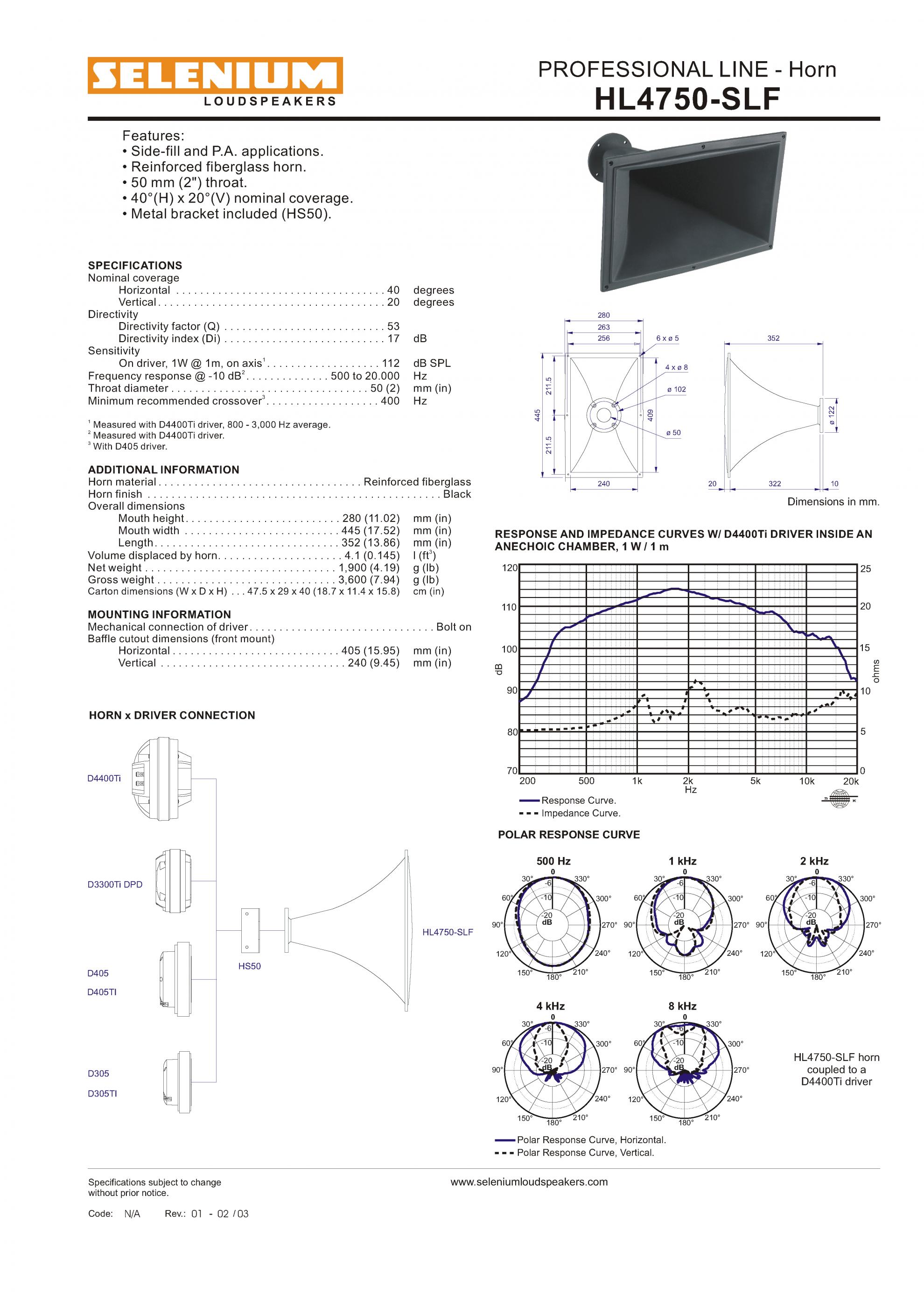

Often, people who like spherical/JMLC and similar round horns are not fond of rectangular horns, especially if these are very short.
However, this horn appears to be an exception:
This is essentially a slightly modified JBL 2386.
There's no diffraction slot and it facilitates a crossover below 500Hz.
However, coverage angles are only 40°(H) x 20°(V), in practice a little wider though.
