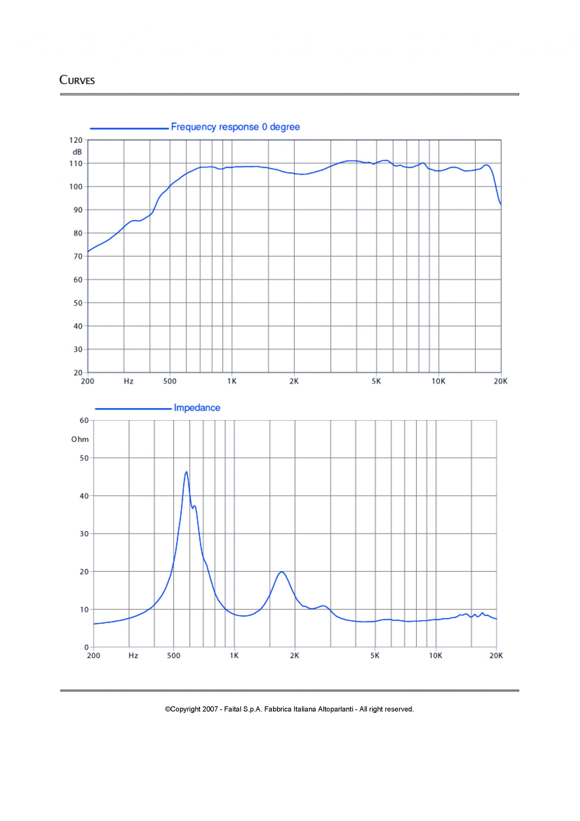

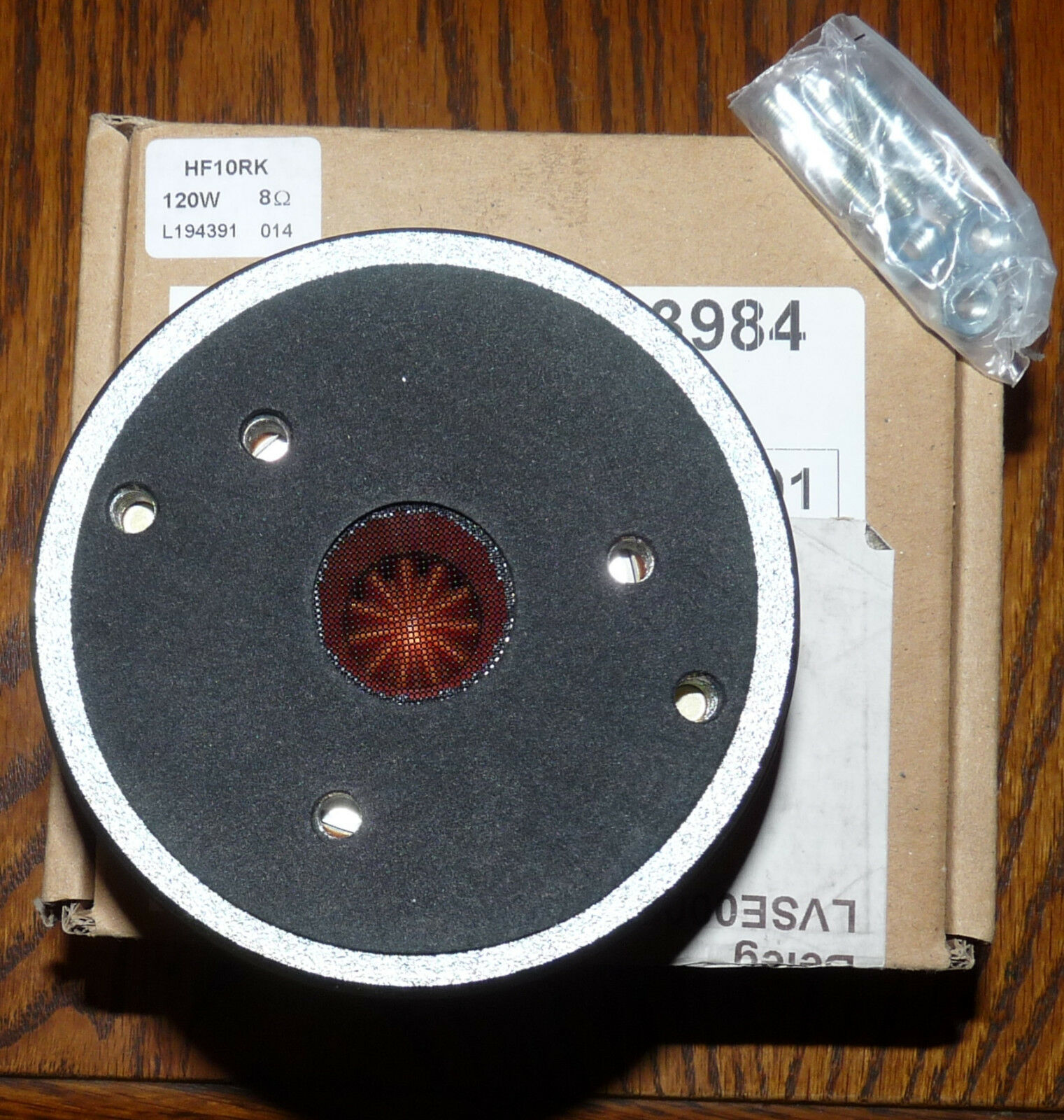

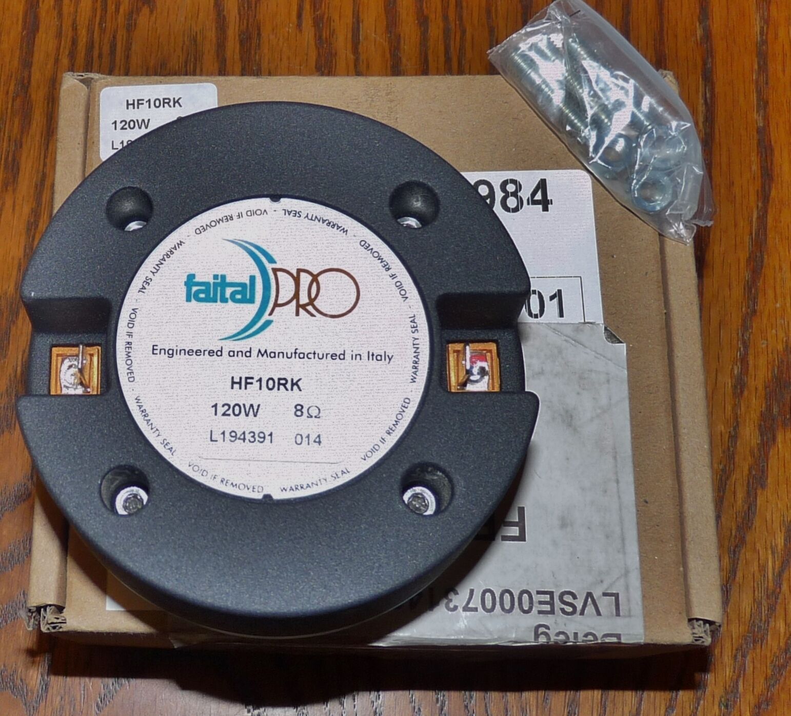

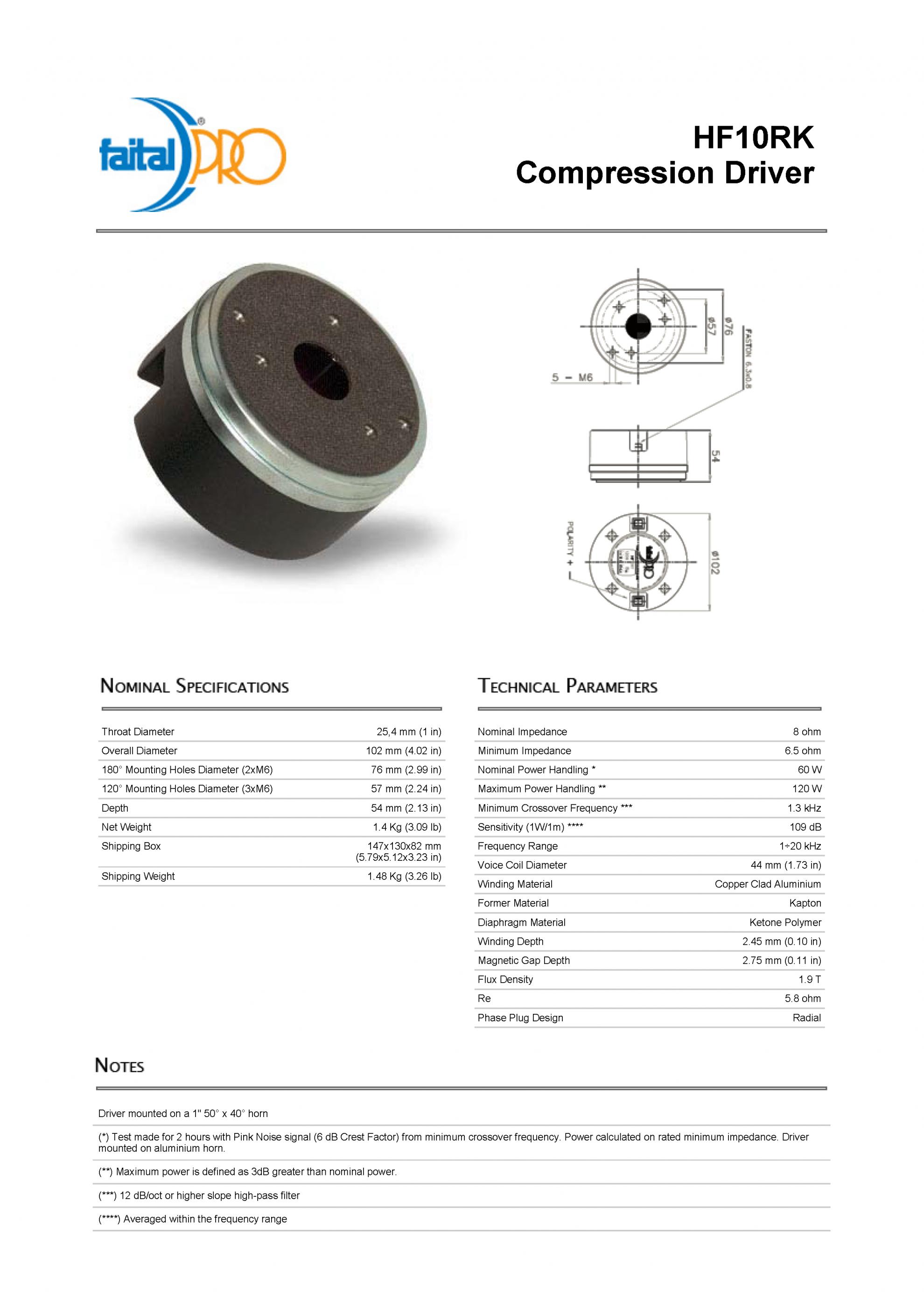

The 44mm Faital drivers would work crossed around 1kHz, especially the HF108 and HF10AK.
daemonsgr, I assume you are located in the UK?
This is probably the best driver currently available in Europe at €65 each, if you order a pair.
The only possible downside is the radial phase plug, that usually works better with Tractrix and similar horns.

wow! better than more expensive faital models?
No, it's not better than the more expensive Faitals, but it's good especially at the current sale price > it's discontinued.
You won't find a similar Nd driver for that kind of money.

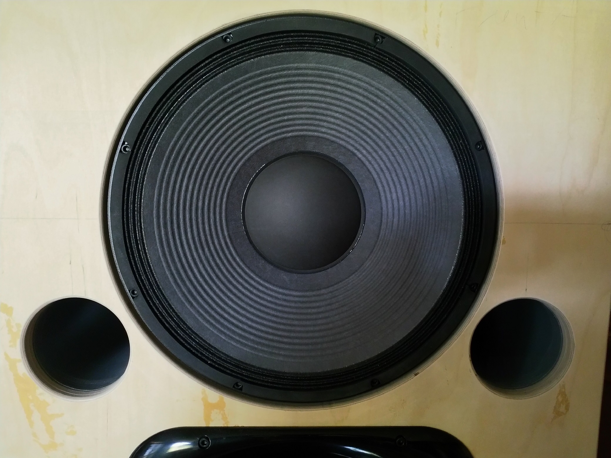

From post 1001:
The cone is different though, especially around the dustcap.
Moreover, despite its generous X-max, the Beyma wouldn't appreciate port tuning at 22kHz.
They pretend to use TAD, but that presumably applies to the comp. driver.
The only TAD woofer with a similar cone/dustcap is the TL-1602, but that one has a foam surround instead of a triple roll.
Well, depending on how you photograph it even the cone center looks quite similar. And it seems to use the same dustcap.
And I fully agree with you that a port tuning at 22 kHz wouldn't make any sense ! 😉 That would not even work with a superexpensive TAD. 😛
Mine use a tuning frequency around 30 Hz BTW.
Regarding the "generous x-max": From the voice-coil overhang I regard them as having an x-max of +- 5 mm. Which is still sufficient IMO. I strongly believe that a two-way speaker is seriously underdimensioned if its woofer regularily exceeds +- 3mm of excursion.
And the ones on the Model 5 are definitley not TAD or JBL drivers because they are lacking that typical brushed front of the basket.
It could be that these woofers are indeed built by Beyma but that they are a custom build.
Regards
Charles
