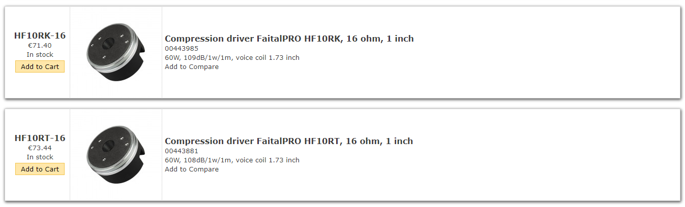

Where can you buy they them for that price in Europe? A quick google and I found only the AK version.
Here. You need an account and you receive a discount if you order more pieces.
Thanks...saw your earlier post. Got the STH-100But don't try this
Thanks very much. I have an account there already...so cool.Here. You need an account and you receive a discount if you order more pieces.
Bummer. Ordered and paid. Got refunded. Prices are up. Looks like it was a mistake on their website.
Too bad.
Prices presumably applied to drivers in stock.
I believe the French guy bought a pair at the low price.

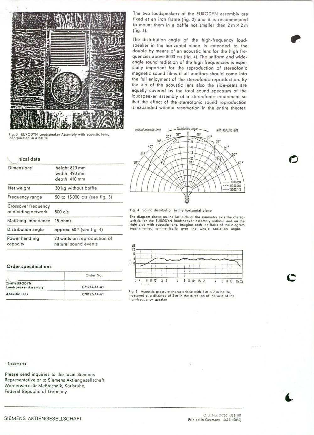

What is missing for me is the Siemens Eurodyn which is a classic 2-way speaker system to cover the whole spectrum.

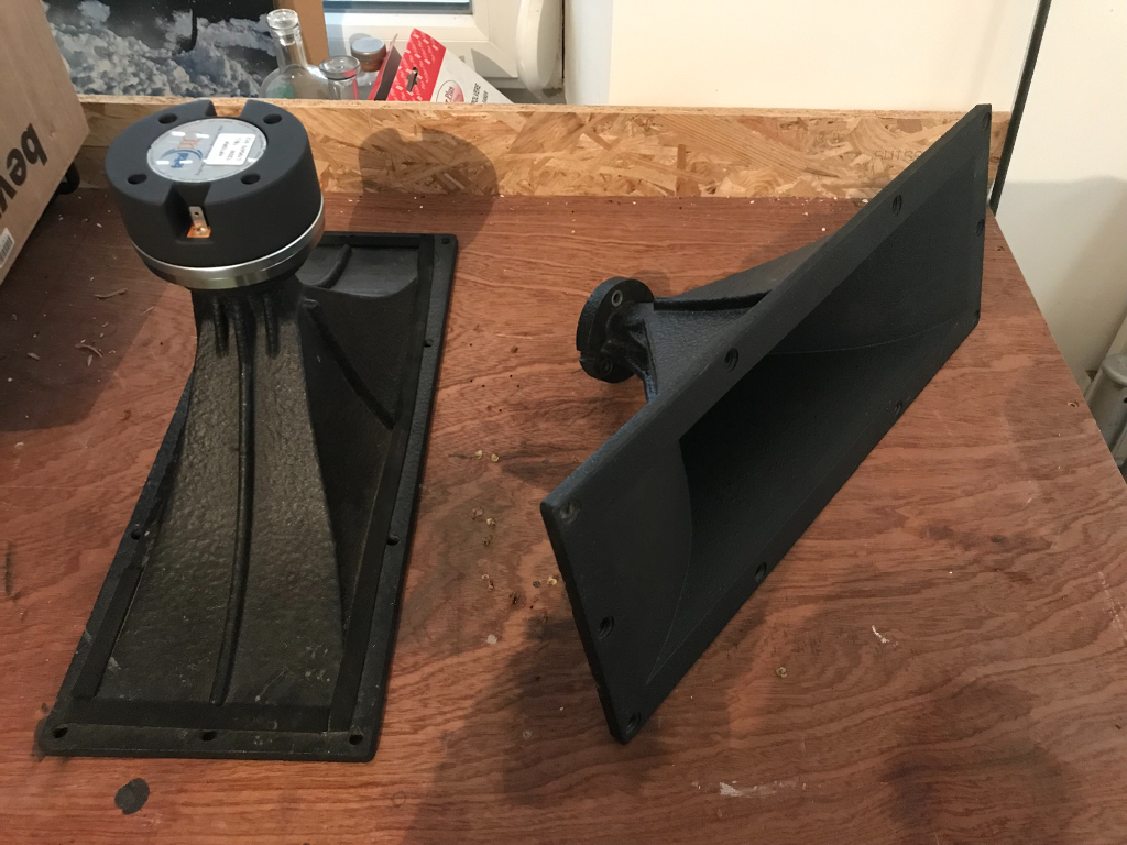

Impression of prototype 2-way with Fatial Pro HF108R - 16 ohms mounted to LTH102 & Faital Pro 12PR320 - 8 ohms.
1 kHz is a critical XO point for a 1" driver. The Beyma CP380M takes it easily, even crossed slightly lower.
Other 1" drivers, like the BMS I have, don't sound so good around 1 Khz.
For 900Hz and below, I would always use a larger diaphram (>1.75").
Much depends on the horn though > in general, a bigger horn facilitates a lower xo point.
