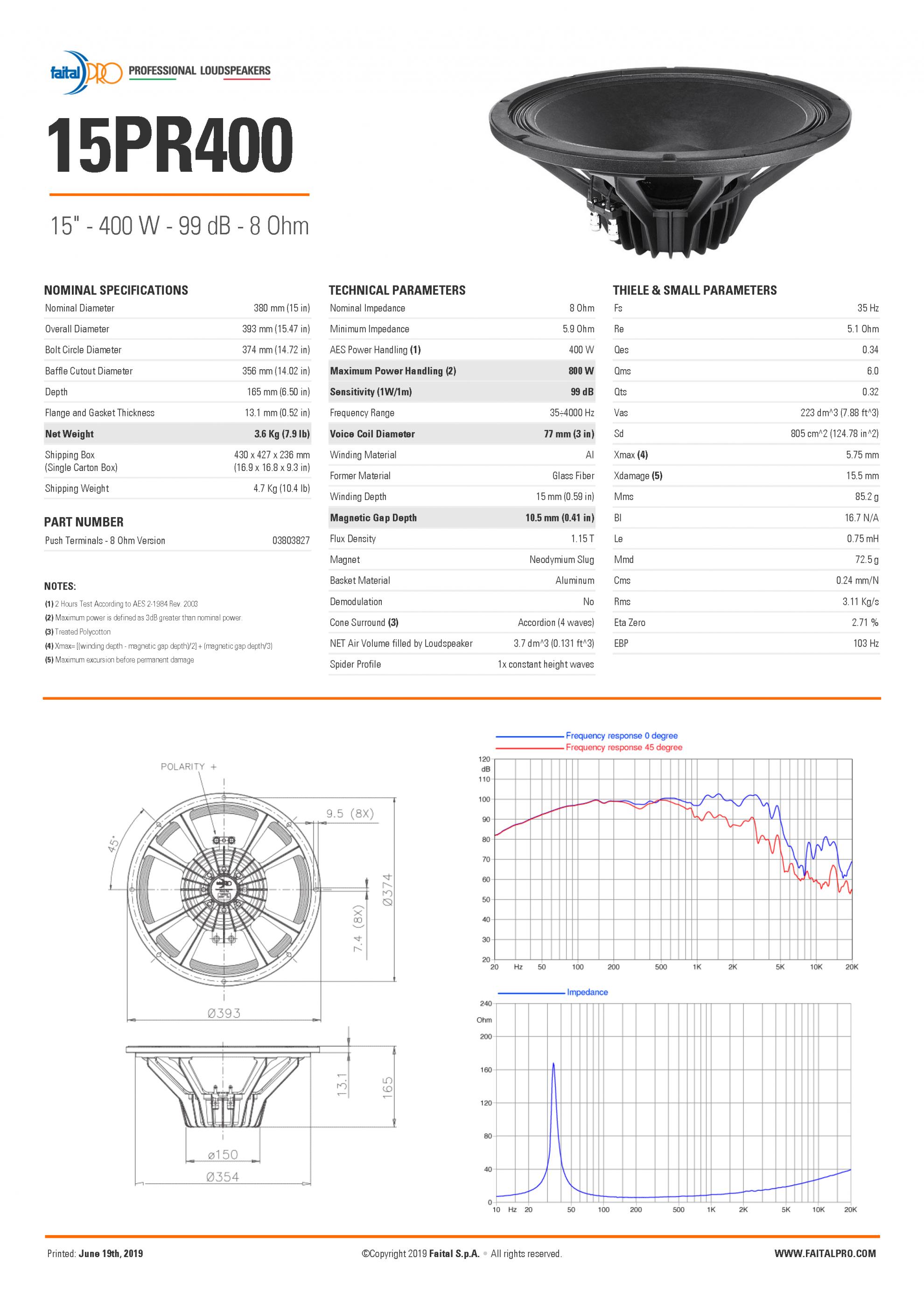

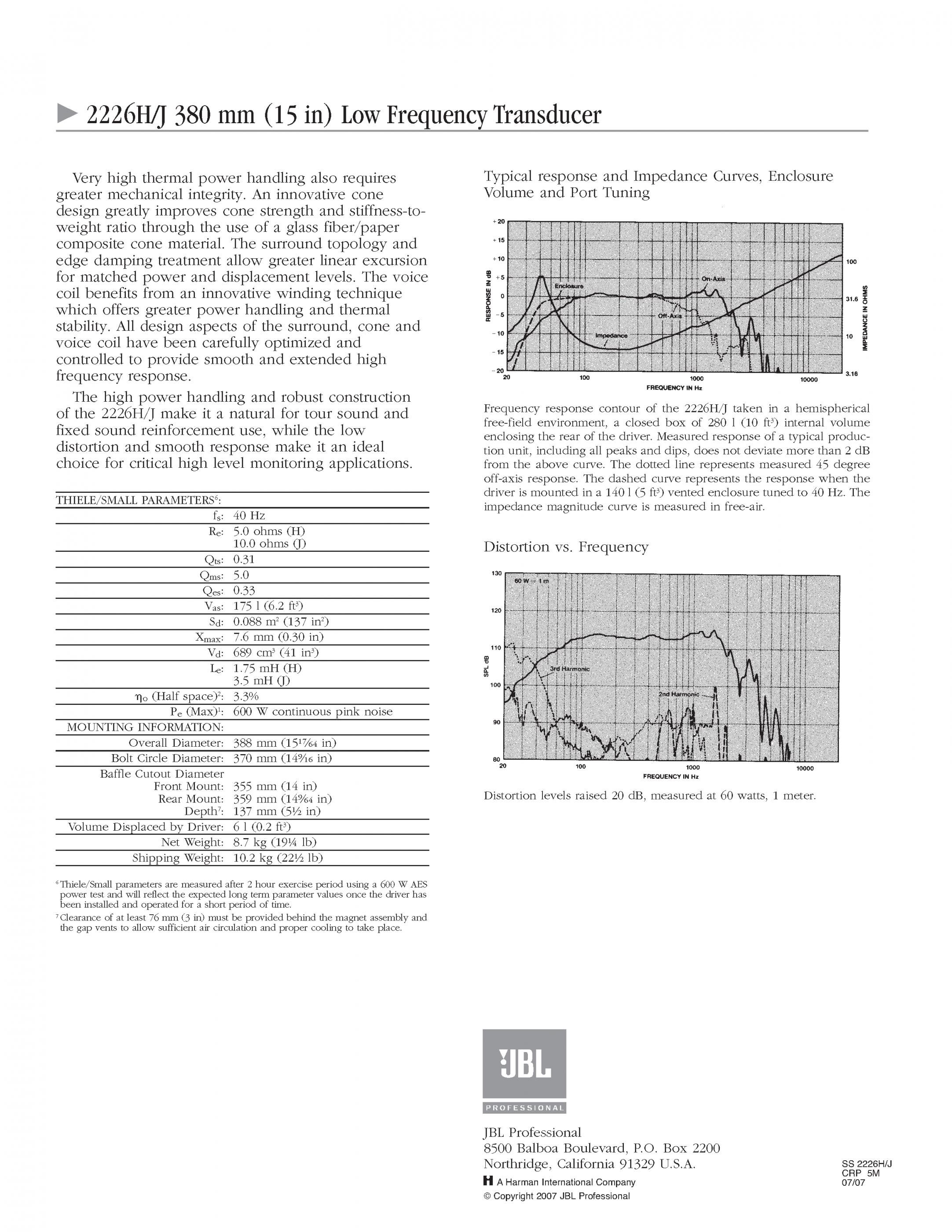

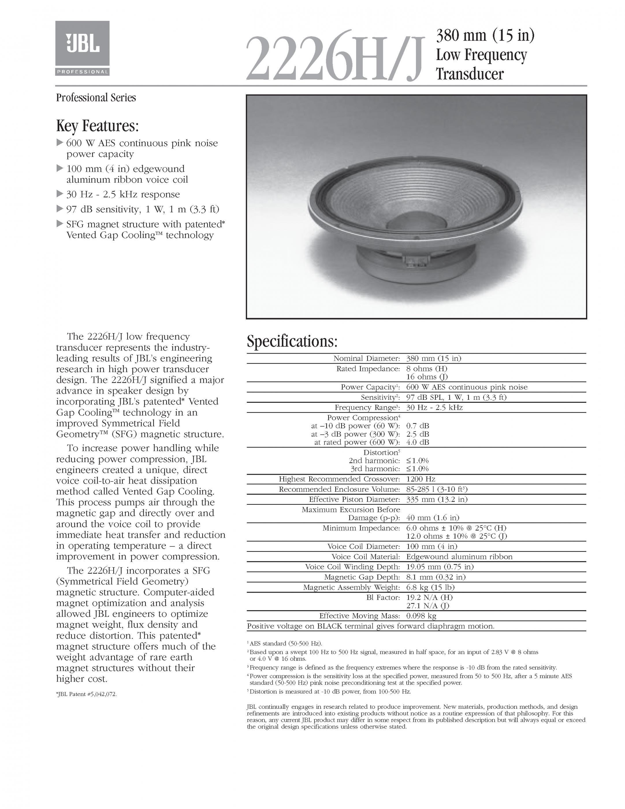

If you just compare specsheets of both drivers, what's your assessment?
Even from a technical/scientific point of view it's obvious why the 15PR400 is superior >500Hz.
I would (vaguely) suggest: just "read" (analyze) the driver and translate (visualize) its characteristics/specs into "sound".
After a few hundred different loudspeaker systems you'll start to "recognize patterns" 😉
... Or if you still don't believe those who commented on both drivers, just build the cabs and find out for yourself.
Why oh why, would the 15PR400 be better in the midrange (>500Hz)?
If you'd just keep looking at the measurement plots on a screen (after building cabs with both drivers),
instead of listening to the builds you may not become convinced, because the 2226 measures flat up to 1000Hz.
Obviously, this won't tell you much about its actual (subjective) sonic performance (apart from the driver technically operating in a 'linear' fashion).
But if you invite classical musicians to listen to both 'optimized' cabs, they would tell you which driver sounds more like 'the real thing'.
You seem a knowledgeable and experienced builder.
That they were made many years apart, with different measurement systems, by different people on different continents and aren't comparable.
